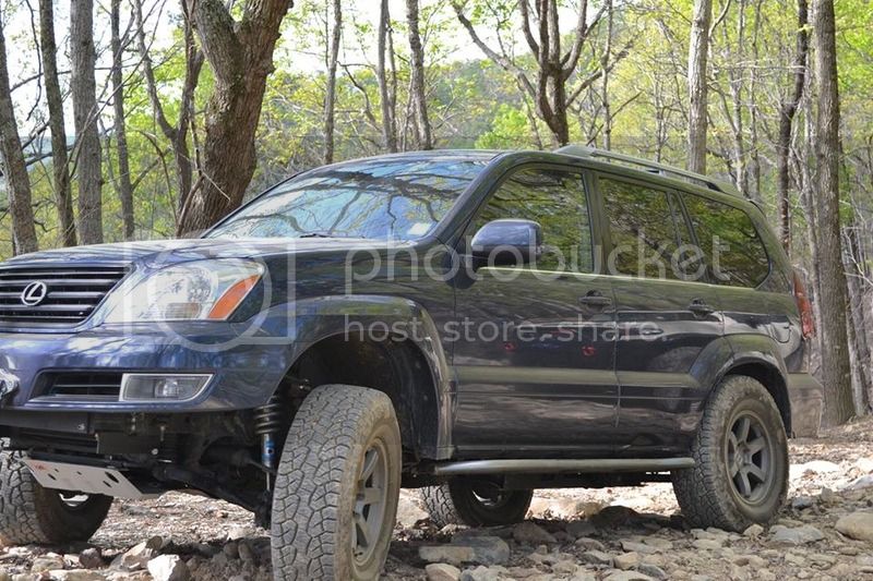

Tested the sliders out today - and the rest of the upgrades (didn't need the winch yet). Overall, it did pretty good in moderate rocks. The gas tank is the Achilles heel I think. The tank skid got a bigger workout than the sliders. Only option to get a little more clearance is to go with some 35's. So that'll be the next project.

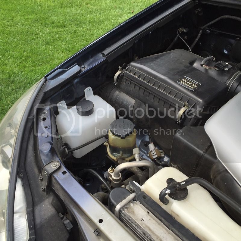

Re-located my windshield washer bottle, using a universal coolant tank...
So that I could fit these.....

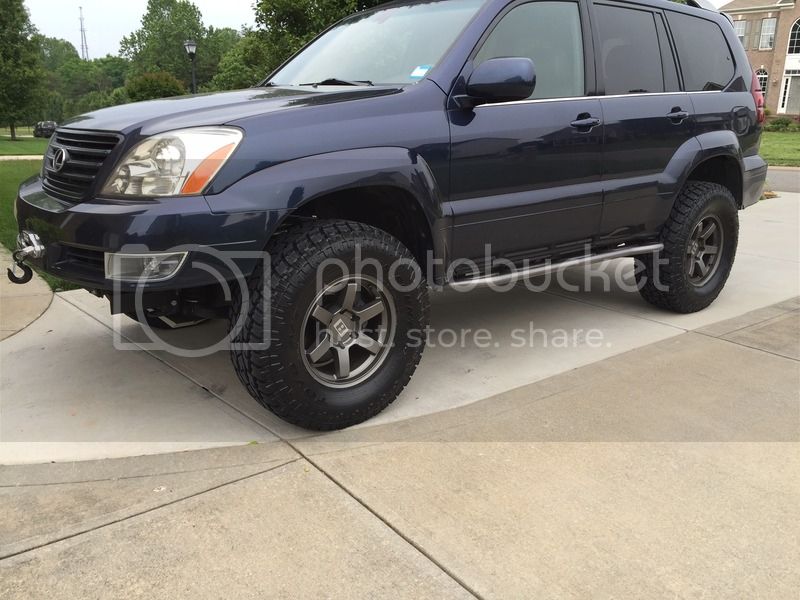

@madtoy how much lift are you running? Still running the 5100s with 2.5" Toytec springs? I am curious how much lift you actually netted. I went with the 285/70s and was considering the 305s I love the way that looks! Looks great. Keep up the good build.
Still the same lift. I had to move the Bilsteins up to the 1.75 notch. This got me right at around 3" of lift. Maybe a tad more.
Hmmm...The bottle relo is nice. I already cracked my OEM. Now details!
It was pretty easy. Hardest part was getting the stock bottle out (only because I didn't know where all the bolts holding it on were).
But just buy this from Amazon, for 8 bucks shipped if you have prime. Use a 1 3/8" hole saw, or wood drill, and drill out the two holes for the pumps. I did one on the front side, and one on the side toward the front of the vehicle. I did this so that I wouldn't have to cut the tape on the wiring harness to get the washer connector to reach. It just makes it in this position.
You also need to put a generous amount of clear RTV around the grommets, since the coolant bottle is thinner than the stock washer bottle, and the grommets don't fit perfectly. There's a small hose pipe on the bottom also - but you just fill that with RTV to plug it. I left out the low fluid indicator, since with it unplugged, it doesn't show up on the dash. Obviously, not nearly as much capacity - but good enough to last a good bit, and easy enough to refill when needed. I did the same on my Jeep, using the same bottle, so works well.

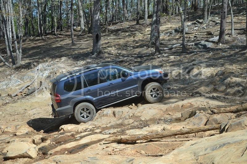

Some fun at Potts Mountain this weekend...
So when are you installing lockers? ;)
Were you aired down at all? The tires didn't appear to deform or grab much.
