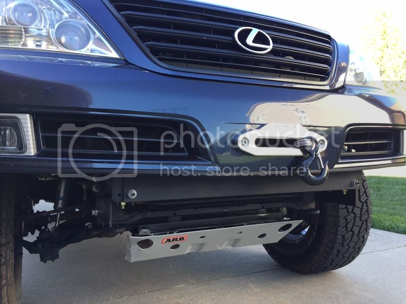

So you removed the entire factory bumper. Added a steel plate too the factory legs. Then built the winch mount on that (plus more metal not seen). I kinda want to keep the factory bumper. I might fab mine a little different. Any thoughts.
Did you fab or buy the bracket for the incognito winch mount? Plz share details in either case, thx.
I fabbed it. Basically utilized the stock frame, and mounted a 1/4" steel plate to it, and used 1/4" angle iron to reinforce it to the frame. No welding necessary. I'll try to post pics when I get back on my PC.
