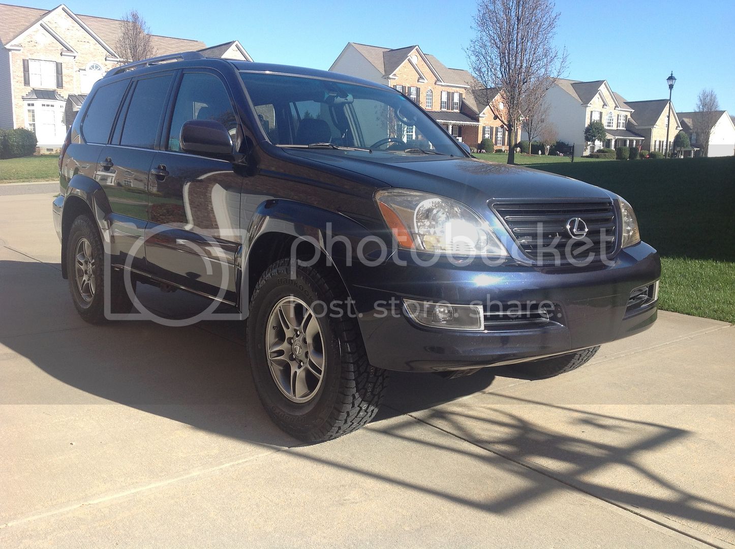

Next, I chopped my cab mounts, flattened the pinch welds, modified some plastic, added some G2 1.25 spacers, and put on some 285/70/17's with no lift. Making the tires clear with no lift is paramount to making sure it won't rub while flexing on the trails.
Mission accomplished

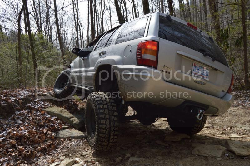

Prior to the GX, I built up a 2004 Grand Cherokee. While it was extremely flexy, and awesome on the trails, it was a handful on narrow winding roads, and highway speeds. Never mind the constant problems that never ended.

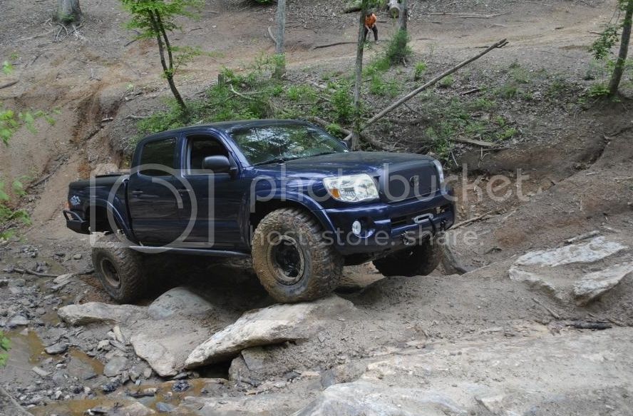

And prior to the GC, was the one that got away. My biggest regret was selling my supercharged Tacoma, double locked on 35's. Great on the trails, and great on the streets (aside from loud and unbalanced tires).

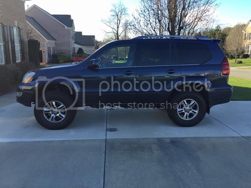

Lift is on. Bilstein 5100's with 2.5" Toytec springs in front, and airbag trick in rear for now. I'll be doing the rear conversion soon though. Also added some SPS UCA's and removed the spacers.
