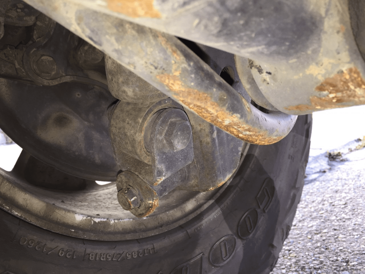

In the world of the 100 Series Lexus LX470, Japan 4x4 made a set of spacers that would mount between the shock mount on the rear axle and the AHC ram, and between the lower control arm and the AHC ram in the front. The purpose of the shock was to maintain the stock amount of travel (up and down), while producing a lift. The AHC sensors would be used to adjust the lift size.
I'm not a suspension expert, but it seems to me that a LX570 sensor lift extends the neutral distance that the ram travels, leaving less down-travel and more up-travel than the stock position at any given height (L/N/H). Generally, the suspension seems very similar to the LX470 series, but I think the LX570 series has a larger range of total travel. However, if someone were to fabricate a similar set of spacers for the front/rear of the LX570, then the down-travel/up-travel might remain similar to stock (also similar pressure), while still achieving lift.
Has anyone attempted to fabricate spacers for the lower shock eyelets to be used in collaboration with a spacer lift? Here's a picture of the spacers on a LX470 series. The front ones from an LX470 certainly wouldn't fit the LX570 LCA's, but the rear one might fit the LX470 axle mount... Is the up/down-travel less of an issue on the LX570 because of the additional travel vis-a-vis the LX470? am I overthinking this? Do the upper spring spacers on the front accomplish the same thing?
[Edit: After looking at the LCA on the LX570, I don't think it's possible to extend they eyelet's without running interference with the LCA itself. Maybe the upper spring spacer is the best bet...]

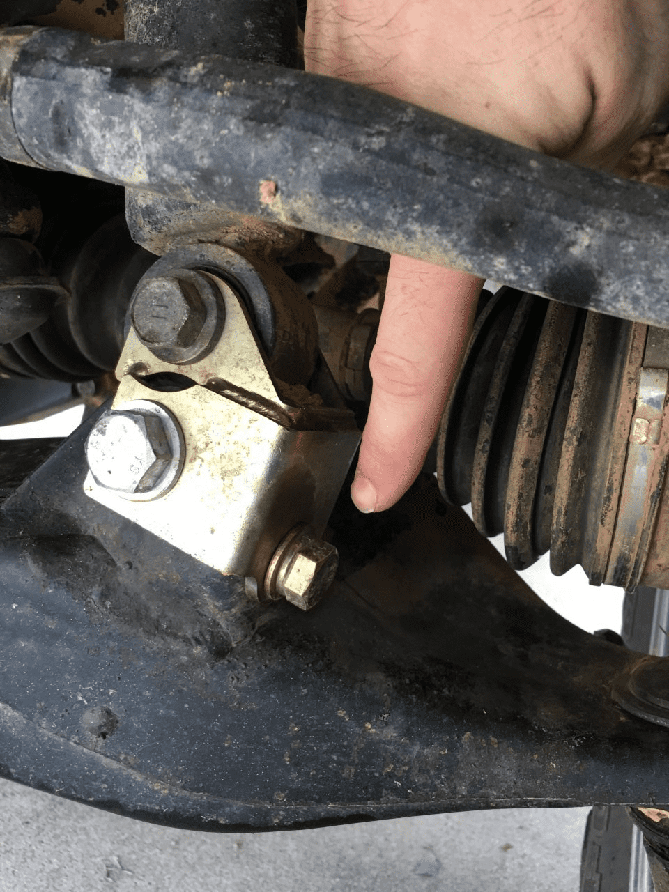

I'll go back on what I said. After further review, I think a front mount for the LCA is possible, it will just require a decent bit of fabrication. However, it might be a lot easier to put a shock spacer in the top, as @TeCKis300 did here Front Shock Spacer - Increased Suspension Stroke? - https://forum.ih8mud.com/threads/front-shock-spacer-increased-suspension-stroke.1098556/post-12820947 . I believe that this achieves the same thing without having to fabricate a metal spacer on the LCA, for the front. However, an LCA mount would likely be easier to install. Where @TeCKis300 achieved spacing of ~0.75" droop at the hub, I think an LCA spacer would have to result in more at the hub. In any event, I think it is doable, and might warrant further exploration. The sway bar links may also require extension, if the increase is more than an inch or so.
On the rear, the Japan 4x4 spacers for the LX470 series might actually fit the LX570...I haven't test fit yet, but it looks promising. The attaching bolt PN 9090119052 is the same on the LX470 and LX570, which leads me to believe that the rear AHC ram on both models has the same diameter hole, attaching the ram to the axle. The rear springs should probably also have a spacer added to them, since the springs would be extended via a shock spacer. There's probably more calibration that needs to be considered on the ideal shock spacer size (eye to eye) and the matching spring spacer.
For greater clarification, the intention here is not to provide additional lift via spacers, but to return the neutral pressure to stock and maintain the same up/down travel as stock, when implementing an AHC lift.

Interesting you bring up the 100-series rear shock extension bracket. I've long thought to try that and may still one day.
If neutral pressure restoration (to maintain or increase payload capacity) is the objective - yes, solution is as you mention and I've done both front and rears. Front with upper OEM shock spacer. Rear, I now have 30mm spring spacer. I've AHC lifted my LX about 1" front and .75" rear. So the front spacer was to restore pressure. Rear to restore, and augment for further load. It all works great up to about 2000lb payload. I've since added airbags too to the rear for kicks and will see how it goes.
Extending suspension travel - the shocks are the down limiter for travel front and rear. The spacer at the front indeed increases suspension stroke by about .75", to 10" total travel matching the rear. Rear spring spacers don't do anything for travel. Anyone want to try that 100-series bracket? Will want to pay attention to make sure that the shock does not become the compression limiter at full squish.
In regards to extending travel at the rear...

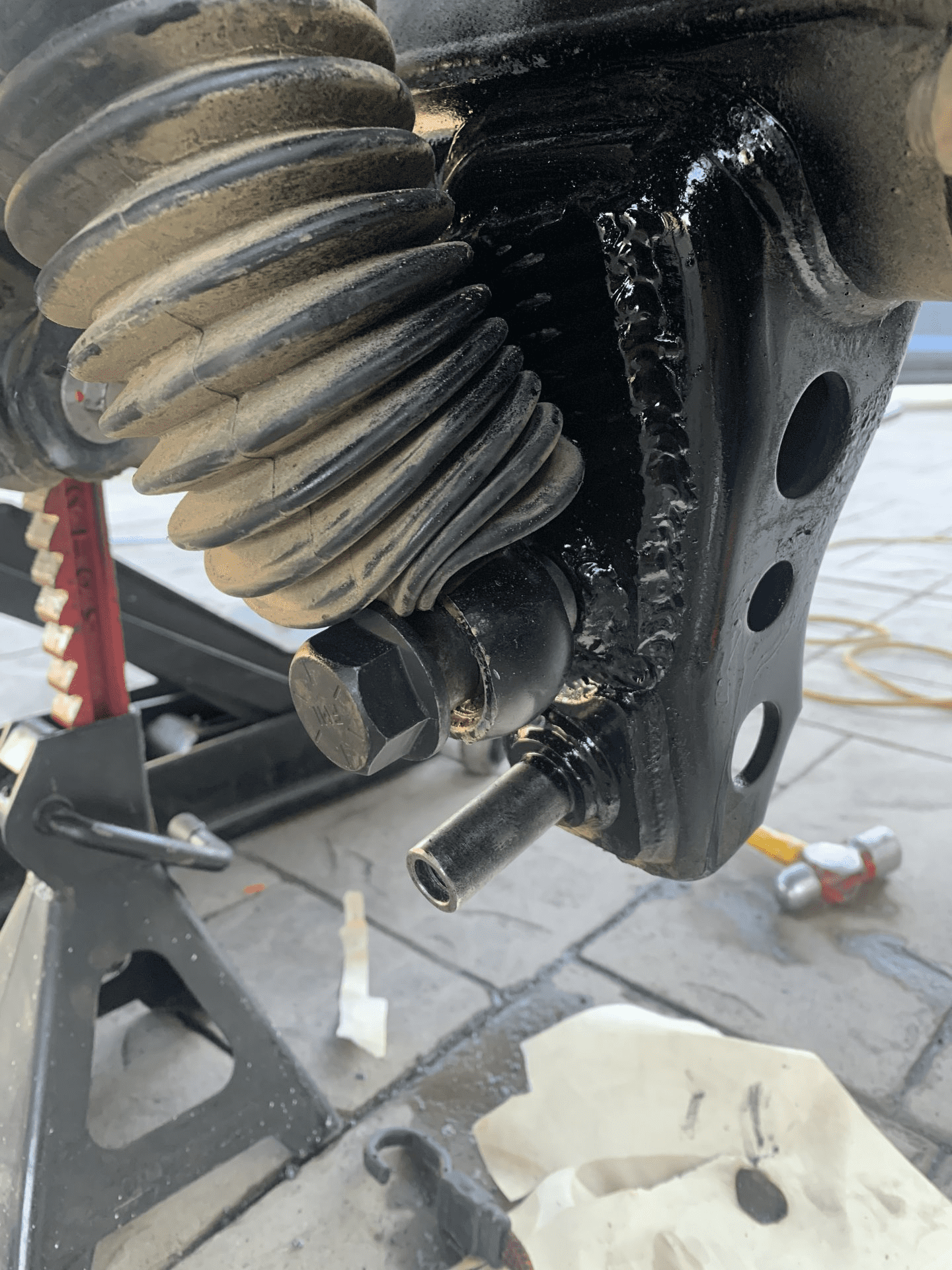

There's been some interesting development where some have relocated lower shock mount upwards on the OEM bracket by reusing a higher up stock hole, welding additional supports, and using a through bolt. This could be a strategy to increase droop by about 2". Provided the shocks don't become a limiter upon compression. Perhaps combining this with a mild bump stop lowering.

Conceptually, that would achieve the same increase in droop, without impacting up/down travel, vis-a-vis stock. If the intention is to keep the AHC ram travel close to stock, the adjustment may have to be kept to around the max AHC height increase possible via the sensor lift.

How's the 37s coming? I think this lower shock mount maybe just the mod you need. Along with a 1-2" lowered bump stop. Should be able to set the AHC sensors to just about stock with these physical changes.

That’s exactly what I’ve been thinking since I saw @Atwalz build. Then you shared the other link that I hadn’t seen but I kind of like his approach with a bolt through. Which do you prefer and why?

If we're teasing at details, the stock setup looks best with a separation of concerns between the structural mounting post, and clamping pressure provided by an end bolt. The single shear configuration is more difficult to ensure long term durability. The stock configuration puts the shaft in compression rather than a single straight bolt through that is in tensile.
Which is why I think if there's any concern at all, that a double sheer support could be created for the new mount by tying it back to the original shaft at the ends.
