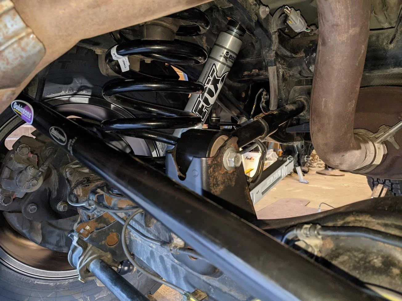

Sorry, missed your question here earlier. I just used the Fox shocks that came with the BDS kit, but it's just temporary. Although intended for a Tundra they fit the bill in terms of length and travel for 4.5-5 inches of lift, and once I have a chance to drive on them a bit with the drawers loaded up and the steel bumper installed I'll have a better understanding of what type of shocks I will need long term. Ideally I'll end up with some remote reservoir shocks to compliment the Fox coilovers up front.

I am surprised to see lower mount hole work from tundra on a cruiser. My understanding was the rear lower shock ID on tundra and cruiser is not same size.
2013 Lc200 rear shock mount ID measured on shock is 3/4”.
2007 Tundra rear shock mount ID measured on shock is 1/2”
The Fox 2.0 shocks come with a metal bushing sleeve that is required for 1/2" diameter shock mounts...but the bushing itself is 3/4" and fits the LC mounts perfectly. So I just skipped the sleeve 👍

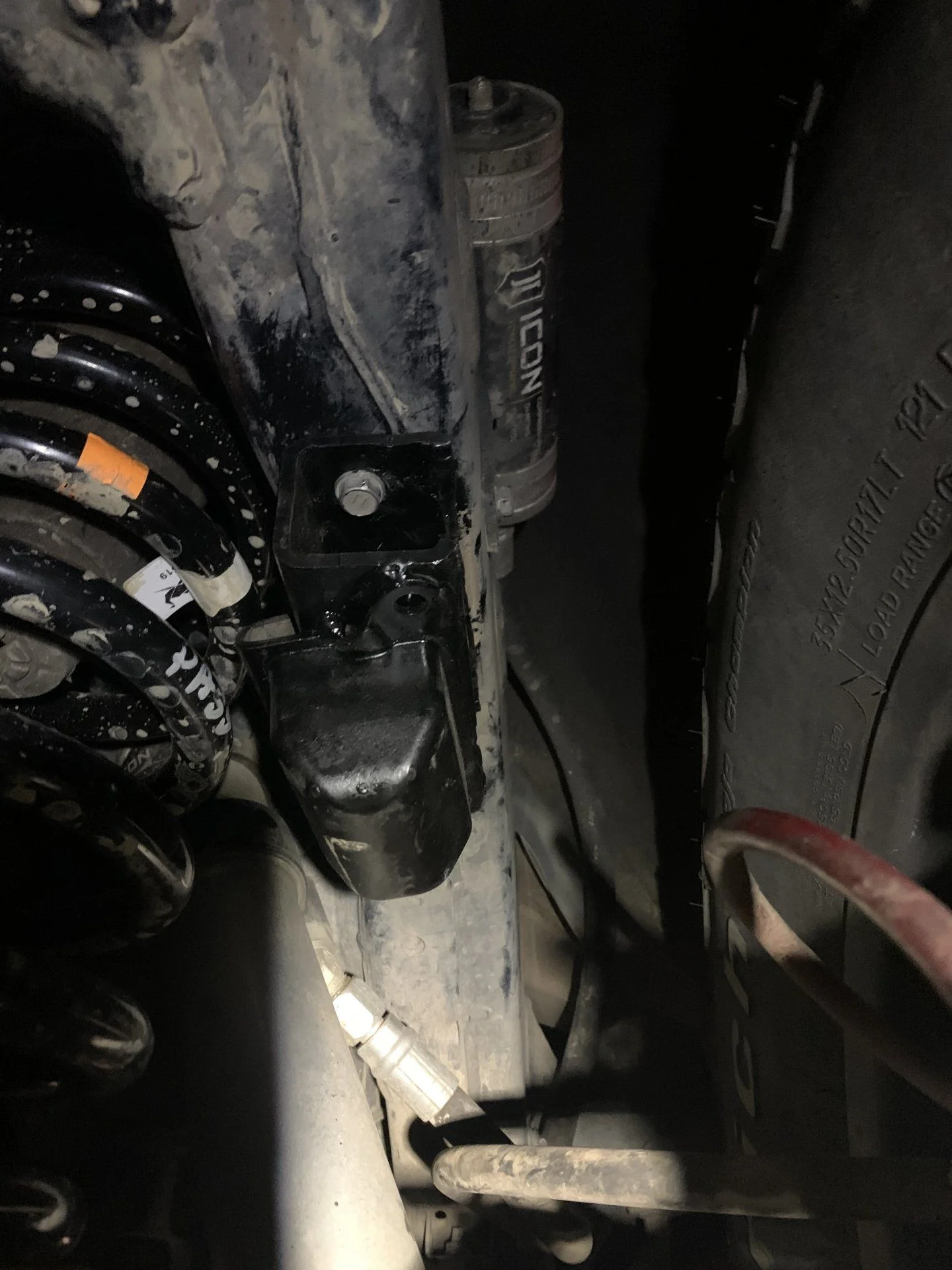

Btw I switched to OME 2423 spring and got desired lift. I had to raise the lower shock mounts by approximately 2”. I also modified rear bump stops to address rubbing.
How much did you have to reduce rear travel? Maybe a pic of the bumpstop when you get a chance 🤓
I limited up travel by 2” it is same amount I raised lower shock mount. Picture I posted above is before the mods were done. I was trying to see limitations I need to put in place to reduce rubbing.

What was the rear rubbing on that caused you to reduce up travel?
The inner fender was in contact with the tire. I am running zero offset wheels so wanted to extend the bump stops to reduce the contact. Full stuff still has few inches of up-travel left to the axle before I extended the bump stop. I have not tested it after extending bump stops.
