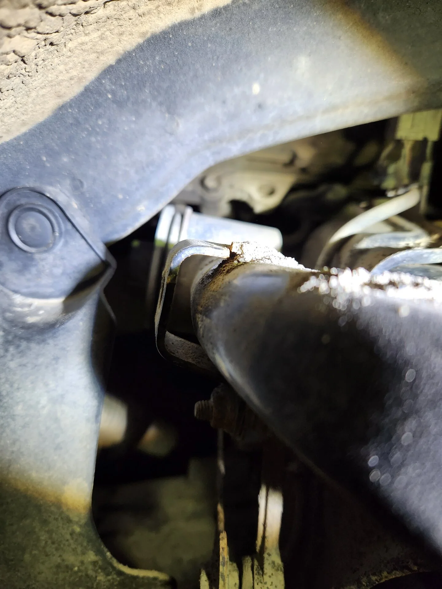

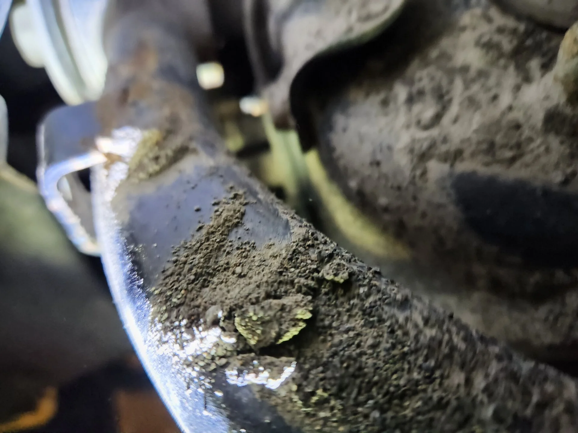

The rear passenger AHC accumulator hits rock and started leak. We were about 35-40 miles out to pavement. So, when this happened, the goal is to get out of the trail safely. I managed to drive over 100 miles home. The rear dropped low and front is still ok. So, I have all 4 accumulators, but was thinking to just replaced the damaged accumulator. The car is currently 88000 miles.
Yeah, that’s a good use case for swapping one, but if you already have the other rear in hand I’d do the pair.

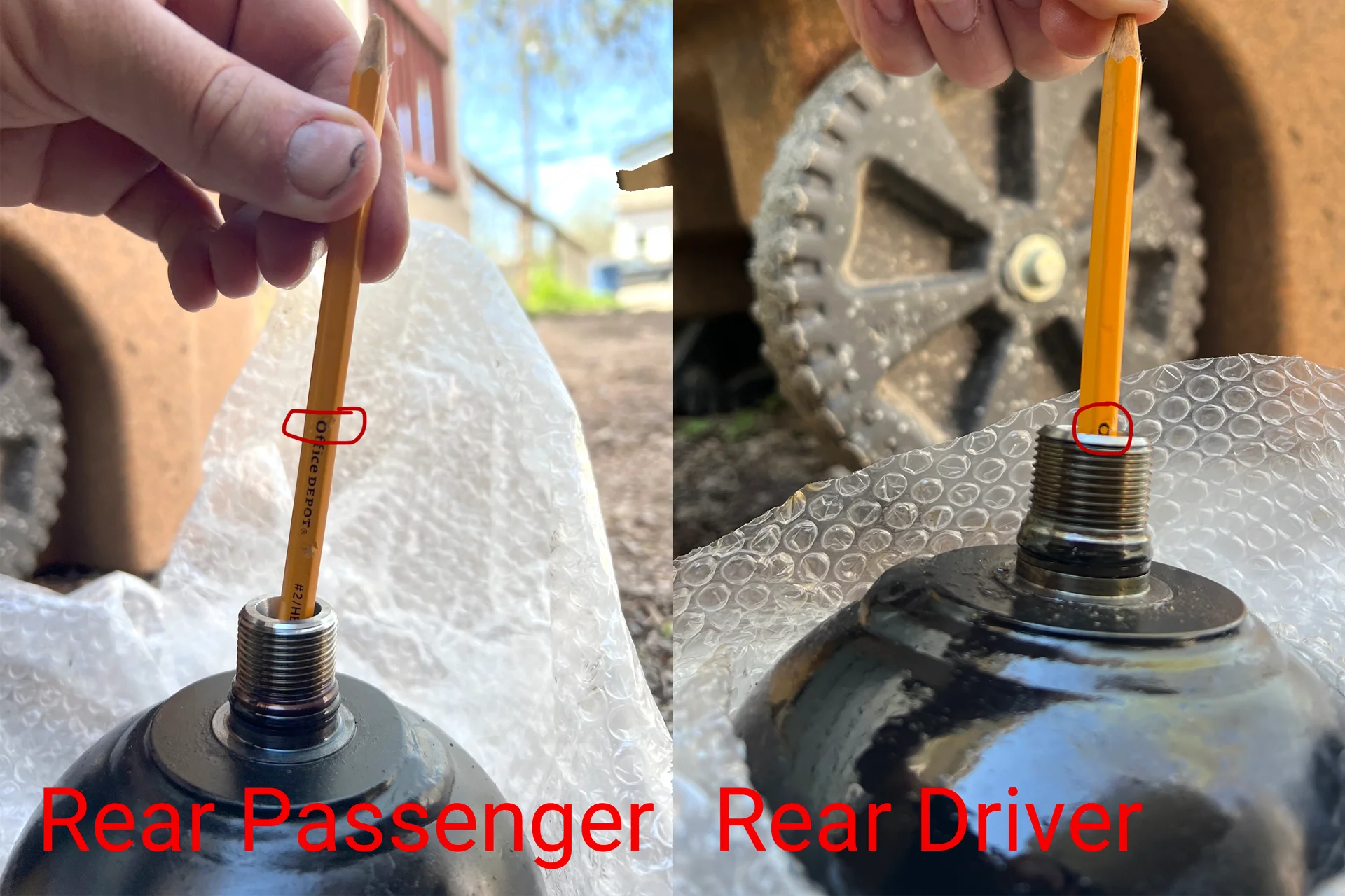

Well, after sitting on my replacement globes for 9 months, I finally replaced them today. And boy, I wish I had done it sooner. 2009 LX w/ 164k miles on the clock. I've owned it for 2.5 years, since 137k.
I discovered a total failure of my rear driver-side globe.
I did a visual check on removal and could see the metal diaphragm on the first 3 globes. On the last one, it was a black hole. So I grabbed a pencil and could feel the collapsed diaphragm on the bottom of the globe. Wow. Take a look at the red circled reference mark. It was nothing more than a bowl full of AHC soup.
As it goes, the car now rides like a dream. I had previously replaced the fluid last summer, which helped the ride a bit. I had no idea what I was missing. It eats up the bounces when driving over the nearby railroad tracks. I'm not exactly sure when the diaphragm collapsed, but the ride quality has certainly degraded casually over the last ~5 months.

  • the rear passenger globe spewed AHC fluid everywhere upon removal, despite being double bled per @baktasht 's video. It was the only globe that did that.
