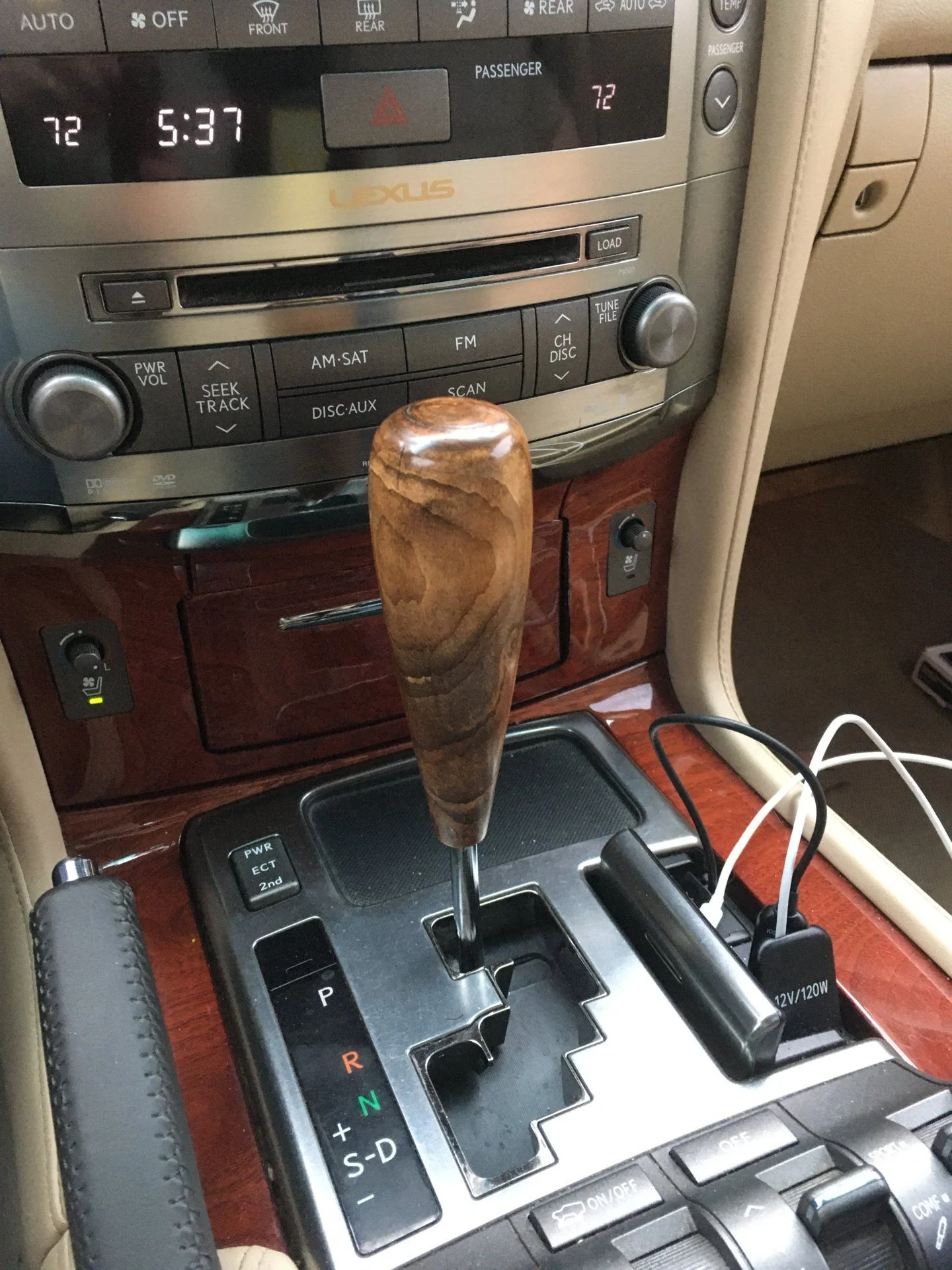

Thanks @dmc for this righteous shifter knob
Looks good. Once the weather warms up I'll see if I can get my friend to make some more, maybe a bit closer to the LX trim color.
Like most of the older LXs my trim is separating, that'll all be CF in a year or so . . . I have considered rubbing some red stain on it to see what happens; but for now enjoying the feel 100%

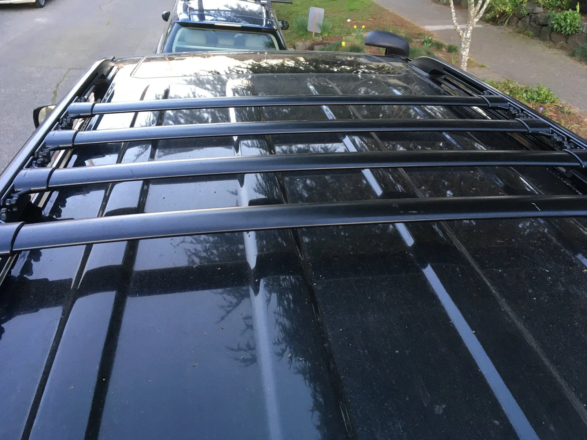

then I have a tlc rack to put on.

I guess after I pull the driver seat and do one more round on the amps, do some rack fitting for the trax, that I'm done? until the armor is ready . . .

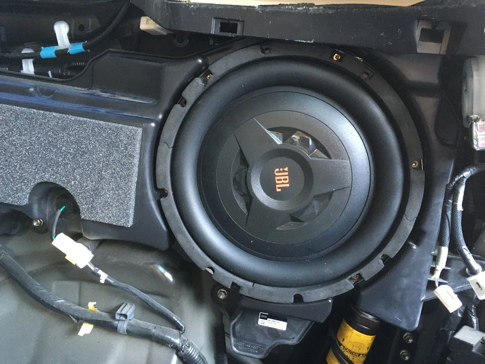

couldn't resist the power of the subwoofer thread and ordered a sub. 8" JBL 810 4ohm 88db 4" mounting depth .35cft sealed box. We'll see how similar the ML sub and JBL subs are when I pull the side cover. I hope it is at least an 8".
edit well on another thread I was informed the ML sub is a 10”. So I’ve got a 1000ws club jbl coming. similar char to the other jbl, but one trim higher, and 10”. It’s 3 and some change depth, 89 db and rated for a small sealed box.
Subwoofer achievement unlocked. It as a pita as the sub I chose really didn’t fit the space, but in the end worked out. It already sounds better (more low end) and I haven’t messed with the DSP or gains.

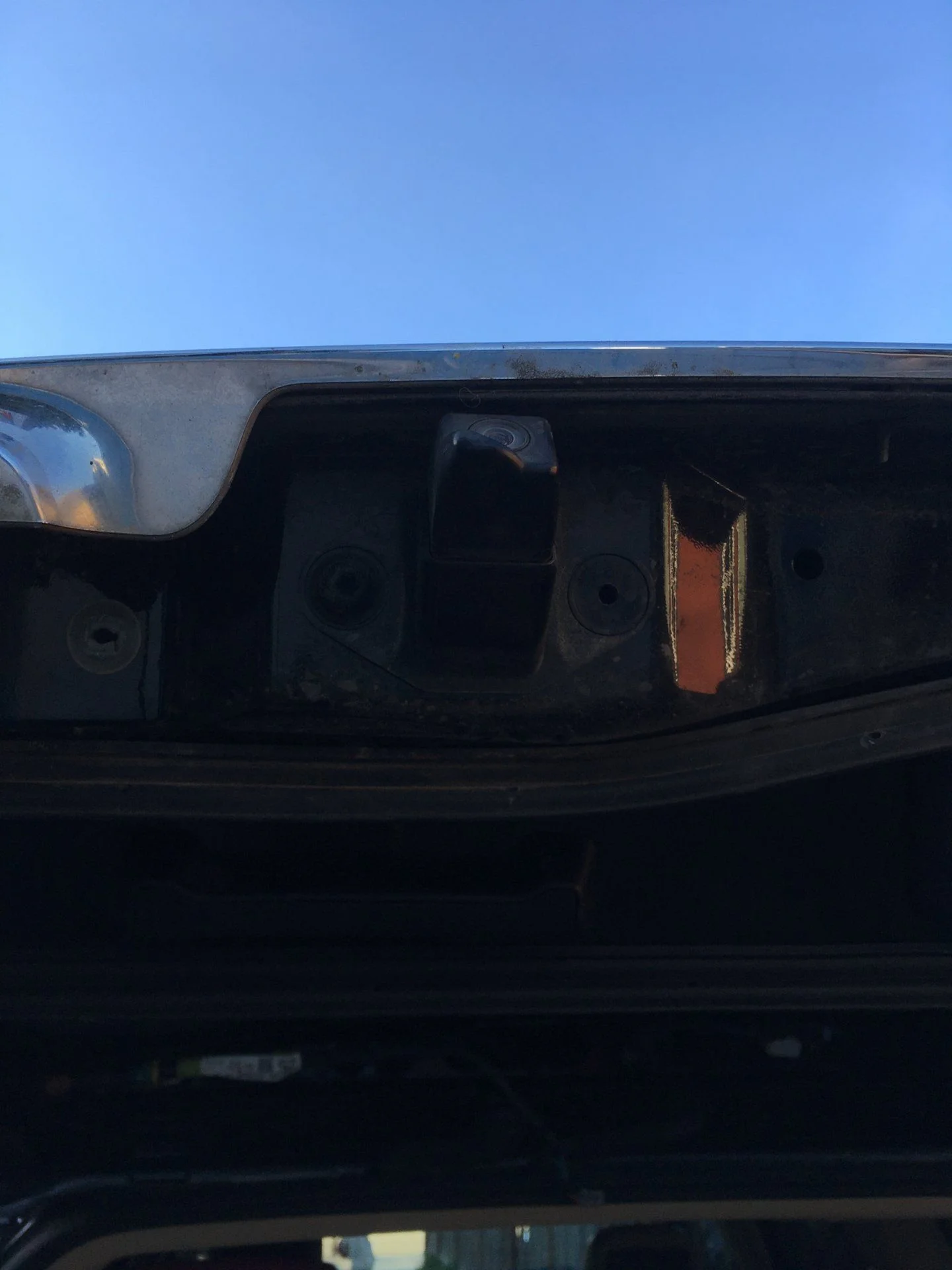

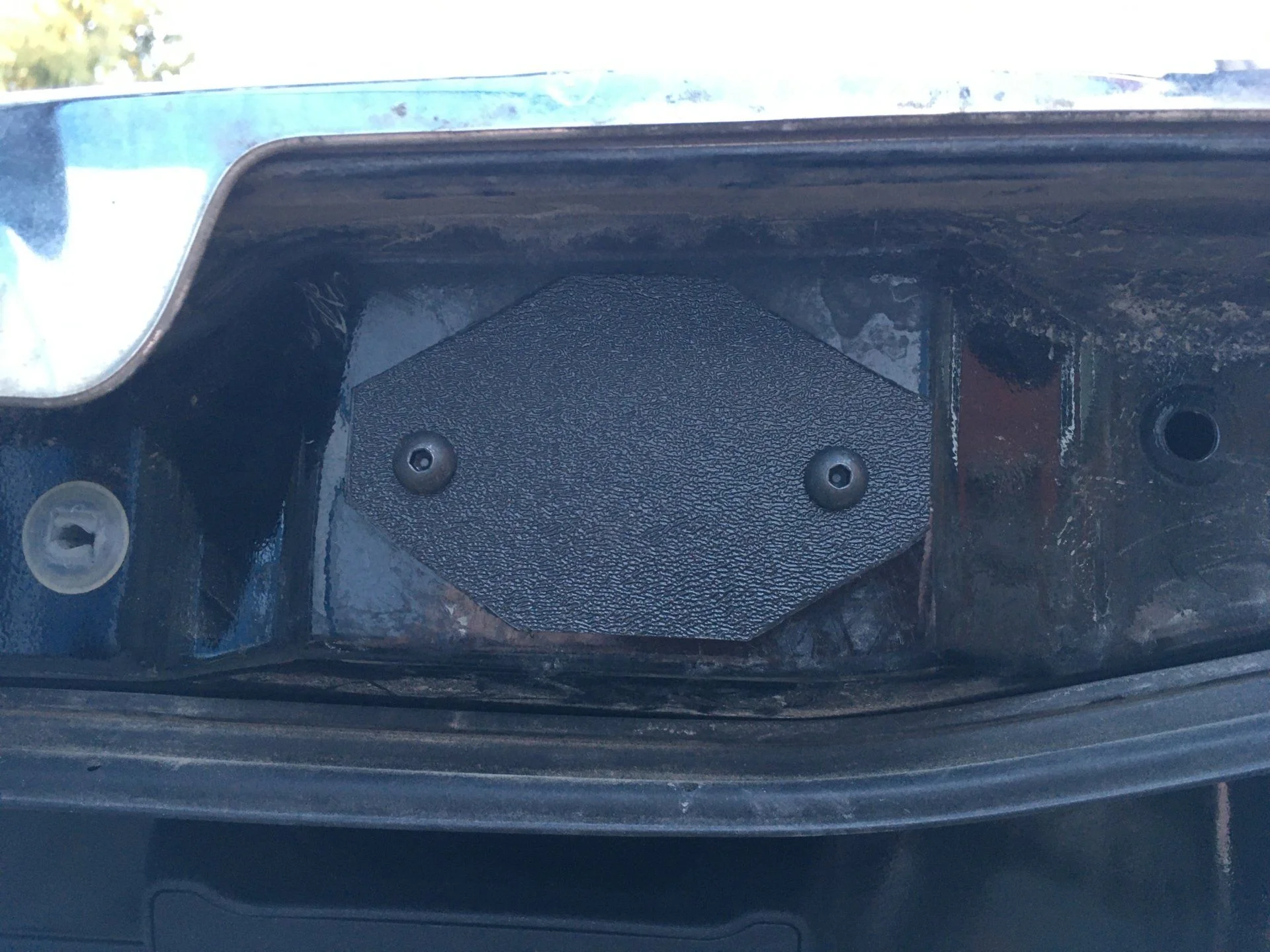

While I had the passenger rear apart thought I’d move the backup camera. Disassembling the rear door is pretty easy, but they used the screw clips from hell to hold the camera in. Got the wire run up to the grommet to the headliner, will start fishing tomorrow.
Seriously considering ordering a big boy dsp for the sound now that I have a sub in place. Probably will . .
Well as anticipated that grommet from hatch to headliner sucked. The final trick I tried was a puddle of lube on the hatch side of the grommet. pushed thru real easy after that. Life lesson there.
Got it down to the right side firewall grommet, which immediately split full length. It exits directly over the ahc fluid tank. Convenient!
Have the wire there and just need to patch in a connector and the final length to the spare.

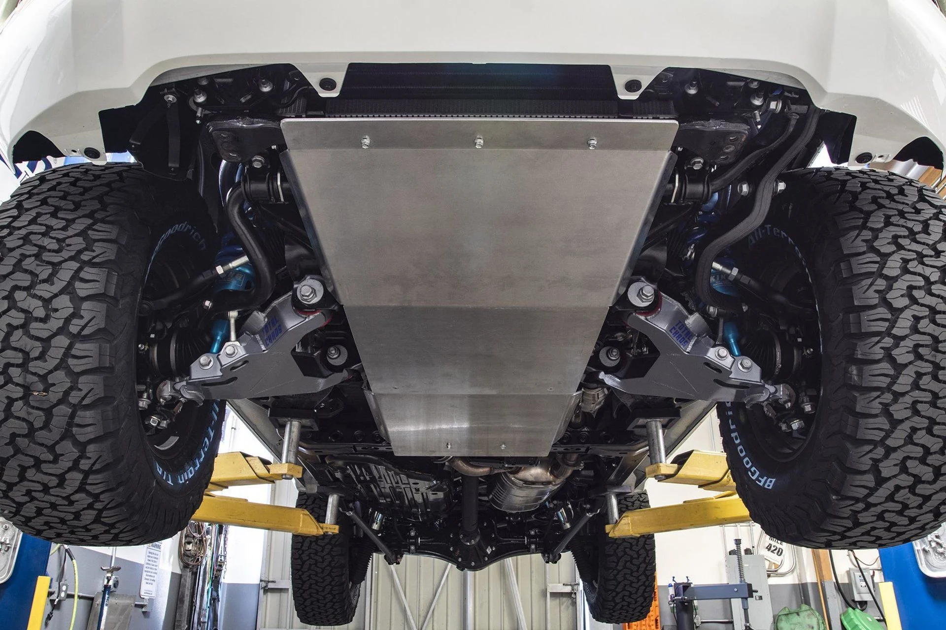

In other news I’m continuing the armor portion of the build.

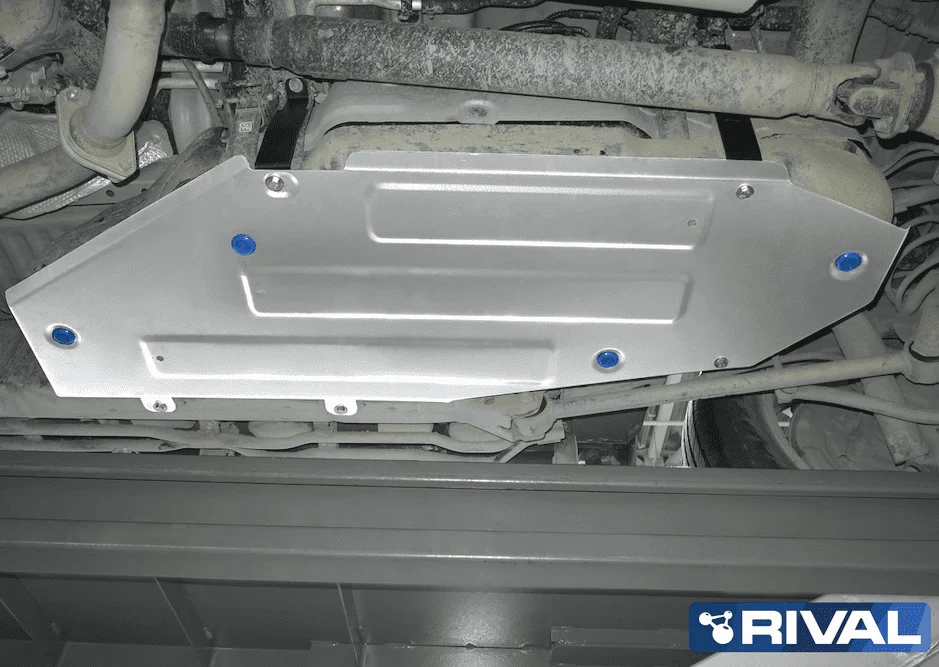

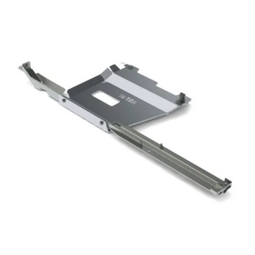

Have decided that I really factor weight (or lack there of) and went all Aluminum except for the rlca and shocks.
Front to cross member Total Chaos Aluminum
Transfer Case Asfir 4x4
Fuel Rival 4x4
Suspension bits Trail tailor
There will be some mild contention at the cross member for one bolt hole, should be easy enough to resolve.
Aside from the suspension which I already have in staging the rear is all lead time ordered.
Total cost was around $1100 for the skids, $300 for the suspension.
