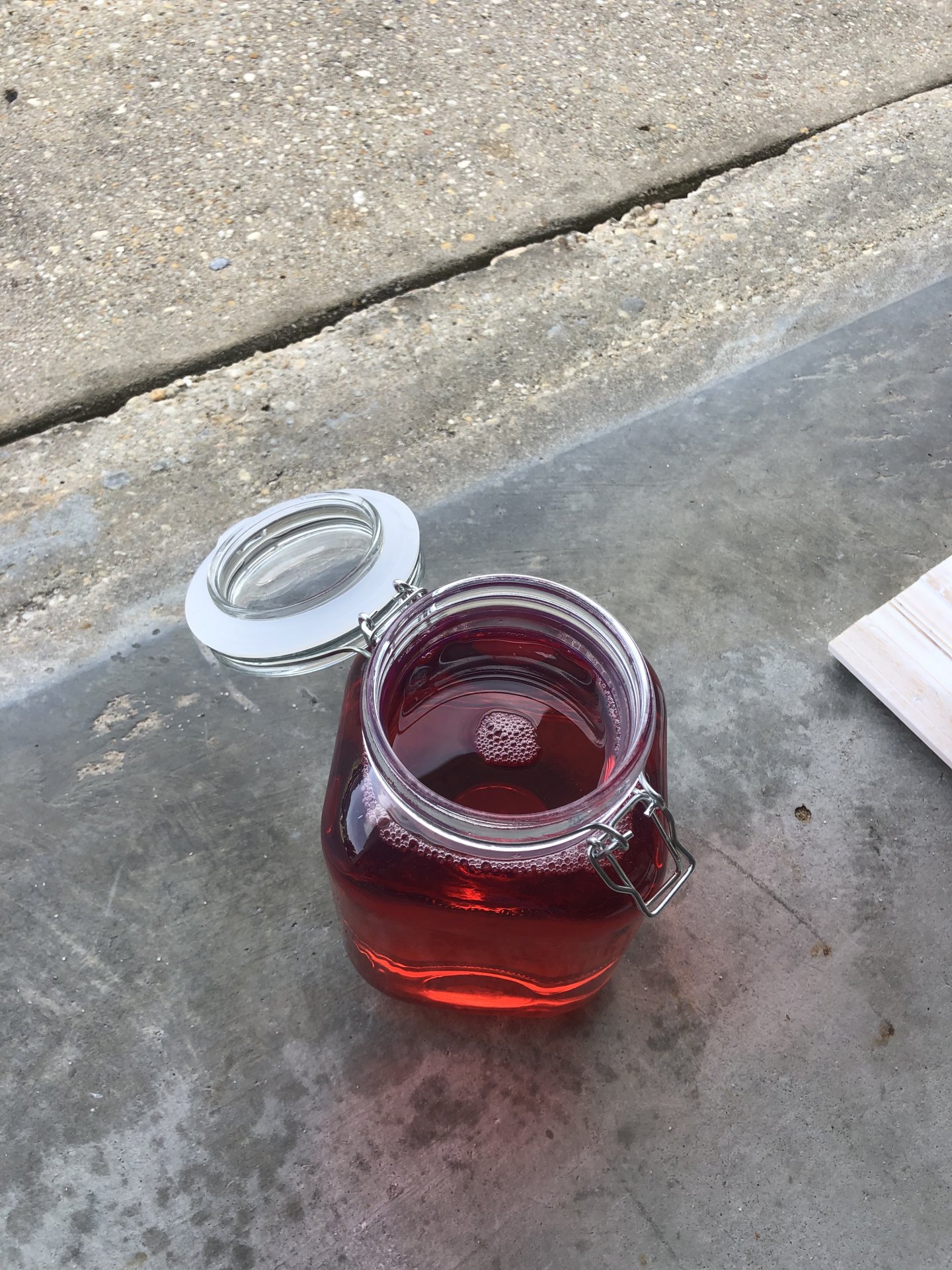

Got my AHC fluid this week, 6 liters from eBay. After I got it I saw the thread from a month or two ago about possible contamination, seemed like it might be more of a technician problem than a fluid problem so I planned to do the fluid change this weekend. Then I saw Wes’s thread about the white jelly in the fluid. So I did what any mud reader would do, I went to Walmart and bought a jar and a cheap strainer to see what the fluid looked like out of the container.

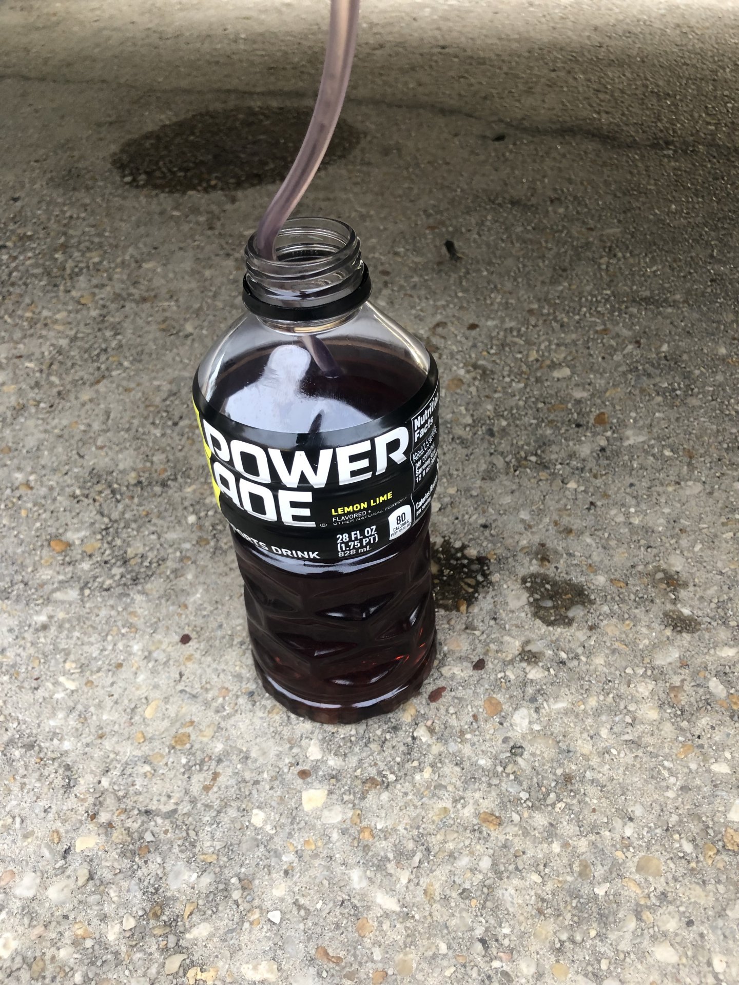

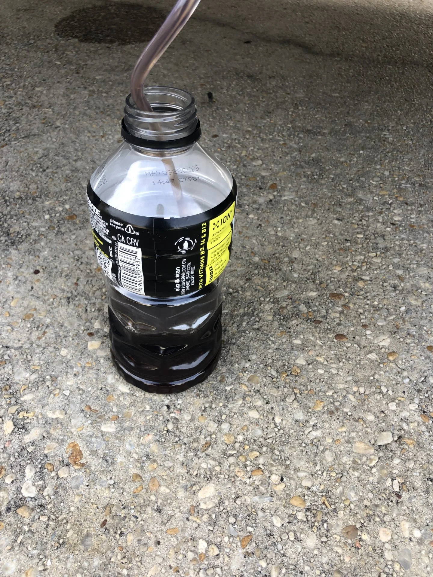

Filling the resevoir was a PITA. I tried it with the filter in and I was spilling fluid everywhere. I took it out but still had to go very slow. I was able to stick the clear tube from the pump way down the filler tube. When fluid started to back up I could hear it gurgling so I would stop and prevent a spill. Went to the front of the truck and started bleeding. Looked like a frothy cappuccino at first. Got better eventually.
Used a brake bleed tube and had a little trouble getting it on the front bleed valves. Due to the location of the rear valves I couldn’t get enough pressure to push the tube in. It was dark anyway so I will need to finish tomorrow. I’m through three liters so far. Let me know if I’m missing anything. Thanks to everyone who helps out on this forum.
