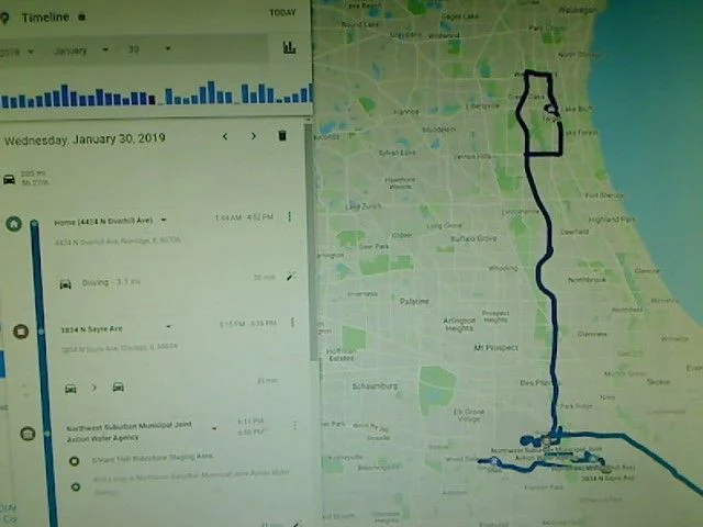

Chicago/midwest experienced that Polar Vortex 1/30/2019. I think a record was set this day for -26 degrees.
It shows I drove 5.5 hours and 205 miles. However, 5 hours drive means the car was running another 5 hours or more.
So, there you have it. No problemos in Chitowns -26 Polar Vortex

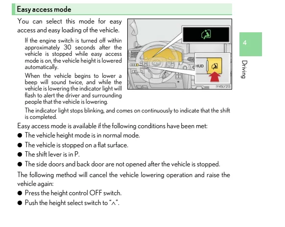

I wasn’t able to find it in this thread so forgive me if it’s been addressed. I have a 2017 LX and the AHC automatically lowers if the vehicle is shut off right when I park, however if I sit for a few seconds prior to shutting off the AHC does not lower. Is that normal? The dealership says it’s functioning as designed but that seems abnormal to me.
Yes. Has to be within 30s of being in park I believe. It’s in the manual.
Also, all doors must be closed in case you’ve noticed it doesn’t lower if someone opens a door too quick.
It is a feature called something like “easy entry/exit, you can turn off in settings.
Thank you, rookie mistake not looking in the manual.

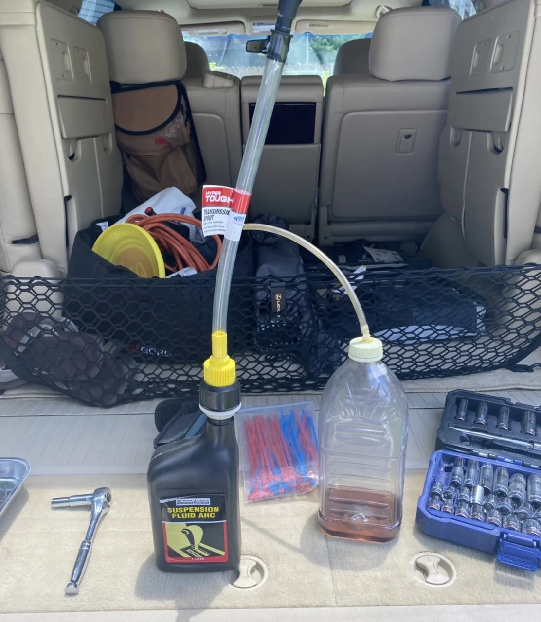

I don’t think I ever posted a picture before when I did my first fluid flush. I did a bleed on my AHC today and added a liter of fluid. Here’s the cheap easy tool I found for getting fluid into the reservoir. You still have to be slow with it, even with the filter screen removed, it will over run the filler neck at full “blast”. The yellow section is a valve to control flow.
Brave man with hydraulic fluid on parchment interior.
Ha, no doubt. At this point, I hadn't actually done anything with the fluid. Just off to the side there were plenty of shop towels and after i actually used the filler tube, it never went back on the tailgate. It was basically only there for 30 seconds so I could take the picture...The risks I take for Mud members..
