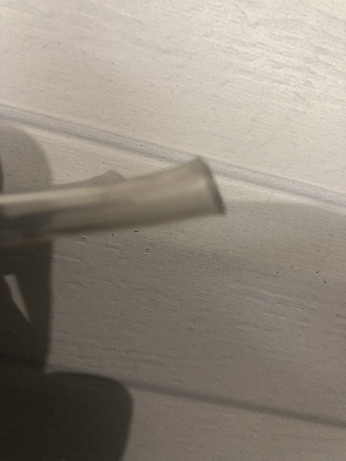

Used a heat gun and a hole punch to open up the bleed tube a little bit, as soon s it stops raining here in Pensacola I’ll see if it fits better on the bleed nipple.

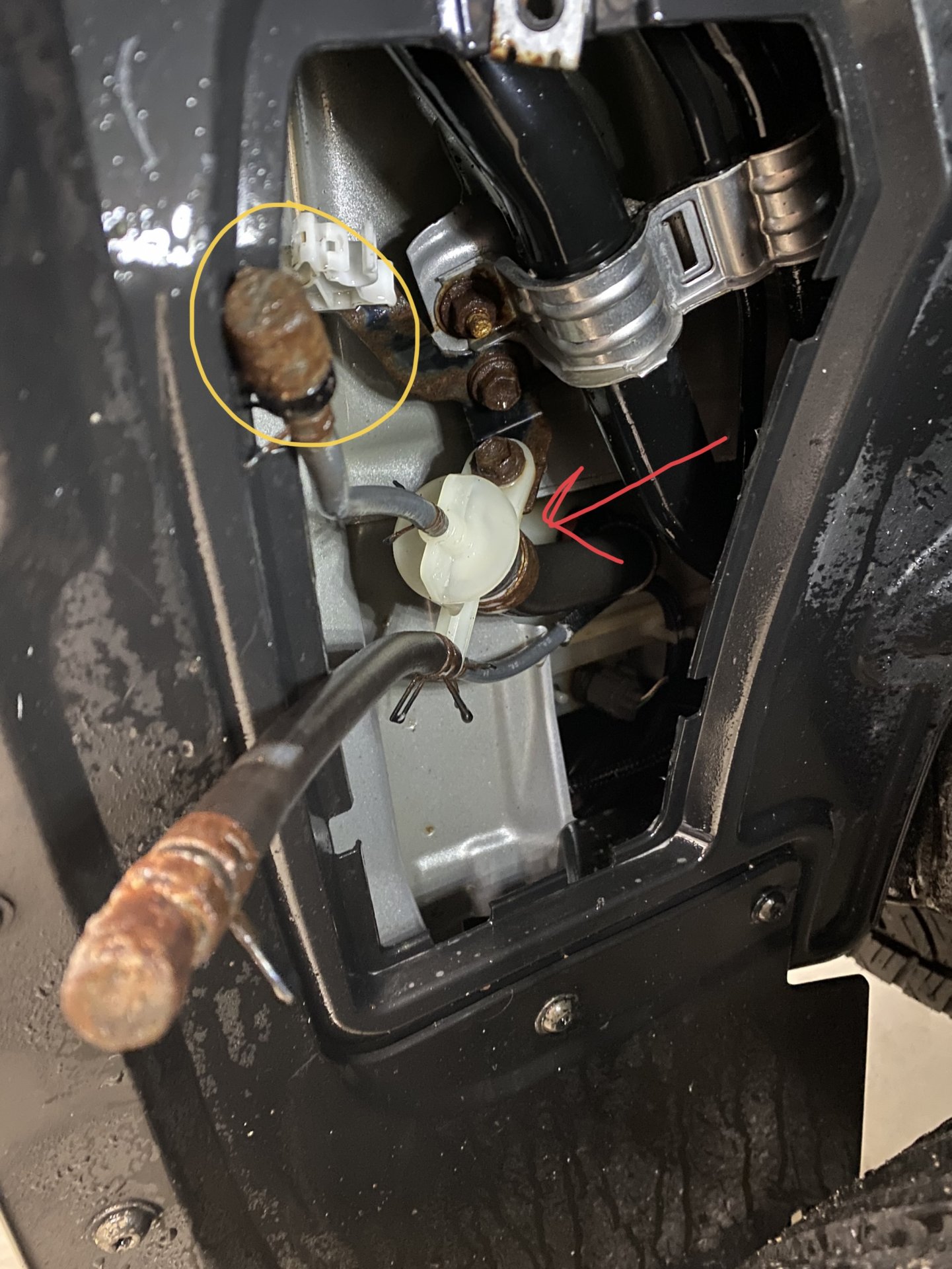

I’m prepping the vehicle for my AHC fluid drain/fill this weekend. I attached a pic of behind the right tire of the AHC filler/filter/reservoir. First question, to confirm, the red arrow is pointing at the filler neck filter, correct?
Second question, the tube I circled in yellow that seemingly connects directly to the filler filter, has anyone used this to refill the reservoir?
The area is wet because I was pre-cleaning it in preparation.

Red arrow points to the cap for the filler neck, there is a filter inside of there that I removed with needle nose pliers and a little reverse (outward) pressure. I believe the other part you are asking about is a breather/air relief vent thing. Sorry for the lack of proper nomenclature. I don’t know if you can fill through the part in question.
The white cap twists off with a quarter turn In 2 seconds and there is plenty of room to insert a tube into the filler neck. There is really no reason to mess with the breather tube. There is question lately on whether to remove the filter. If you don’t, filling will be very slow. It’s pretty slow without the filter in place. In light of the AHC fluid issues, My plan will be to pour the fluid into a container I can inspect before putting it into the reservoir.

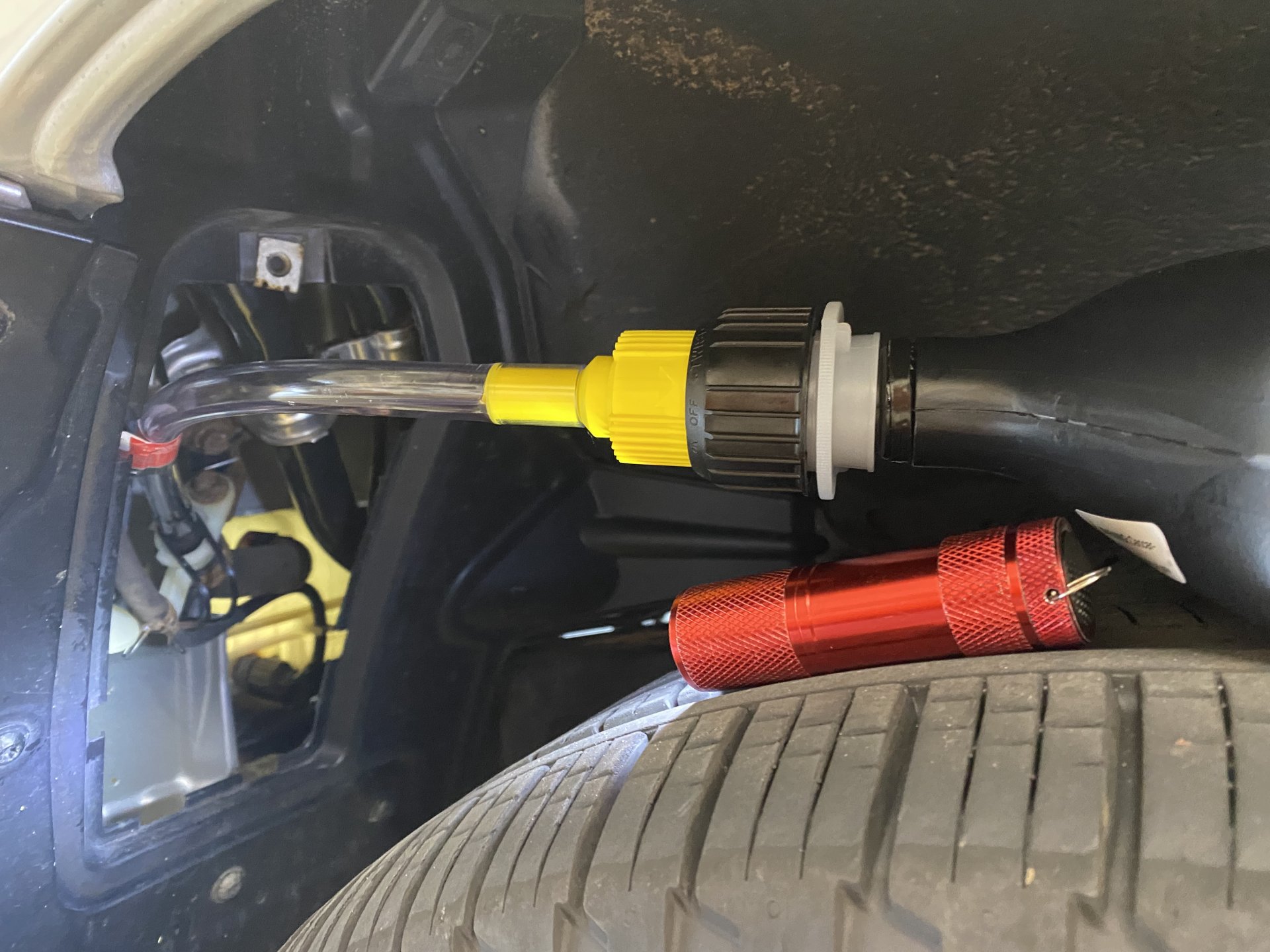

I bought one of these from Wally World.
Amazon product ASIN B000EH4UXM
Ok, so it sounds like those two hoses are breather hoses - good to know. I’ll leave them alone.
Does that Flo tool screw on to the top of the 1 liter AHC fluid bottles? If so, that looks like a life saver!

Yes it does, and has a valve to regulate flow, which you will need. I found you can lay the bottle on its side on top of the tire, and let it drain that way.

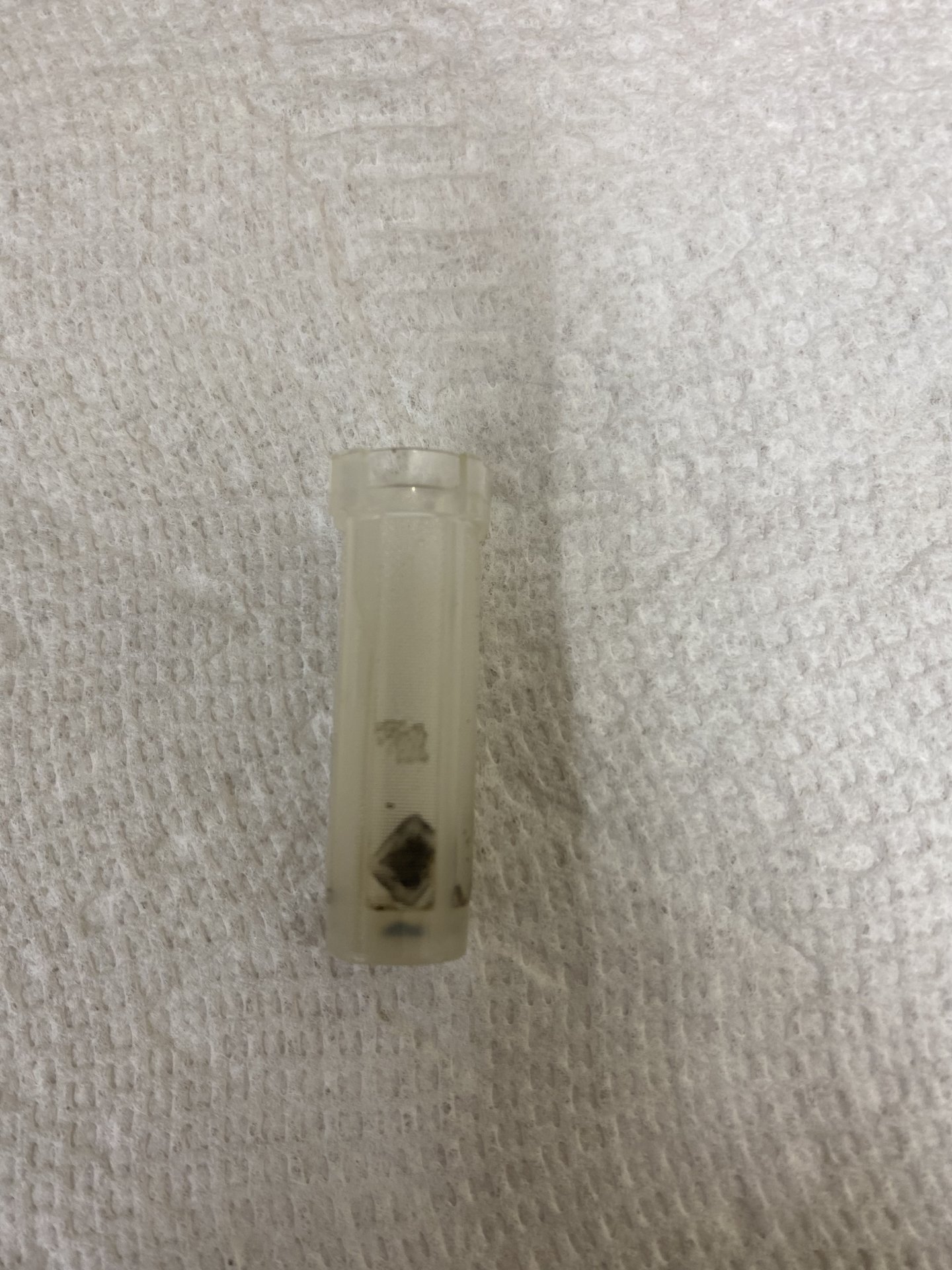

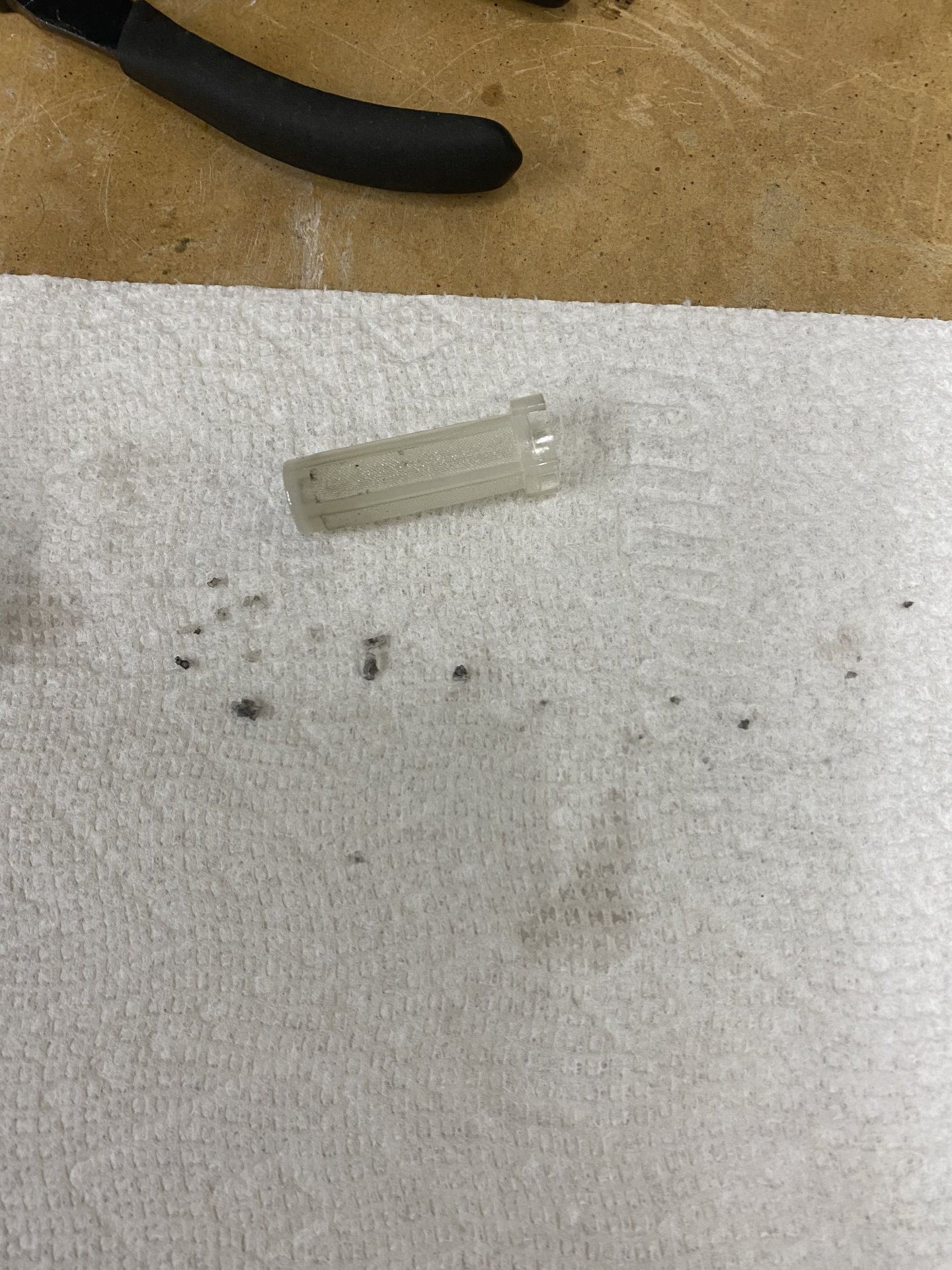

To continue my prep for the fluid change and familiarize myself, I pulled the filler filter just to see. There was something encrusted/hard sitting at the bottom of mine!
Needless to say, I carefully removed it and cleaned the entire filter before reinstalling. WTH, huh? I don’t have record of my fluid being changed before so not sure if this was been in there since 2013 or amassed over time?
I had similar stuff in the filter, considering I have an ‘08 I just assumed the filter was doing it’s job.

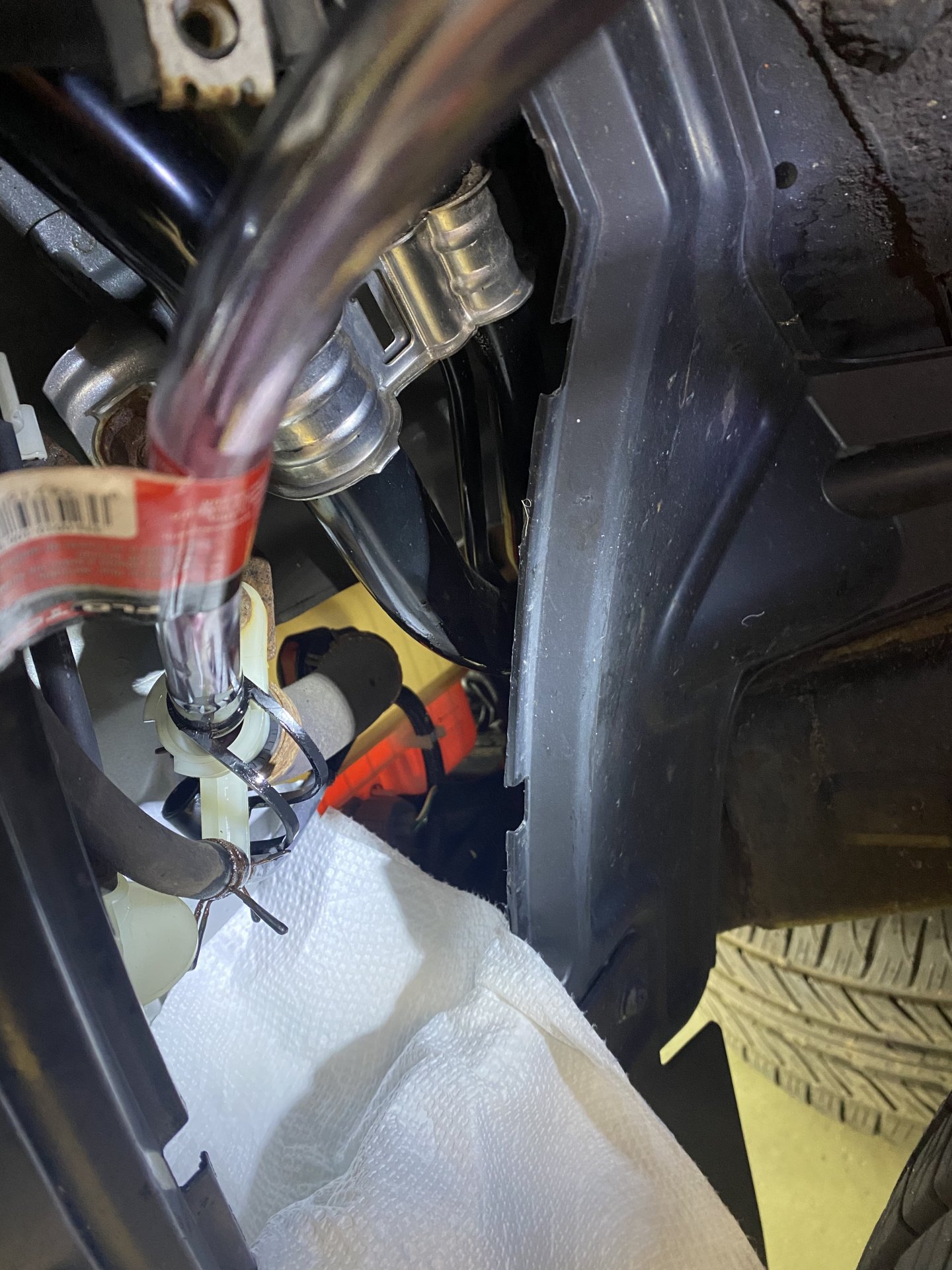

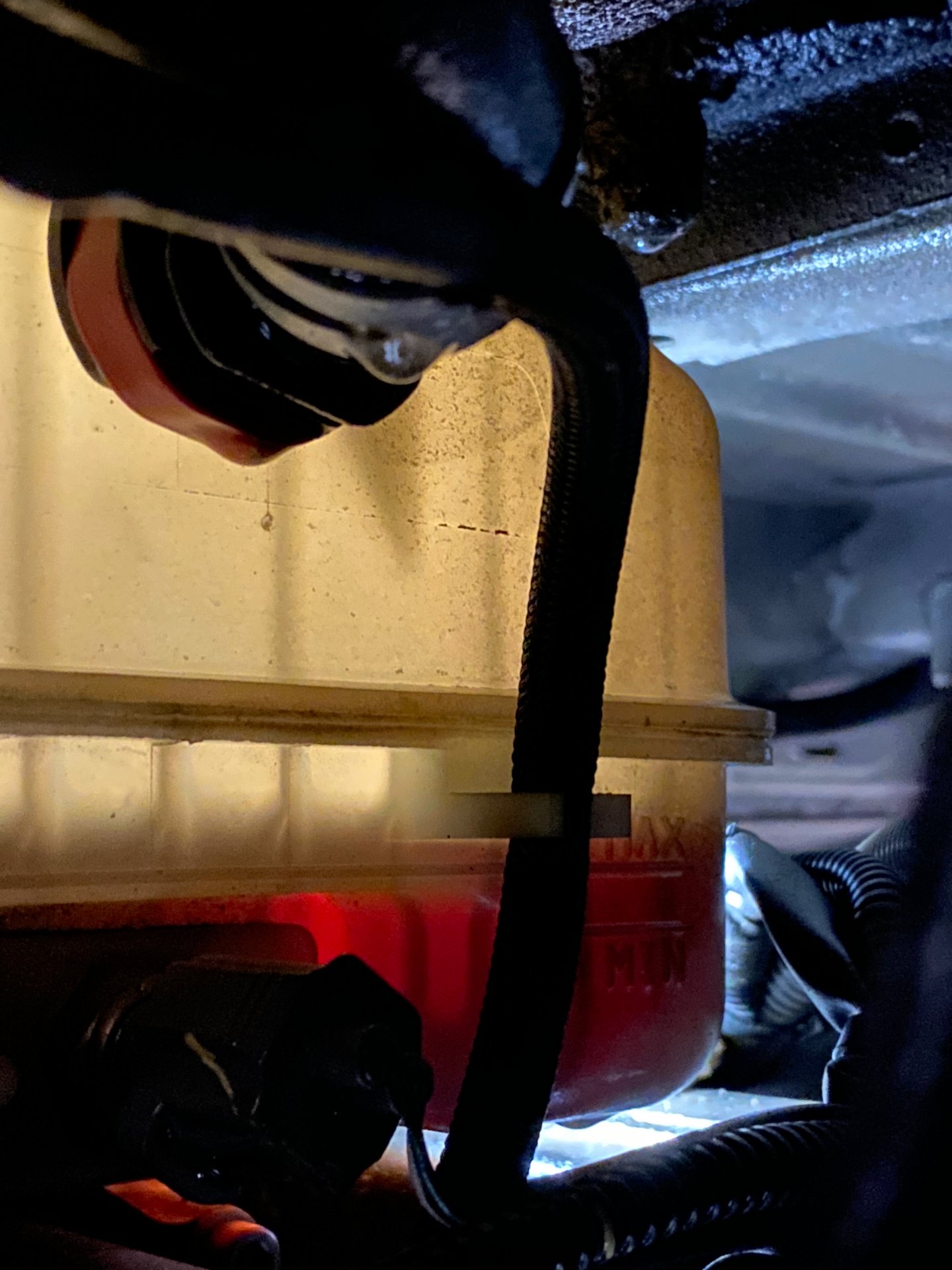

Next, I did remove most, but not all (didn’t want priming issues later), of old fluid from the reservoir with a hand pump. With the little hose included with the pump, I was able to snake it all the way down into it by twisting the hose at certain times.
Then, with the filler filter in place, I added about 1/2 quart of new fluid, stopped and pulled the filter and inspected for debris or white globs of stuff. Thankfully I found nothing and emptied the rest of the quart. This brought it OVER the max fill line by quite a bit which I was fine with. I knew after I was all done if it was over full, I could suction some out. I put the filler cap back on.
