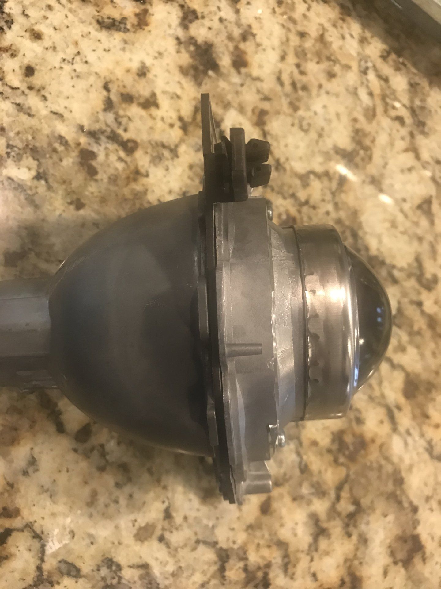

Do a complete retrofit. I've installed SC430 projectors in my truck and I can tell no aftermarket kit can hold a candle to it. If you can't find any SC projectors, any S2000 witha little modifications will look good

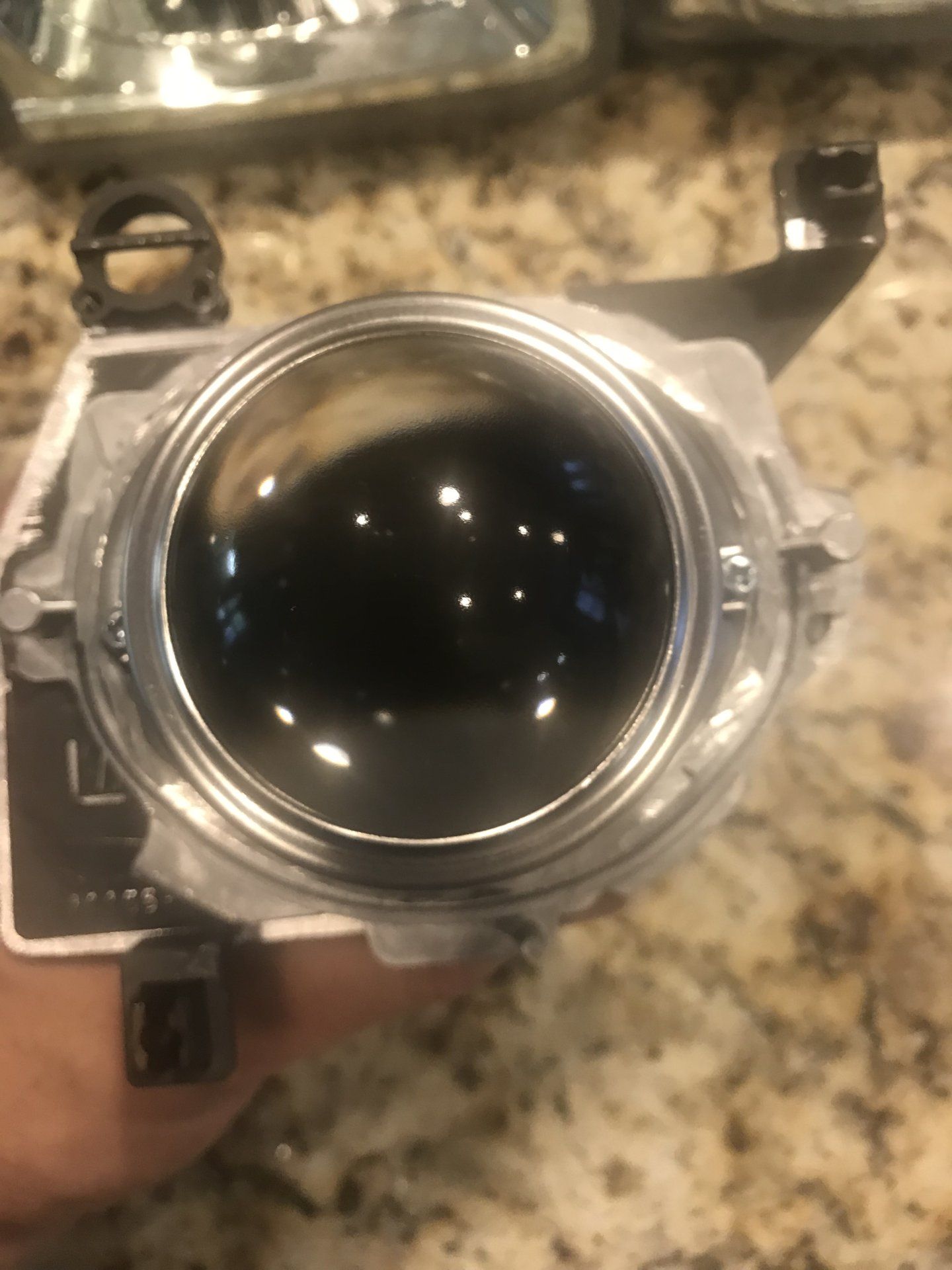

Guys the only thing you've gonna need for this retrofit is the SC430 projectors & a dremel. Nothing else. Just cut the ring that's on the projector so our bezel will flush, & on the bowls put a slit on one side of screw hole. The LX470 projectors are a one piece setup. Projector and bracket is one complete piece. Use your dremel to cut the projector off the bracket and try not to damage the bracket. Put the bracket in between the SC projector & bowl, screw it together and then you done. Put it all together. Repeat the process for the next light. Then enjoy having fun driving at night

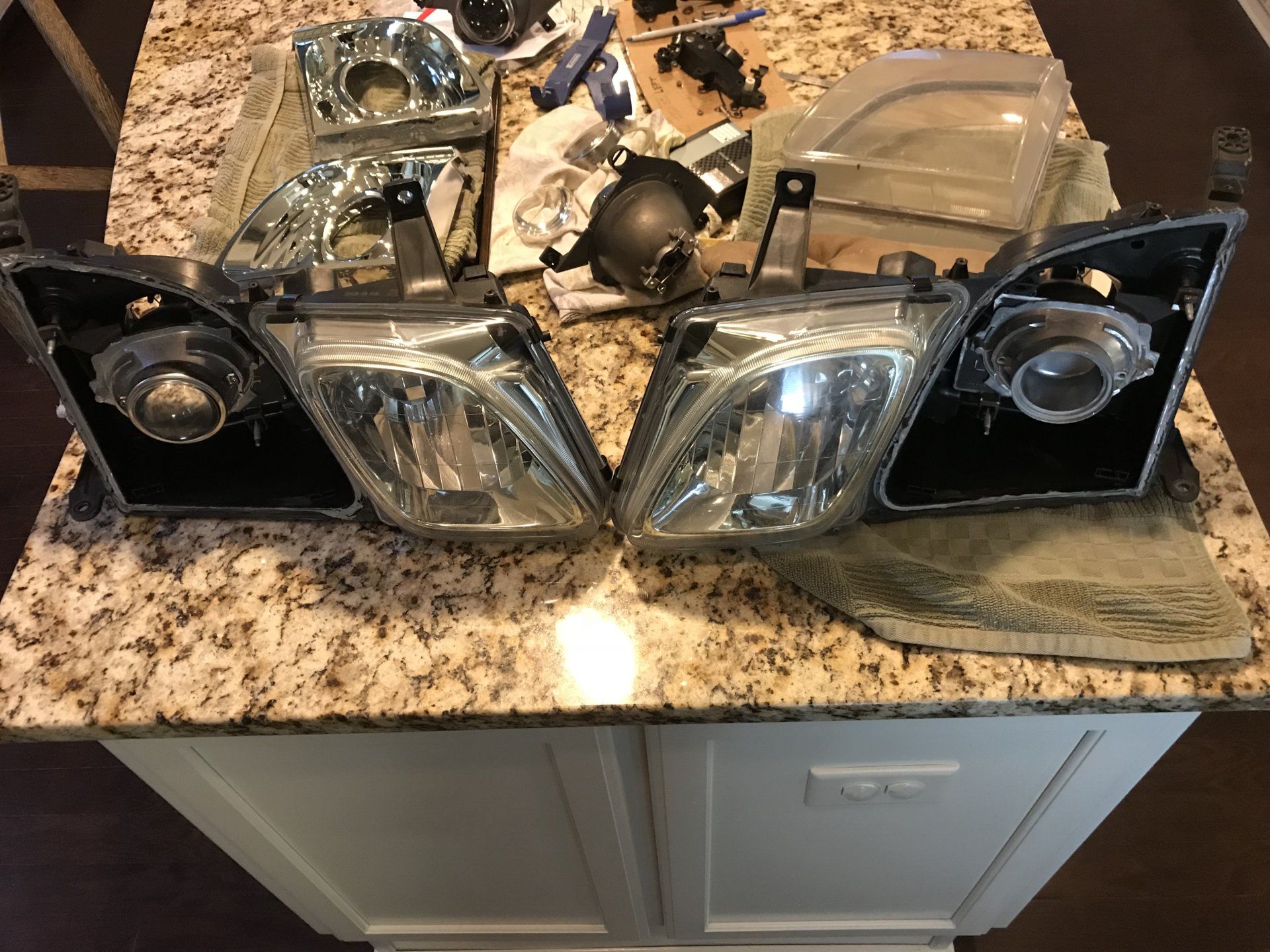

I got my "Eagle Eyes" headlights in and installed them. Thought about doing the SC projector mod, but both my headlights were already pretty wore out and the driver's side was cracked so I would have to replace it. Eagle Eyes lights were cheaper and easier so I gave them a shot and so far I'm pretty happy. I went ahead and changed out the standard bulbs it came with for HIDs. Unfortunately this means you have to disable the DRL because the HIDs won't work on the lower voltage. Right now I just have the angel eyes hooked up to come on with the brights, but I am going to make a relay to turn them on when the engine starts to act as DRL, or at least see what they look like. DRLs are good, I like them. Helps to keep people from turning in front of you and lets others know that the vehicle is running and might be moving soon.
Fit and finish is not perfect, but pretty good. I have not aimed the lights either, but I can already tell they are going to be good. Overall I think the lights look great on the vehicle and resemble something that Lexus might have put on themselves.
