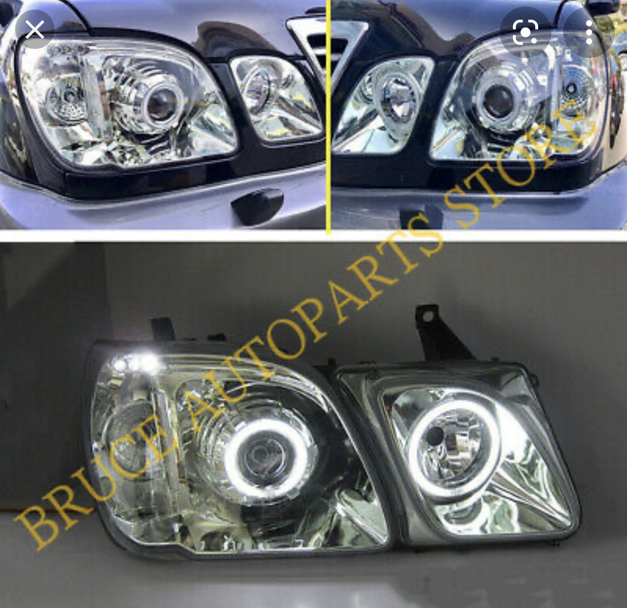

Any tips or tricks on the install? Where do the red/black wires connect?
Red and black are the power connections for the DRL halo rings. you can connect them to a 12v circuit that is live when the engine is running. NOTE: don't connect it to the actual DRL output because the voltage is too low and it will not work. I decided I didn't like the "angel eyes" at all so I just wired them to come on with the brights only.

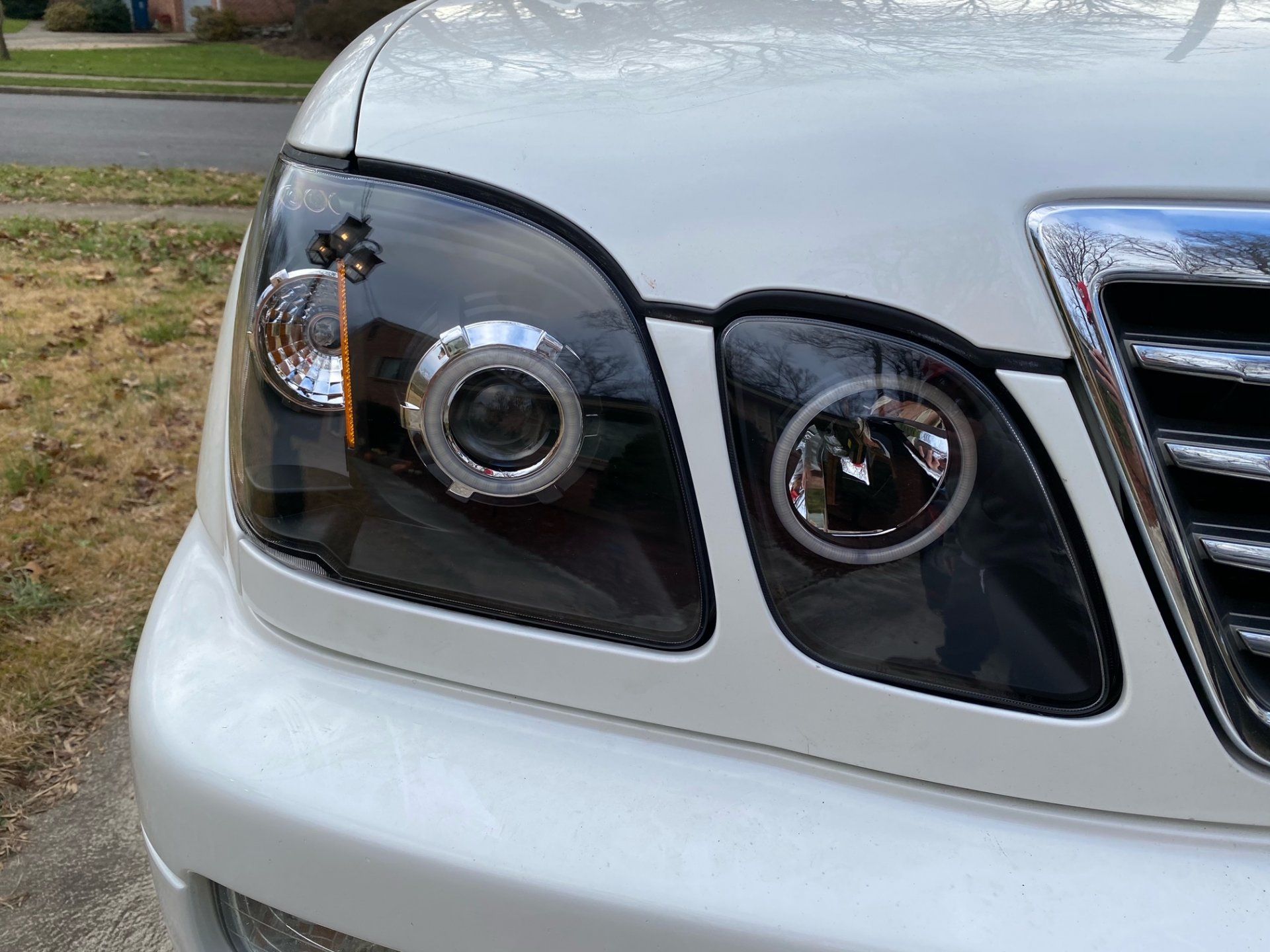

I've been happy with mine. They are about 2 years old and still holding up. Definitely not OEM quality, typical chinese, but they get the job done and still look good but they are starting to become slightly cloudy.
These look great. Hard to tell if that kit includes the lenses/covers? Mine are cracked and yellowish and I'm not really sure what my move is there.
EDIT: I see in the description that kit includes "clear lenses". Was install pretty straightforward? Thx

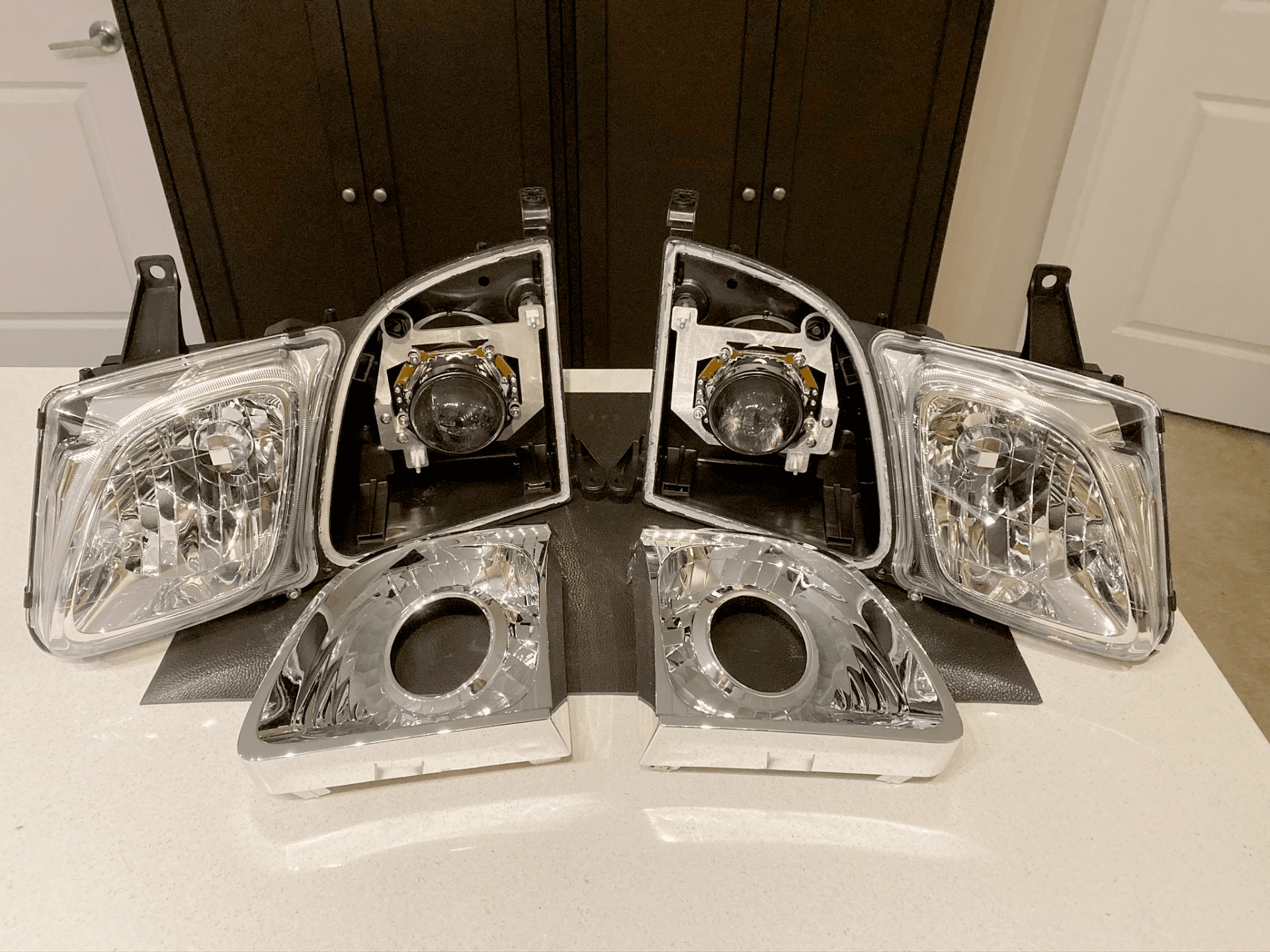

Save your money and buy NEW OEM... either Poly Carbonate or the early model Glass.. both are still available .My 2006 lights which where Poly had not started to fade but they did have small spider cracks. To date I've retrofitted 30 plus LX lights but i only work with new housings but I've sold 30plus brackets to those wiling to DIY their current lights

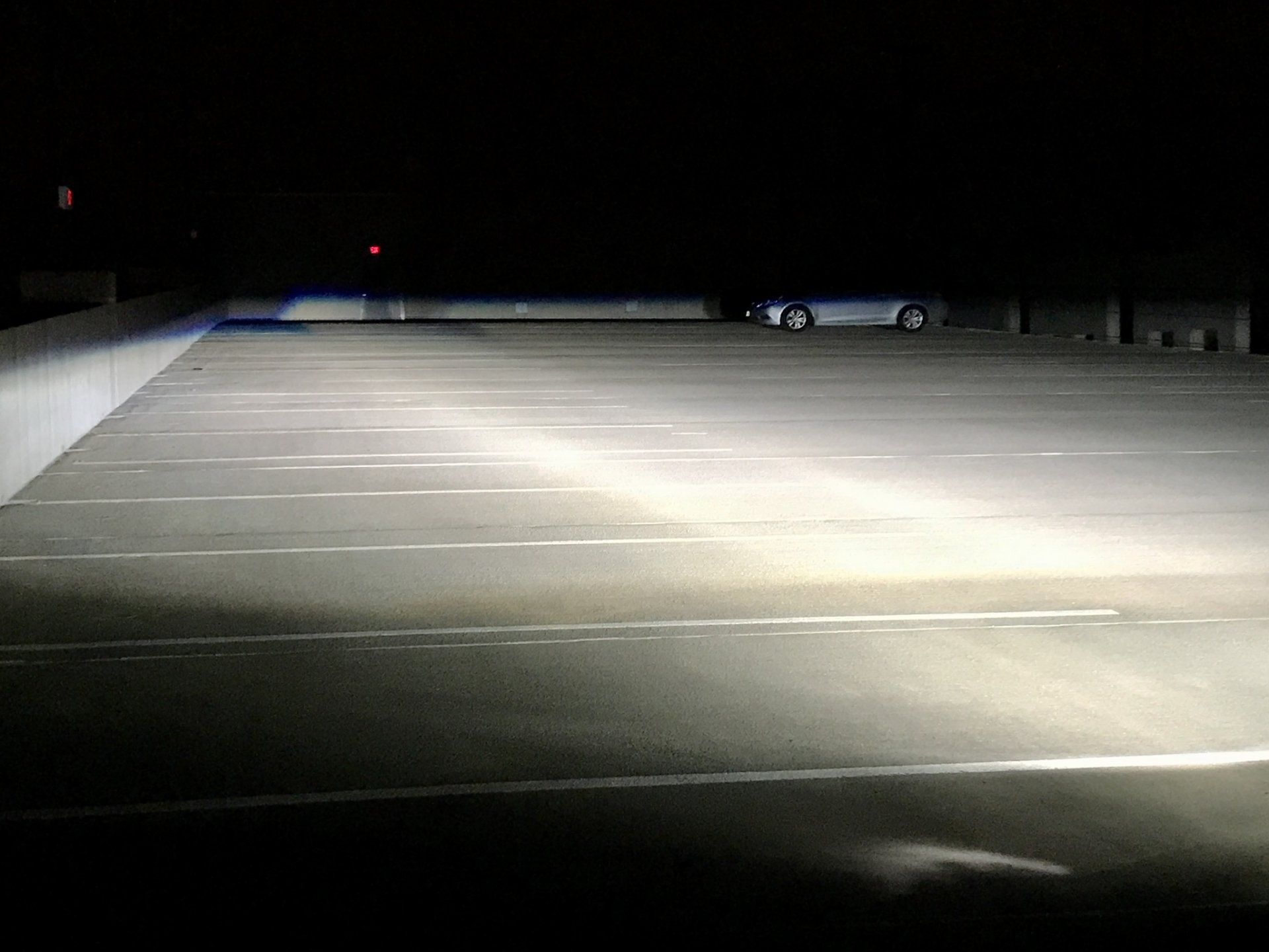

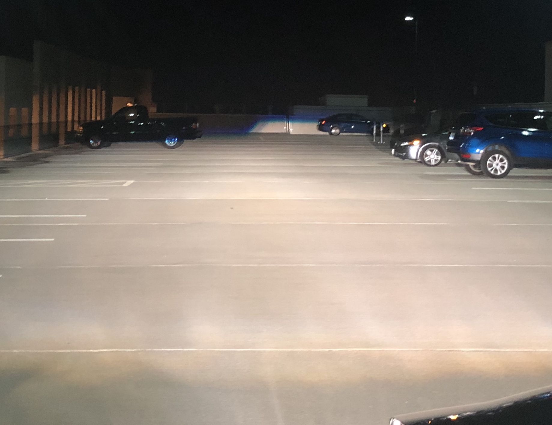

The plug and play versions are retrofitted with the Morimoto D2S 5.0 which has a very impressive output and they are bi-xenon... so they also fire as a high beams . To those who think the LX factory lights are great...the first shot are stock low beam ..the second are the lights I build..The shots where sent to me by a client
If you need new lights and you want your truck to look cool by the cheap halos but if you're looking for amazing output retrofitting an HID is the only great option at this time
@silverbullitt started me down this path a few years ago as he's local ...but i was looking for a easier way to mount projectors so I designed and developed the bracket to simplify the process

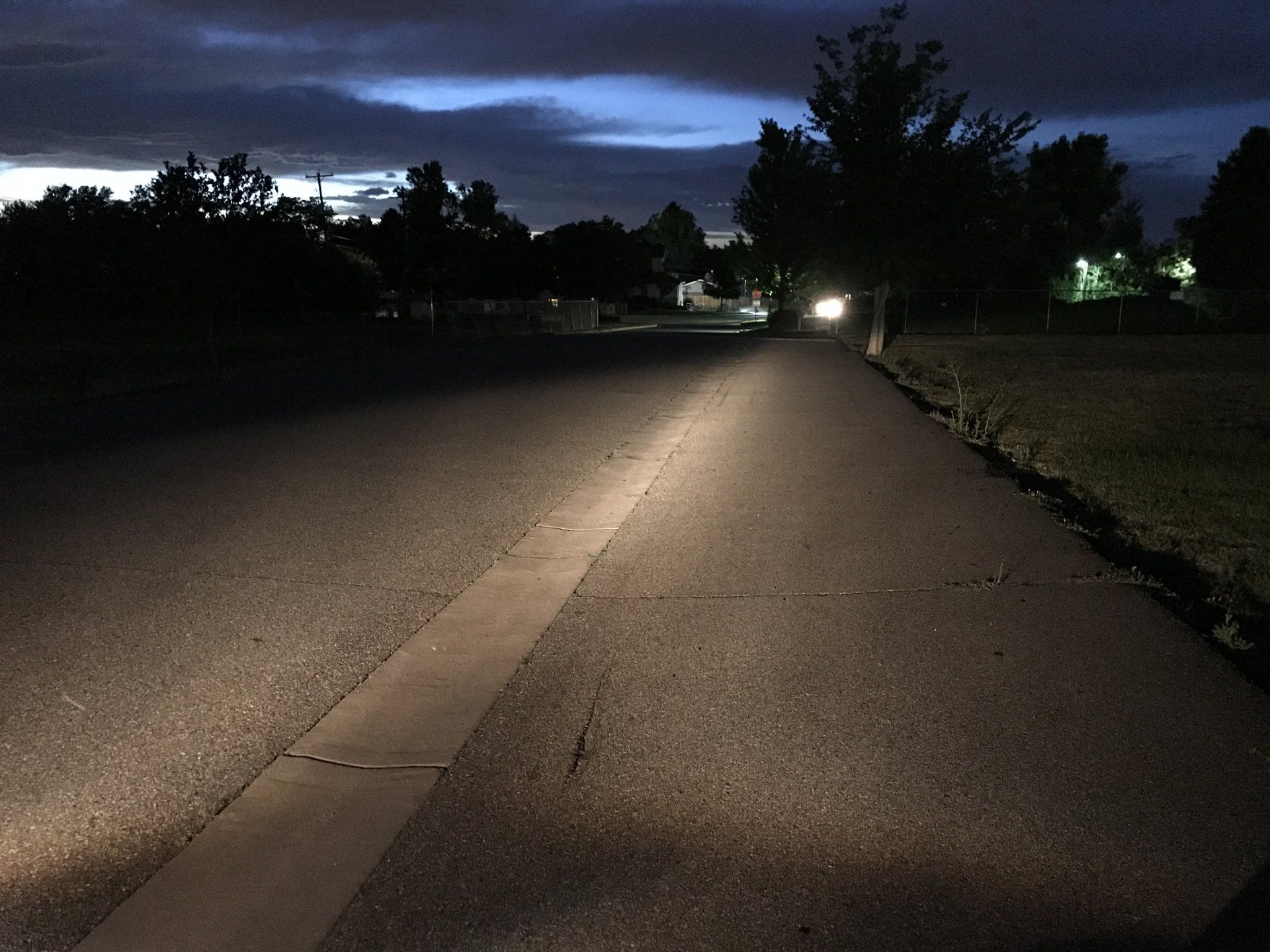

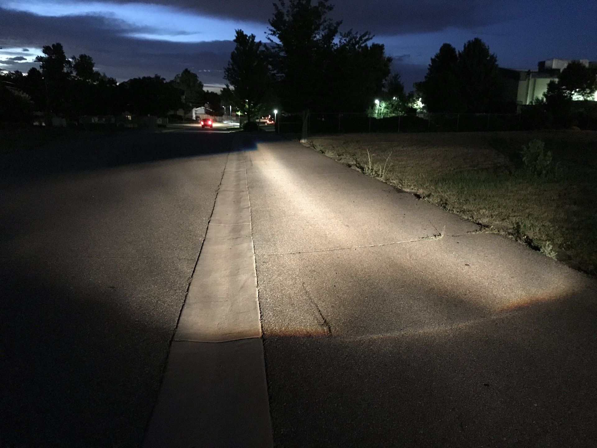

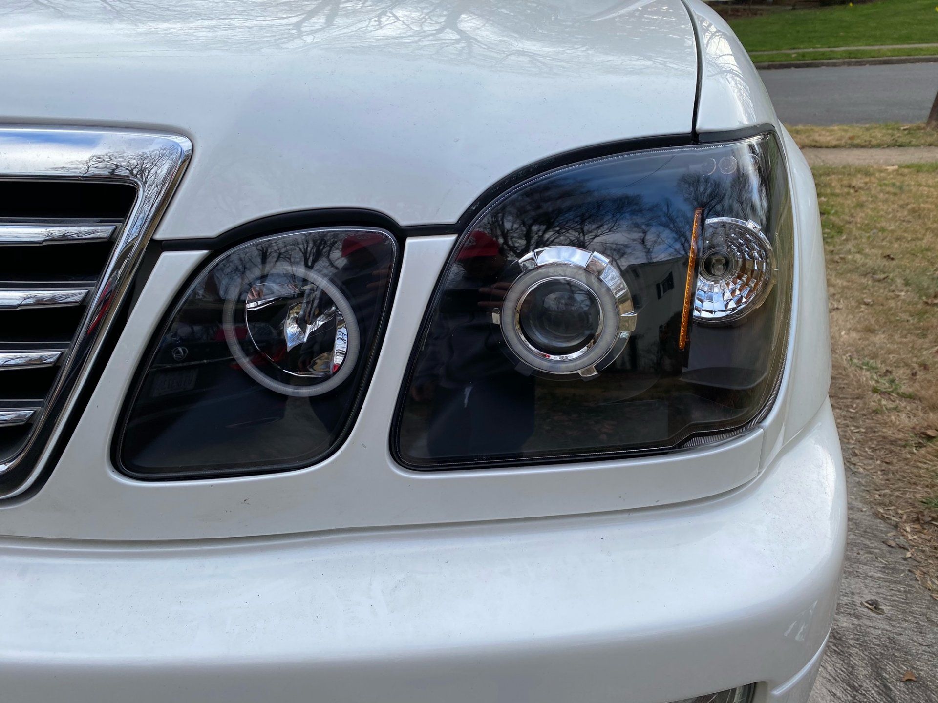

I found a photo I took mid install as I wanted to see the difference. This first photo is stock light drivers side. Second photo is the cheap Amazon light. I’m covering the other light in each photo.
I’m pleased with the difference. Long term I will convert the stock lights using what I’ve learned here on mud.

Is the second picture also the drivers side?
If so you’re better off with stock headlights.. better distance and better width

No second pic is the passenger side, I'm covering the driver side. I hadn't at this point done any aiming. I have raised them so they throw a bit farther. I lost a loose side light wheeling in the spring. Decided to give these a try so that im not time constrained when doing the conversion.
No idea when I will get to that. When I do Ill post up another compare.
I do agree the HID retrofit with the glass lens is the best long term.
That said the cheap lights are a nice affordable alternative.

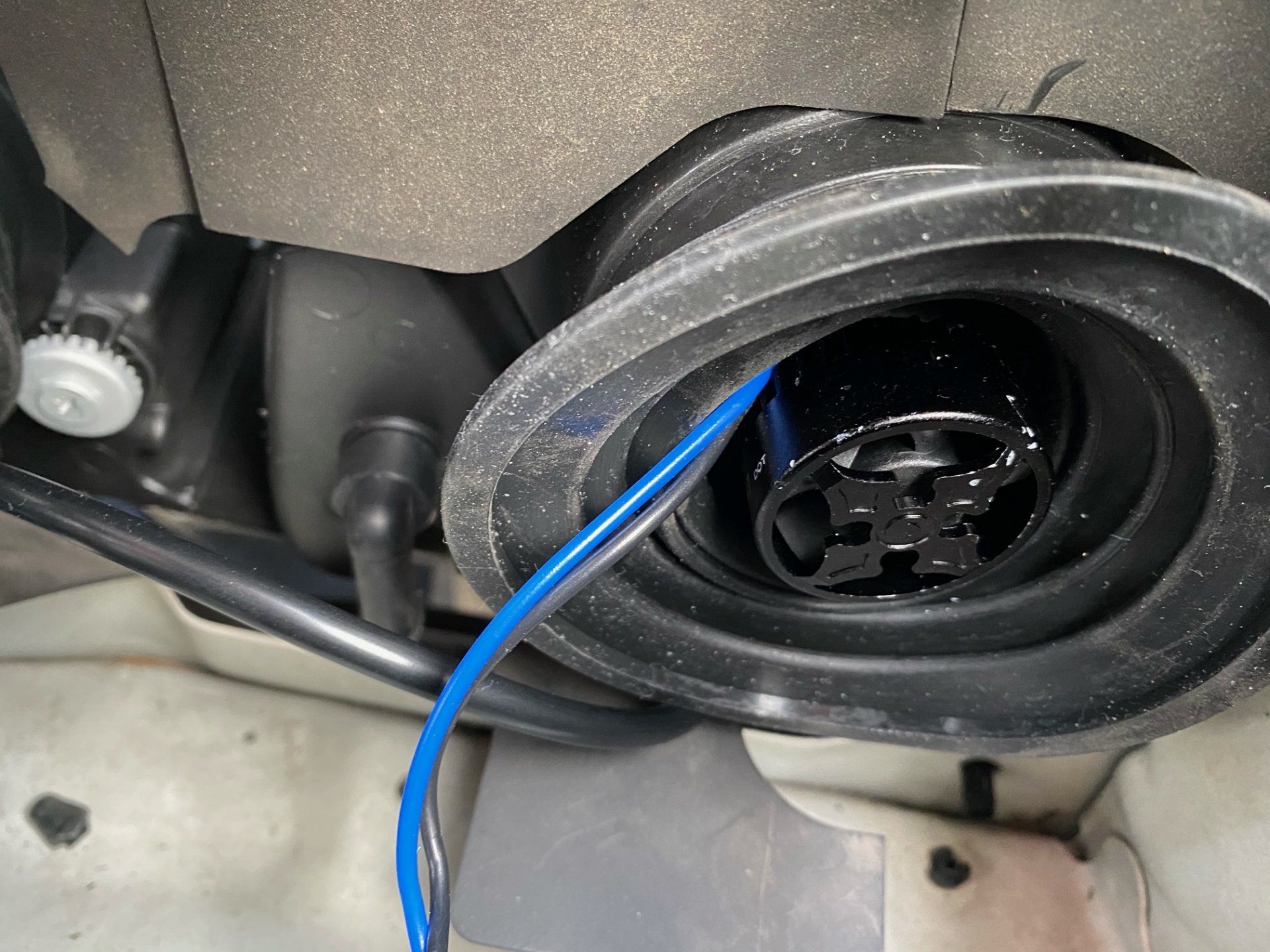

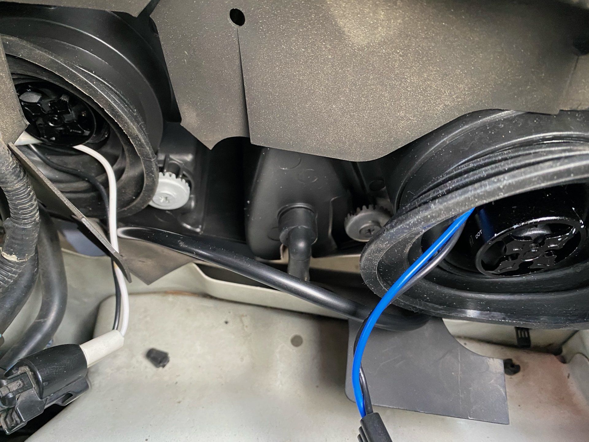

I just did the aftermarket headlight replacement with LEDs both H1 high beams and H7 low beams. Will post light output when I get a chance at night. As for the LED cooling, I found some Amazon LED specific dust covers and I think they will cool them just fine. See pics.
Amazon LED dust covers are here: Amazon product ASIN B076Q9D52Z
