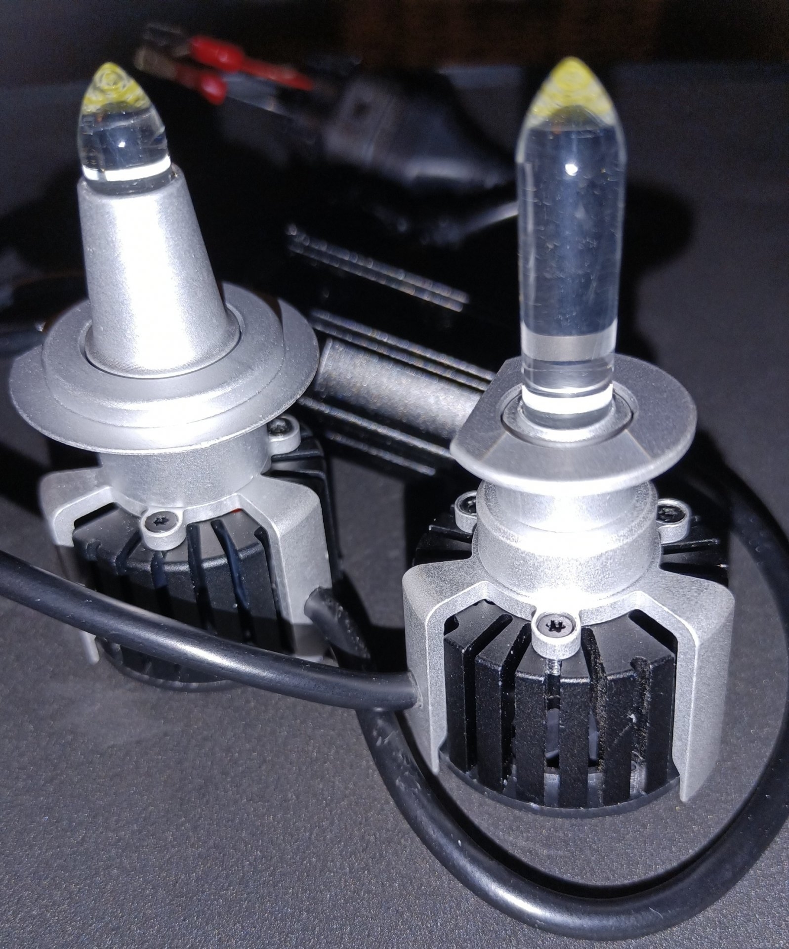

Just received new style LED's H1&H7 to replace halogens that come with my Eagle Eye aftermarket headlights. Anybody else seen or used these?
