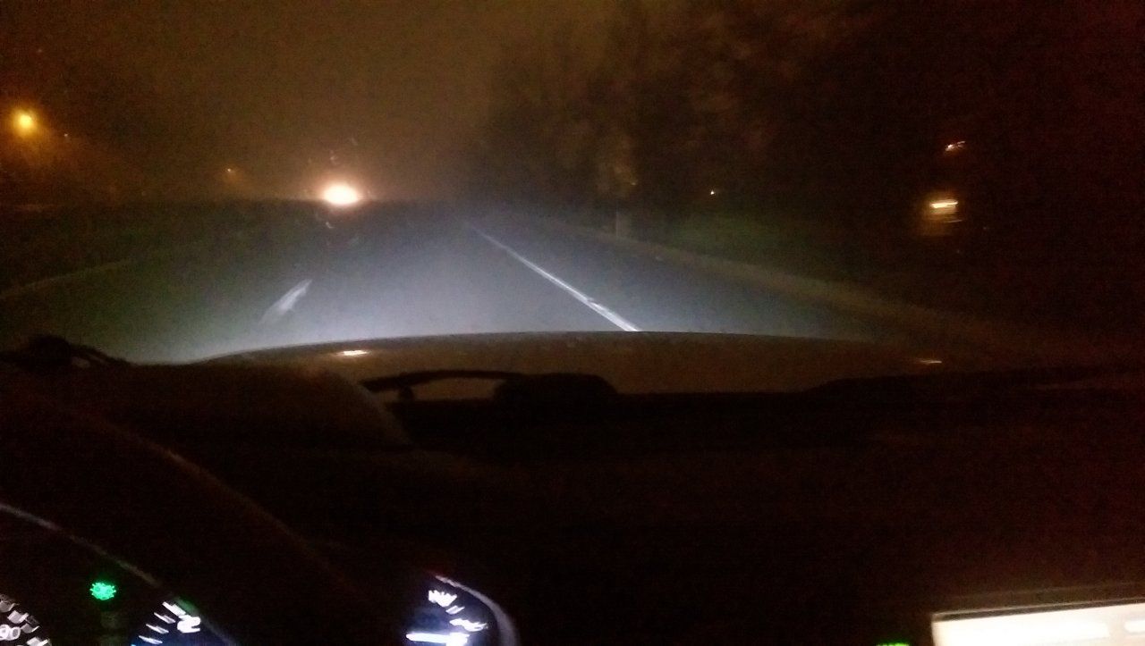

My 03 LX I retrofitted with with SC430 projectors will outperform most vehicles out here today. I'm on par or equal to the headlight output performance as the Honda S2000. & have no problem driving in any weather. Even rain. This a pic I'm driving thru fog and I cut thru it like it was nothing
May I ask why you chose SC430 projectors over 04-06 LS430 projectors? The LS projectors have been praised for a long time as one of the best projectors ever made. It's a very common retrofit into virtually any headlight that you can fit it into like the 2nd gen Lexus GS for example.
To answer your question. The SC projectors are almost identical to the LX. So The MOD was very easy to do. The LS projectors are to big and wouldn't fit in my LX. But I do have some in my 98 GS. Now this is a crazy wide output. Here's my GS:
