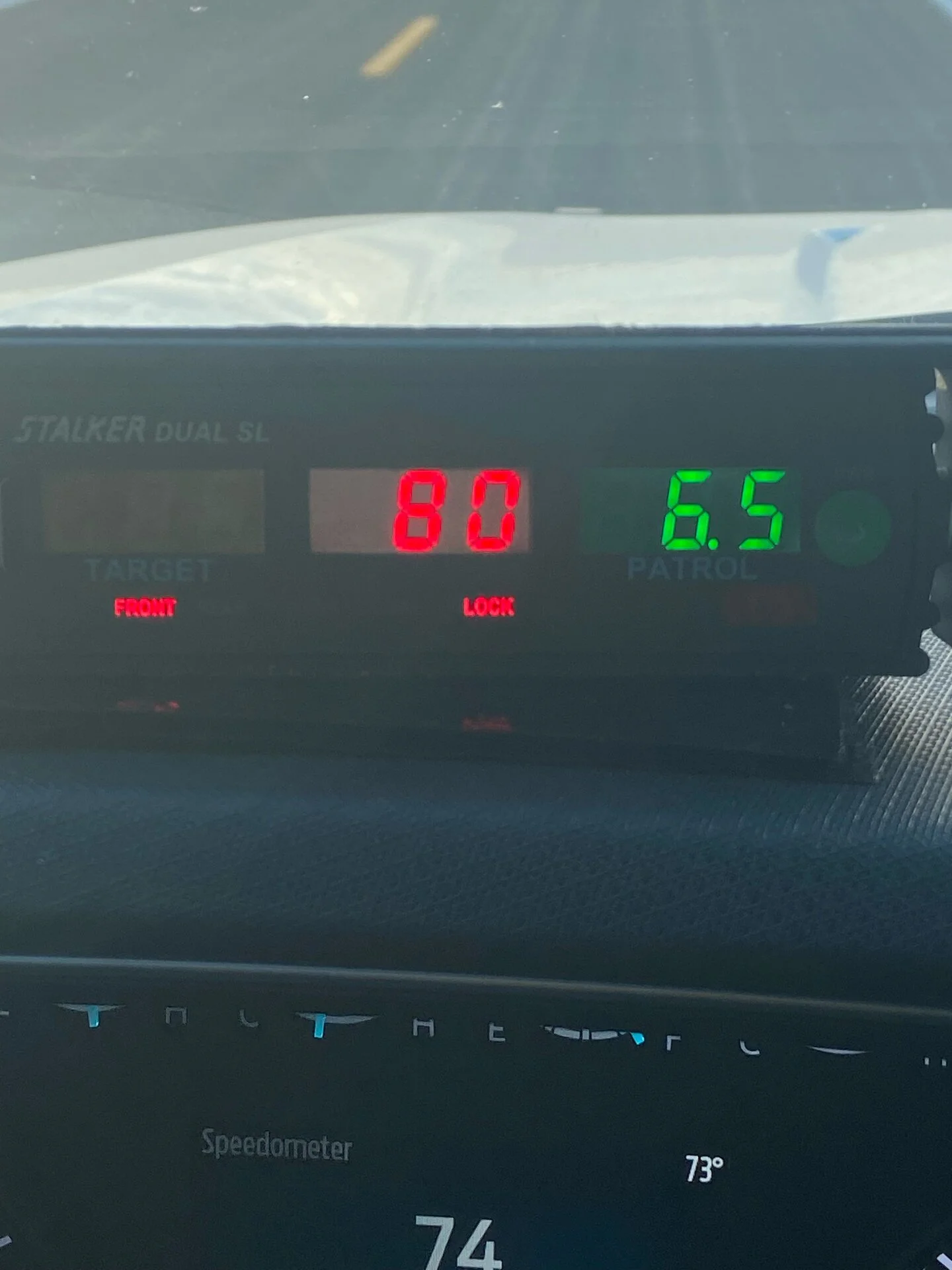

Wednesday: I get this picture from a police friend that passed me. Thankfully, no ticket, but I took it as a friendly warning. I didn’t think my speedo was off that much. Ordered this unit when I got home that afternoon.
Monday: Unit arrives on lunch break. Took literally less than 10 minutes to install it and calibrate it. Fantastic product, thanks @Lutz Auto
