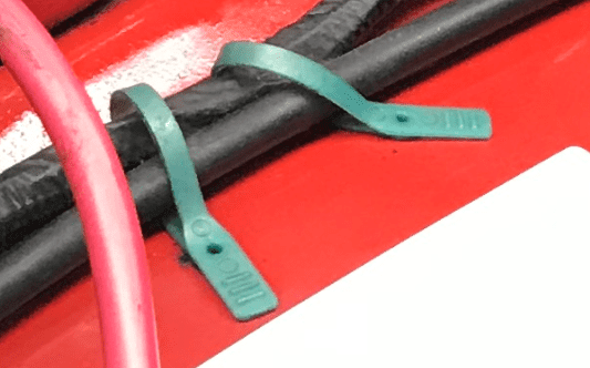

Also, Anyone know where to find these factory green wire straps?
@RodrigzCrzr Perfect! and thank you for the compliment and the source for the straps! (Throwing the link up there for my reference later on, and if anyone else needs them).

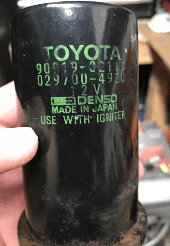

I was cleaning up my coil/igniter last night. Not sure if I should replace the coil. What are your guys thoughts? It worked fine before I tore the engine apart last year, but it's pretty rusty on the top. Should I just wire wheel the rust and call it good until it goes out? I'd hate for it to go out when I'm out in the middle of nowhere. A new one from Toyota is about $65, or Rock Auto has aftermarket for $25-35. I'm hesitant on the aftermarket just based on the reliability of the Denso coil.

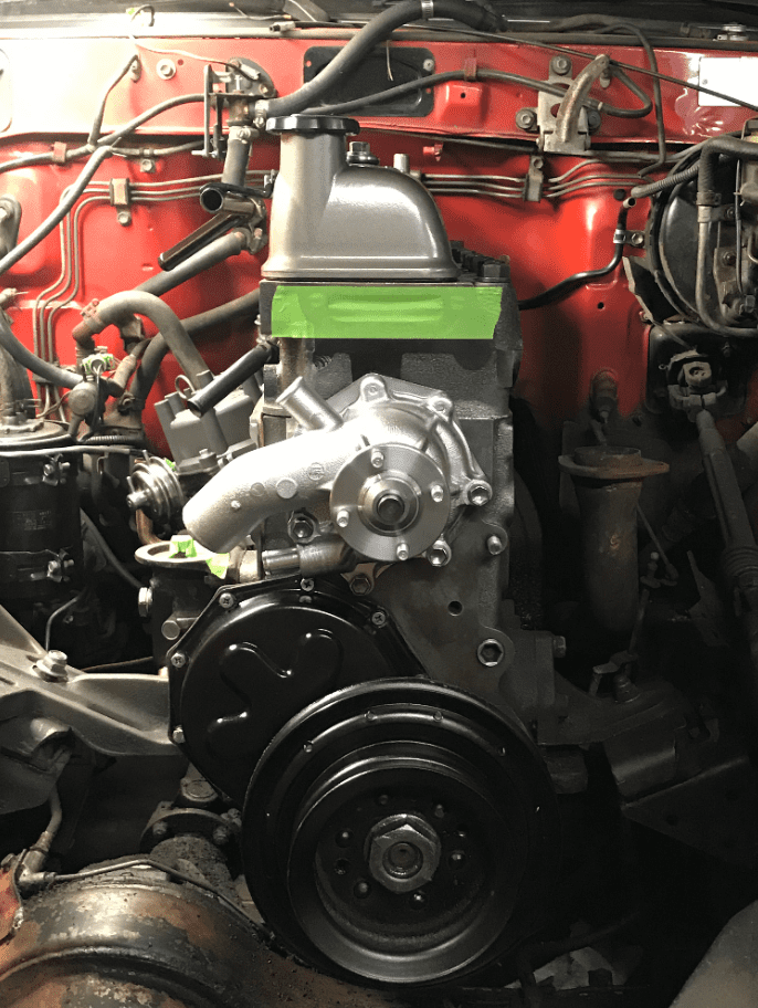

When I installed the crank pulley oil in the timing cover, I was using my seal installer, and somehow the garter spring fell out and got pinched between the seal and the cover and messed it all up. I put it back in place and for a quick second thought about just "letting it ride", because it went back in and I really had ambitions of getting the timing cover back on, but decided it's not worth having the potential oil leak, which would most likely happen. So I pulled it off and ordered a new oil seal. Should get here Saturday. Then more progress!
Got the new seal, and got the timing cover and crank pulley back on. Also installed a shiny new water pump. Things are starting to go back on! Progress!
