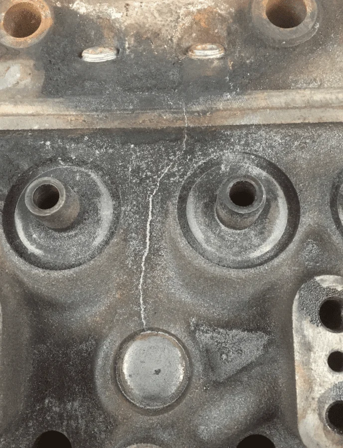

I picked up the cracked head this morning... Pretty good sized crack leading to the freeze plug, which is why my machinist told me it wasn't fixable. I've heard of some specialty machine shops able to weld these. They heat the block up to extreme heat, which melts the freeze plugs out, stitch weld the crack, and fill the freeze plugs with a threaded plug. Not sure about this though. Anyone have experience with this? More trouble than it's worth? Just find a used one?
1945119
I wouldn't try and fix that, source a replacement.
Ouch that looks like a big crack. If you're not in a big hurry we could maybe work out some kind of head relay to get that head from Helena to CDA. Also I would let Paul take the head to his machine shop if possible. They do a great job on these, having done so many for him.
Current plan is to get one from TorFab, he has a number of them for $300 that all test good. Still need rebuilds though. And I may have just found a local one 10min North of me in Hayden, Idaho for the same price.

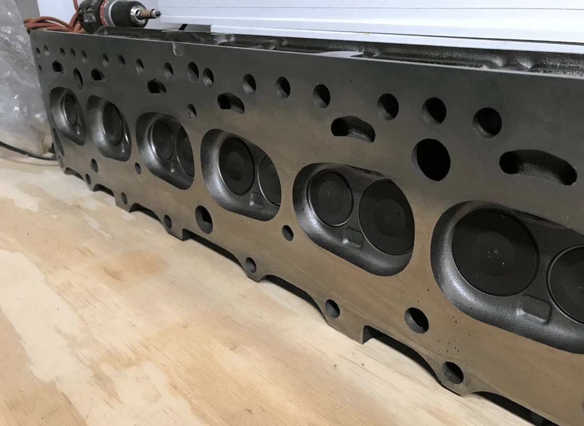

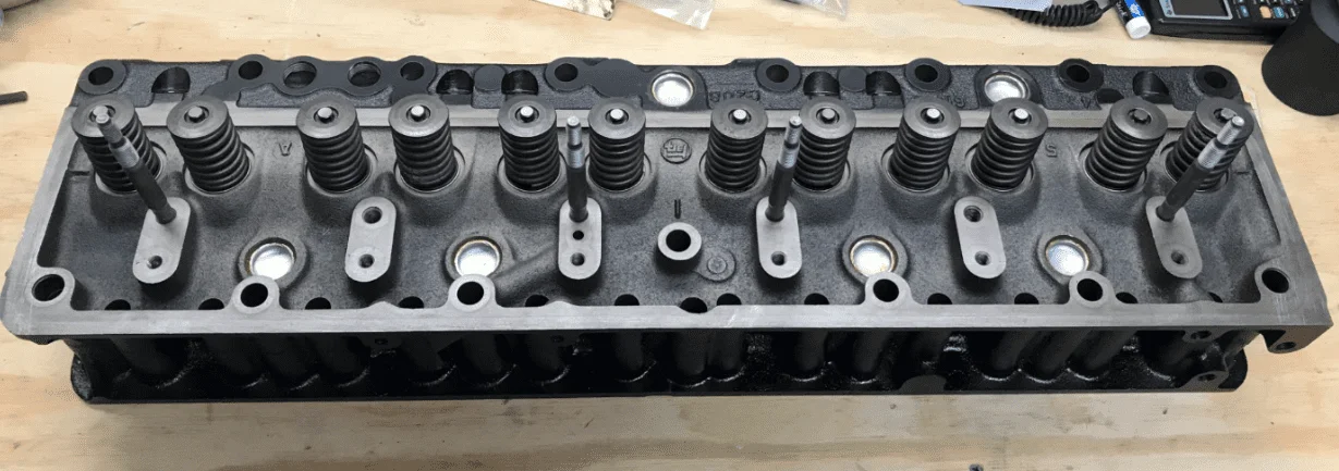

When I left off, I was in search of a new head, because mine was cracked pretty bad (unrepairable). I had a line on one from Torfab that I was getting ready to go over and buy, but then I was contacted by @Perovich, who is local to me, who said he had a good one. I asked him how much he wanted, and the stand up guy he is, he said he had no use for it, and gave it to me! I'm still in shock! I took it down to Spokane Cylinder Head service and had them check it all out and rebuild it. They said it was in excellent condition.
Here it is back from the shop.

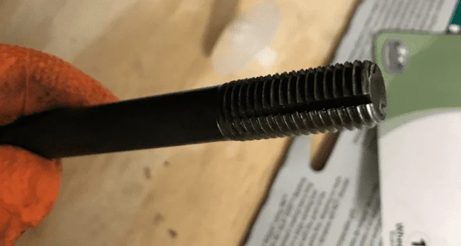

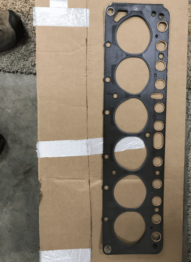

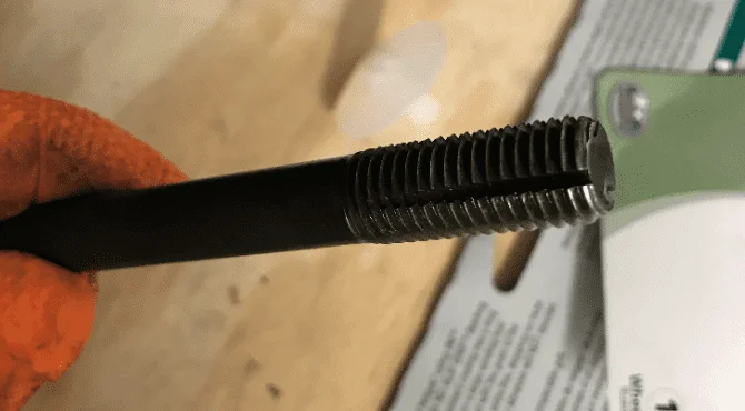

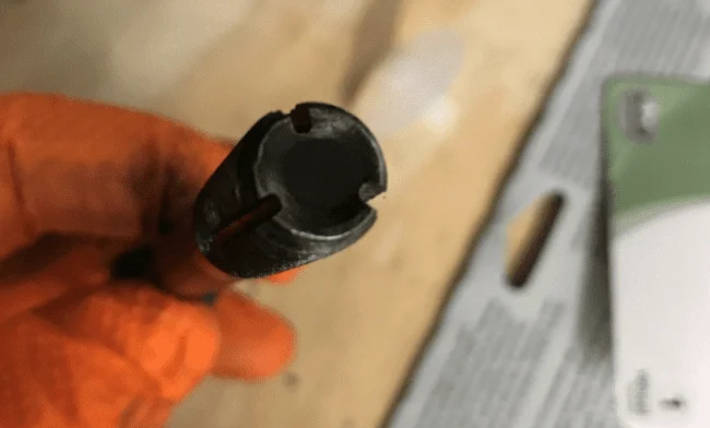

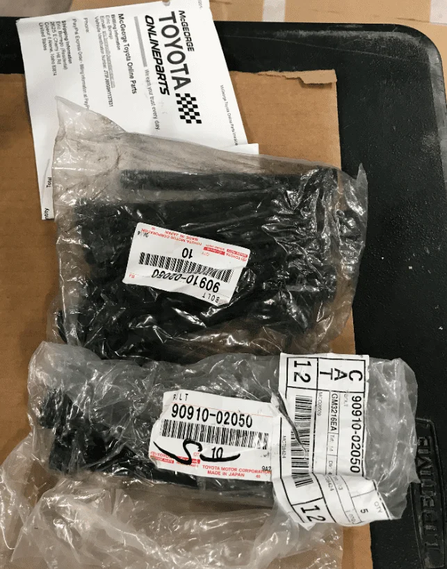

Before I installed the new head, when I cleaned the surface of the block, I also cleaned the head bolt threads. I have all new head bolts, so I took one of the old head bolts, put it in the vice and got out the angle grinder to make a few marks in the bolt to catch the crap stuck in the threads. Worked like a charm. I couldn't believe all the stuff that came out of it.
New Head Bolts:
New Toyota Headgasket:
Homemade Head Bolt thread chaser:

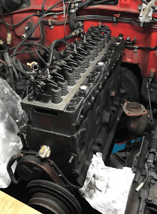

I installed the head, they are so heavy! Luckily I'm 6-1 270 and am able to manhandle it... HAHA. I carefully lowered it onto the gasket and torqued it all down in the pattern from the FSM. I wasn't about to mess with getting my torque wrench in the back to install the hook, so I got some spacers.
I installed the push rods in the order I took them out. But before I torque down the rocker assembly, I wanted to check the lifter valves. So, I put the valve cover on the head to keep everything clean, then started removing everything off the passenger side of the block to get at the inspection plate. I got it off and checked the lifter valves. I have read that a good bit of varnish can build up on the bottom of the lifters and make them very difficult to get out. I was expecting to have to struggle to get them out, but they came out with ease and looked pretty good for the amount of miles the bottom end has on it.
