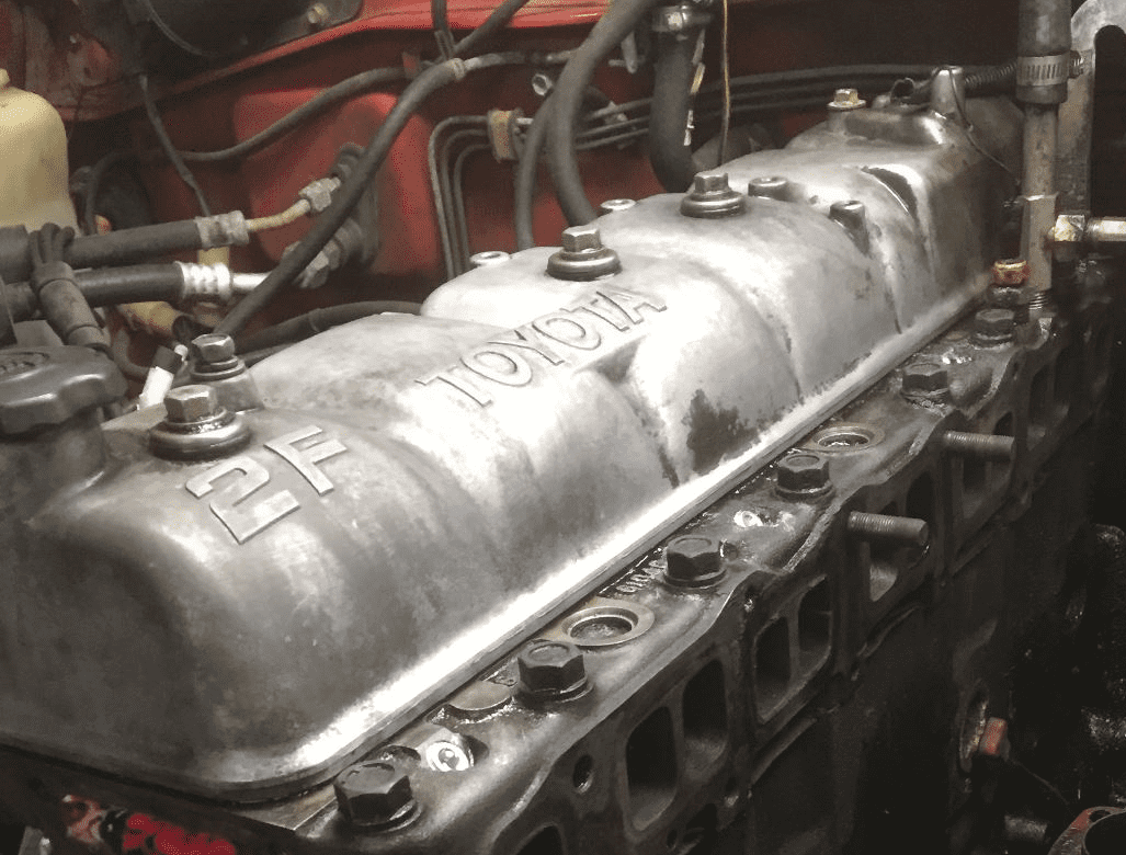

Last night I picked up a cleaning pad for my angle grinder. It made quick work of a few things! I don't have a pic of the valve cover before, but after 15-20min on it, it's very shiny metal! It's going to get painted with VHT SP205 to try to match the factory color, along with a clear coat. The hard water lines are getting painted black.
Before:
After:
That angle grinder disc pad is my new best friend for cleaning!

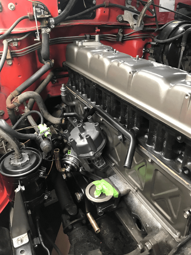

Got some work in over the weekend.
I tackled the passenger side of the block. Removed everything that had been leaking (dizzy, oil cooler, oil filter bracket, etc... what a mess! But I'm getting things cleaned up!
Before:
After:
I still have a lot of scrubbing to do, but it's turning out alright. I need to order up all the gaskets and metal rings to get everything bolted back on. I figure I'll clean the oil pan when I remove it to change the gasket.

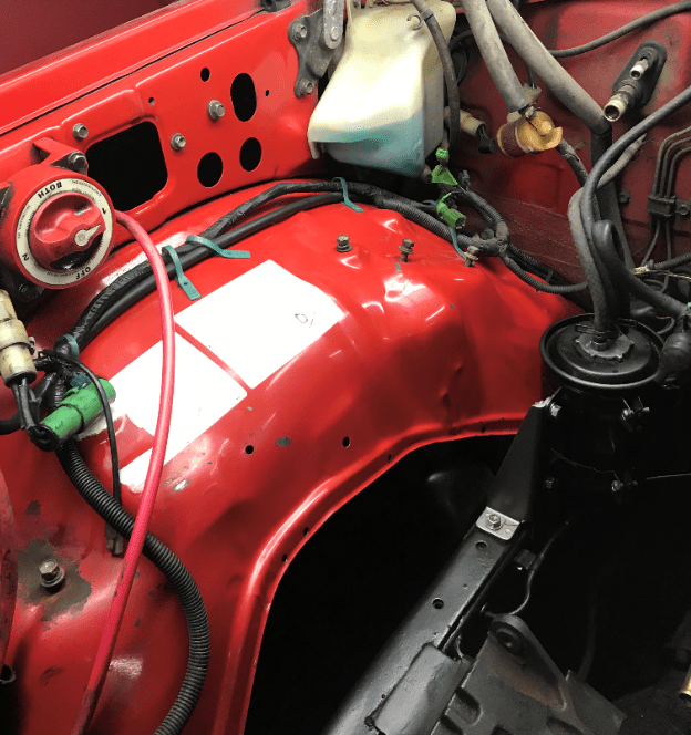

I did some work over the weekend, cleaning the passenger side frame rail, charcoal canister area, misc. brackets and fender. Still a lot to do, but what I did do, turned out great, in my opinion. I need to clean all the crap and gunk that's fallen on the diff from all my scrubbing... I'm tired of seeing it look so nasty in my pictures. I'm surprised how clean the original inner fender paint still is!
Got to work on things a little over the holidays. More cleaning, refurbishing and finally putting a few things back together.
Installed the push rod side cover with an OEM cork gasket, installed the charcoal canister and hoses, installed the oil cooler bracket and oil cooler with new OEM gaskets and rings, cleaned up the distributor, put on a new OEM cap and rotor (the new toyota rotors are gray instead of the burnt orange color), and a new o-ring gasket, and did some general cleaning all around. Pulled the coil and igniter to clean up and a few other brackets. Will have them back on soon.
