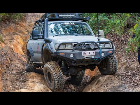

I guess this is kind of a science project... Looking at the design of the superflex arms, I believe that they flex much better than the Delta arms, do to the leverage that can be applied to the bushings at the closer distance. I originally grabbed some arms with caster built in. But, that meant I had to remove my LandTank caster brackets to reweld the brackets on the axle. Those arms also had 10 degrees of correction. (they had the benefit of moving the axle forward too...) 10 degrees of correction is too much for a 3" lift.
So, I decided to try to use an arm that had no correction built in and set it up to work with my current castor correction brackets. I like my current caster and I know that I can drive 90 mph down the freeway with my current setup. Plus... I haven't seen this done before. (which I think is kind of cool) My hope is to get my rig to drive just like it does now on road. But get it to flex like Shauno's rig from 4wd Action! (Maybe even better with my Slinky setup!?)
