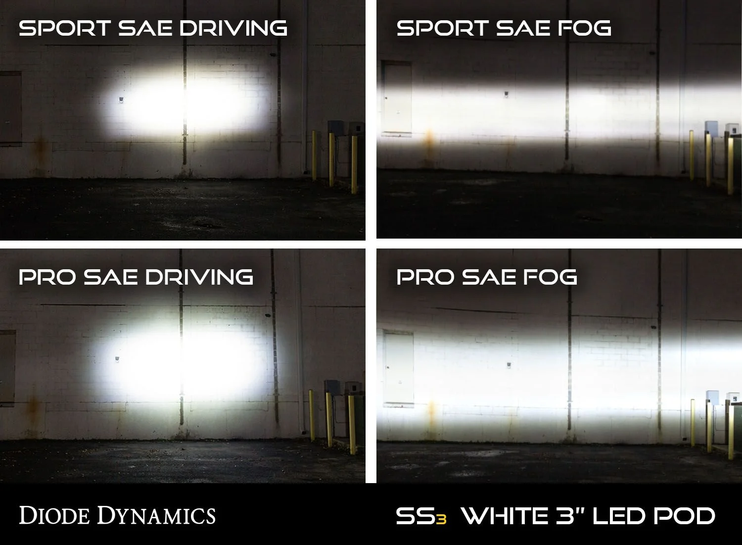

Now, here's the interesting part. My buddy also had an SS3 pod light. Man, that light looks pretty cool. (probably cooler than the light bar that I ordered...) See it on the left here:
The pattern is a little taller:
Here's a long distance test... those DD lights really throw light far:
I really like the look of those SS3 pods... I almost want to change my order. There will be a little less total output from the SS3 sport, but there would be more output if I got the Pro version... What do you guys think?
Pro all the way, they are crazy bright, and in the SAE fog lense the light pattern is about 50% taller than the Sport (beam pattern is short and WIDE either way for the SAE fogs, but a taller pattern for the Pro's).
