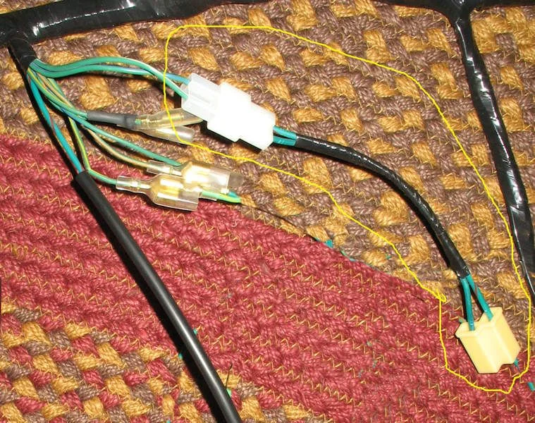

I had totally forgotten about this thread, but have something that may be of interest to anyone converting to the two or three terminal LED flasher from Super Bright LEDS.
I have a connector socket that will directly fit the two terminal LED Relay part # CF12ANL-01 from Super Bright. I also can make an adapter sub-harness that plugs into the OEM "T" flasher connector one one end and has this connector on the other end. See the bad pic. No cutting of your OEM harness!
I can also make an adapter for the three terminal LED flasher they sell. This flasher has a feature the CF12ANL-01 does not: the clicking sound when activated! It does require a ground. I can make an adapter that would plug into the "T" connector, has a lead with a ring terminal to ground under an existing bolt, and goes to a three terminal socket the three terminal flasher would plug into. I could even make a kit that included the flasher relay.
I updated my web site with this info and pricing. Link in my sig... Look under Misc Electrical IMG_0436.webp CF12ANL-01-led-flasher-storeT.webp IMG_7306.webp
