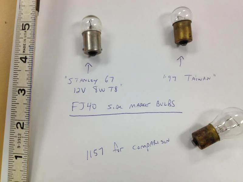

The side marker lights are the same as the single backup light (one bulb) in our '71 FJ40. All of these are in our Land Cruiser, including the fog light bulbs and cargo/bed lights from a Chevy truck.
Thanks! :))
First pic is a BA15s or a single filament 1156 base
Needs to be shorter than a standard 1156. If your wanting a bulb for the amber maker lights then you want the 67-A9-WV
For the reverse light I think you can take a taller bulb and to be honest you want the brightest light you can pack in there. This is what I would get if it would fit. 1156-W3X1W It's a 4watt bulb. Specs are here. http://www.superbrightleds.com/cgi-...ry=CAR&Page2Disp=/specs/115x-x3X1W.htm#photos

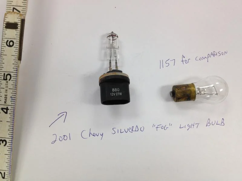

FYI, for anyone with the 880 12V 27W bulbs for GM applications, you can use an 885 bulb which is 50 watts. These are Sylvania bulb numbers, but I believe many other brands use the same numbers.

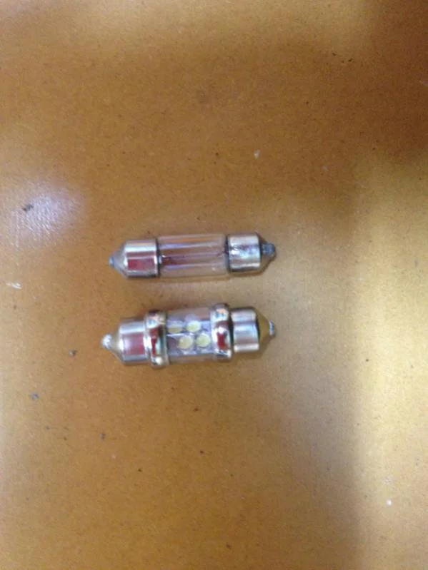

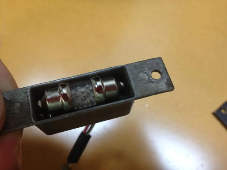

Has anyone found an LED that will work in the under dash light (not the one in the dash pad). The one that mounts under the dash - I think it is called "heater control light"??? The 3022 festoon from superbright is too fat to go inside that narrow metal case.
I have it. Let me dig it.
Mine fit Ok...
