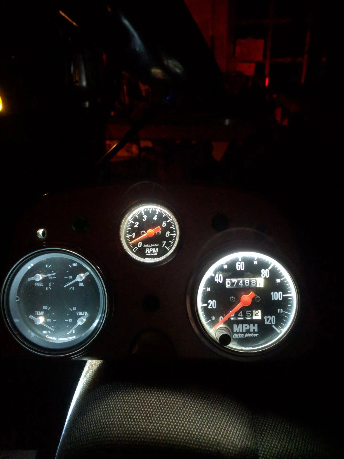

I also converted all the dash lights to LED's except I am using AutoMeter gauges and their supplied LED's. Gives a good soft light at night and does not blind me.
Also bought LED's from SuperBright.com as well for the side markers, license plate and turn signals. The turn signals will not flash so I guess I need another flasher. Just haven't gotten around to making that change.

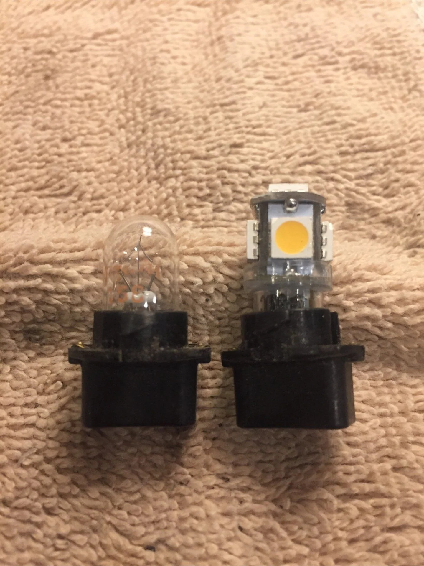

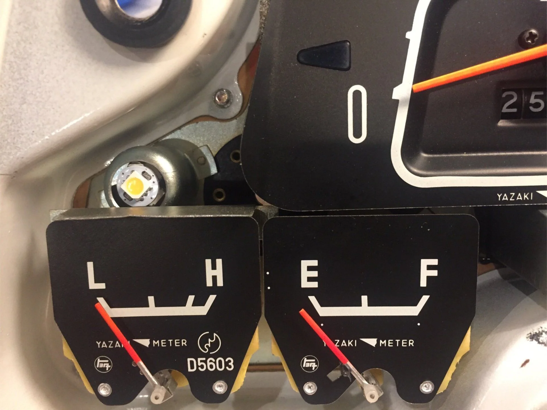

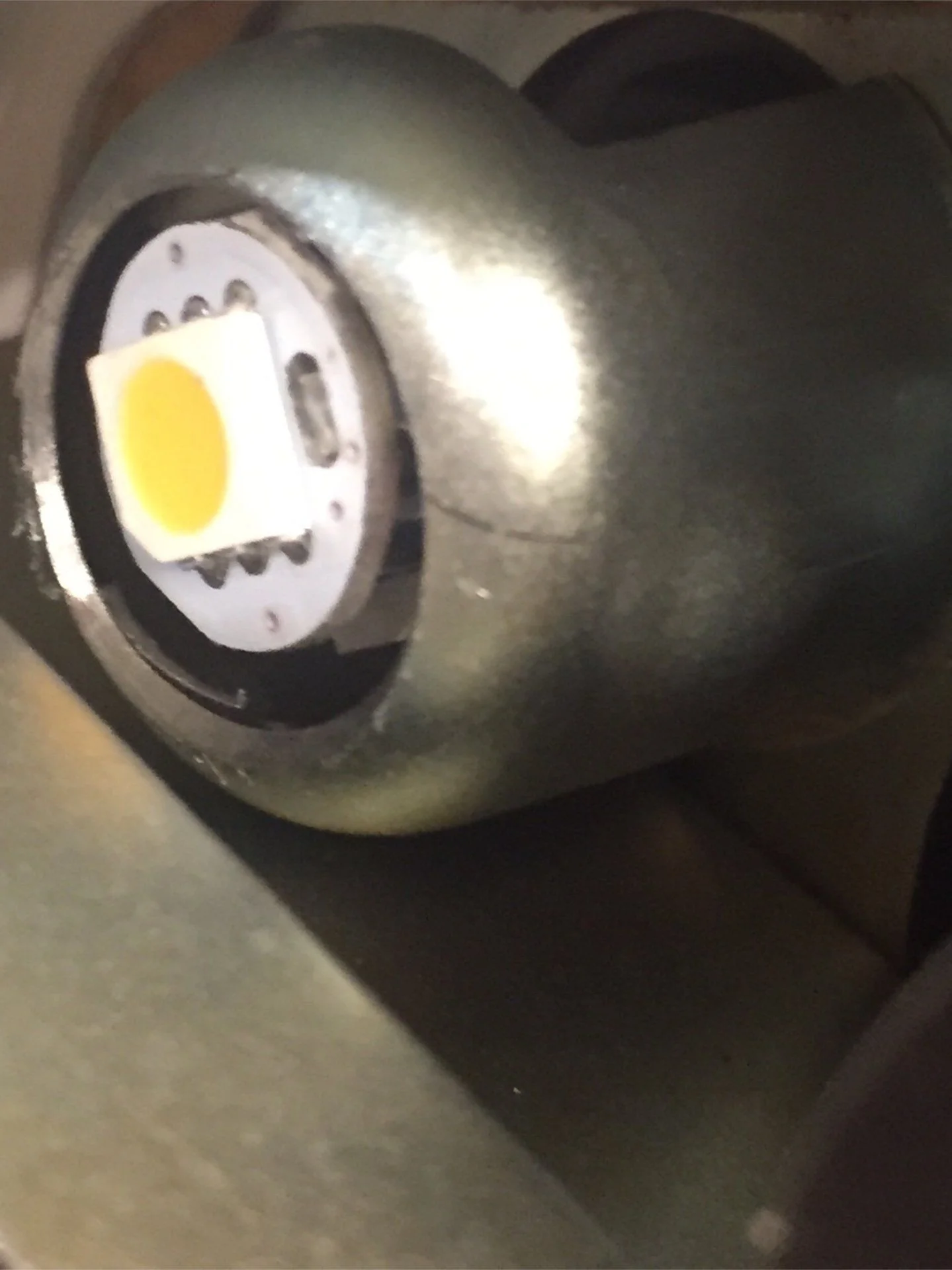

Ordered all the bulbs that @FJ406 listed. Did have to modify the cluster light shield. Used a step bit to hog it out.
While sitting in the passenger seat, if you position your head 18 inches from the dash and look at the cluster. You can see the forward firing LED. My gauge is back together so I’m going to call it good for now. Wouldn’t take much to add a piece if tin to eliminate the side glare.
Also ground the flat shields down a bit in hopes more light would pour over them.

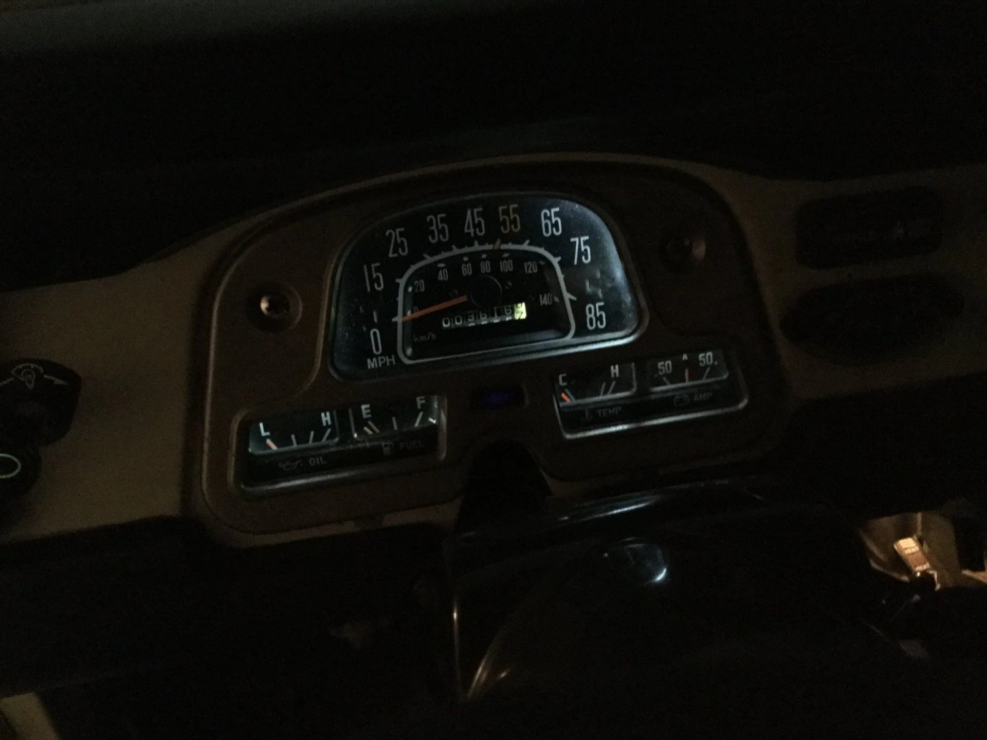

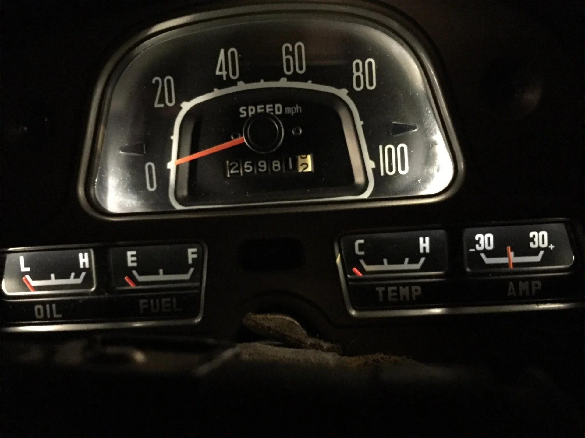

@thebigredrocker - Here’s me minus the shroud job :grinpimp:....... Do believe you are some brighter!
I am fine with the improvement over the old bulbs plus I do not want to take that cluster out again!

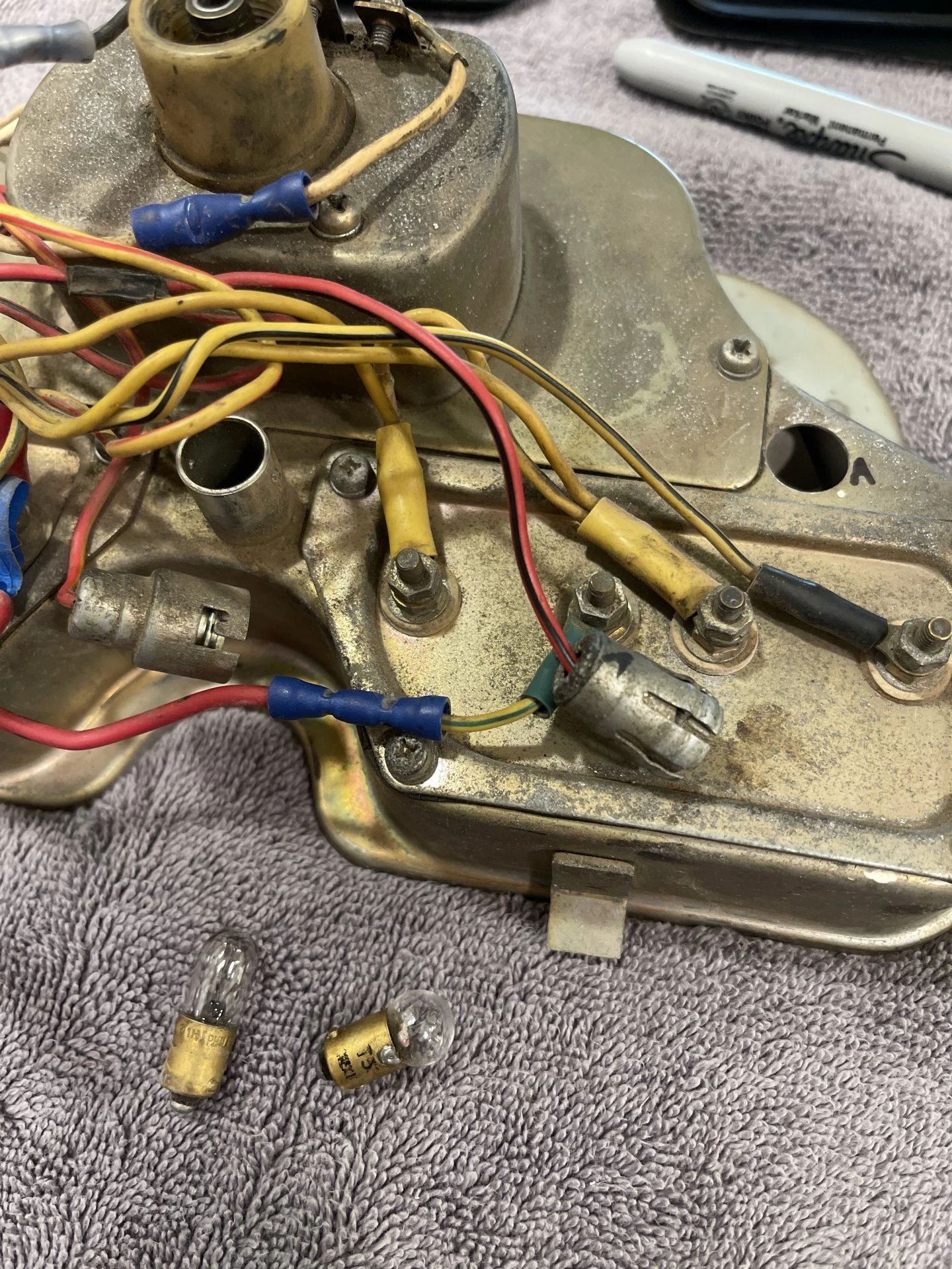

*FWIW: I’m sure I will not be ‘lighting the way’ with this but here’s the bulbs I ordered -

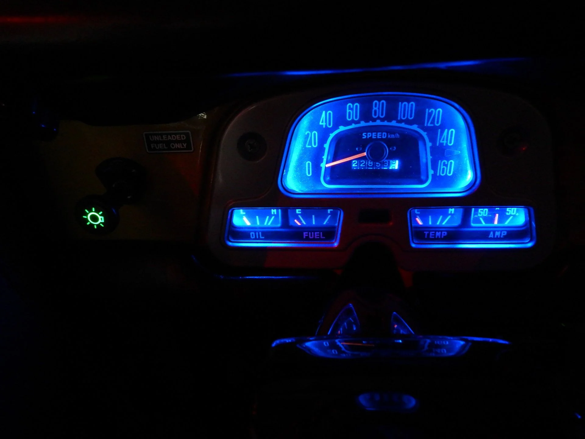

Got some Sylvania 194 LEDs for my dash gauges... You can judge for yourself, but I am VERY impressed.

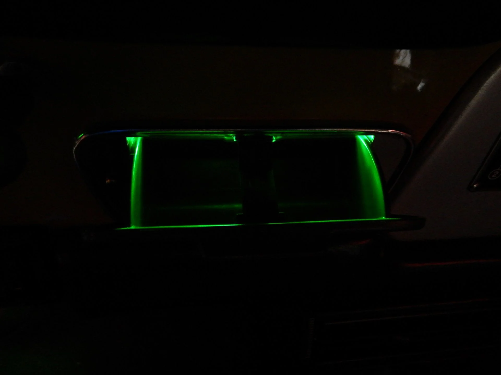

I did a Illuminated Ash Tray Modification
I added the bulb socket holder out of a 89-95 pickup / 4runner
when closed NO light is visible , must be the good sealing properties of the ash tray anti smoke design ?

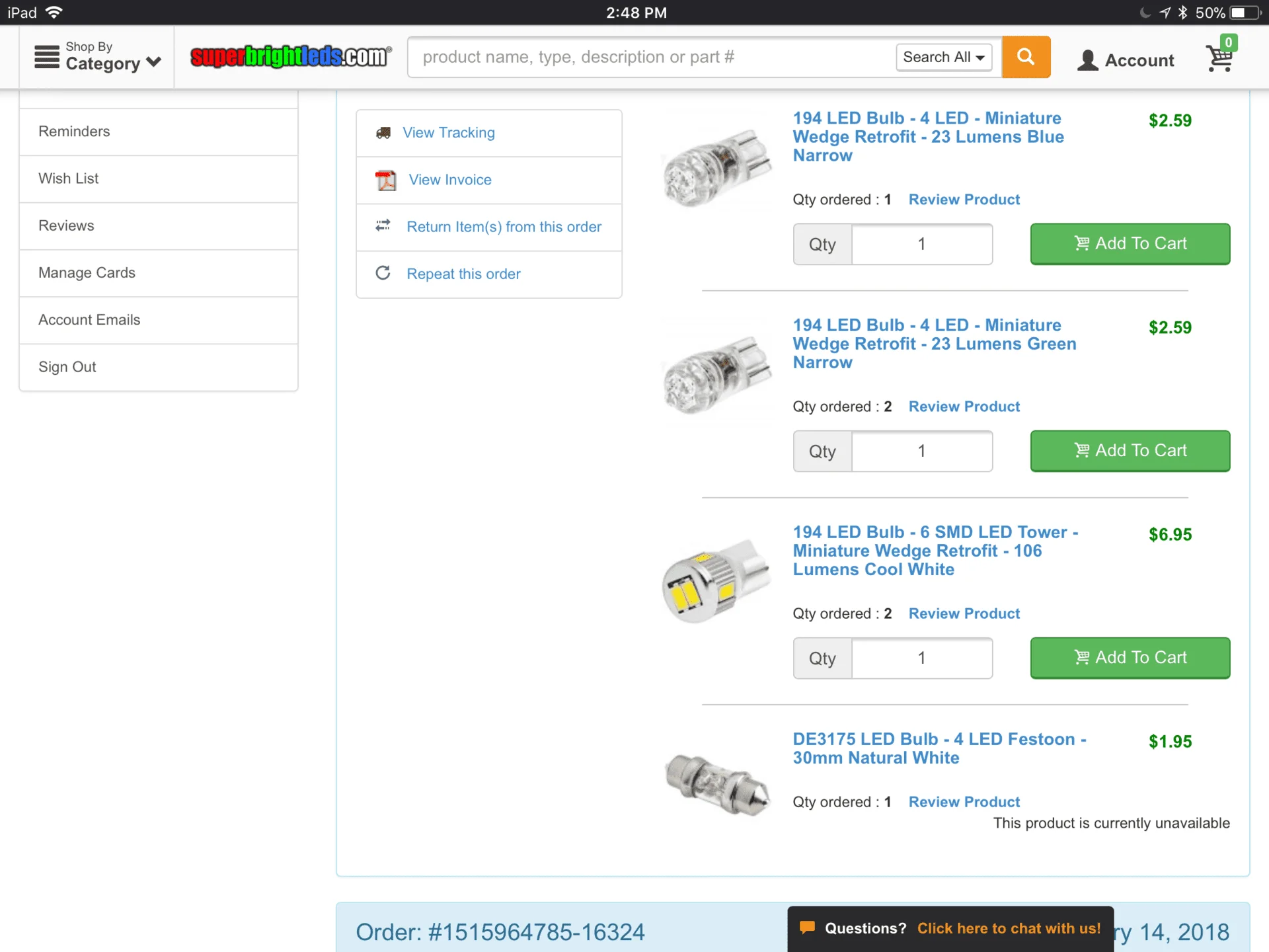

Here are a couple options I found on super bright that I figured I would try:
