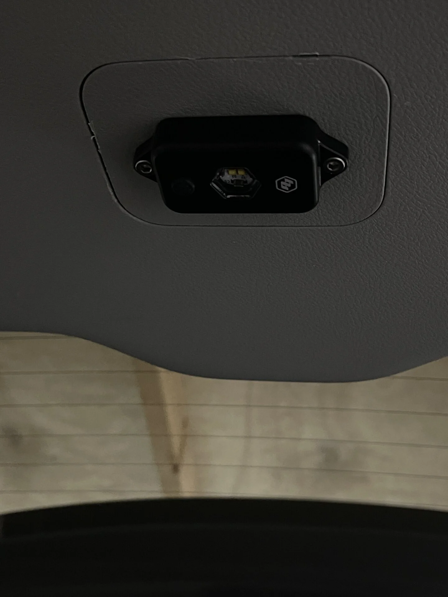

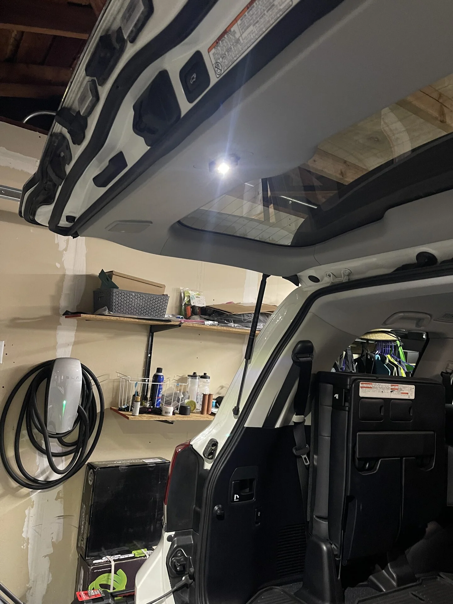

I installed mine yesterday using the Baja design rock light. It’s was fairly simple instal. I tapped into the lift switch and it automatically turn off when the lift gate closes.

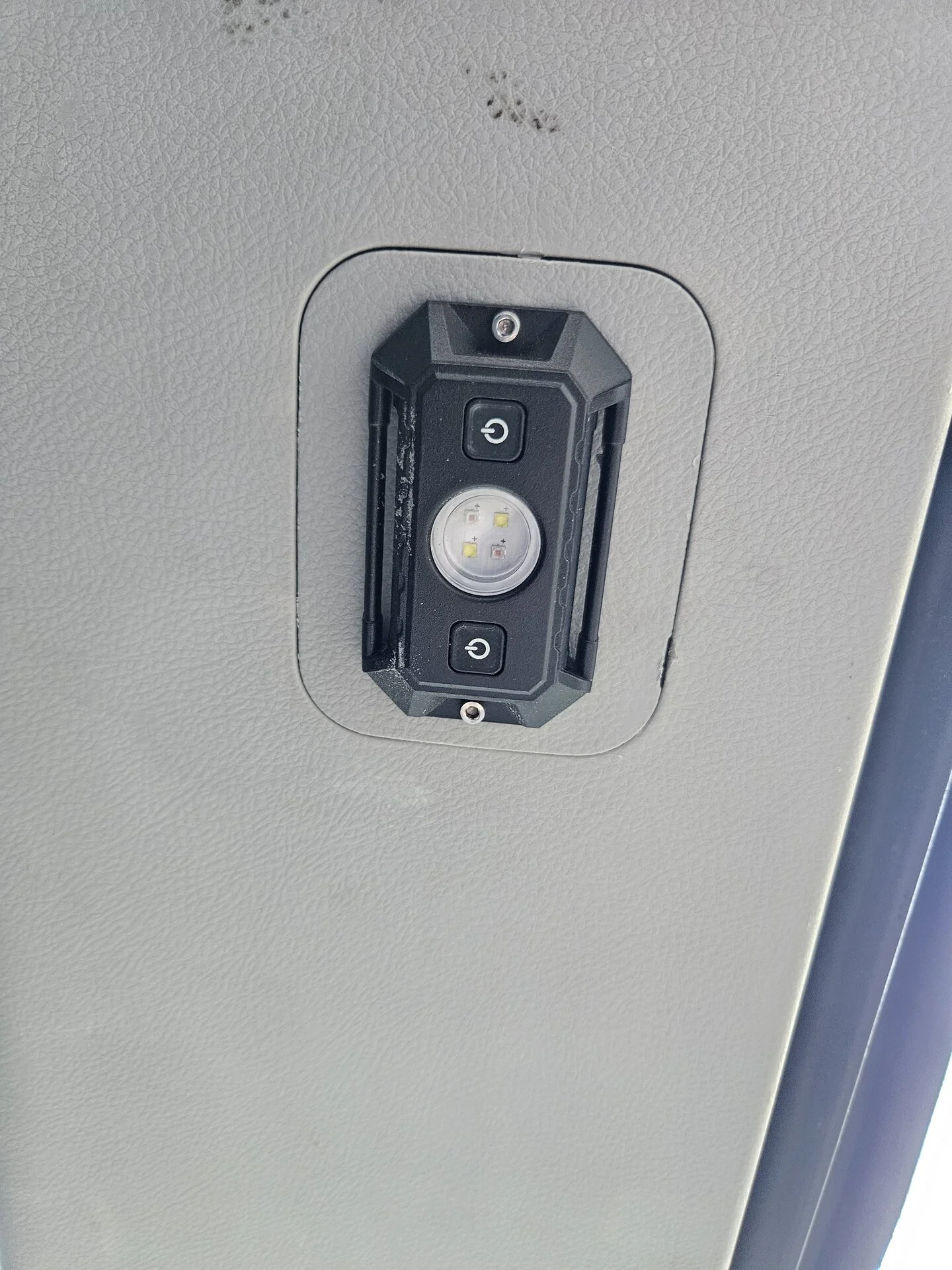

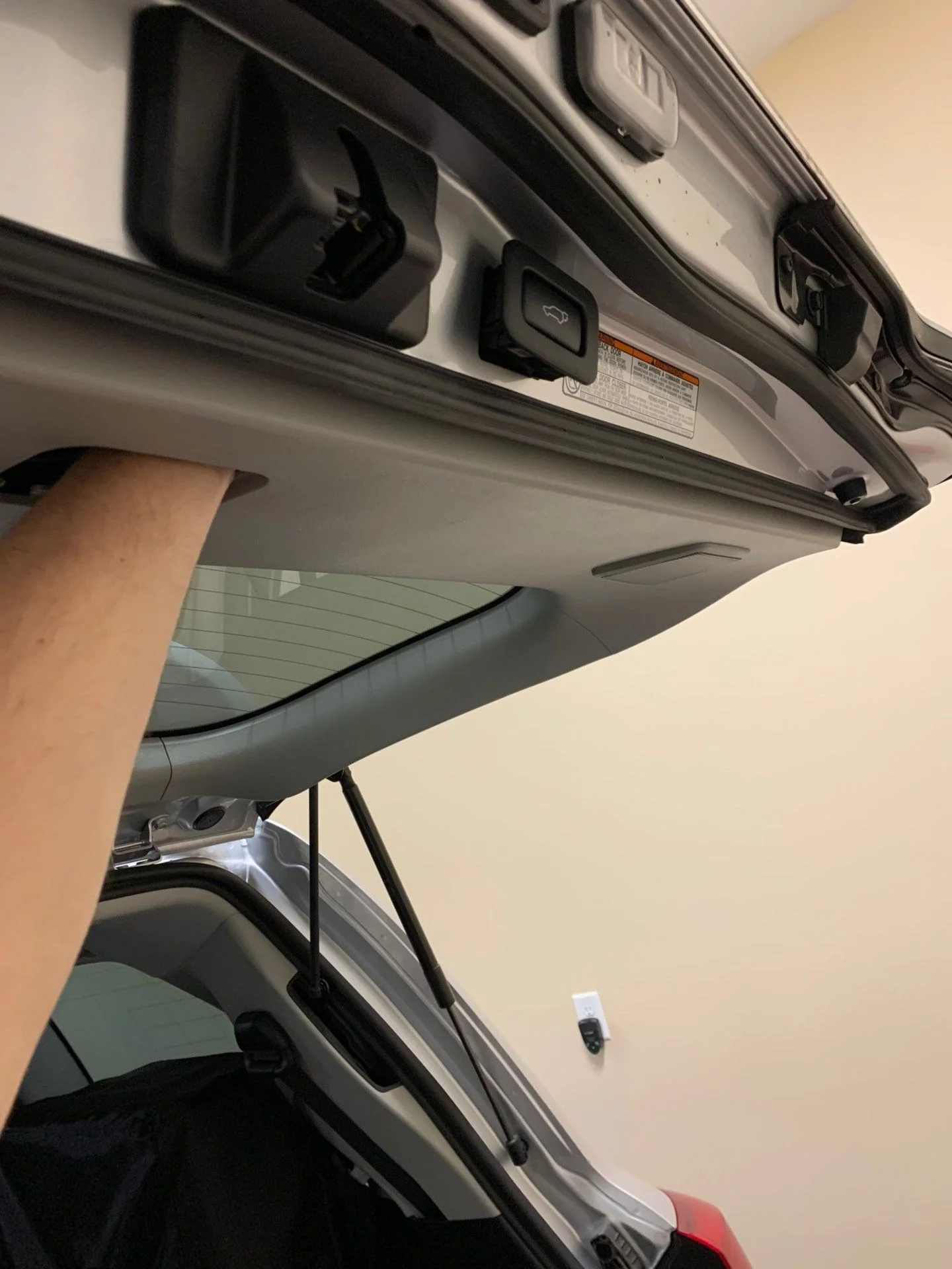

Many of us are using this:
Plug and play (you need small hands, I got my wife to plug it in), high quality, excelent functionality and light. Brendan is very responsive.
from that thread: "Yes fits all 200 series electric lift up tailgates through to the current 2020"
Duro I agree you need small hands

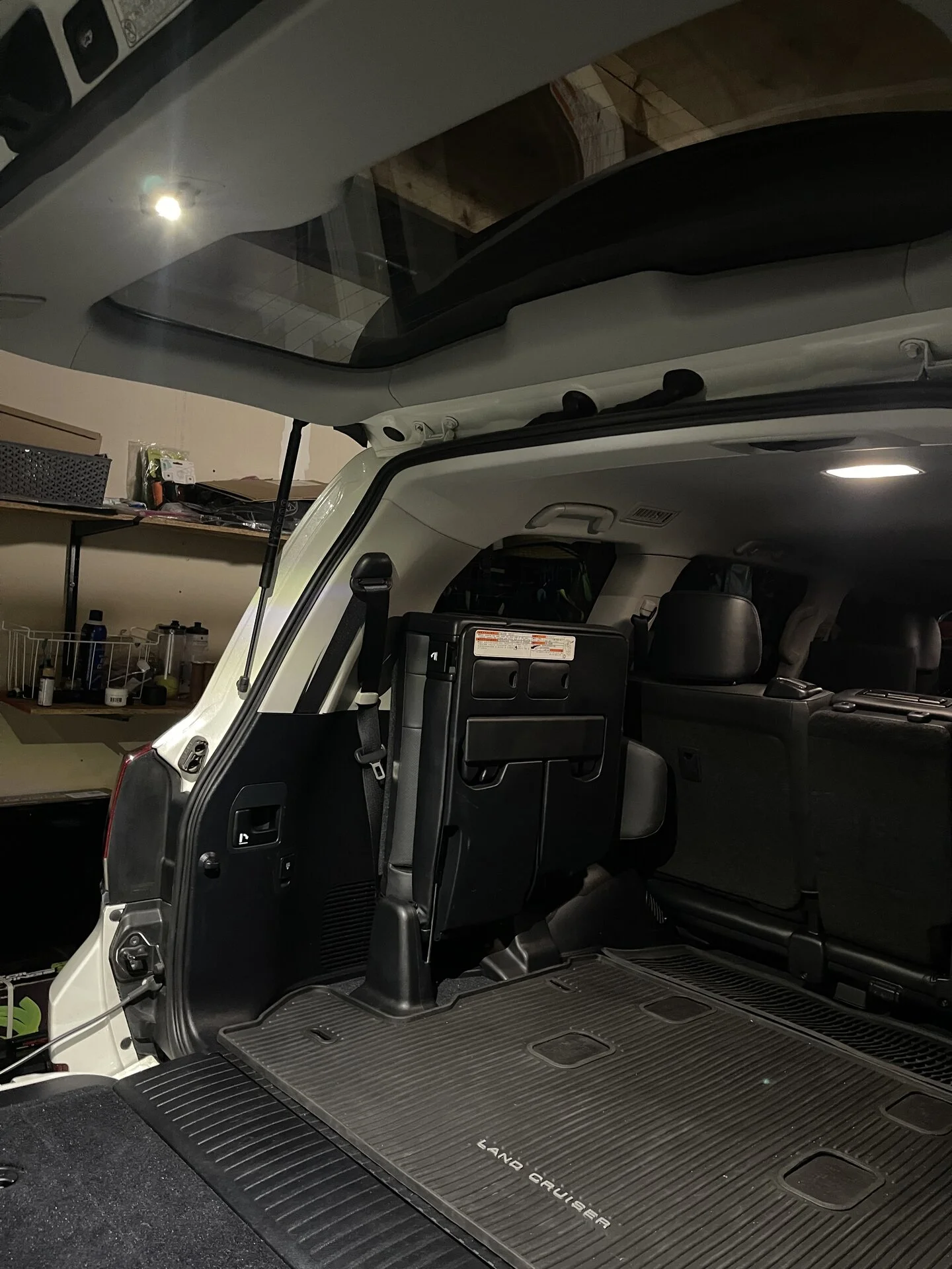

I used one of the diffused KC Hilites Cyclone V2 lights w/ the flush mount kit mounted in the same location and tapped to the rear cargo light. Don't have a pic currently but can get one later if anyone is interested.
I have this one too. DEFINITELY need small hands, or be prepared to leave bits of skin in the hatch like I did. VERY responsive seller, zero hesitation to buy from again!
If I had it to do over, I would consider removing tailgate trim to avoid having to deglove my hand for the small connector.
I did exact same on my 2021, works great.

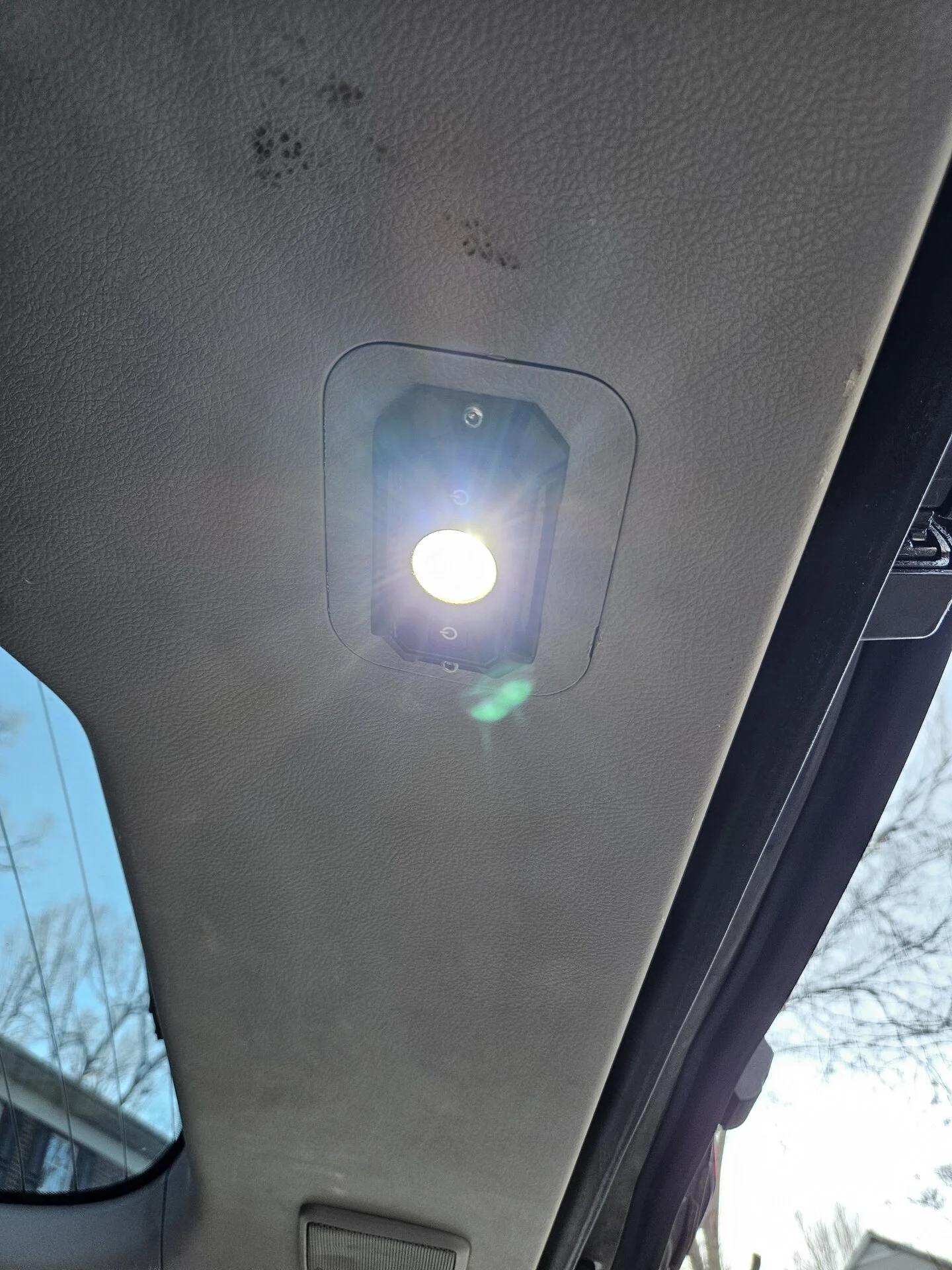

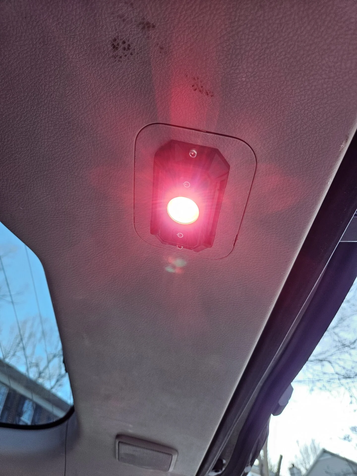

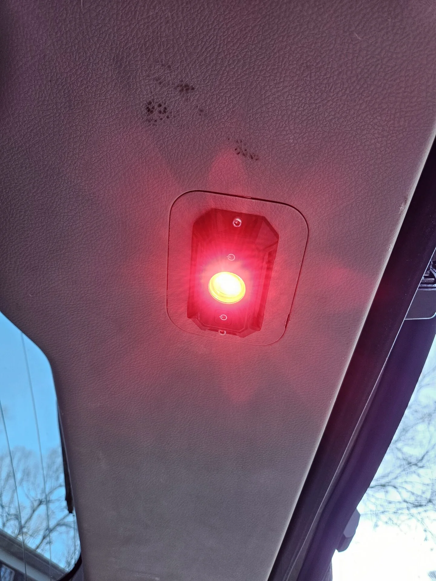

I used 2 National Luna dual color lights on the upper tailgate (and a door switch)... there is a fair amount of disassembly needed to do this and not tap existing power, all plastic on the upper tail gate, headliner is dropped a bit, pass side lower cargo plastic comes off, & drivers side is loosened.. there is a rear camera relocation video that victory4x4 has that goes through this.. takes a while to do...
But to me it was worth it - lights are Clear and Amber... and very bright..
