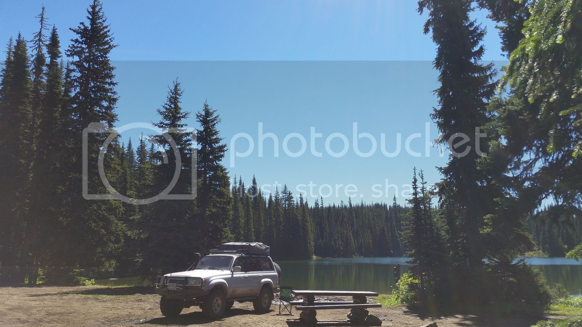

Great time camping with old and new friends. This is my camping spot on the 2nd night.

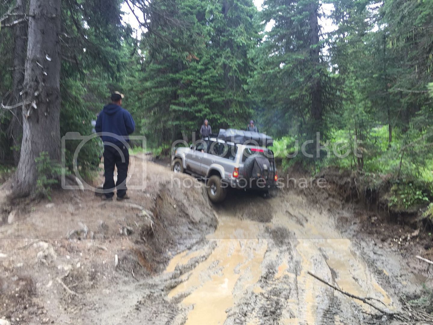

One of the obstacles that has been carved out over the years by many trucks. 6 years ago when I last did the trail this was not an obstacle.
Now as you drive up the wall on the drivers idea is as tall as my roof and it's a near vertical step 4ft up.

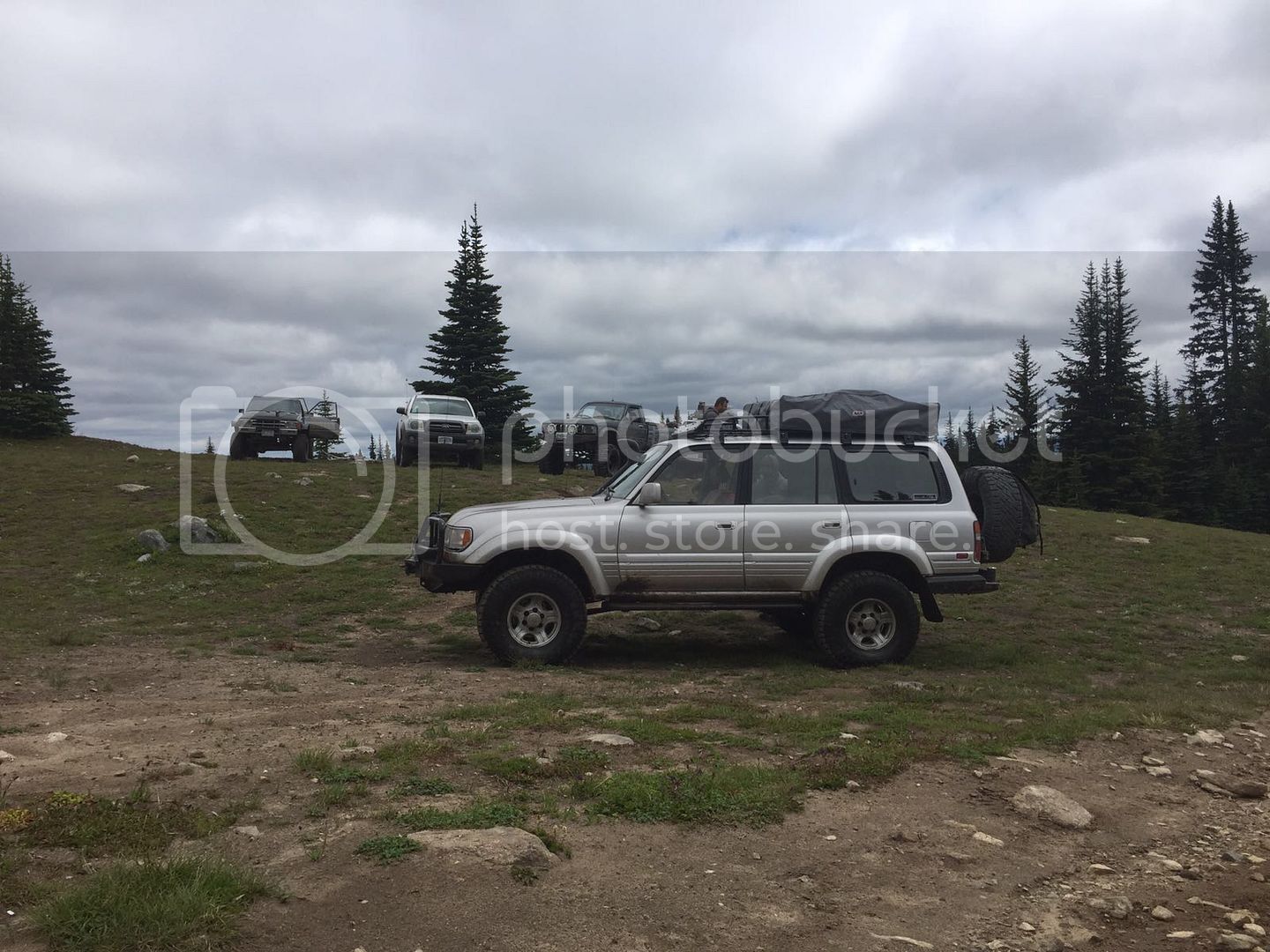

Lunch break at 6000ft. Great viewpoint.

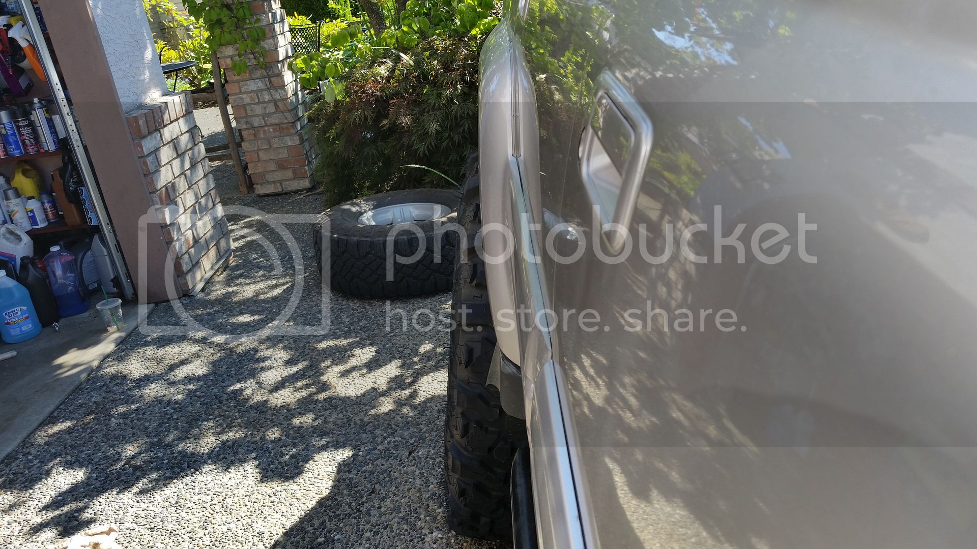

WhIle I had the wheel off I fit my brothers 15x10 3.5" back space wheels with 37x12.5 Pitt bull rocker........um yeah it looked amazing lol like a little arctic truck.
Even fit inside the flairs so tecnivally legal.

Yeah as soon as the new SCS wheels are ready I'll be going 37x12.5r17. I test fit the sample wheel on yesterday and it looks amazing, lip is level with the wheel flair.
Intrested to see what to think of thoes cooper STT pro when its time for tires. Leaning towards the bfg ko2 at the moment.
I wanted to test the Pittbulls becouse on thoes wheels it's more agressive than the SCS wheels will be.
