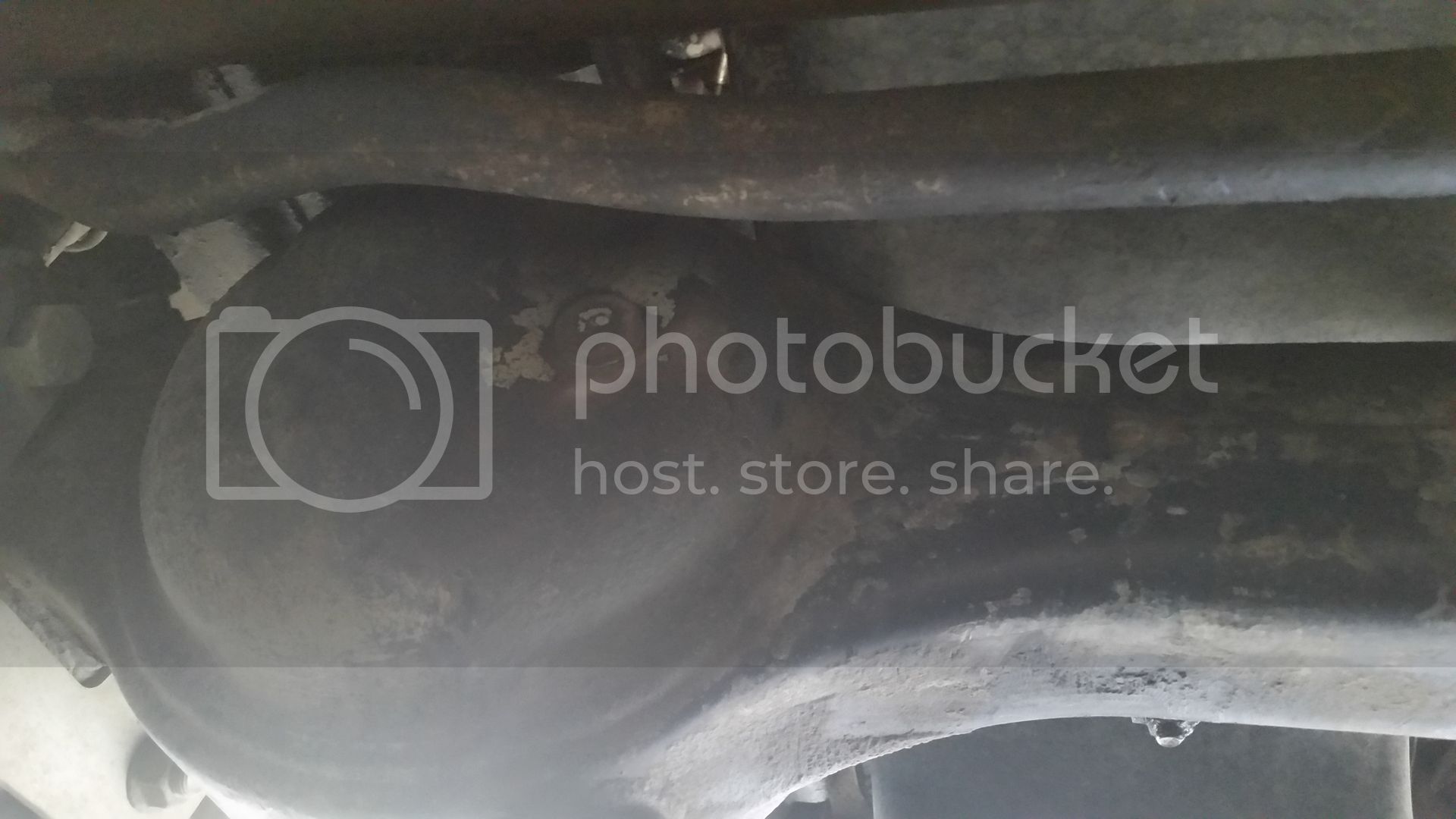

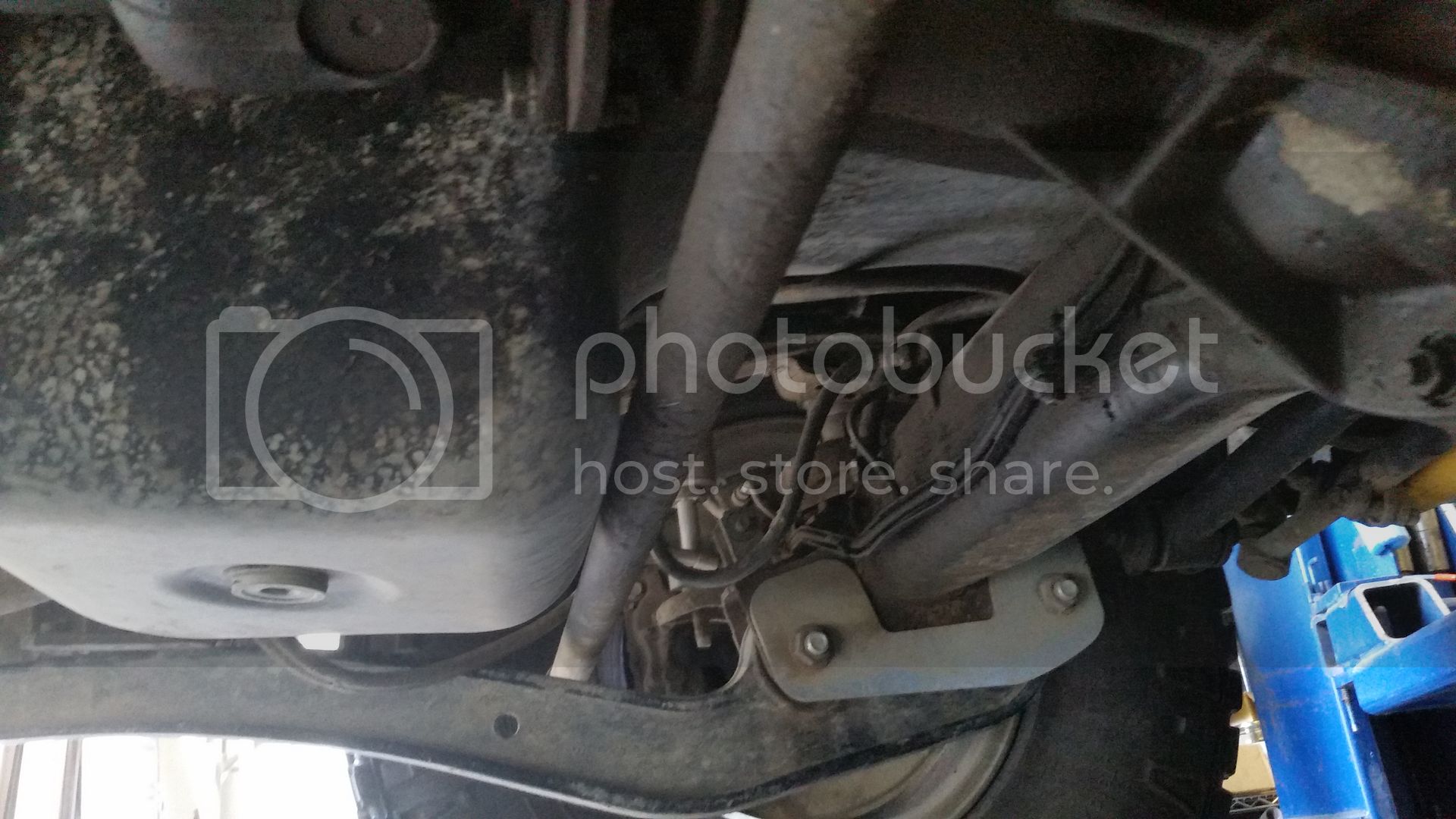

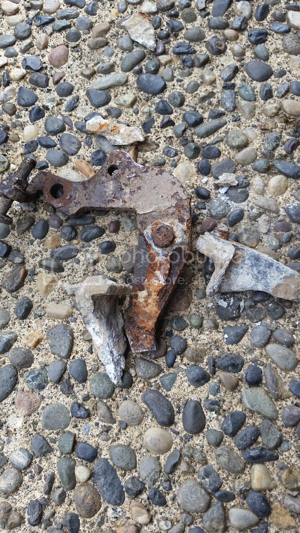

My next priority was to look at the sized passenget side e-brake and fix it.......found the issue.
That is all that is left of the bell crank.
So I ordered a bunch of new parts from Toyota and hope to have this working before I leave.

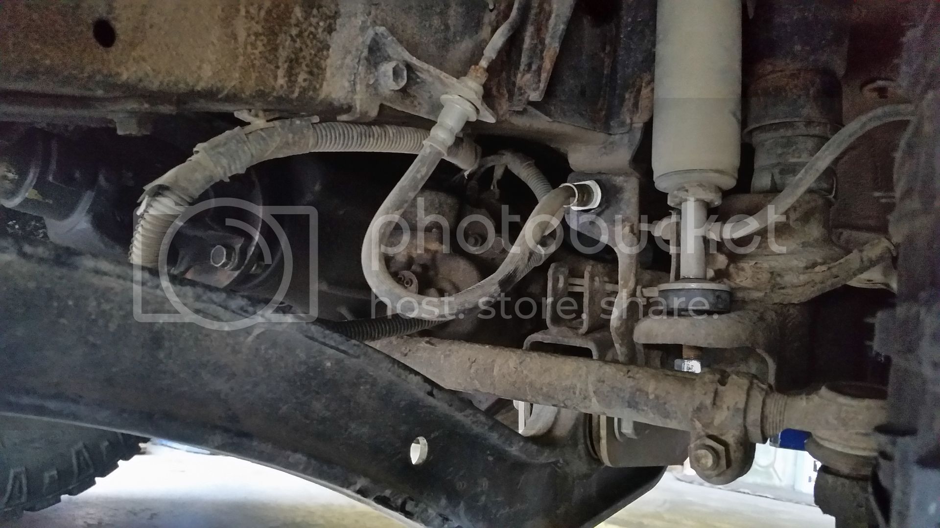

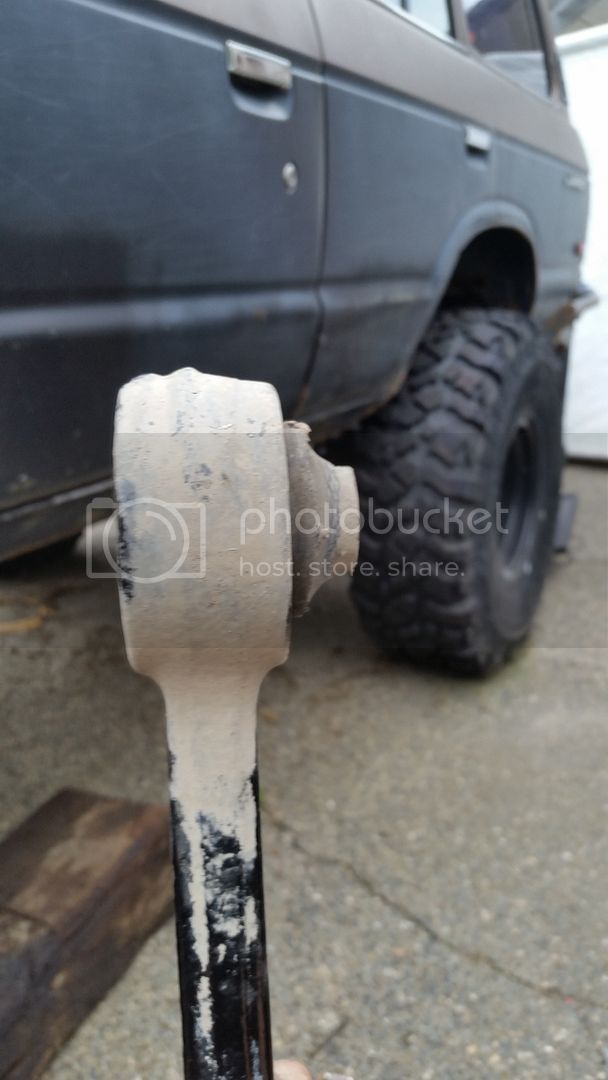

Oh I also pulled out my front radius arm to get a new frame end bushing installed....

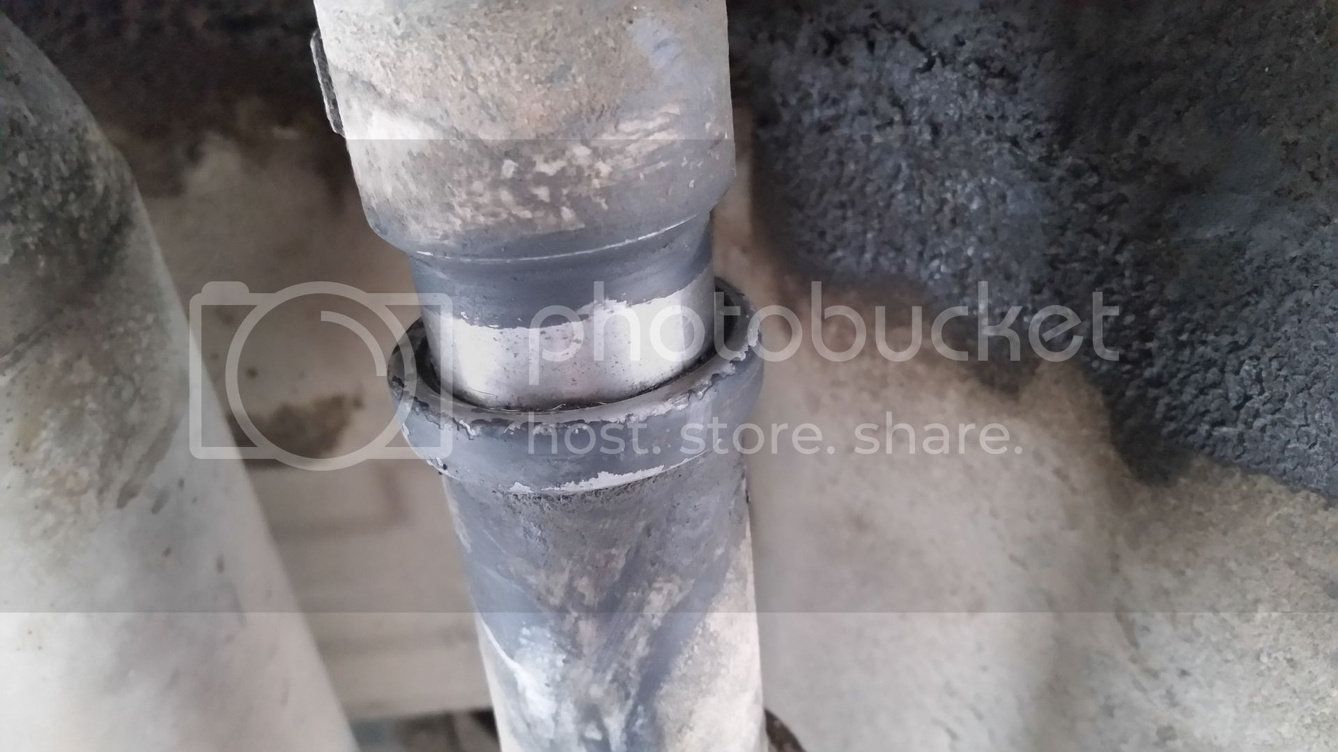

Checked my rear drive shaft and I have 1" of compression travel so should be fine, not sure why others have had to shorten there's.

Your whole drivetrain is moved .5" forward, which I believe is enough to not need to modify the rear shaft.

Yes that 1/2" must be the reason my rear shaft is fine. Haply to save $300 driveshaft job right now to be honest.

The extra .5" was a good move on your part. No need for driveshaft mods and easier clearance fro the timing cover, probably helps with bellhousing clearance too.
