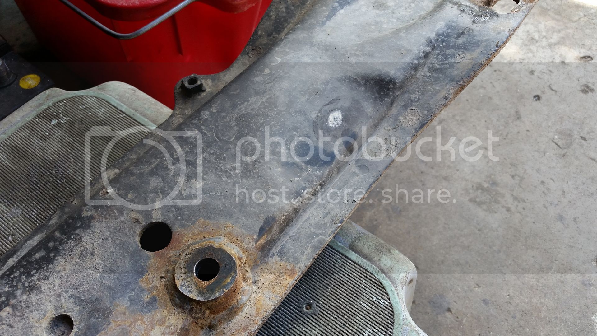

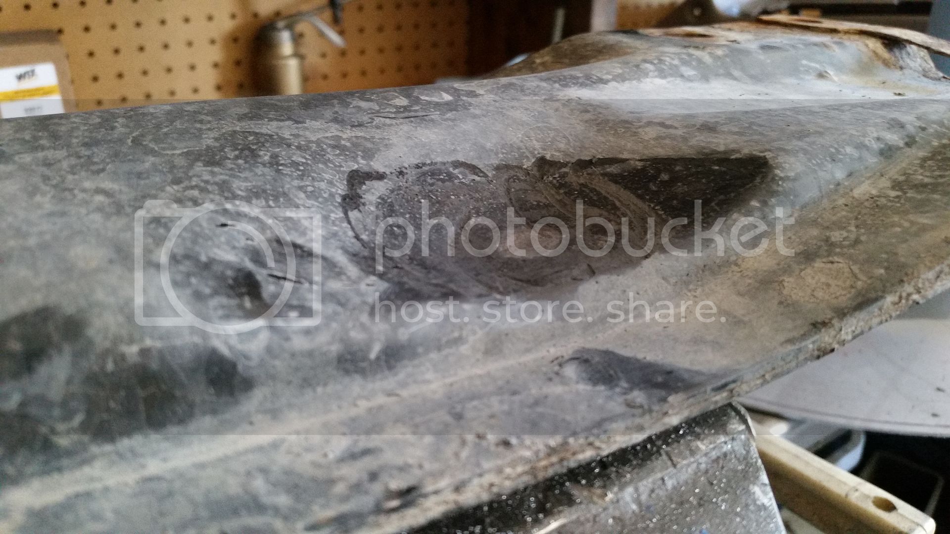

First on the list was drop the cross member and paint. When I dropped it I found my vibration that I was getting under load.
Massaged with a 3lb sledge before paint.

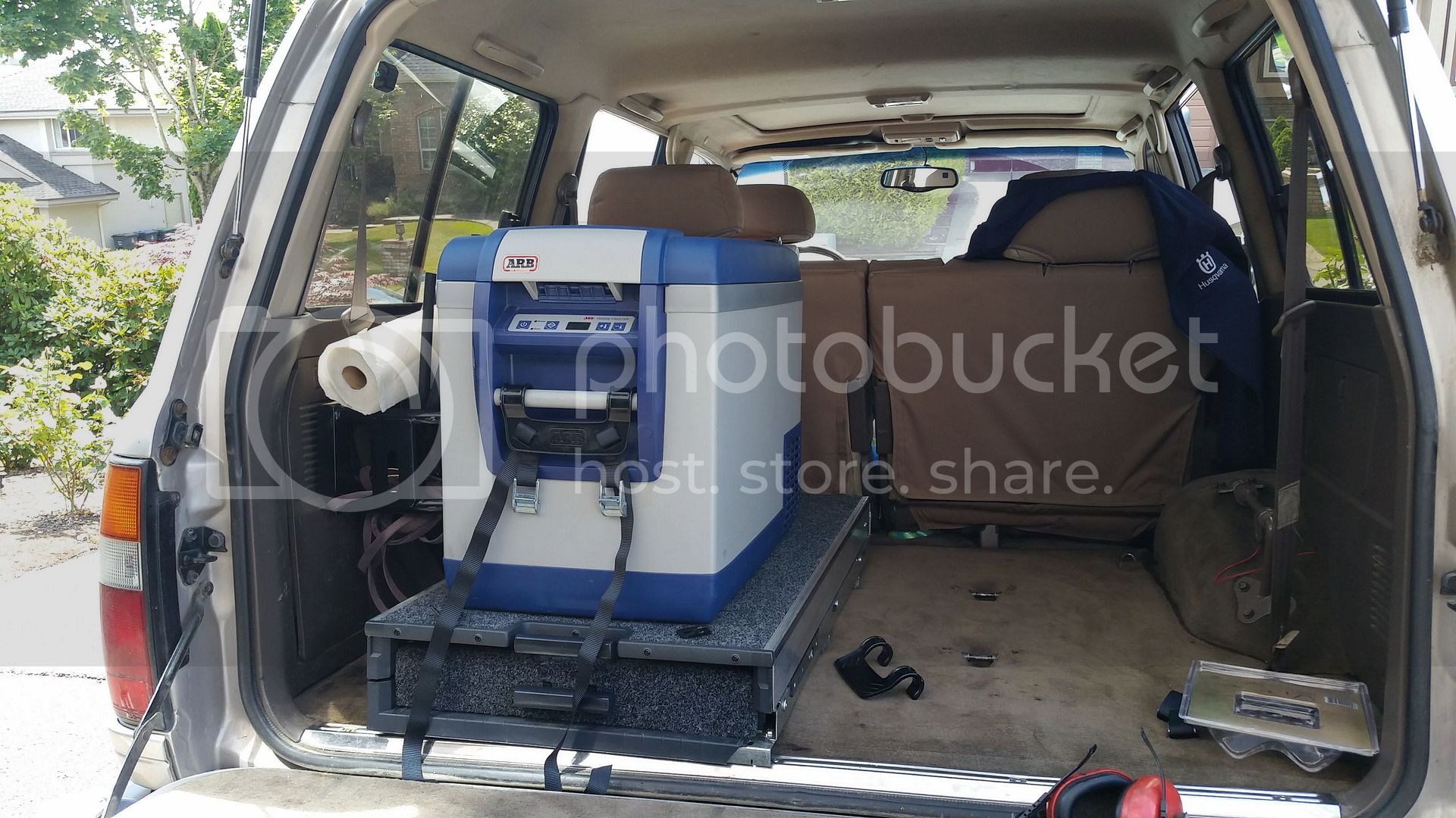

Next project on the list was get my ARB drawer and fridge back in.

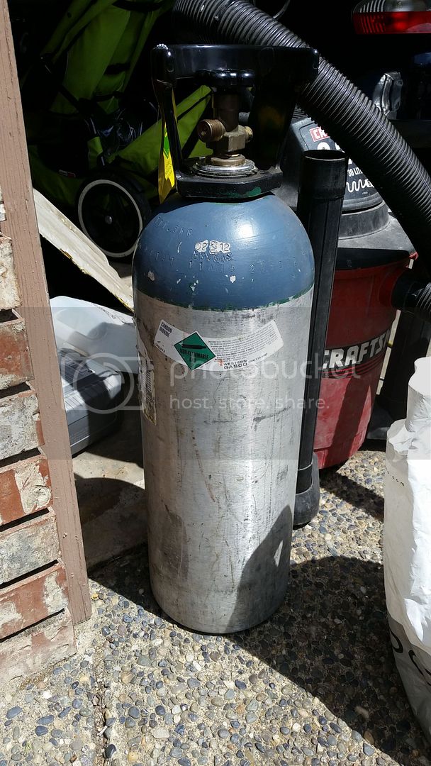

Then contemplate where and how I'm going to get this mounted.
20lb co2.
I was not able to get my engine driven York on the cummins so I needed an alterative. It's not idea but it's better than not having Air.
Test drives today went great, no issues noted. No external coolant leaks. So much better driving now that that crossmember contact is removed, quieter under load and even normal driving. Amazing how such a small spot can make such a difference.

Was your xfer case tapping the cross member?
Yes, it appears to be about 1/4" lower. I may try spacing the mount up when I have time becouse my cruising off road skid does not fit now too. I'm going to have to be careful though with the shifters/tunnel clearance.
Hey Jeremy, I have a nice Powertank Supertank bracket I'll give you a good deal on, if it fits the 20 lb bottle - I bought it for a 10 lber. Never been used.

That would be great! Hopefully it fits, I was looking at making one but decided my time is better spent using the truck not building stuff for it.

Otherwise you can pm me and check it out if you have to come through North Van some time. If it doesn't fit I can give you a deal on a 10 lb'er with regulator too - also never used :grinpimp:
