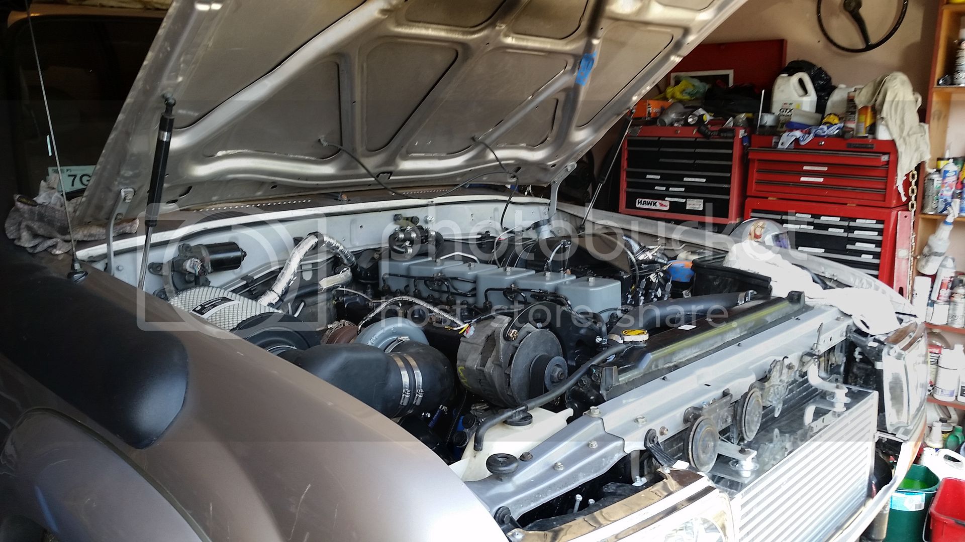

Everything mechanical is done and it's ready for a drive once I connect my drive shafts tomorrow morning. I still have some clean up inside to do mainly the console and putting the dash back together. I did have some clearance issues with the intake horn and the hood or hood reinforcing rib. I ended having to massaging the rib down with a perciss instrument (hammer) to allow the hood the to close. It's close 1/8th so am planing on further massaging and I'm also going to get a bit taken off the horn.

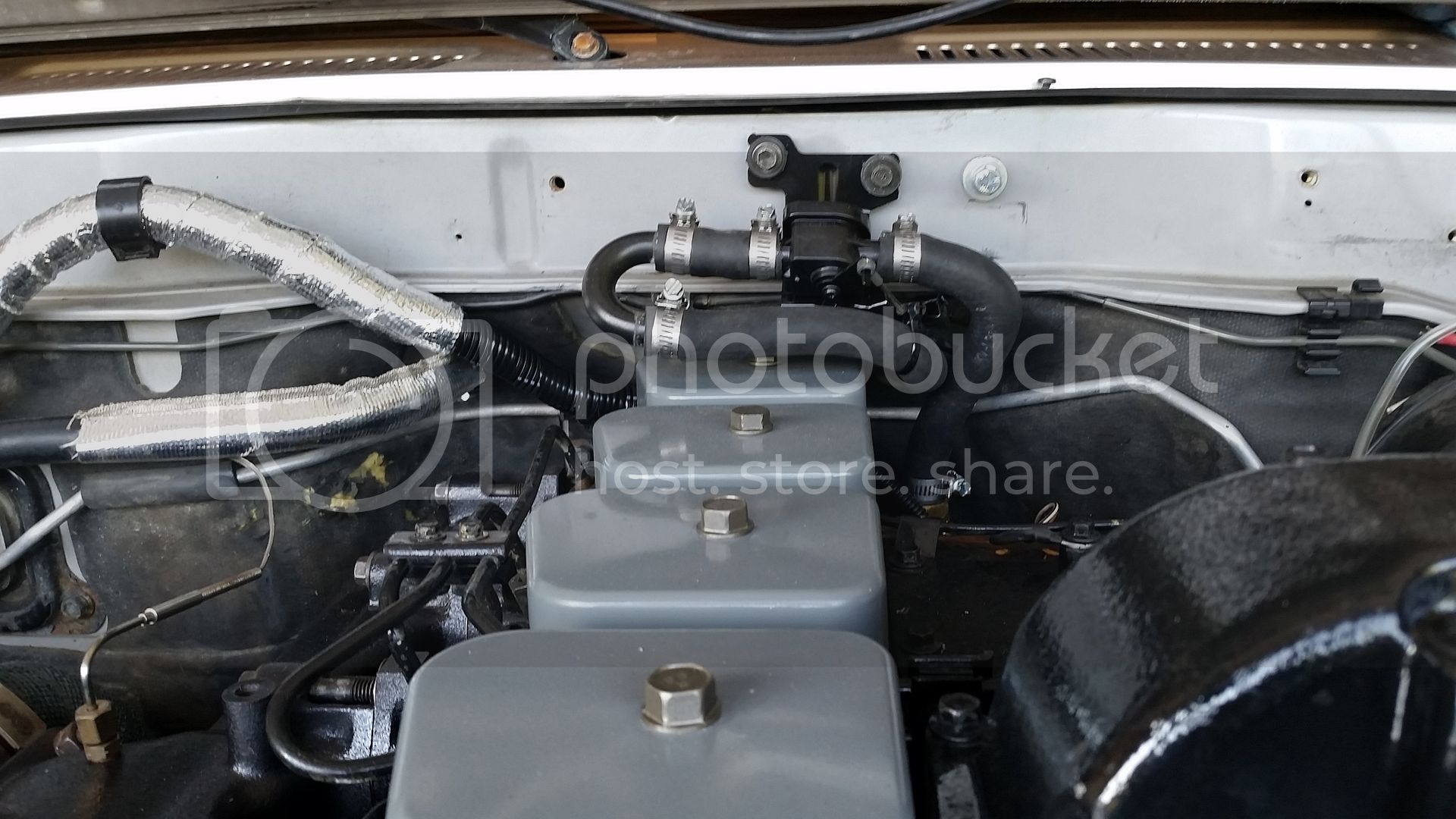

Heater hoses went in well.

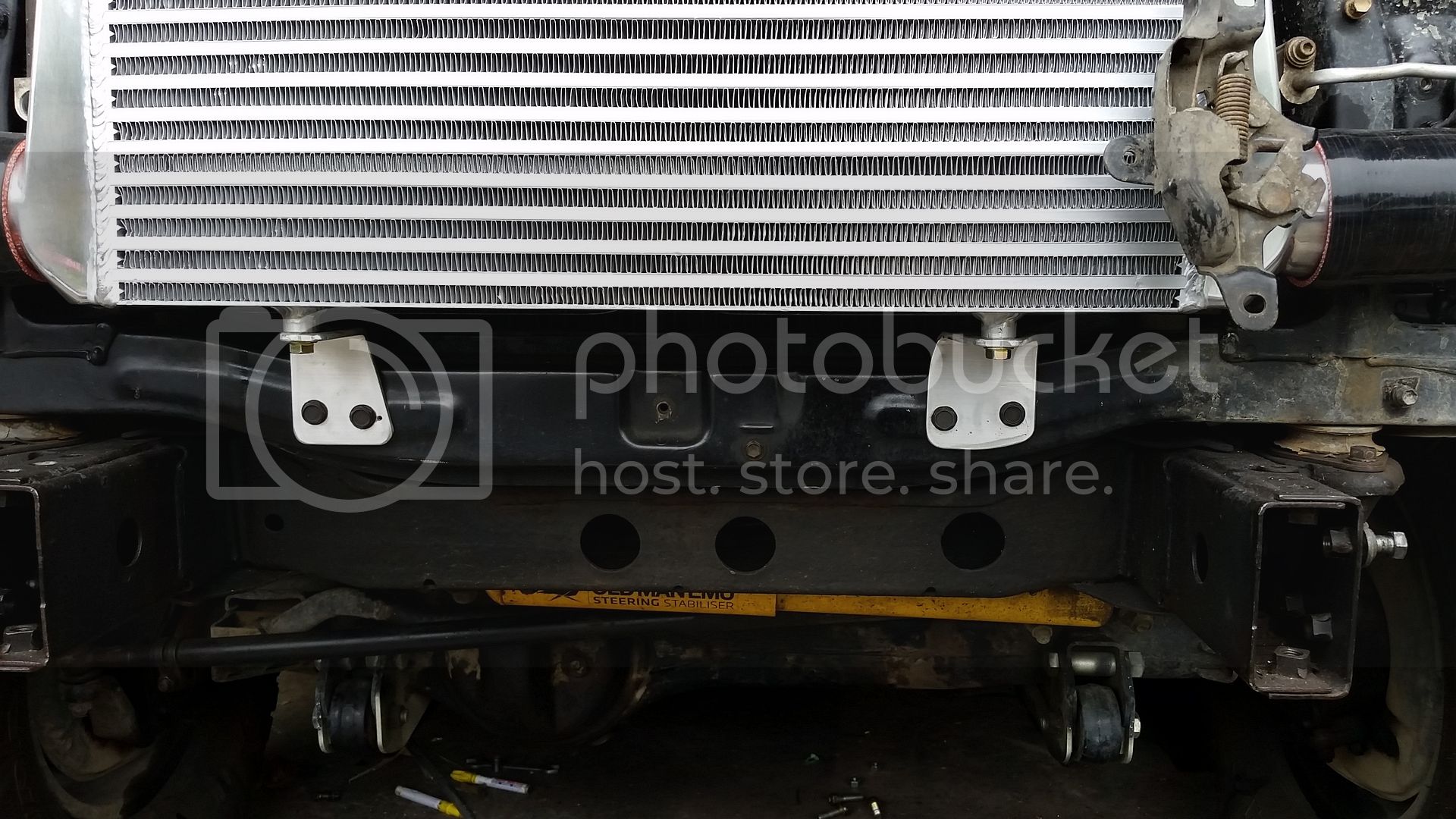

Lower intercooler brakets I forgot to post yesterday.

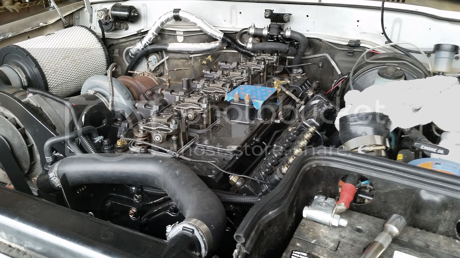

I ran the engine up to temp, or atleast till the t stat opened. Tomorrow I need to re torque the ARP's ( suppose to be done after 1 heat cycle). Then attach drives shafts and see if it will move.
Yesterday I had a lot of cleaning up to do on the truck. I started by retorqueing the ARP's all clicked right at 125ft/bs but two took a 1/16th more rotation. I'll have to do it again in 1000kms.
