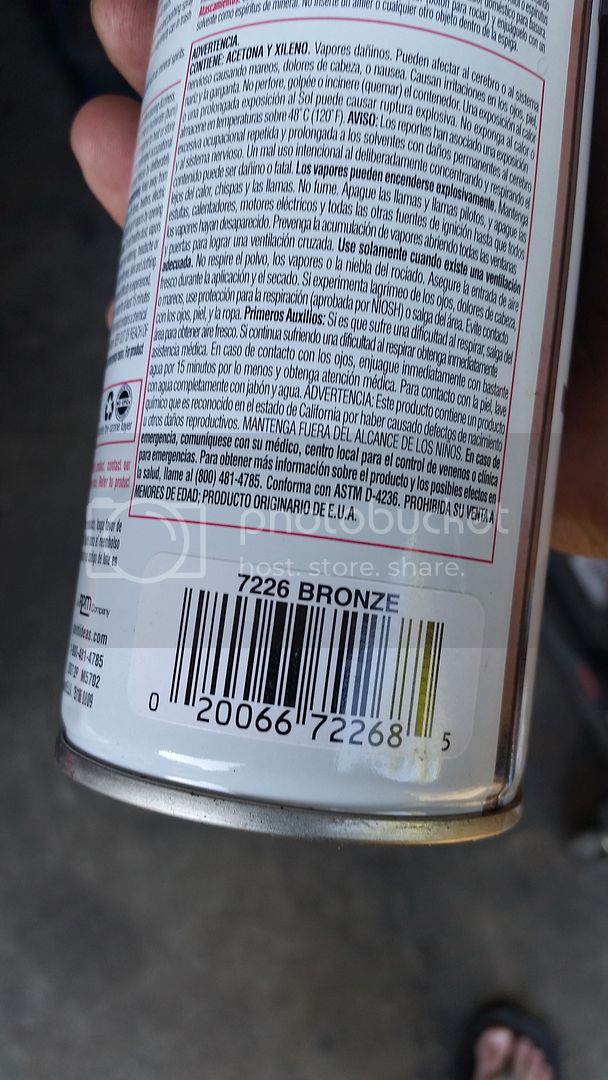

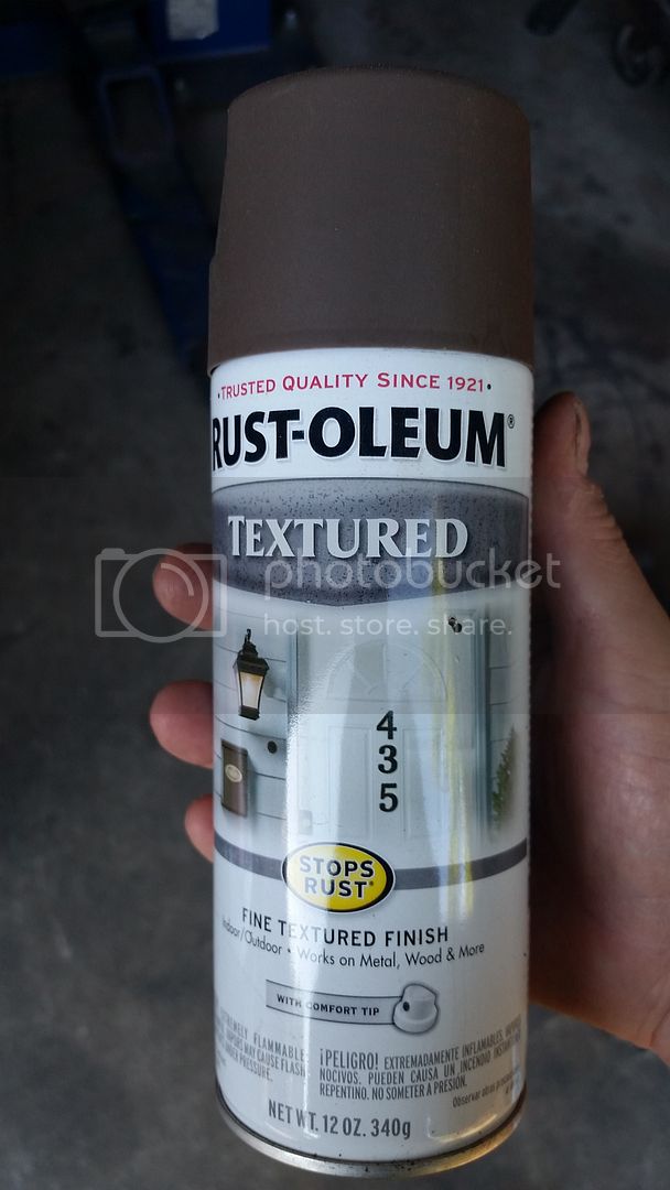

Here it is.
If I remember right I got this at Home Depot.
Thank you.
