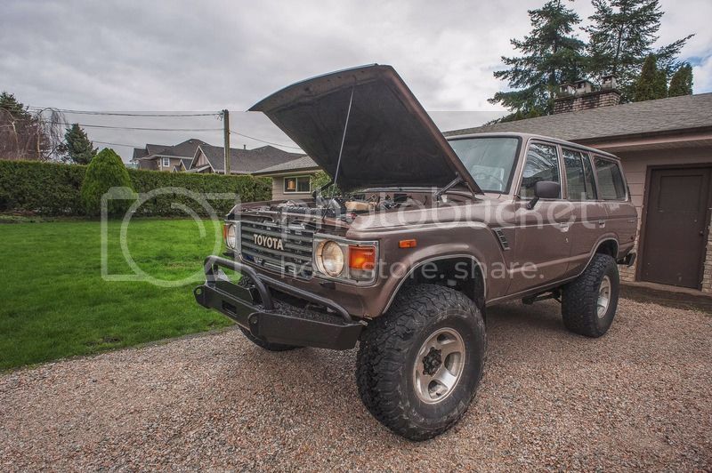

motor is dirty from the mud spraying up...

Amazing, I absolutely love it. I didn't know tan coloured engines looked so good.
Are those 2 giant spin on fuel filters?
I was going for a tank theme... I really like the tan when it is clean but it shows dirt quick (which was the intent). It has a small oil leak from the power steering pump seal, which I was easily able to trace because of the Tan paint!
The 2 horizontal filters are oil, main and a bypass filter.
There is a small style fuel filter on the rail, and another fuel filter/water separator on the firewall by the oil filters.
