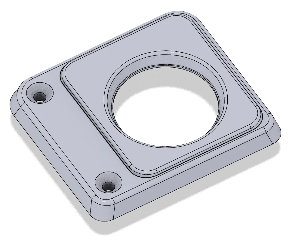

While posting around on this subject I got a lot of questions for Tachometer bezels. I have 3D scanned the original bezel (@wormfood sent me one, thanks fot that!) and now have a nice 3D file.

A thread without pics is boring, so here are some pictures of the 3D model:

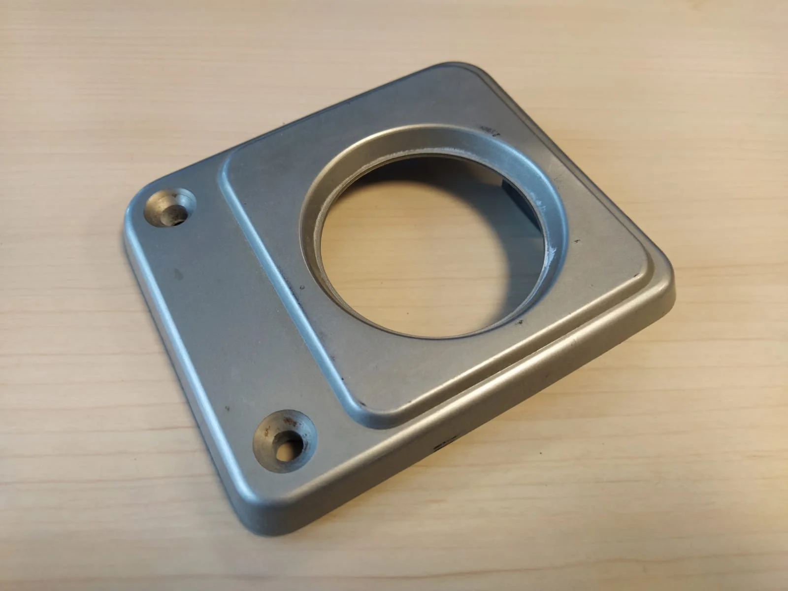

The original:

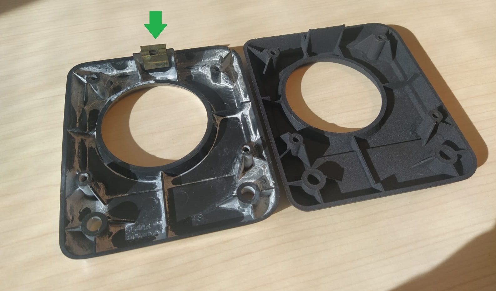

So, slow progress on this p[roject but I had a few bezels 3D printed. These are quite high quality SLS printed PA12 parts, they look and feel good.
I use this material a lot at work so I had the 3D print shop print a few more.
Here are some pictures of the front:

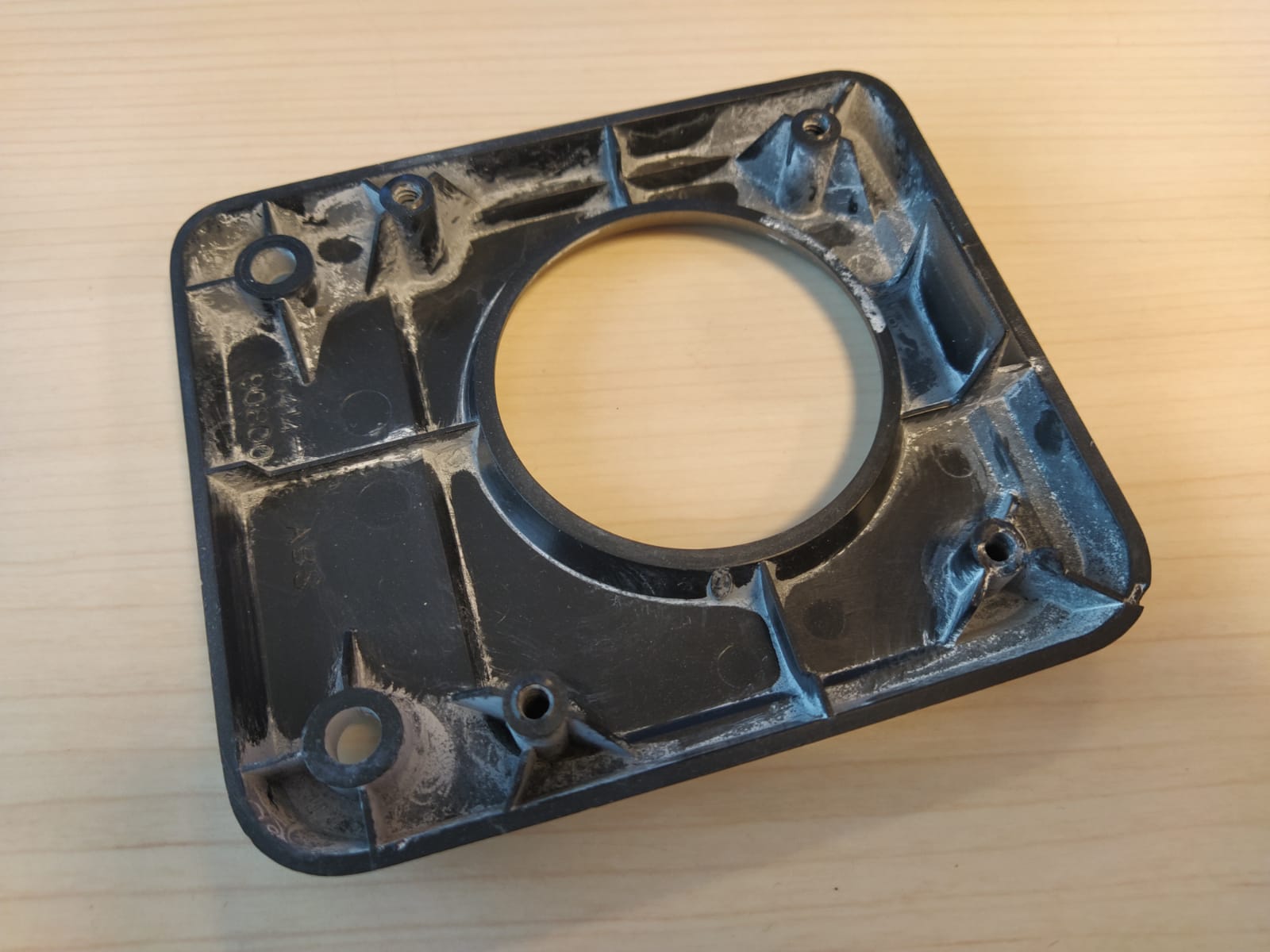

In the pictures below you'll see some white powder on the original bezel, this is from 3D scanning and will just wipe off.

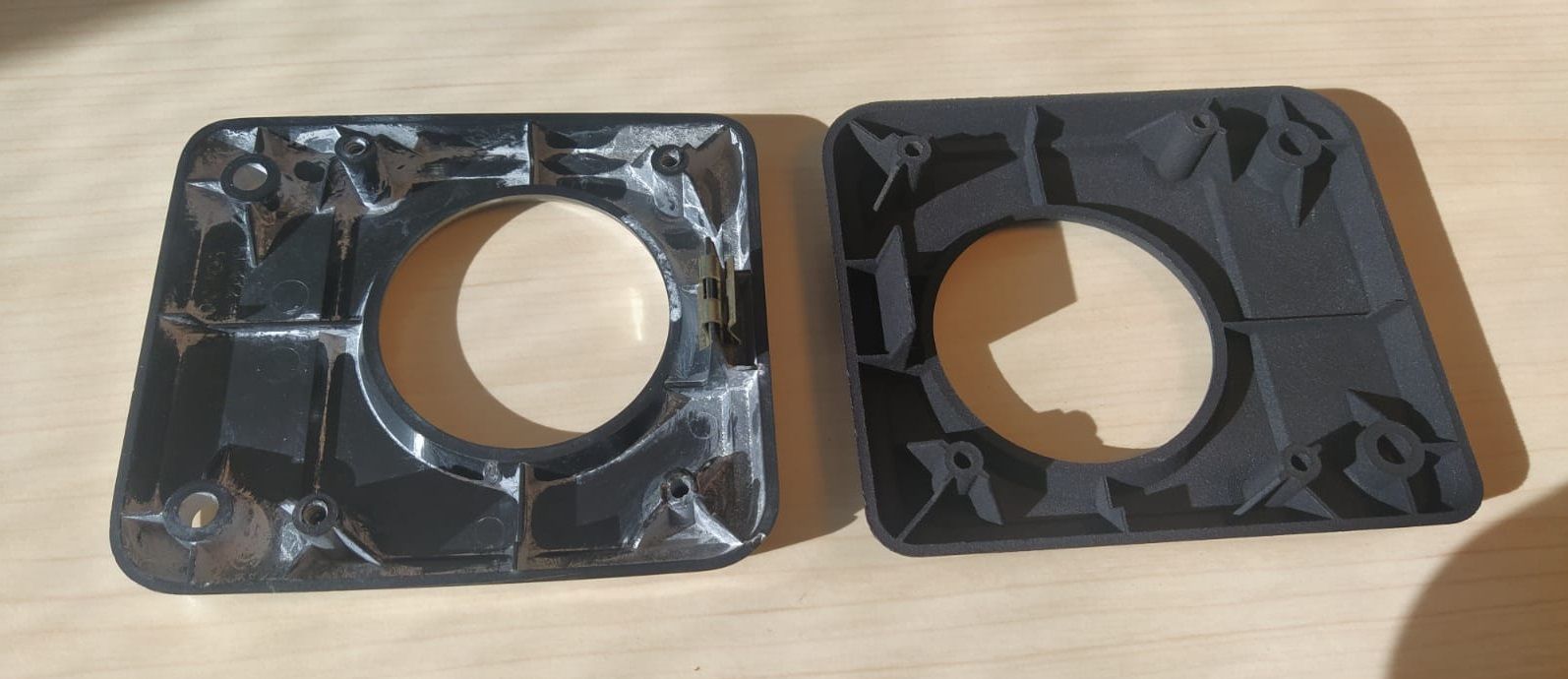

Does anyone know the product number for this metal clip?
The match in all the curvatures is not 100%, the outside edges of the 3d printed version are straight while there is a very slight bend in the original. When you compare them side by side you can tell but I think the match is close enough. I'll sent this bezel back to @wormfood and continue with the project.
