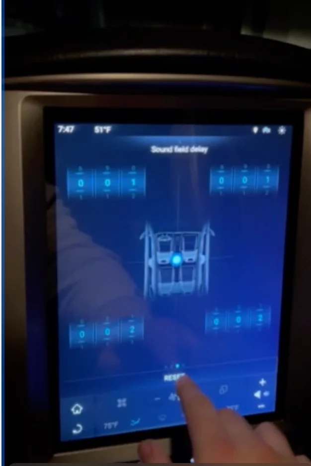

Got this installed in my son's 07 lc. No sound everything else seems to work. Any suggestions
Go to sound field delay screen and set each speaker to a different value. Worked for me but it sounded like s***. But it worked. Ordered a px6 unit to swap out the g6
Settings > Settings > Audio > Equalizer > Scroll all the way right > "Sound Field Delay"
Set each of the 4 values to something different until you get acceptable sound.
