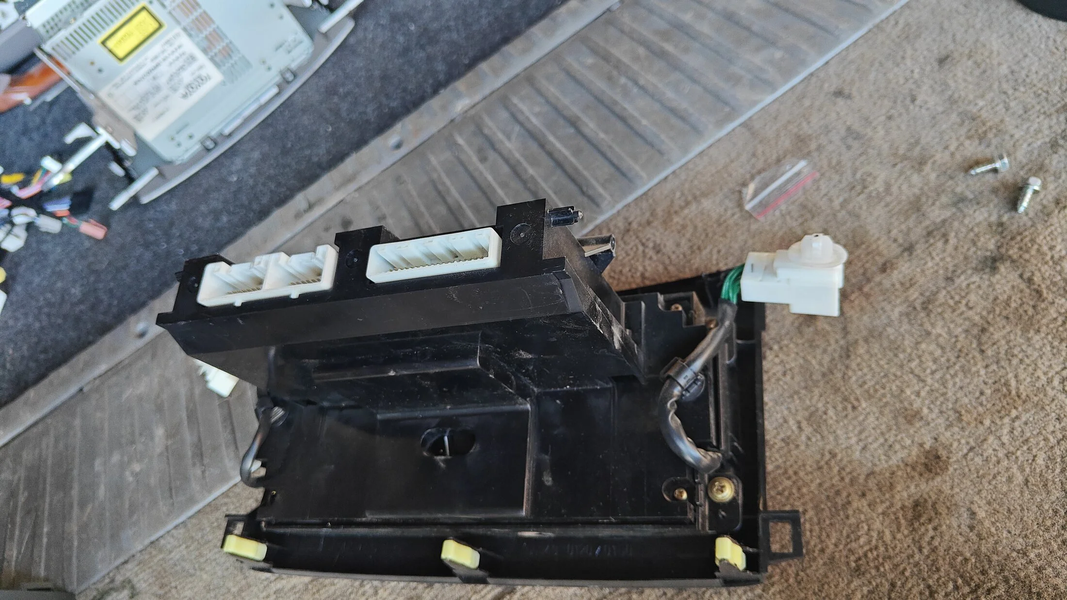

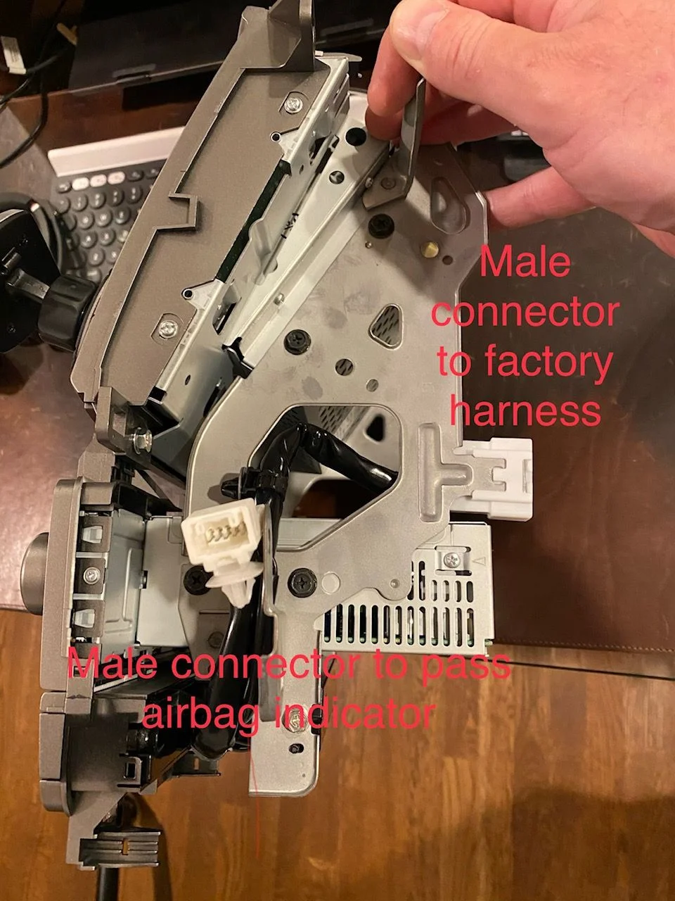

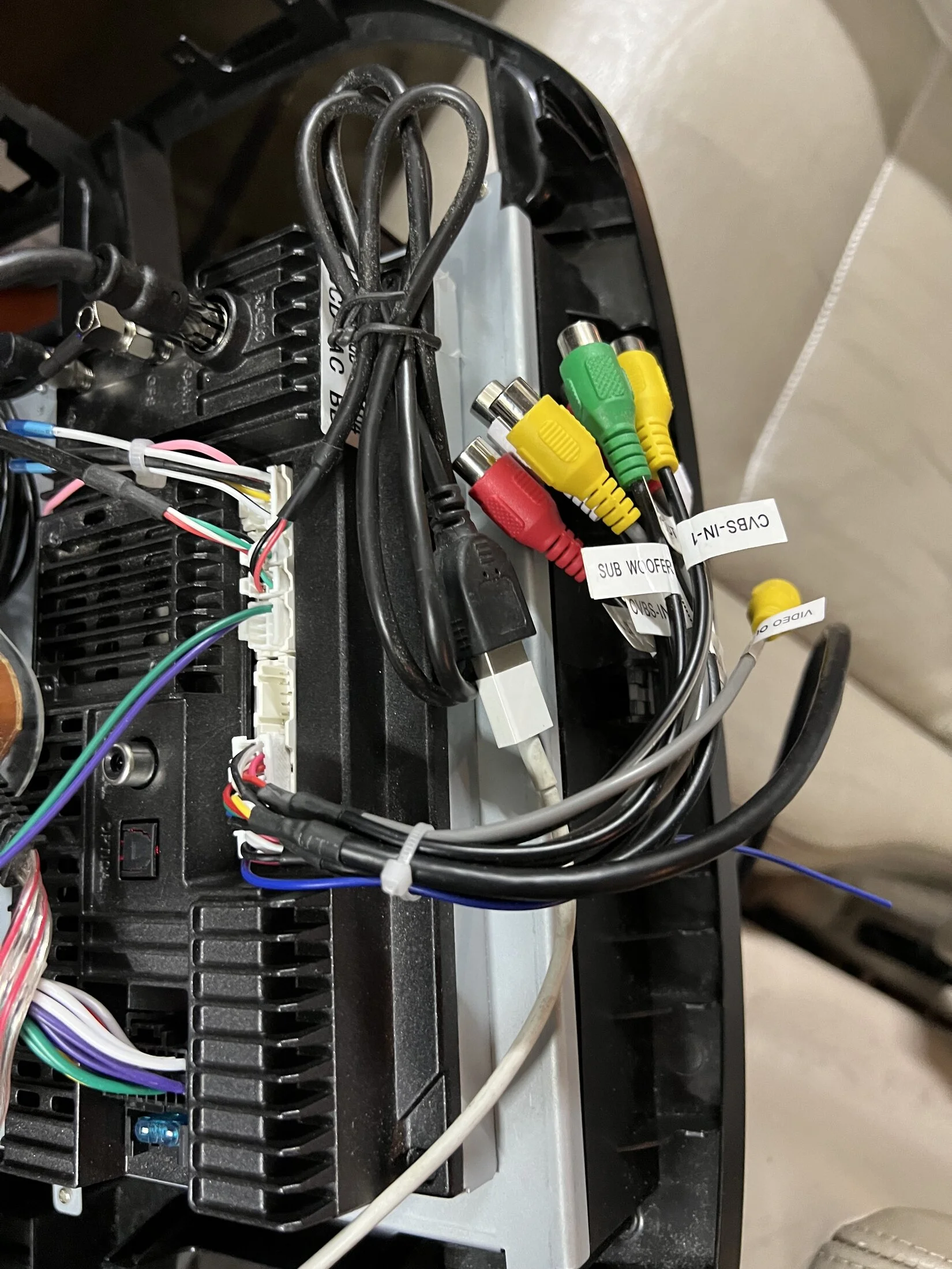

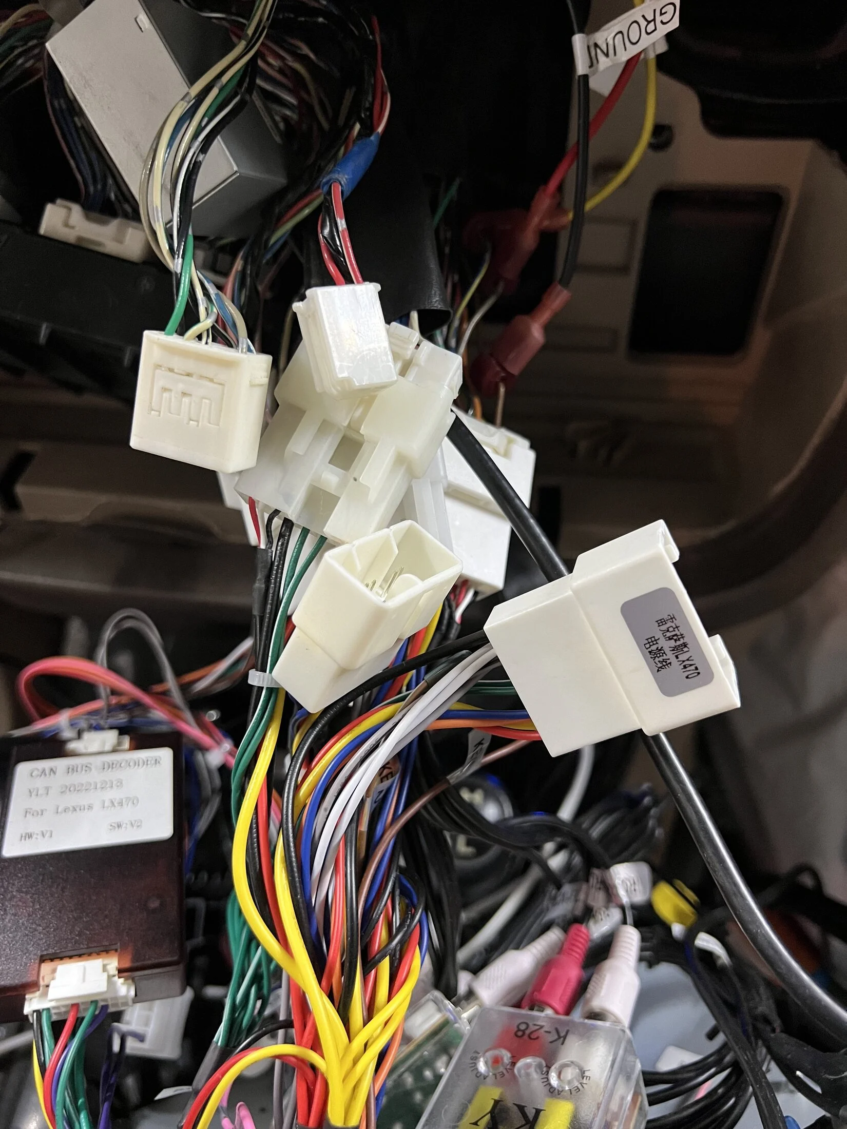

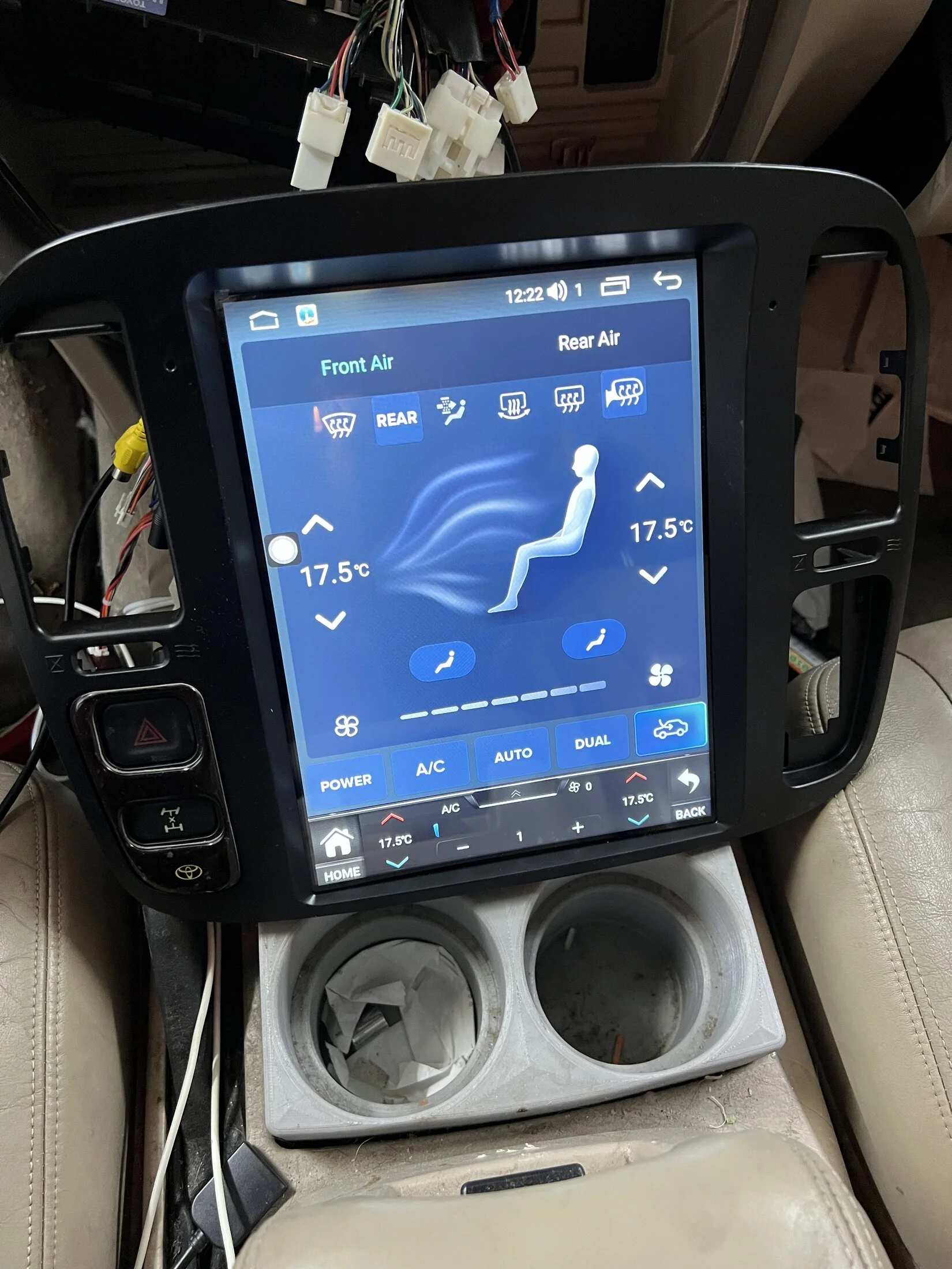

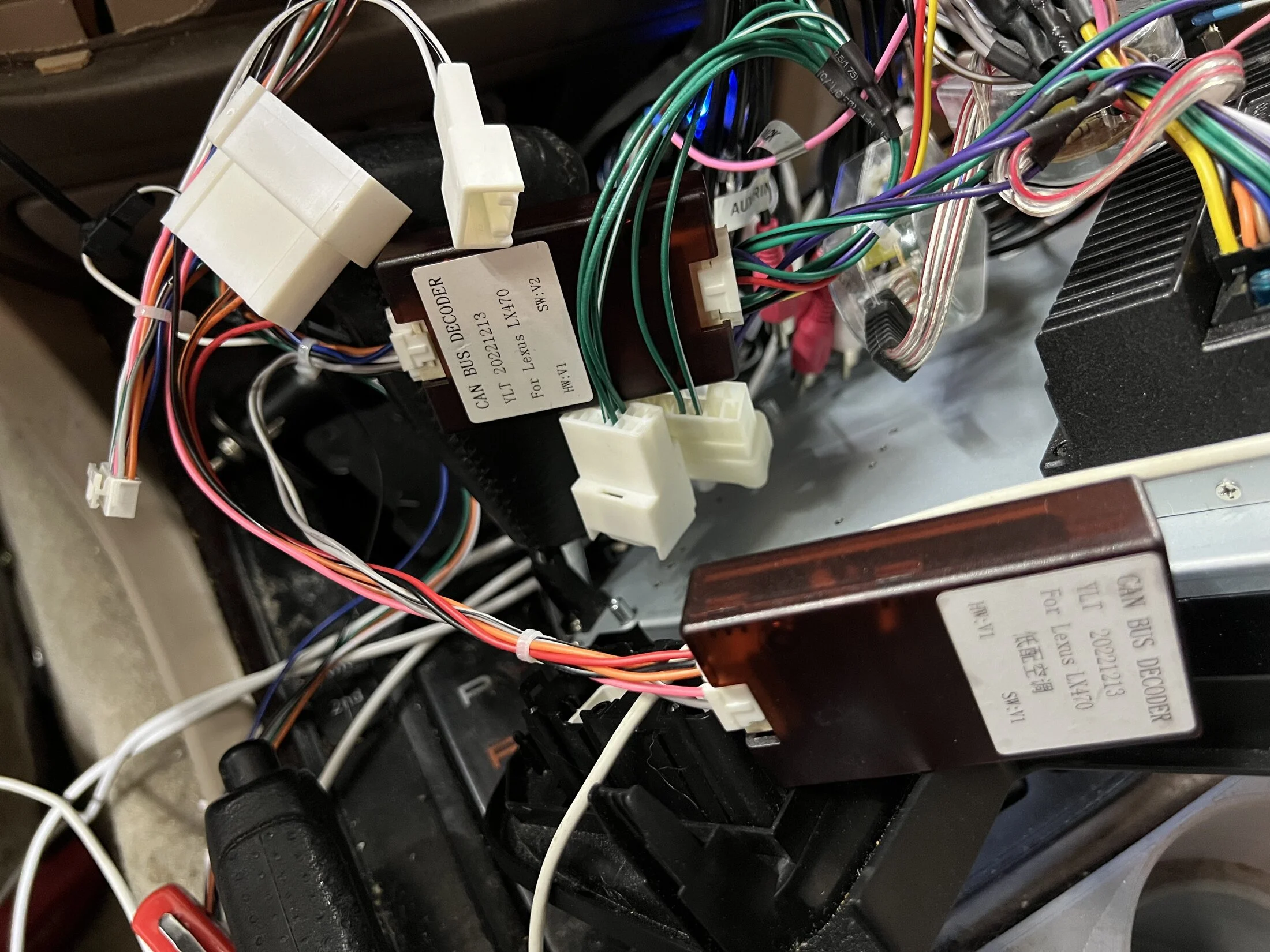

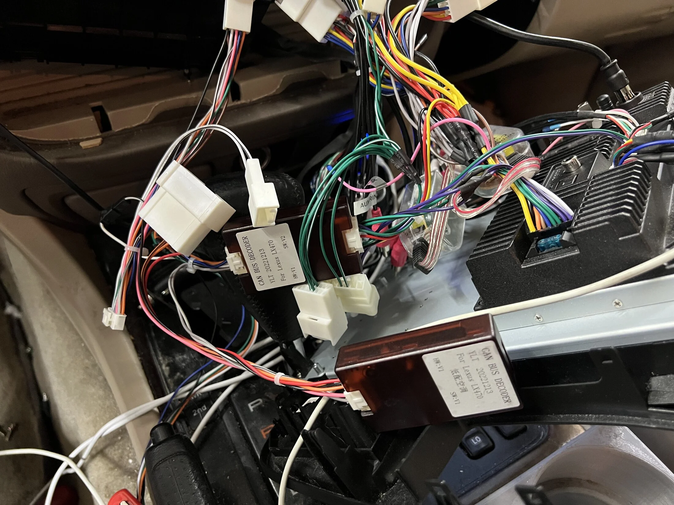

All, I’m attempting to install the tesla style radio in my 02 LC. The kit that i got has canbus units that say “lx470” and i cannot get the climate controls to work with the current configuration. Radio works perfectly. There are also two pigtails/wiring harnesses on the vehicle side that don’t have a corresponding pigtail/wiring harness to plug into on the radio side.
Do i need to do some splicing? Any direction would be very helpful. Thank you
Photo no. 3 shows the two factory harnesses that are unused at the top of the screen.
Photos 4-6 show the canbus and corresponding wires.
Photo 7 is just showing the factory harnesses again.

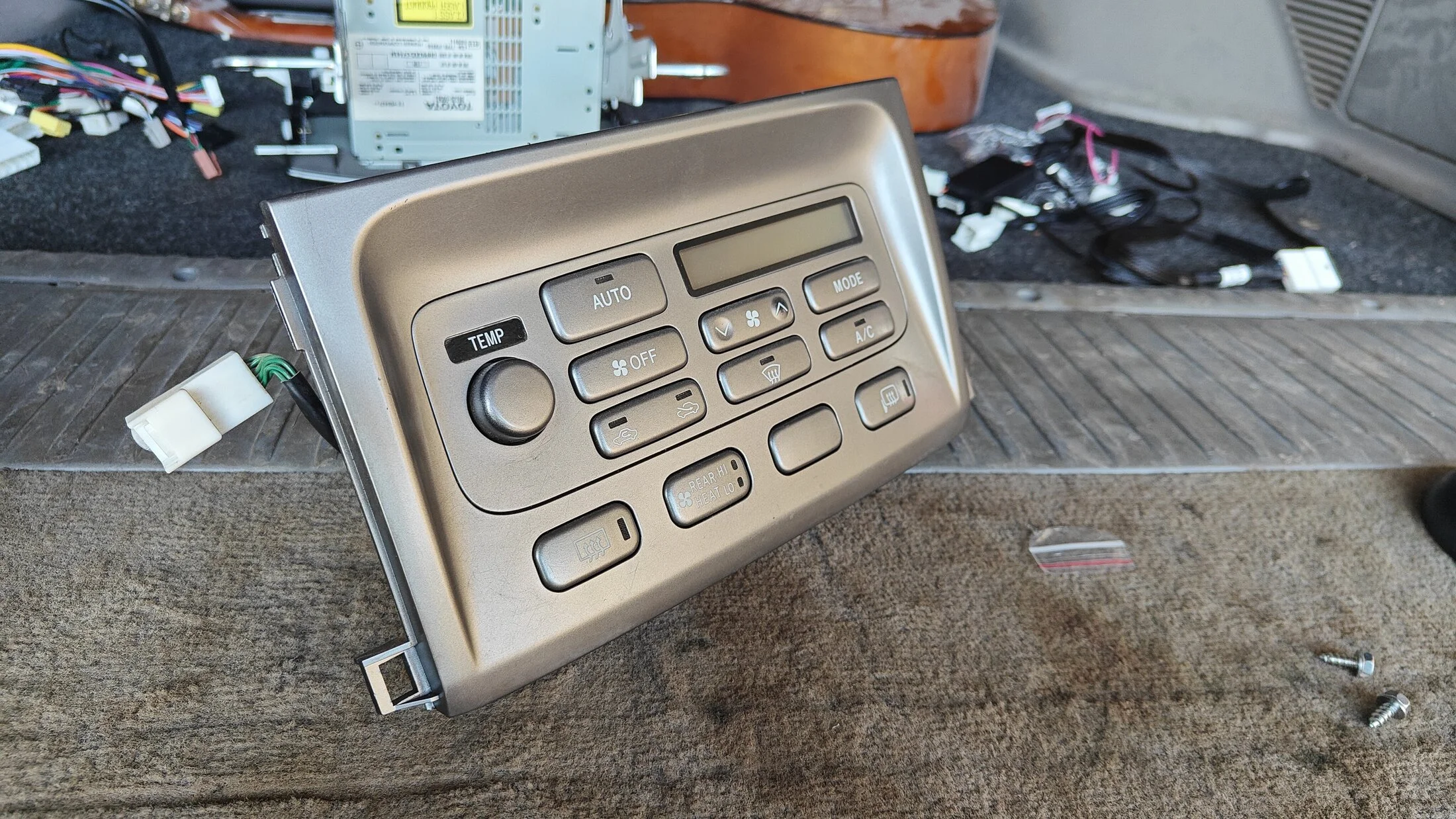

Hello. I was finally going to install a screen in my car. Got it from Phoenix and they got the pictures of the dash and all. But when taking the car apart I realized that it was all wrong. My Aircon unit didn't fit, it was an older one I think. The car is from 2004. The black box will never fit. I the triend to install the harness and see if I could at least fire up the screen. I could mount one plug.
So I guess there's nothing to do but to put it back together. I emailed phoenix being quite unhappy. I don't know if I have to send it back or maybe it could be a different harness.. 😏 Anyone got an idea of what the options are?

You don’t need a phoenix Tesla style radio because your climate control buttons aren’t integrated into a screen.
Tesla style phoenix radios are those cruisers that have climate control buttons integrated into map screen.
Luckily for your car, you can use any regular android stereo.
You're very lucky, I would WAY prefer to have had the manual buttons and a standard smart screen then the tesla style screen. Even though I had a very successful install and it's working great.
I don't feel very lucky, I already have the Teslascreen and was really looking forward to it. What are my options? Return it and get another unit? Or can I get another Aircon box?
Return it and get literally any brand name stereo with out going through all of the hassle of the Tesla style screen. There are people on here that have spent years tracking down what your truck came with from the factory and then converting their truck over to your setup so they can run a regular aftermarket stereo. You won the lottery and don't seem to realize it.

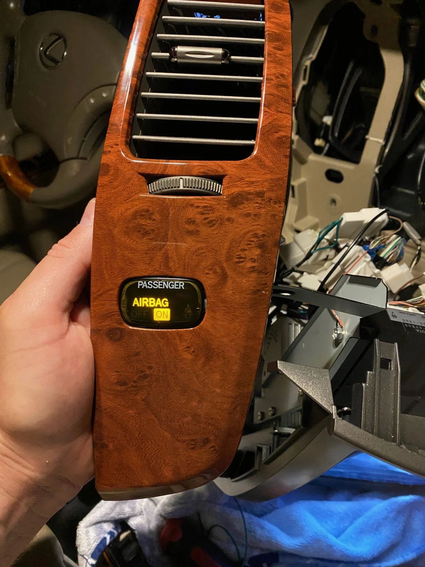

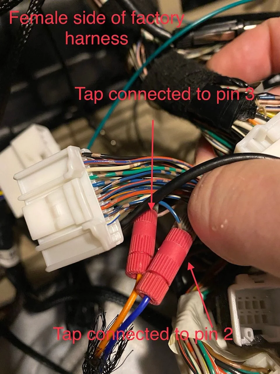

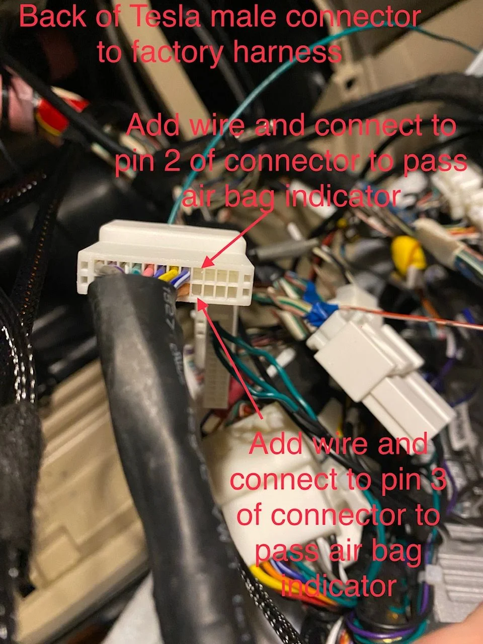

I recently installed one of the Tesla screens after the factory nav screen cracked in my 2007 lx. I was eyeing them for a while and had heard about the airbag light issue for 2006 and later trucks. Here is the solution that worked for me. Hopefully this also works for the late model LC and non-US guys.
This is a picture of the passenger side of the factory system. These connectors are what links the passenger airbag light to the rest of the air bag system. Your Tesla system will replace both of these with new connectors but is missing wires, resulting in a failed SRS check and dashboard airbag MIL.
These are the Tesla replacements. To solve the airbag light issue, you need to add two wires where indicated.
If you're like me, you won't have the necessary wires/pins laying around. Luckily, your Telsa unit came with two versions of the harness in question: a "high" configuration that you use for LC/LXs with a nav system and the "low and medium" configuration that isn't used. The low and medium version has wires with pins that fit the male connector to the passenger airbag indicator. In my case, the other end did not have pins that fit the connector to the factory harness. My solution was to cut two wires from the unused harness at the end that I didn't want (i.e., cut the end opposite the connector to the passenger airbag light indicator and remove the pin ends from the unused connector) and to use posi-taps to tap these into the factory harness wires that correspond to the marked pin holes above. In my factory harness, that meant I tapped pin 2 to a blue/black wire and pin 3 to a brownish wire. Once done, you will have 4 total wires going to the passenger airbag indicator (the two that came with your Tesla unit plus the two you just added). I have also asked my seller to send an updated harness so I can remove the taps later and will post a pic of the updated harness if they send one. Hopefully they will start shipping these with the pins already included at some point to address the issue.
Before putting it all back together, connect your passenger airbag indicator light and test for normal operation. The dashboard airbag light should turn on for about 6 seconds during the SRS test when you first turn on the car, and then it should shut off. After the SRS test is complete, the passenger airbag indicator light should be off (i.e., neither "off" or "on" illuminated) when the passenger seat is empty. With light pressure on the passenger seat (~30 lbs, but I can't remember the exact number from the FSM), "off" should be illuminated. With the weight of an adult in the passenger seat, "on" should be illuminated. If your light is displaying "off" when an adult is in the seat and "on" when there is light pressure on the seat, your pin 2 and pin 3 are reversed. Switch them and retest. The passenger seat belt indicator should be off when the seat is empty or occupied with the belt buckled and illuminated if the seat is occupied and the belt is unbuckled.
Once everything is confirmed working, button it all back up and enjoy your Tesla screen. I think it's a solid upgrade to the original system if you are willing to put in the time to set it up. As an aside, I bought mine from Phoenix Automotive. Everything functions as it should after some time fiddling with the settings and pulling the front seat to tap into the TV ECU for the reverse cam feed from the OEM camera as shown earlier in this thread. Phoenix takes 24 hours to respond to questions (and sends these annoying automated "acknowledgments" that they are working on your message) but does provide support and was instrumental in finding a resolution to my airbag issue. I got capped out at 5 pics in the post so pic of my set up is in the next post. Just need to get some OEM vents with proper clips and a better screen protector, and I'm good to go.
