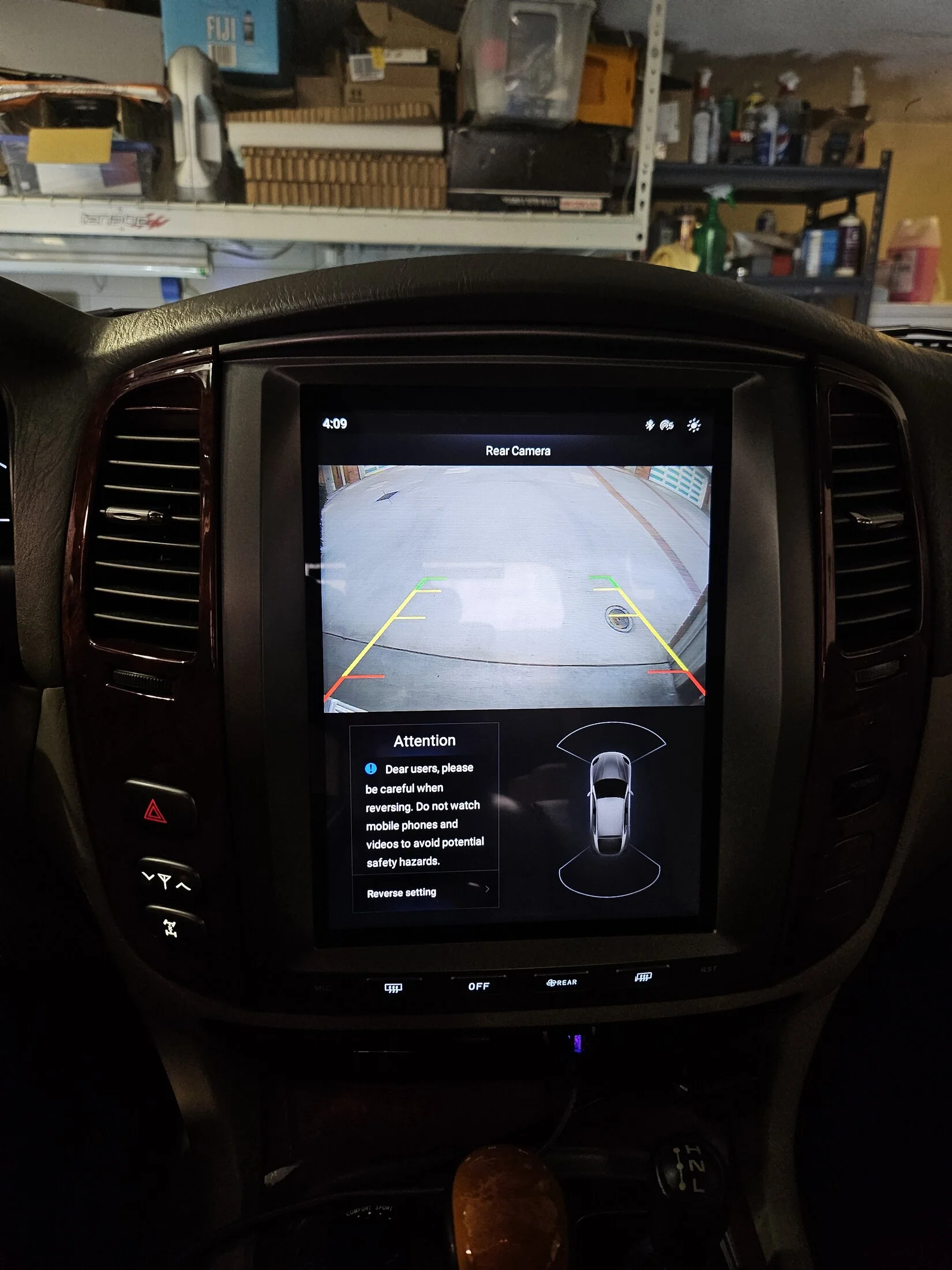

I got the OEM camera to work, tapping into the parking assist unit under passenger seat

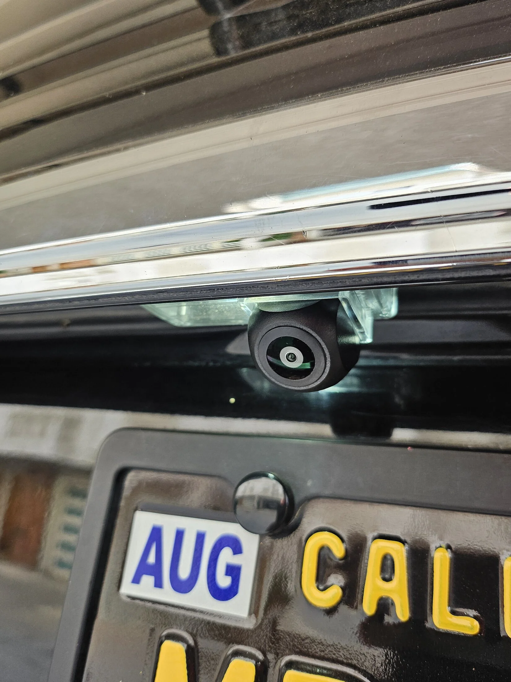

I really like that there is a near OEM looking camera! What model did you use?
I actually had to buy one from Phoenix and to the get the part that replaces the factory licenseplate light with one that has a camera built-in from Amazon, tested both cameras and the one that came from Phoenix was higher resolution 720p vs the one that comes with the Amazon unit that's NTSC. Then I removed the camera that came with the Amazon one and swapped in the Phoenix audio one, it is a direct fit.
Would you mind sharing which one you bought on Amazon?
I did have to tweak it a bit myself to get it to fit properly however, just like the reviews said, it fits very loose. I had to use a heat gun to bend the tab out on the one side to make it more like the OEM one. I also cut pieces of thin adhesive foam I had lying around to make a gasket so that it would seal against the body to keep out dust and moisture.
