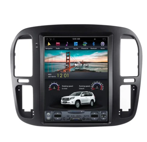

I found this link (opens in ALIEXPRESS - no i'm not an "affiliate") that shows the touchscreen style radio/head unit with integrated HVAC controls mounted in an older model LX470. Anyone have luck with this? For $759, it's about the price of a broken nakamichi replacement AND broken HVAC control replacement.

I have a 2002 with the Nav screen. I know you have to do a lot of wire splicing to convert it back to the standard HVAC controls. I wonder if this is designed to directly replace the Nav screen unit or the standard contol. I do like the idea of this.
Cheaper option here if anyone wants to be the guinea pig. This one looks like it only works for non-nav models but not sure. From what I can tell no one has been able to get the 03+ tesla unit to work properly so I'm not holding my breath that this will actually work.

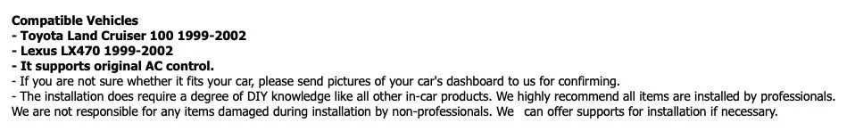

On the web, the Chinese vendors seem to advertise both LC & LX applications w/o OEM navigation.
It has been my understanding that the non-nav HVAC controls are "plug compatible" between LC & LX, but I don't know about if the boards are interchangeable in this "transplant".
It is my understanding that the OEM stereo connectors are different between LC & LX, so I'd expect a different harness would be required/supplied by application.
