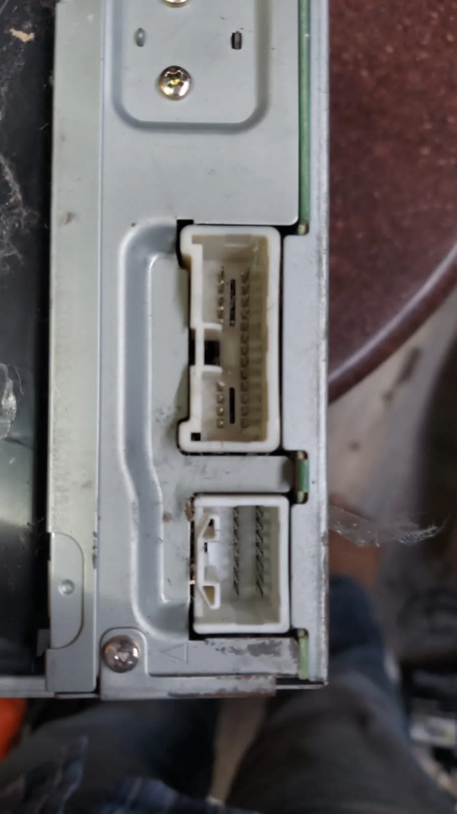

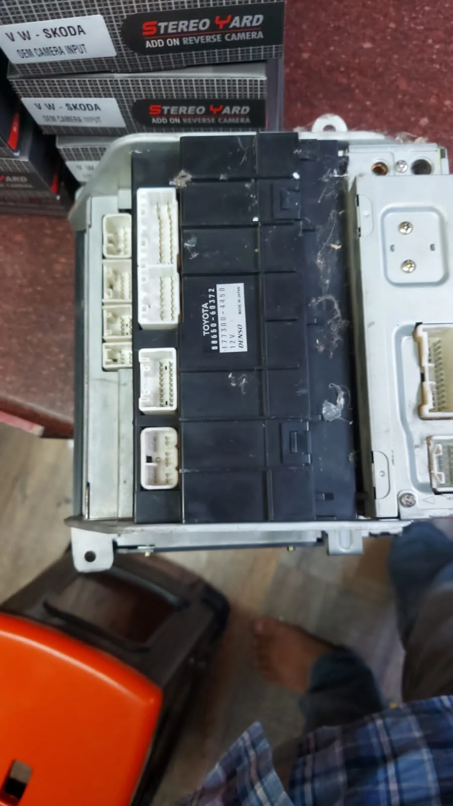

Hi, did anyone manage to get an update on the pre 2003 JDM specific nav screen? I've got a JDM HDJ101K and I've been trying to get an android head unit without trying to go down the nav delete route.
This is what my factory nav looks like. The connectors on the back seem different to some other pre 03 nav units
