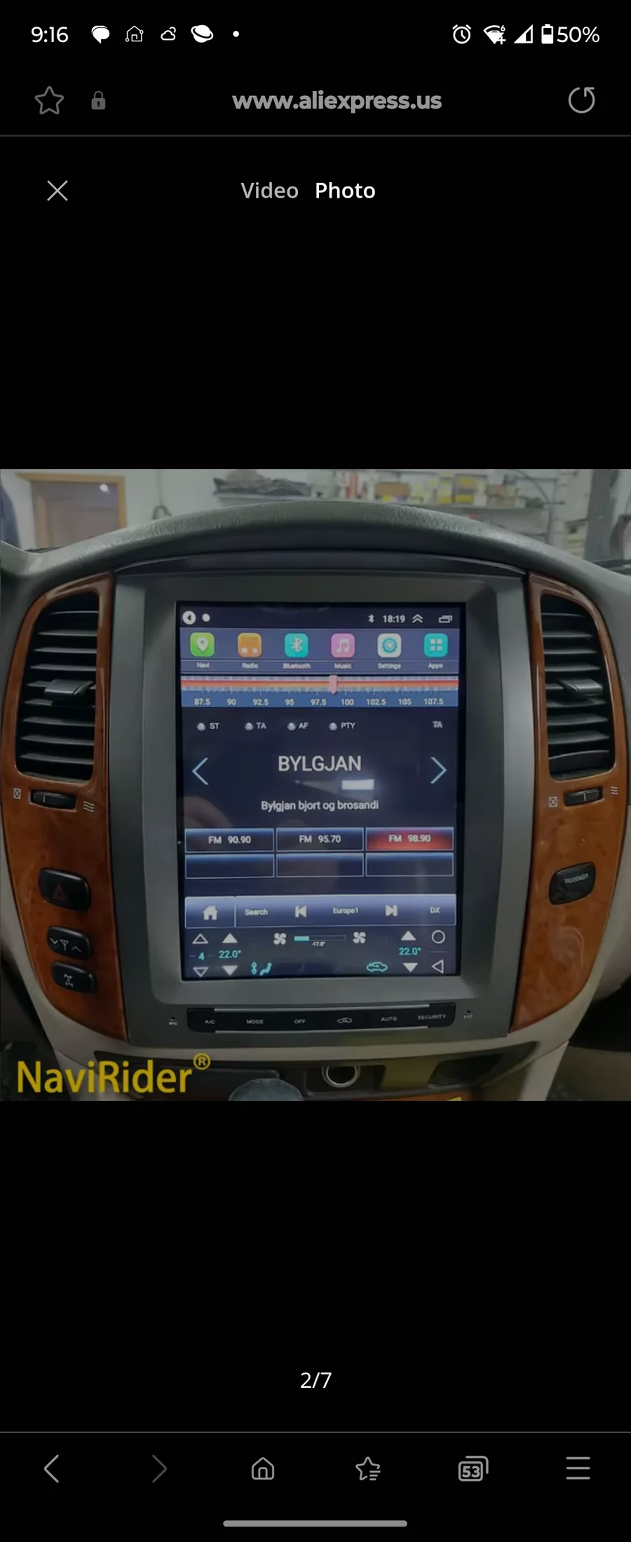

Curious - has anyone tried one of these yet (pic below)? They are octa core processors (not the Phoenix g6 model). They distinguishing feature on the front is the silver trim along the buttons. Their memory specs are way better, so maybe a better outcome with newer product?View attachment 3789142
Pile on question, if you have tried it did you add a 360 camera system and if so which one? Looks like NaviRider makes a system I would assume would be compatible. The new head unit plus 360 cameras would really be a huge modernization upgrade if they work.

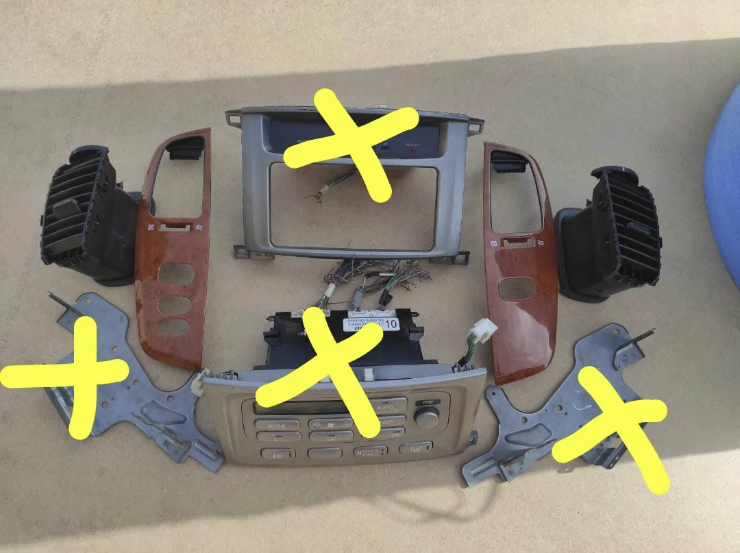

I can get you all of the conversion parts. I've got an 06 LC and have the parts marked in yellow on their way to me and can get another set or two.
That would be amazing! Sending you a PM.
Circling back on my post above. I've been hit up by a few folks for LC and LX swap parts. The LC parts are the ones marked in yellow in the pic above. The LX parts would also include the 2 side pieces that are not marked. My contact assures me he can get enough sets of the swap parts for both LCs and LXs to cover the folks who have already hit me up and and at least a few more. Send me a PM if you're interested.
