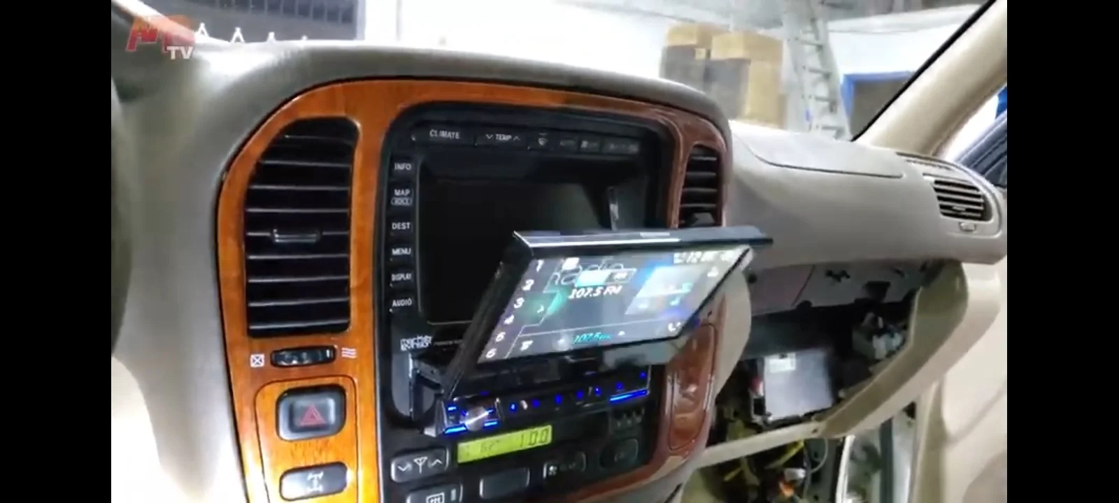

Hey Fitterblue, the Tesla Style Screen is only compatible with non-nav Land Cruisers. Your Land Cruiser is a nav head unit so unfortunately you cannot install the Tesla Screen.
BUT! I have an alternative for you if you're still interested in upgrading your Land Cruiser.
You can install one of these Single Din 7 inch Flip-Out Android touch screens.
Theses Flip-Out Screens basically have all the functions the Tesla Screen has (because they're both powered by Android)
It only has a smaller screen that's all.
