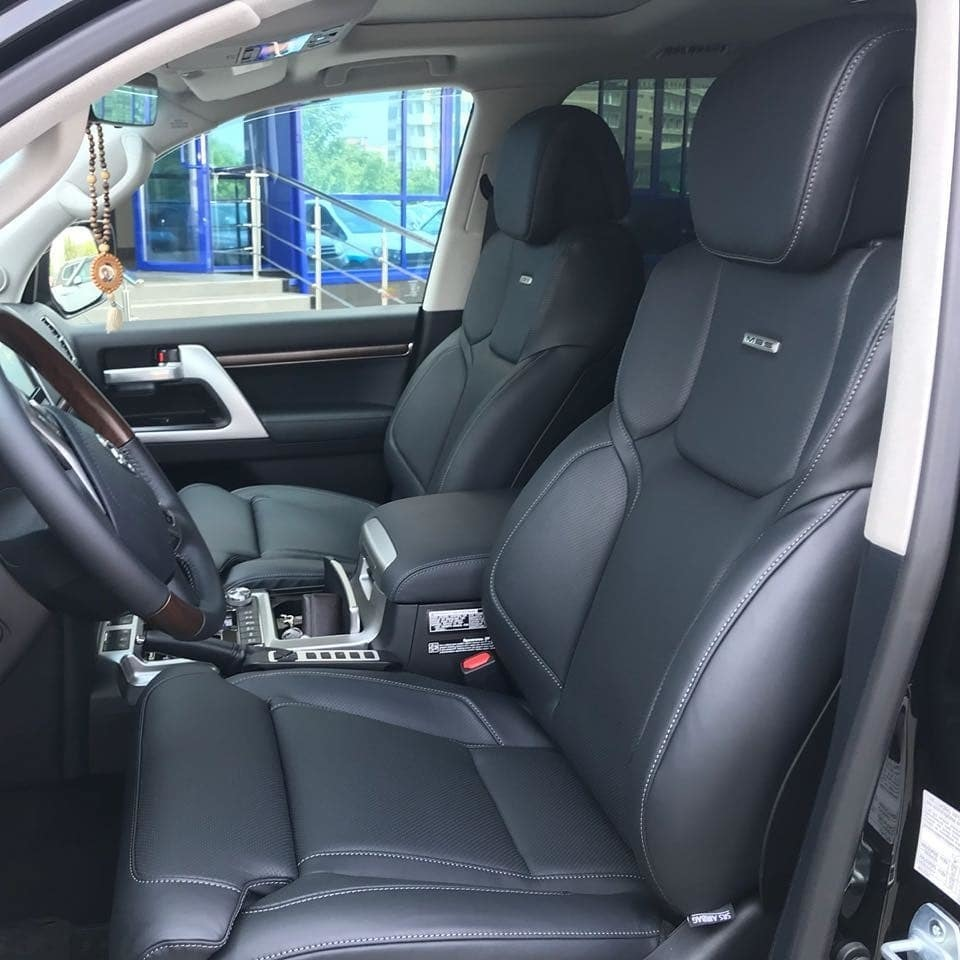

I know MBS seats are hard to get here in the US and they are Russian made... They do use the frame and parts of the OEM seats including the OEM airbags. I would not mind getting the parts and DIY as long as there are some semi decent instructions on how to hook up the electrics.
Those look awesome

Those look awesome

Thanks man. I spoke with the folks at Scheel-Mann today to clarify. With the seats comes a kit which consists of wiring and resistors to make the airbag light go away and allow it to function. This is only for the passenger side, as the drivers side is good to go as-is.

If we just could get these MBS parts for a reasonable price. That would be the amongst the most enjoyable DIY projects I can imagine.
I've asked the European contact for pricing and the set of front seats is app. 4400 USD plus shipment, taxes, customs fees. Check the link for their catalogue. For me personally, a 100% payment in advance is a no go, chances to receiving your money back from Russia in case of trouble ranges from slim to none... Below is the offer I got (1000 RUB is some 10,2 USD):
