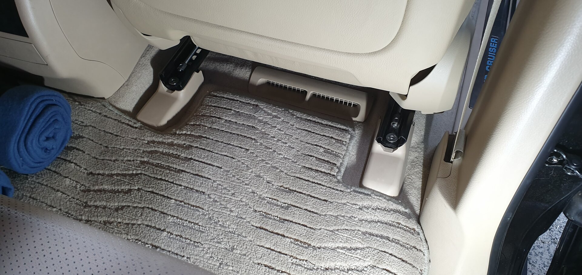

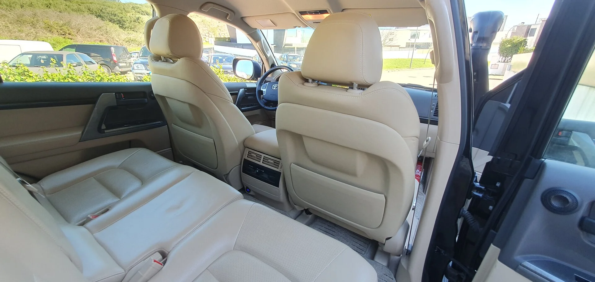

After some time "off", due to Christmas, New Year's Eve and a lot of work at the shop, in 2024, I've managed to find some time to change the leather on the seats from the original color to the most look-a-like in the car, since the seats on this TOYOTA are vynil (nappa?) instead of real leather.
The armrest is made of rubber, although it looked like the seats... It's now also leather!
This is the only photo so far, I think I'll have everything ready tomorrow and will start installing them in the car.

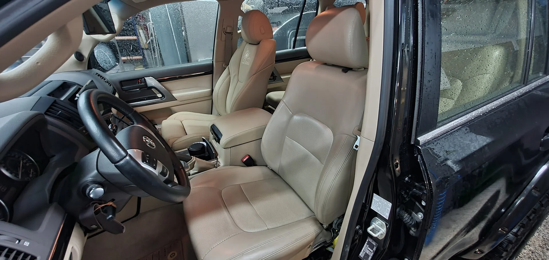

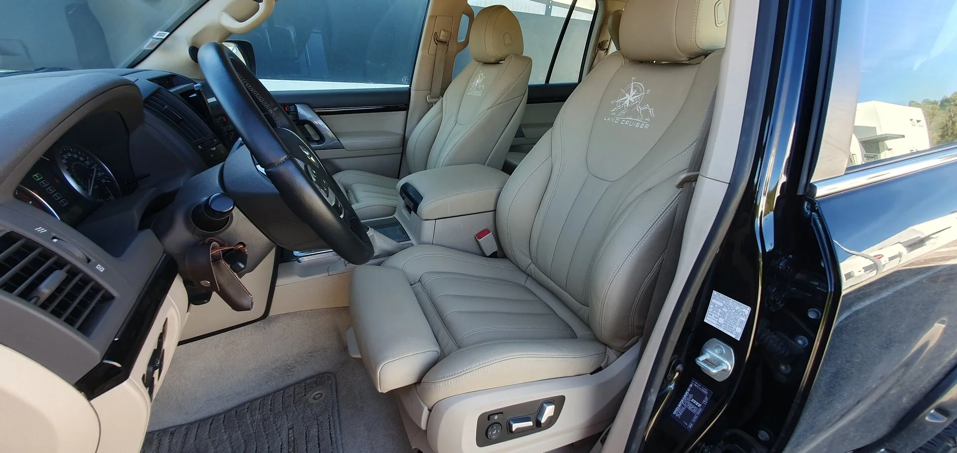

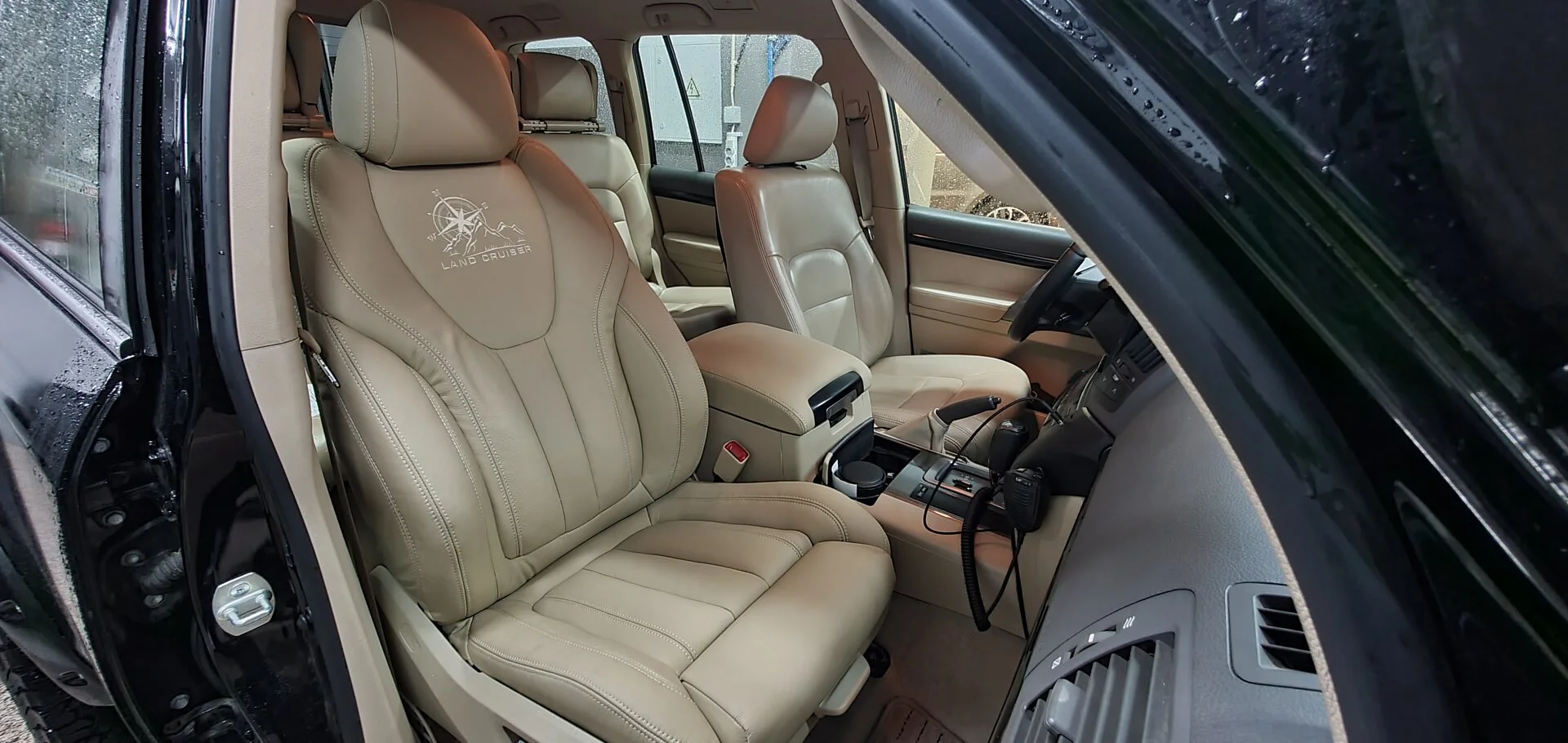

Both seats now in place!
The driving experience is completely different, a lot of grip on the back and you are really seated for driving, instead of just sitting there trying to hold on the steering wheel and door cards on some wild tracks while a bit over the normal speed...
Everything is working as intended, except for some plastic trimming that is going in place in the next week.
I've decided to color code every bit of the plastic parts on the BMW seats, so this will take a while to complete.
I'll post some pictures of both seats tomorrow.

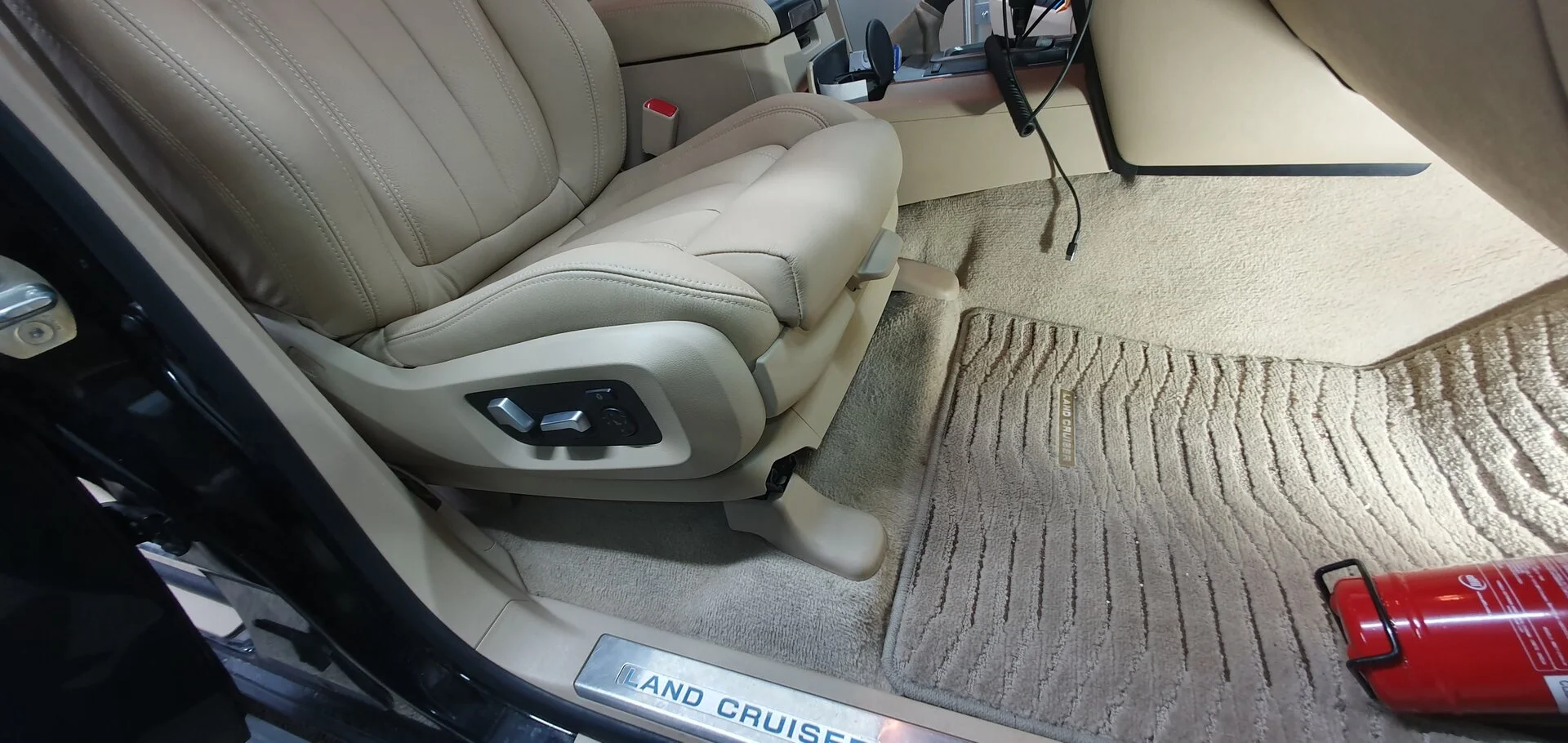

It was an odissey to have everything as intended and a lot of work to have them in place.
TOYOTA doesn't sell the brackets that hold the OEM seats to the car, these are the trick to have everything working properly, I took them from the original seats and welded them to the new seats, creating some adapters to compensate for the difference in width (fortunately just less than 1 inch).
If it was simple, I would offer a pair to you, no problem.

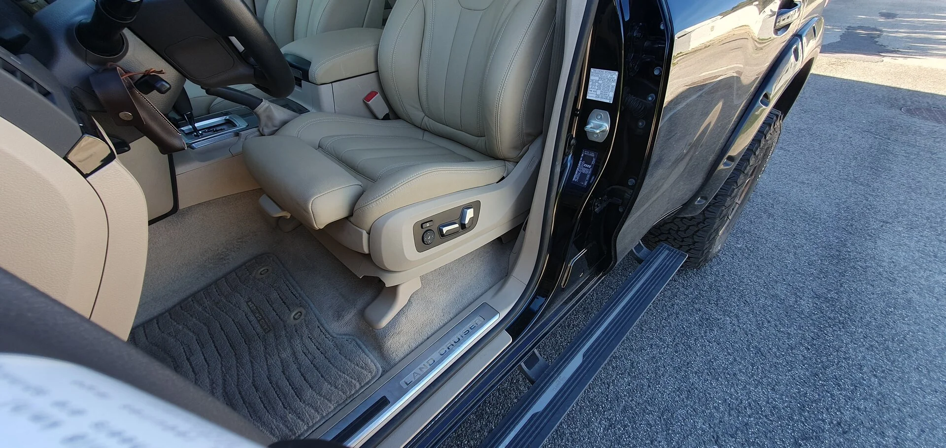

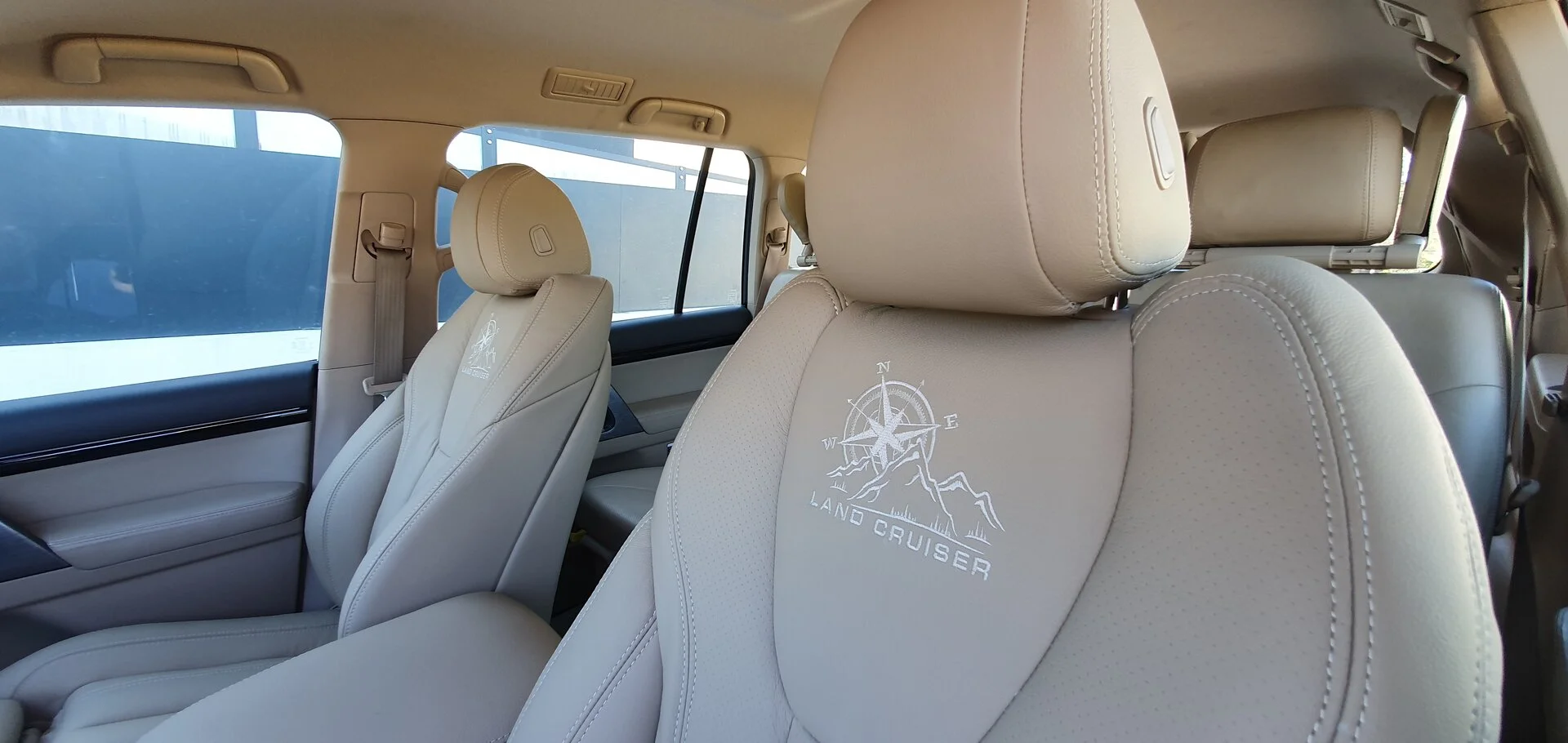

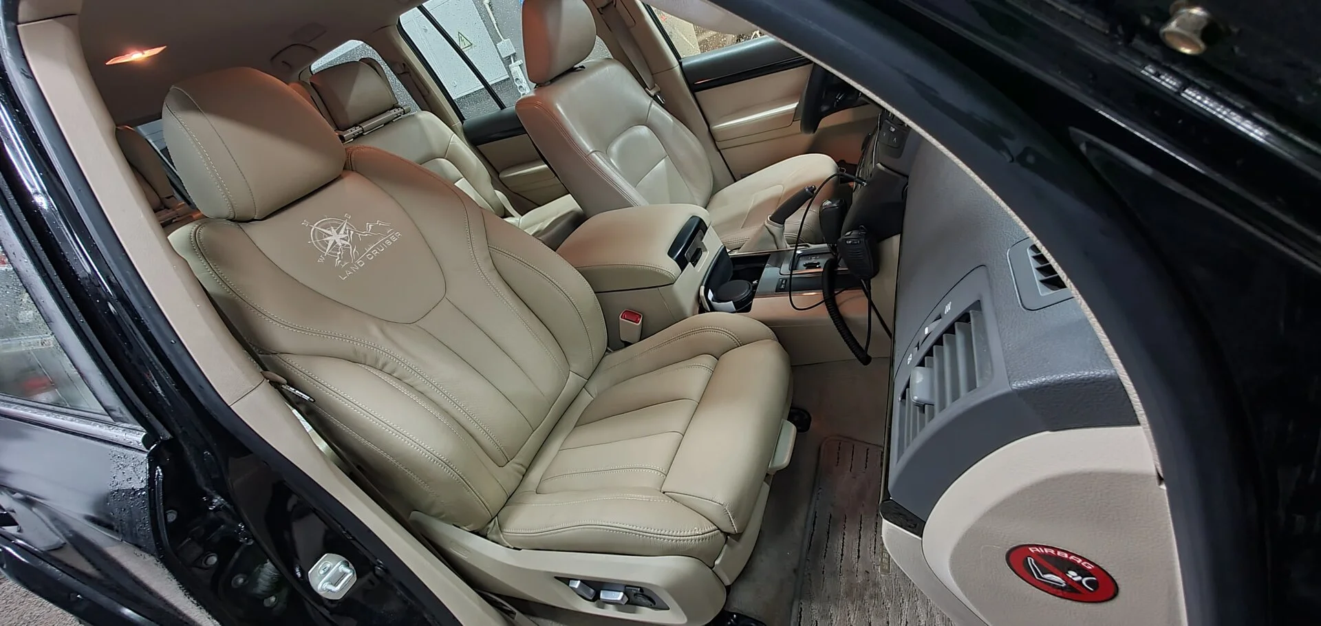

It's done! Finished, complete!
The smell, touch, feeling and overall comfort is totally different from the OEM seats in this version (GX-R) that were like kitchen chairs...
I've tried to keep the fittings as OEM as possible using the OEM brackets, bolts, covers, etc. and this is a mistake!
The amount of work needed to keep those is more than the benefit and the main issue is it doesn't let the seats be bolted in a lower position than the OEM ones.
Maybe I'll get back to this in a near future, I would prefer a lower driving position, although these are at the same height as the OEM ones.

Thanks, don't be jealous, it's not that difficult to pull a stunt like this.
You need to find some seats that fit the spacing between the TOYOTA seat rails, I found that BMW E, F and G series are more or less the same length and width, so I started there.
The second thing to do is having them working on a bench, 12V power supply (no more than 2 Amp in my seats) and test them, specially if the donour car has front memory seats, you'll probably have to get the non-memory front seats button console and modify the harness in the seat to have it all working flawlessly.
Upholstery, if needed and it's just some drilling in the OEM TOYOTA brackets you pull off the OEM seats.

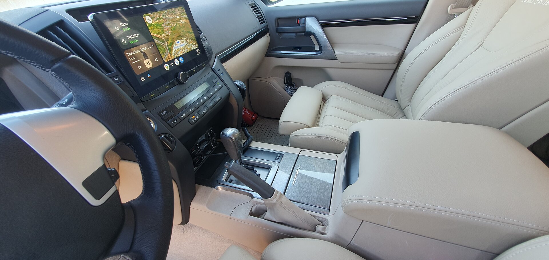

What’s that dash setup? An iPad mounted over the stock screen? Looks good.
The dash setup is possible on a non-navigation LC200, since the A/C console is independent from the headunit.
The headunii is a KENWOOD DMX-9720XDS (AV Multimedia systems • DMX9720XDS Features • KENWOOD Europe - https://www.kenwood.eu/car/navigation_multimedia/multimedia/DMX9720XDS/), maybe different in other non-EU markets but probably the same chassis so it will fit.
The main modification to the dash, apart from some trimming inside, is the hazard switch that went to the roof, next to the interior light switches.
I choose this headunit because it's capable of 4 High-Res cameras, also from KENWOOD, completely different from the ones that come OEM and a lot better than some aftermarket ones.
