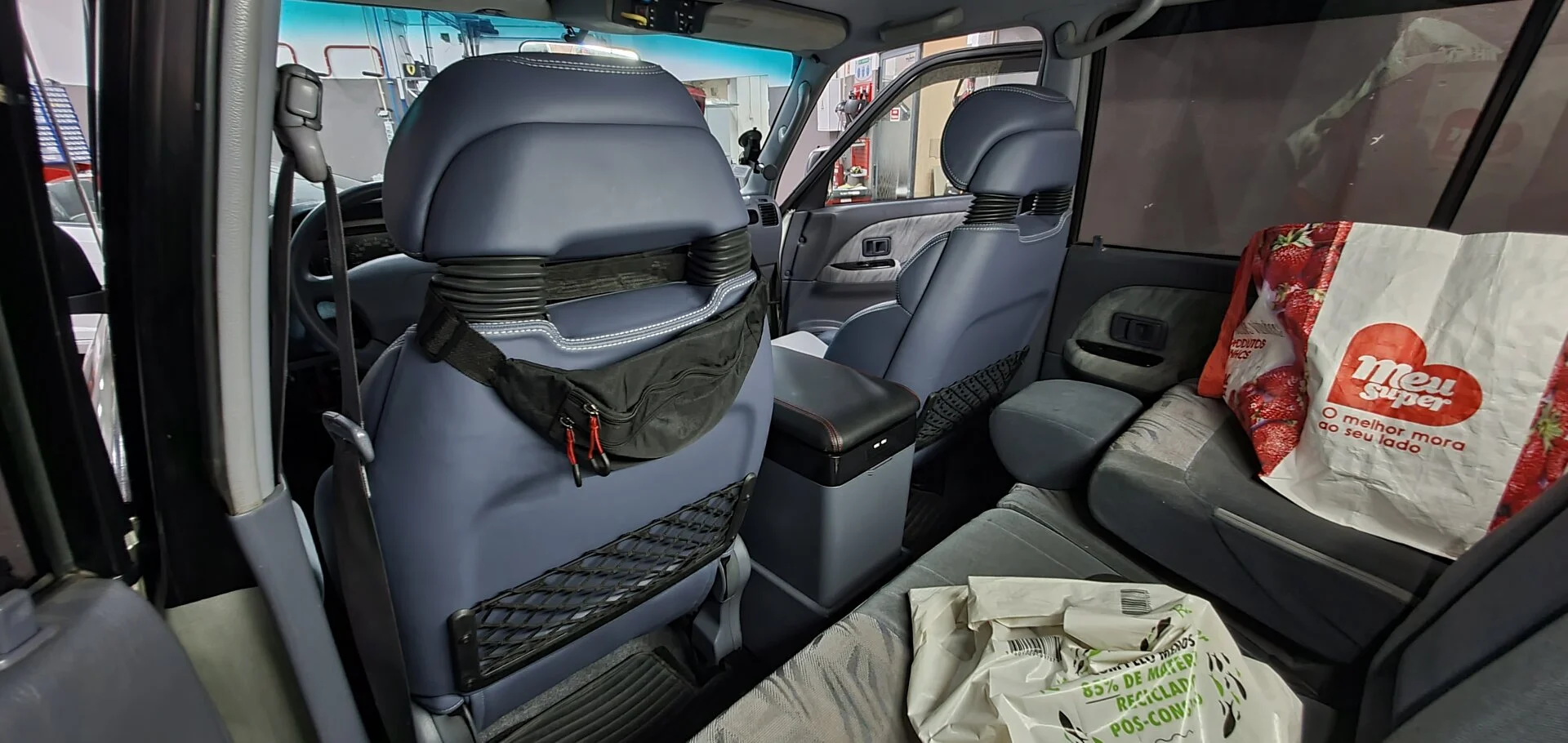

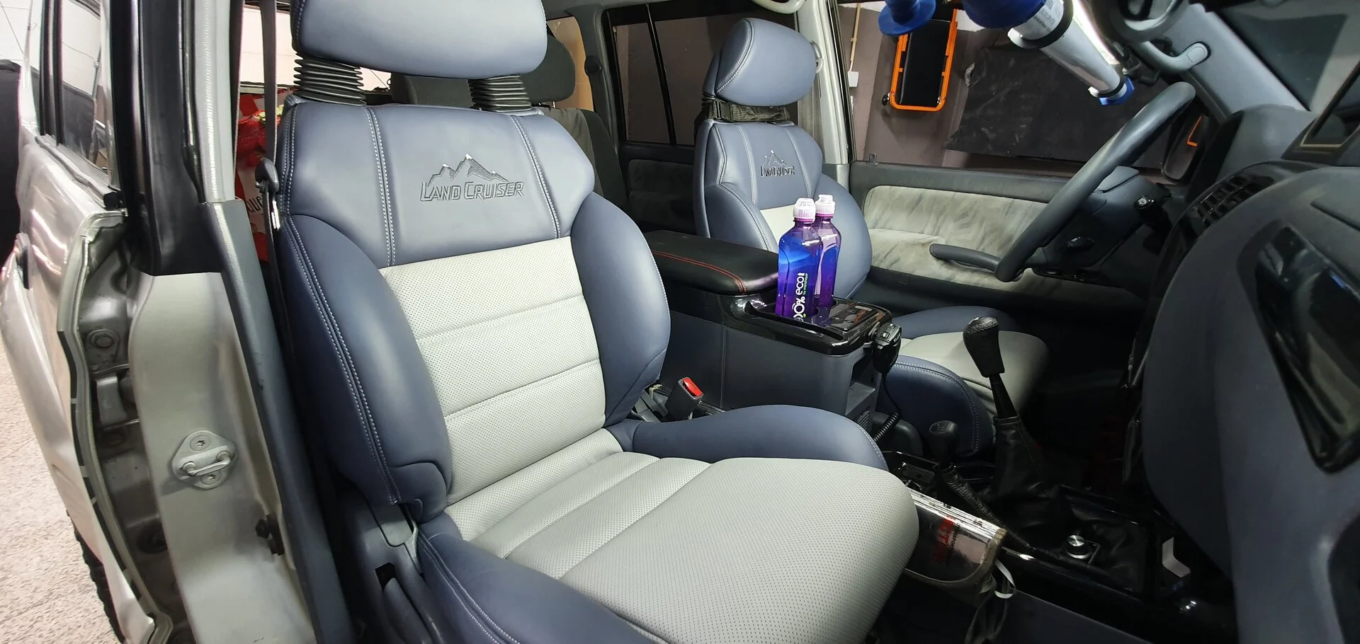

I did an upgrade on a 2001 Prado 95 I also own, using CELICA's Carlos Sainz edition front seats, something that turned out great and quite comfortable.
What options do I have, if someone already did it and what seats did you use?

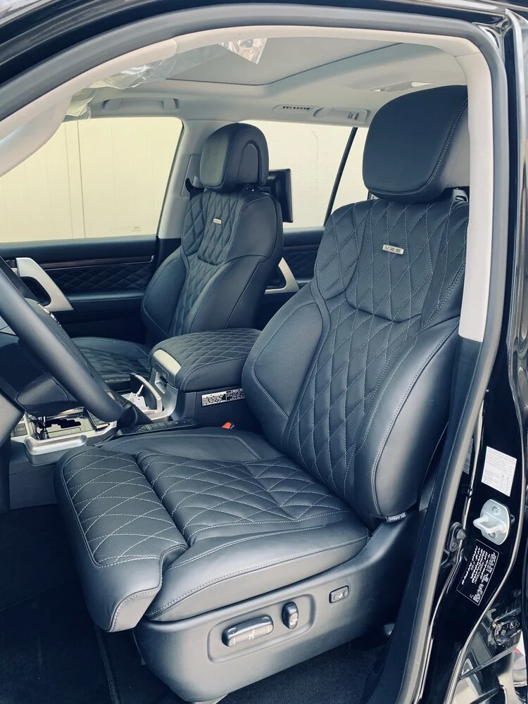

The (black) MBS look like they have airbag tags on the lower portion of the side bolsters?

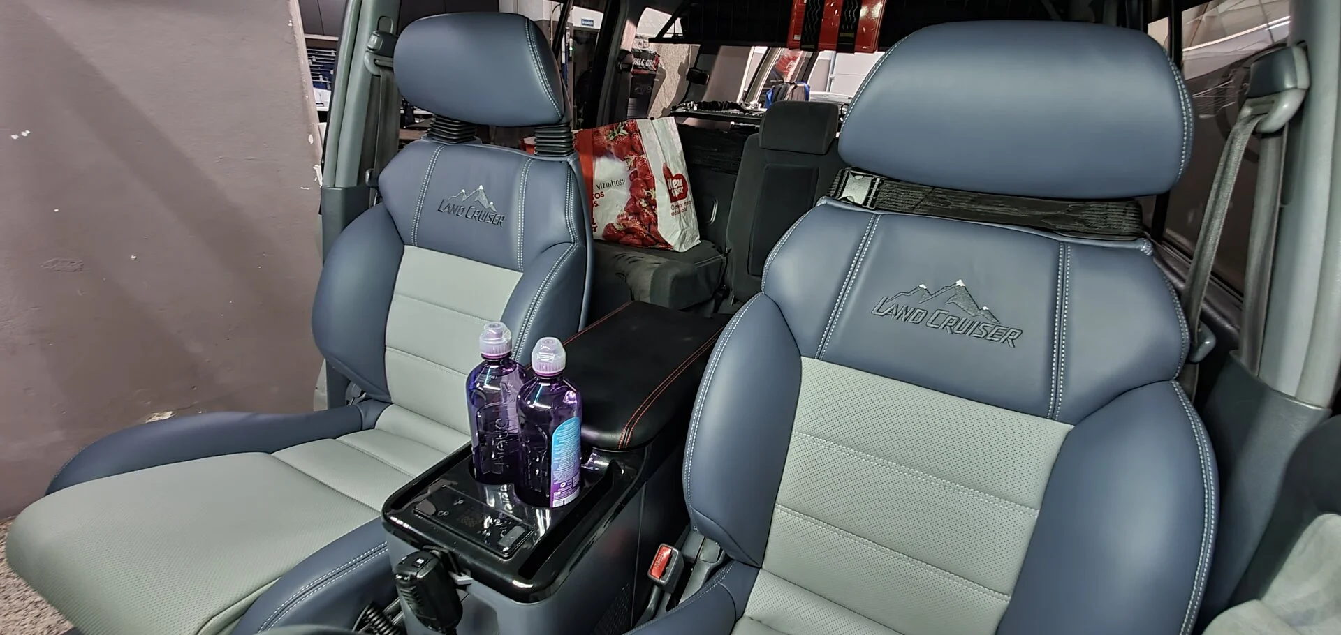

Here is the write up on Paul May's rig (owner of Equipt) on Expo. I think the biggest challenge is the airbag sensors.
