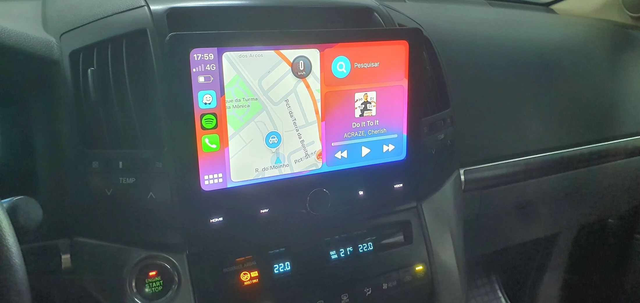

I'm a professional Car-Audio installer, in Portugal, this is my personal overlanding vehicle so time and labor is done by me with costs to my family, health and mental sanity... :bang::bang::bang:
I would recomend finding a professional in car fabrication, modification or similar with some experience in electric and electronic connections and functioning, depending, of course, on the seats you are installing, mine were last generation BMW so Can-Bus protocols are different and one needs to find the correct solution for it to work.

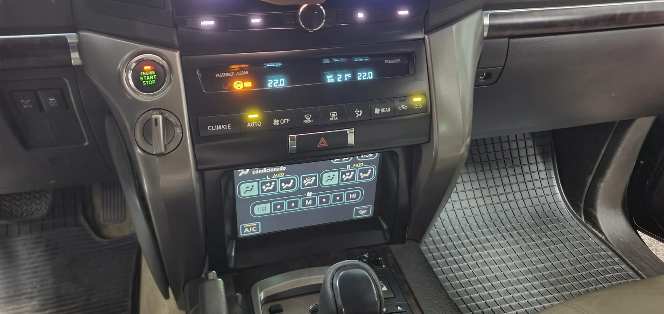

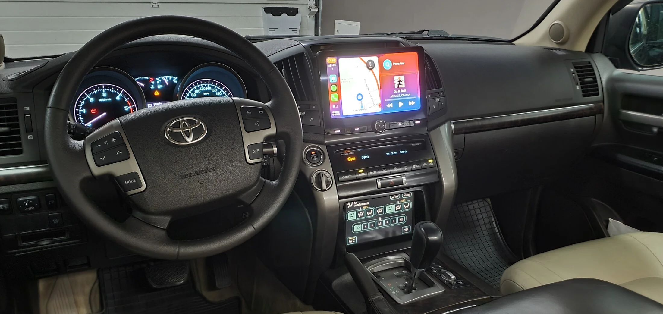

The dash setup is possible on a non-navigation LC200, since the A/C console is independent from the headunit.
The headunii is a KENWOOD DMX-9720XDS (AV Multimedia systems • DMX9720XDS Features • KENWOOD Europe - https://www.kenwood.eu/car/navigation_multimedia/multimedia/DMX9720XDS/), maybe different in other non-EU markets but probably the same chassis so it will fit.
The main modification to the dash, apart from some trimming inside, is the hazard switch that went to the roof, next to the interior light switches.
I choose this headunit because it's capable of 4 High-Res cameras, also from KENWOOD, completely different from the ones that come OEM and a lot better than some aftermarket ones.

Since my last post I've done some other VDJ200, with KENWOOD and recently with ANDROID (TESLA look) rádios.
One of the KENWOOD's was installed on a full navi JBL headunit and that was a PITA!!!
Along with the dash modification we needed some fabrication for the integration of the OEM screen, since it controls the climate, front and back. It's not that difficult but still a lot of work to do and it looses the ashtray, cigarette lighters, etc.

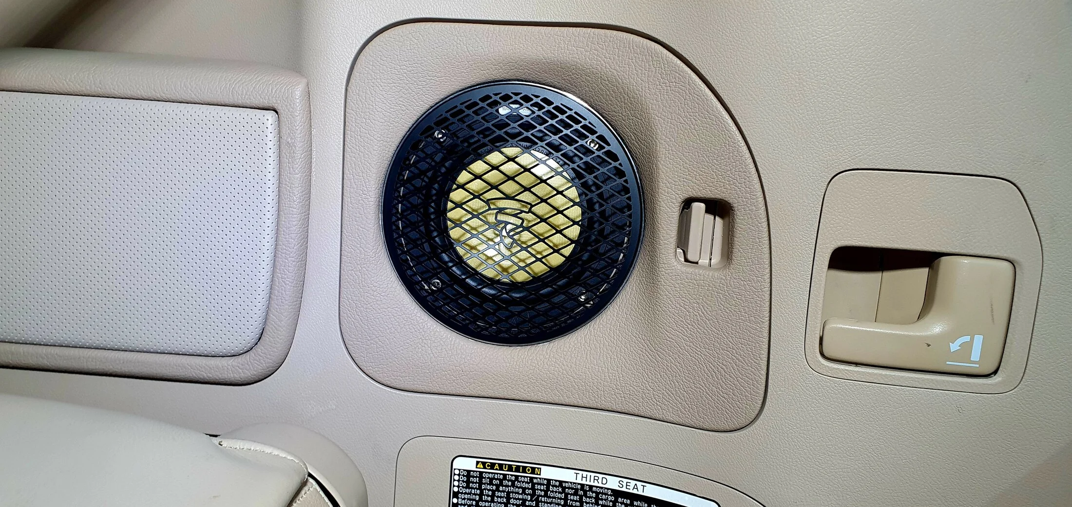

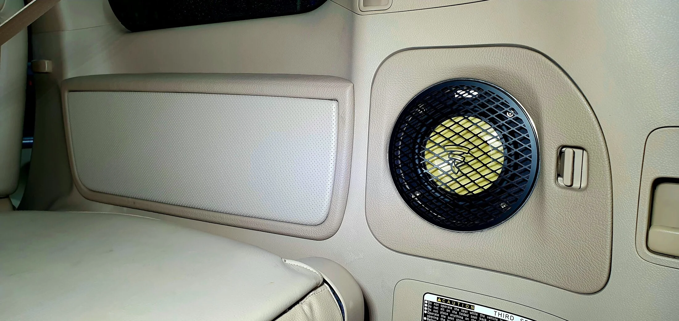

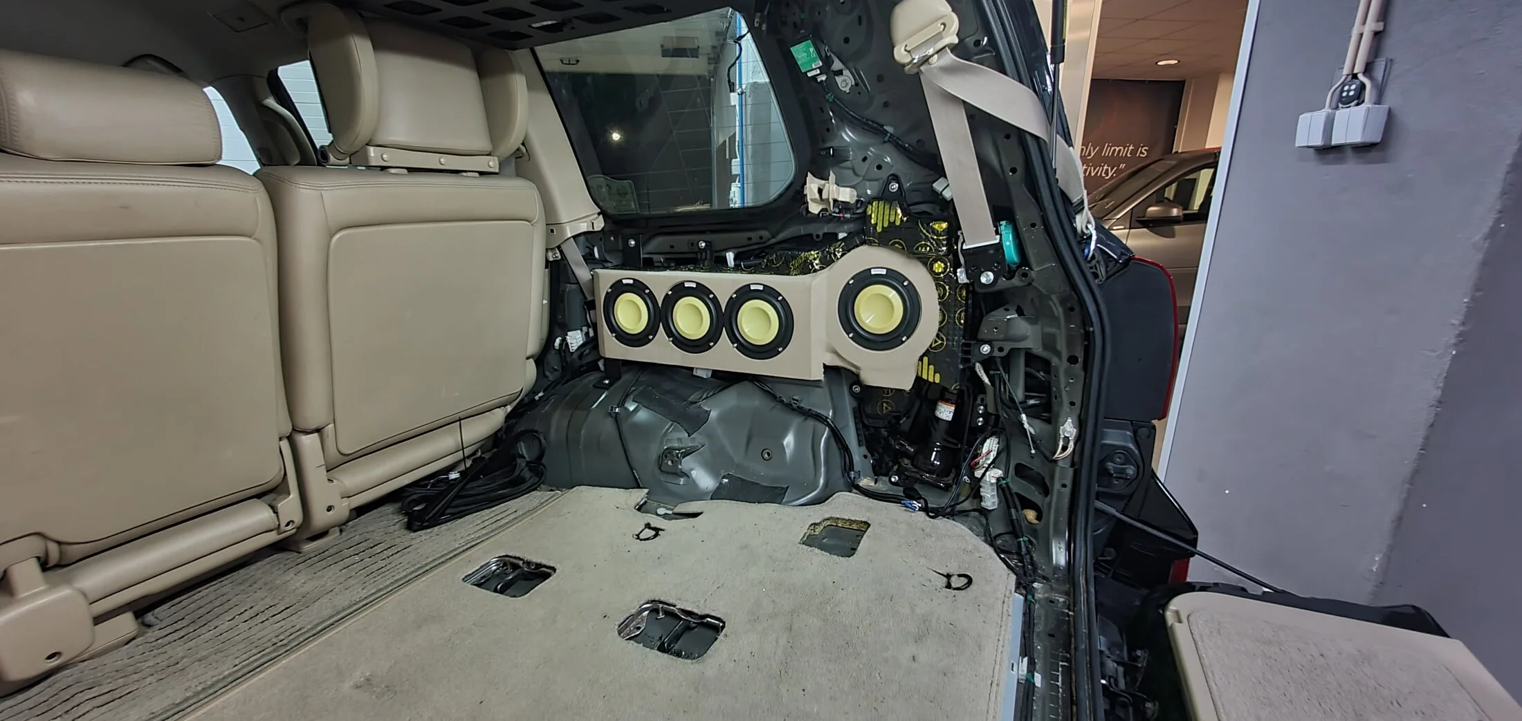

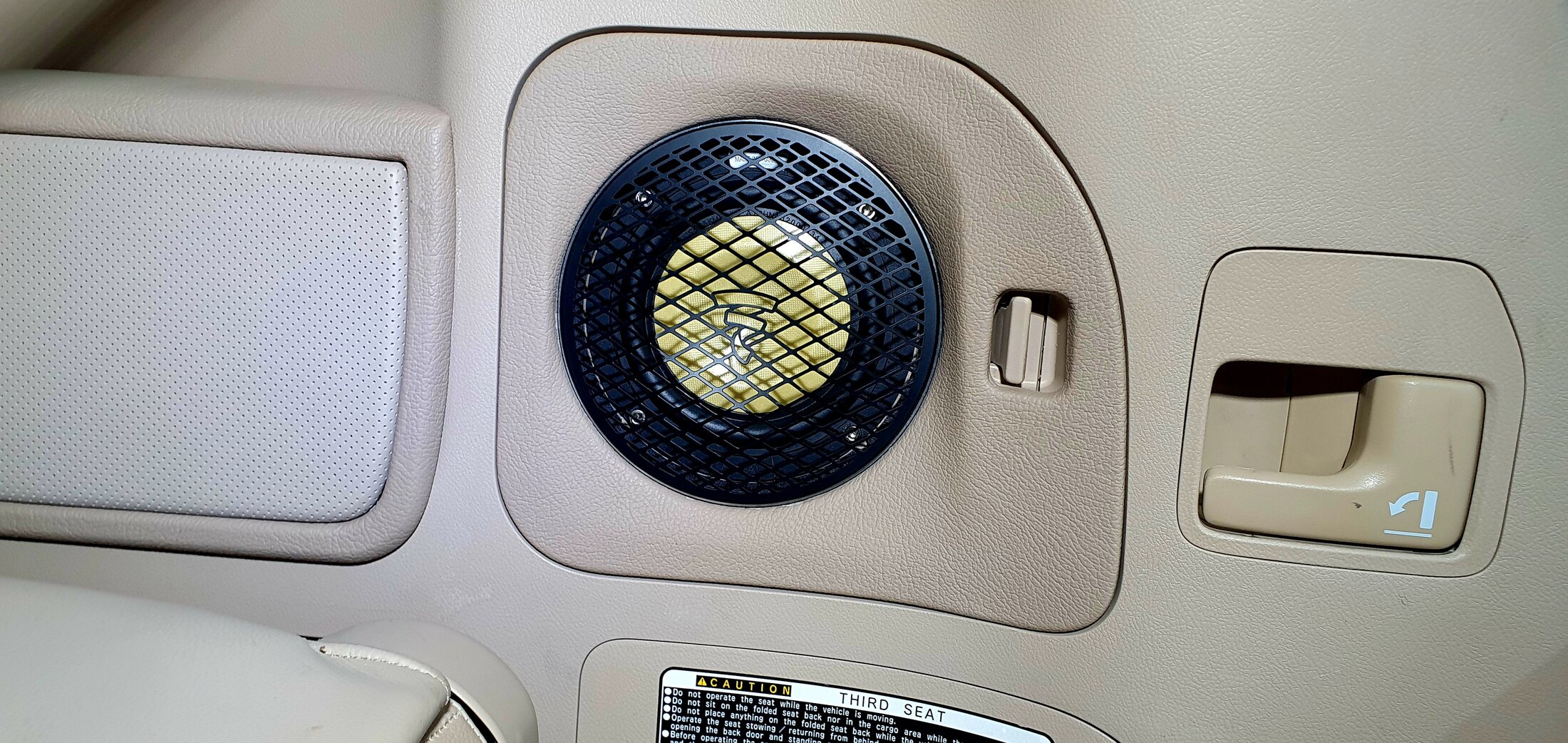

I haven't shown the audio system on my car yet, mainly because it's not completely finished (when you do this for a living you tend to let yourself behind... 🙄) and also because I started with some class D amplification and crossovers but now I'm going class AB and full active on all speakers.
I'm using the new FOCAL K2M speakers range together with MOSCONI PRO amps and DSP.
I've done a major sound deadening on the doors and rear panels, installed all speakers and built some tweeter pods on the "A" pillar, will have some photos ASAP except for the subwoofers that I can show you now how I've done it.
