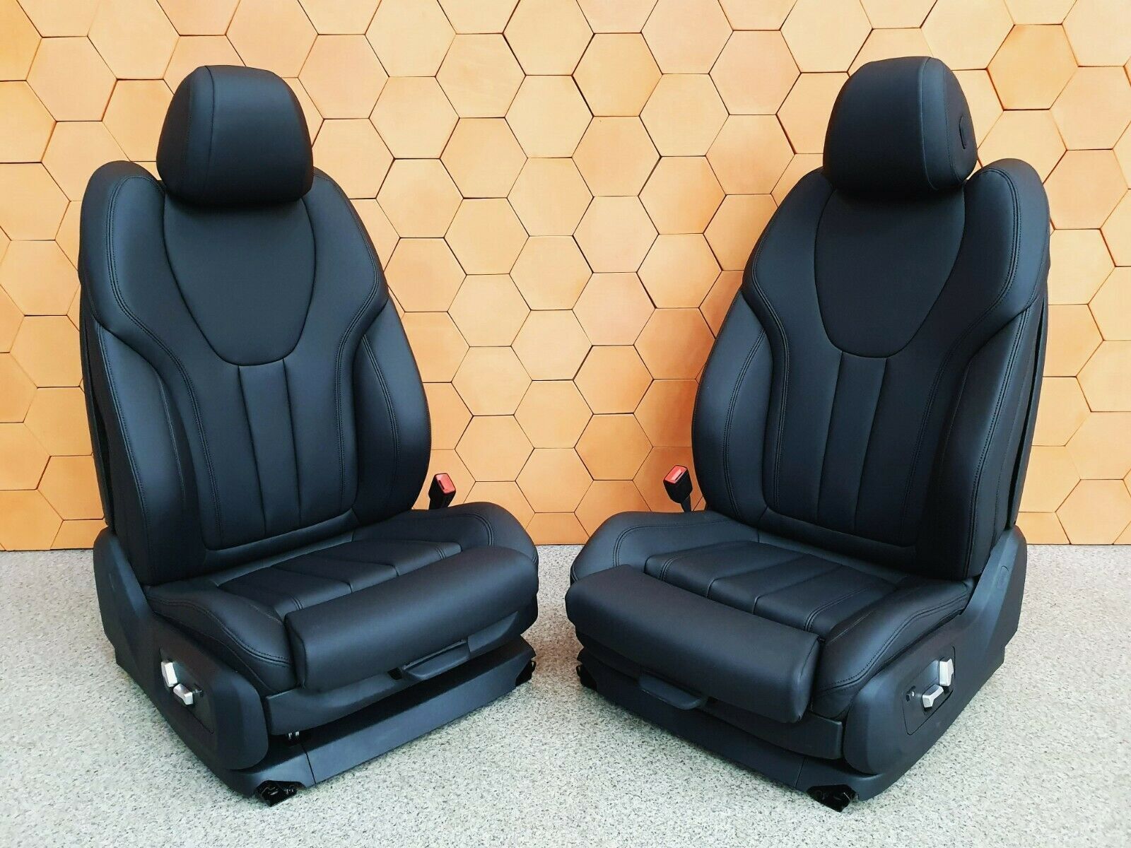

After some hours, searching for front seats, I found (and bought...) these, being delivered somewhere near the end of this month.
I don't know how will they fit mechanically or electrically and if they will fit at all but I do like a challenge so bring it on!!!

The seats are awesome, they're from a BMW X6 (G05) but not without issues...
The first issue is one of the airbags is deployed, so I need to buy a new one but first I need to know if they are compatible with the TOYOTA airbag system, present in the original seats.
The second issue is the electronics on the BMW electric powered seats. The driver seat (left side in Portugal) has an electronic module that once powered works fine, all movements are OK, the heating also, etc. however, if you don't use any movement or function for more than 30sec. the electronic module just goes to sleep... The passenger seat (right side in Portugal) doesn't have this module, all motors are connected directly to the buttons and everything works fine, even if you adjust some setting an hour after powering up.
So I began to try to understand the differences between them and found out that there are 8 different button consoles for each seat...
After some digging, I found the correct one (from a UK vehicle) where the passenger seat is on the left side (without electronic module).
Next step the harness inside the seat, so I removed the leather an started looking for the correct cable harness, still without luck, as I've already ordered two different ones without success.

I've taken the OEM front seats off, to figure out what mechanical modifications need to be performed in order to bolt the new seats using the existing hardware, including the plastic covers.
It was quite easy, since the BMW seats have just a little less width (on the tracks) than the TOYOTA's and more or less the same length (also on the tracks).
I've taken off the 4 feet that were soldered to the OEM seat, soldered some new brackets (the fixing points are not exactly the same) and bolted them to the floor, using the existing hardware.
Next step was bolting the new seats (frame) to the TOYOTA brackets and hope that they would be in the same place than the OEM's, specially in length, keeping the possibility to adjust them back and forward as in the original ones:
Notice the difference in angle (now adjustable) between the knees support of the BMW's and TOYOTA's seats, it's a major difference.
Having the mechanical structure figured out, now on to the electrical connections (my LC doesn't have OEM electrical adjustable seats) in order to keep all movement from the BMW seats and also to add seat warming, etc.
I also found out that my LC doesn't have side airbag in the passenger seat, so, since the BMW seat airbag is deployed, I will spare some money buying a new side airbag, keeping the deployed one for now.
I will try the driver's BMW seat side airbag (not deployed) on the TOYOTA seat harness, as if it was the original side airbag inside the TOYOTA driver's seat, if it works properly, I might try to figure out how to install and code a new passenger side airbag, security is important!
A last picture of the seat harness modification, since I couldn't find the correct harness part number (there are at least 12 different ones, for the left side...) in order to have the seat without memory, like the passenger side, and having everything working properly as it should.

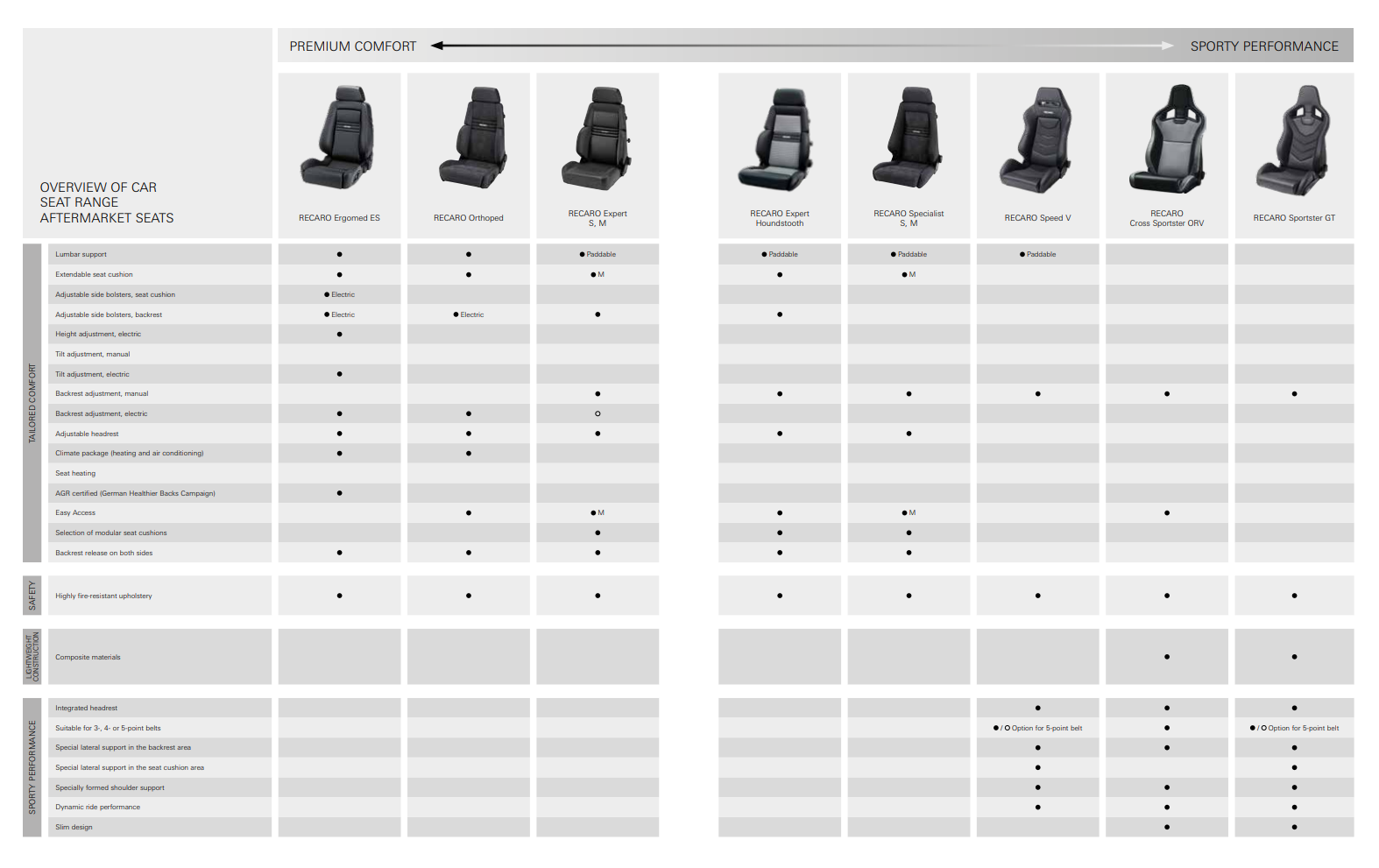

If you're going to drop the $ on seats, seems like the Recaro Ergomed or Orthopad are the only 2 which don't give up the heated/cooled seats.

The RECARO seats are very limited, compared to the BMW ones, in my opinion they are excellent to a racecar or a high-end restomod but not for the intended with these ones.
