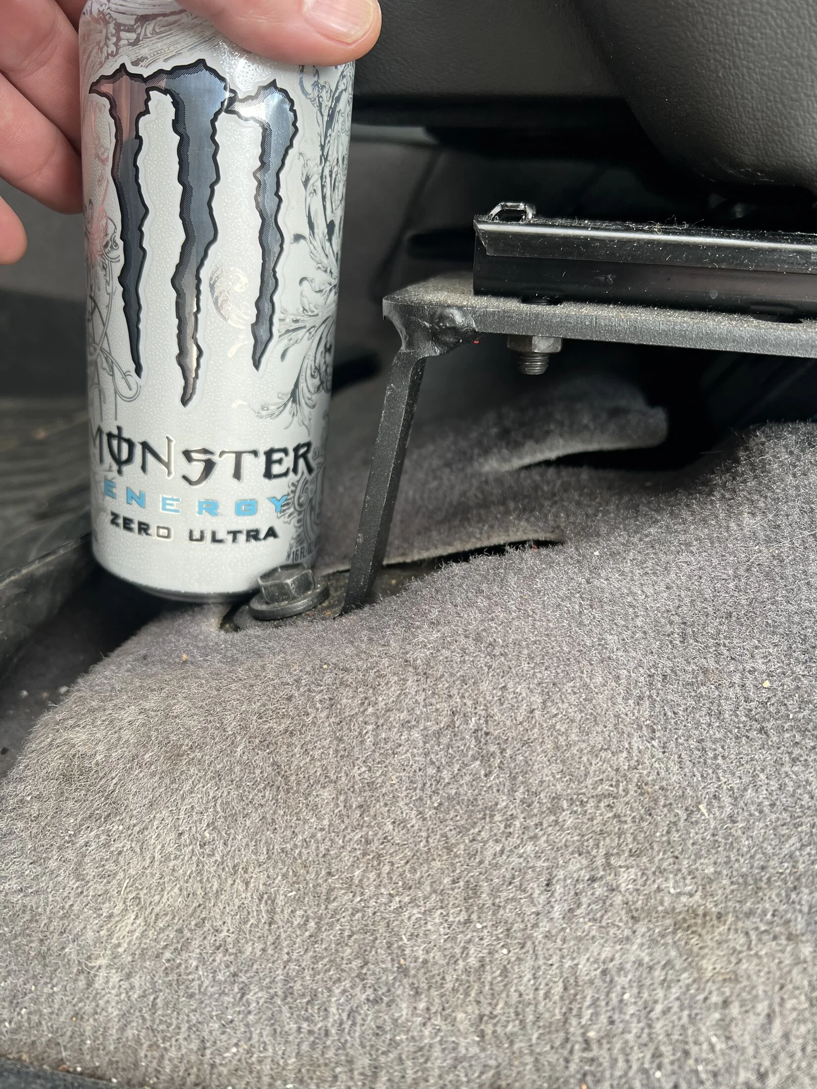

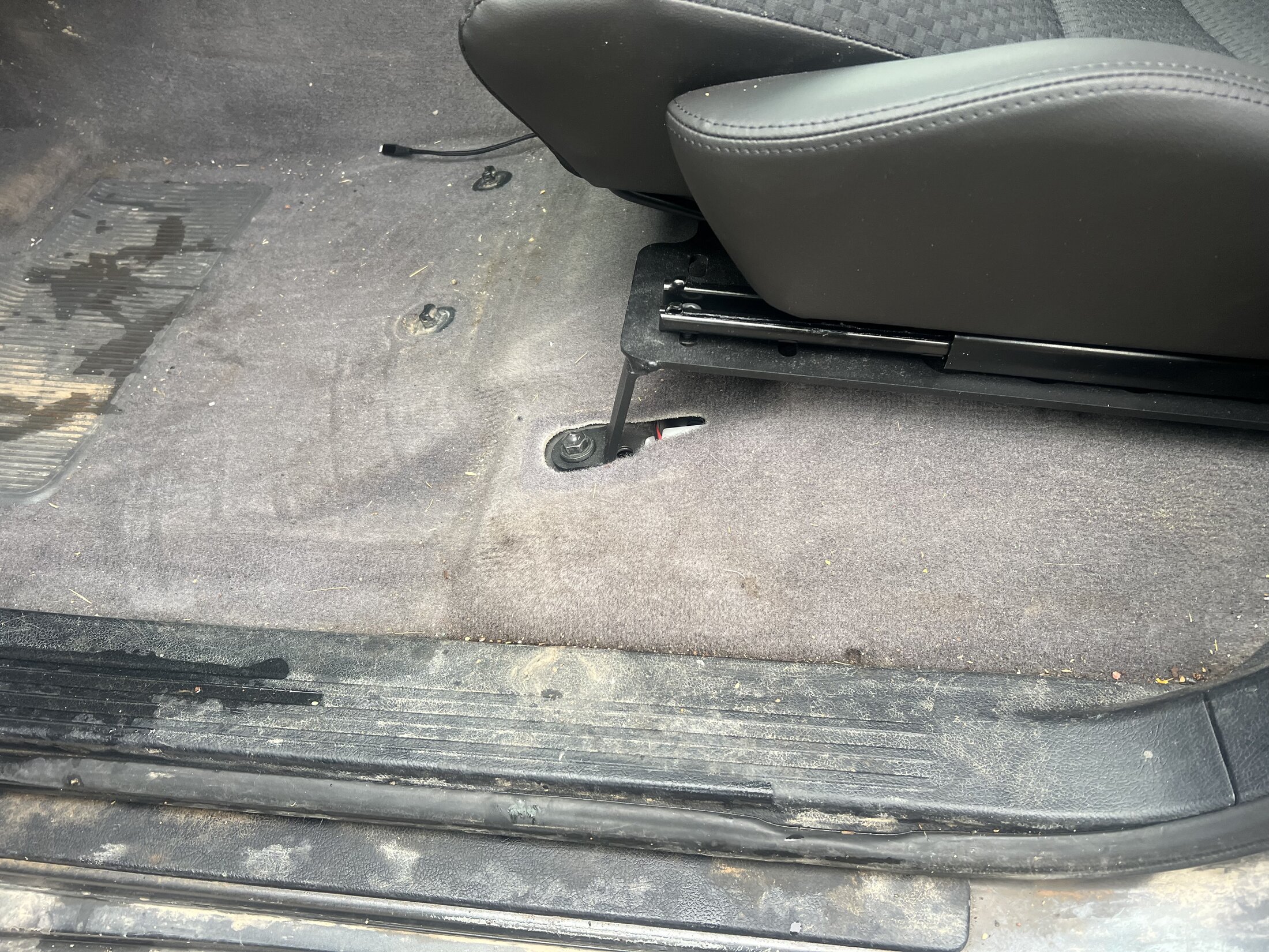

The new brackets have arrived.
Once Scheel-Mann and Planted Technology confirmed that I had received the “tall” brackets by mistake, they pulled out all the stops to get me the correct ones ASAP.

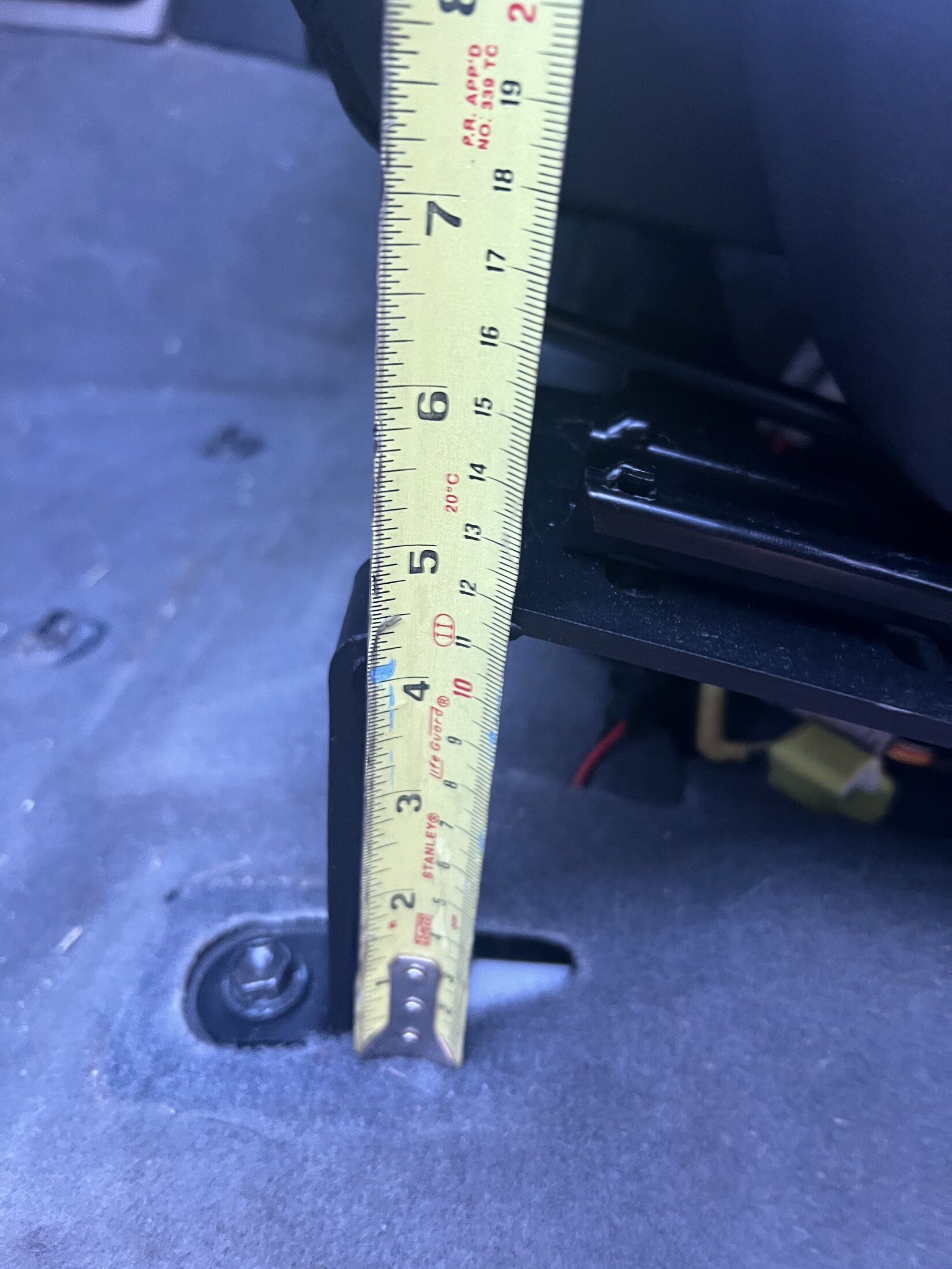

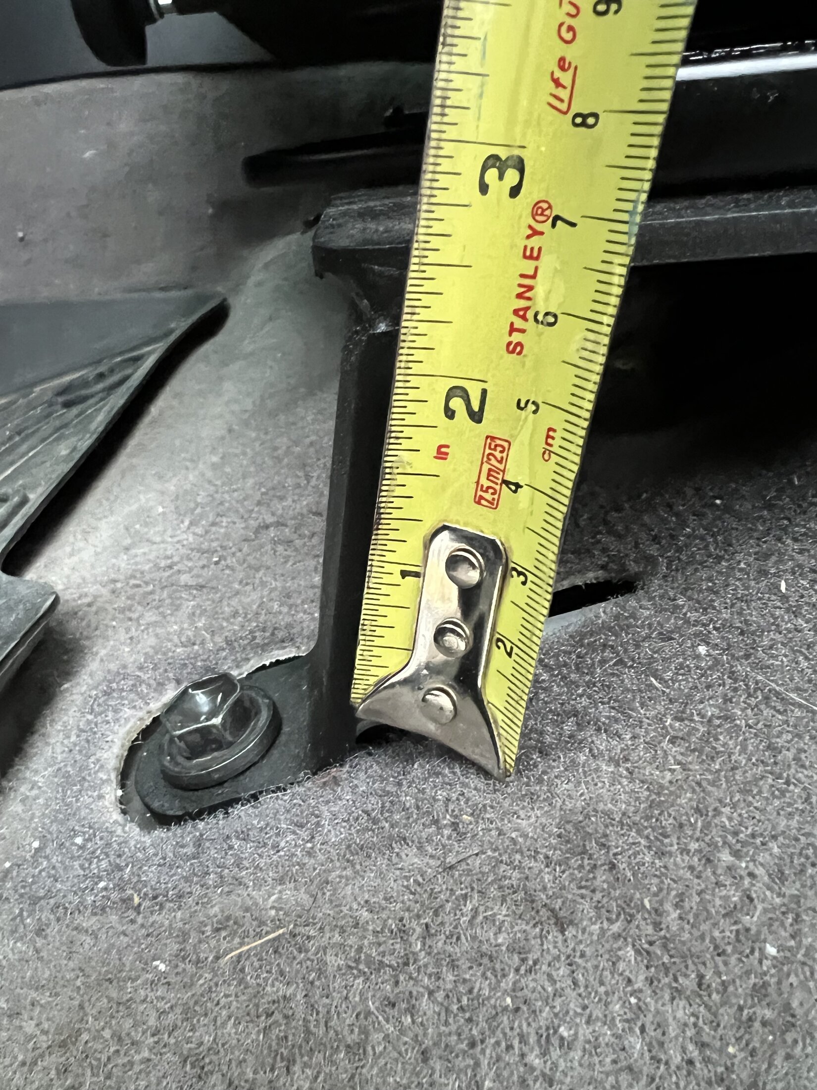

The new brackets are about 2.5 inches lower.
The first time I got in, I was a little surprised at how low I was sitting. It was not uncomfortably low, mind you - just surprising (maybe because I had been riding on the “tall” brackets?).
That said, it is also what I think is the perfect height, at least for me at 6’1”. It may even be slightly lower than the factory seats, which I think is an unexpected bonus. Attaching a photo of the “tall” bracket, first, followed by two photos of the new one.

Curious, with the lower brackets you have now, is there anymore room underneath to go lower?
I ask because you mention these MIGHT be lower than stock height.
One of the reasons I’m considering the Scheelmans is to lower my seat height at least an inch.

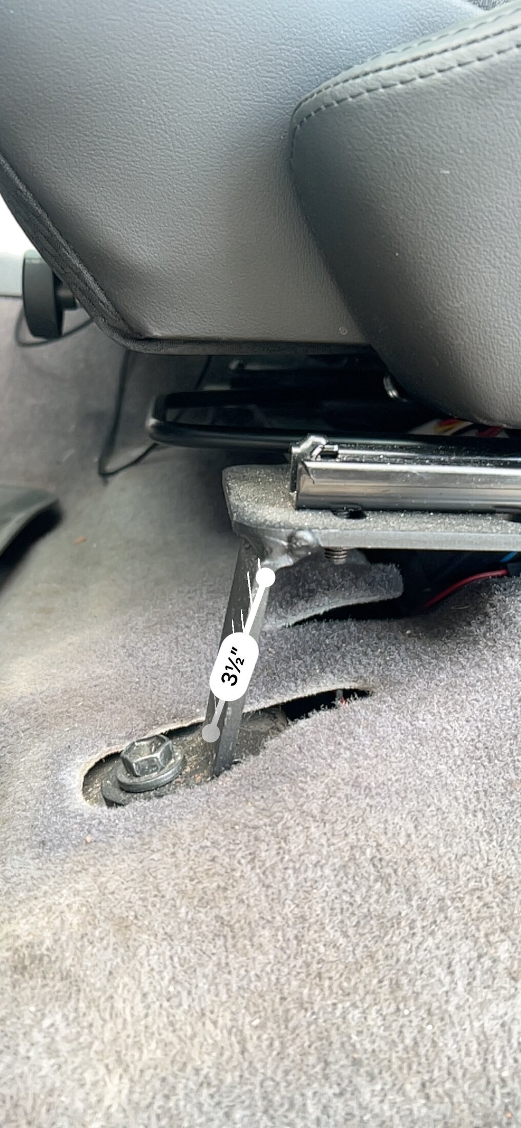

Apologies for the rudimentary measurement. I also did it with an app , but it was difficult to keep it steady. I think it’s closer to 3” than 3.5”, as you can tell from my unsteady hand. I’m on the road and don’t have a regular tape measure handy.
