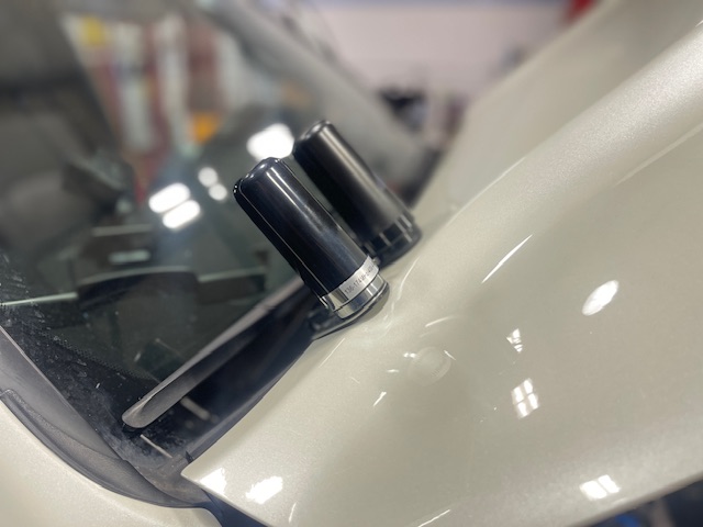

  • GMRS: Midland MXT575 hard mounted w/ hidden brain, stubby +3db antenna on hood.

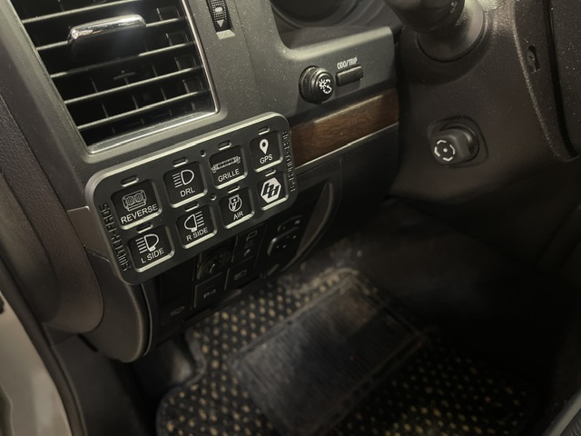

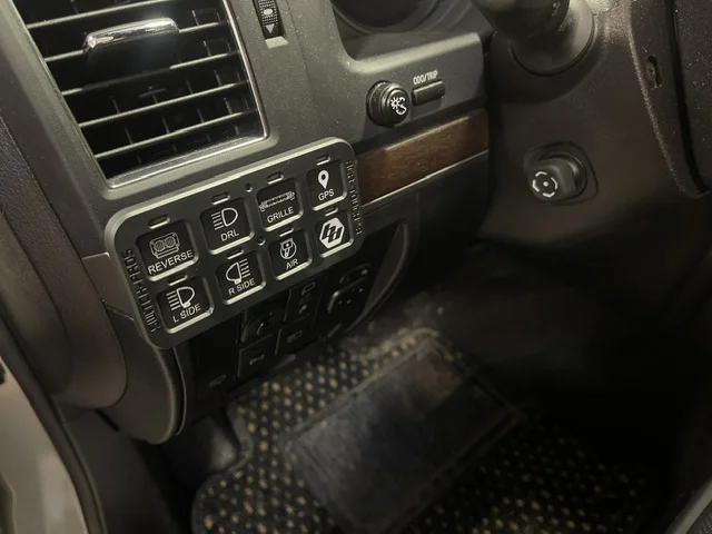

  • SwitchPros panel for control

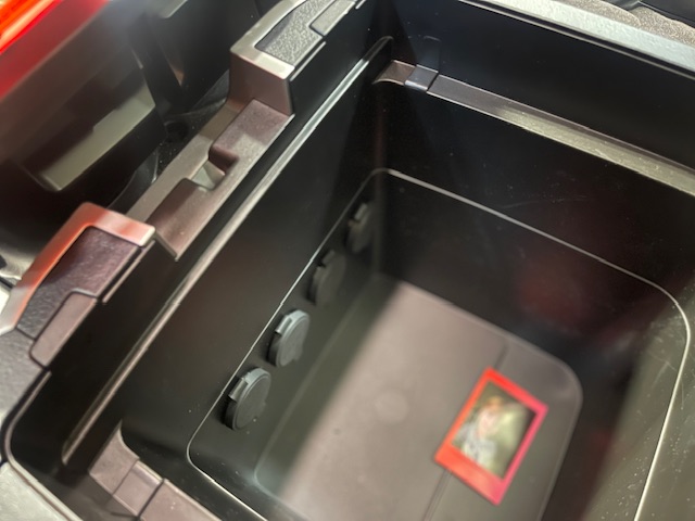

  • 20 USB-C power points throughout cabin, 4 with USB-C PD for charging laptops, tablets, cameras, etc.

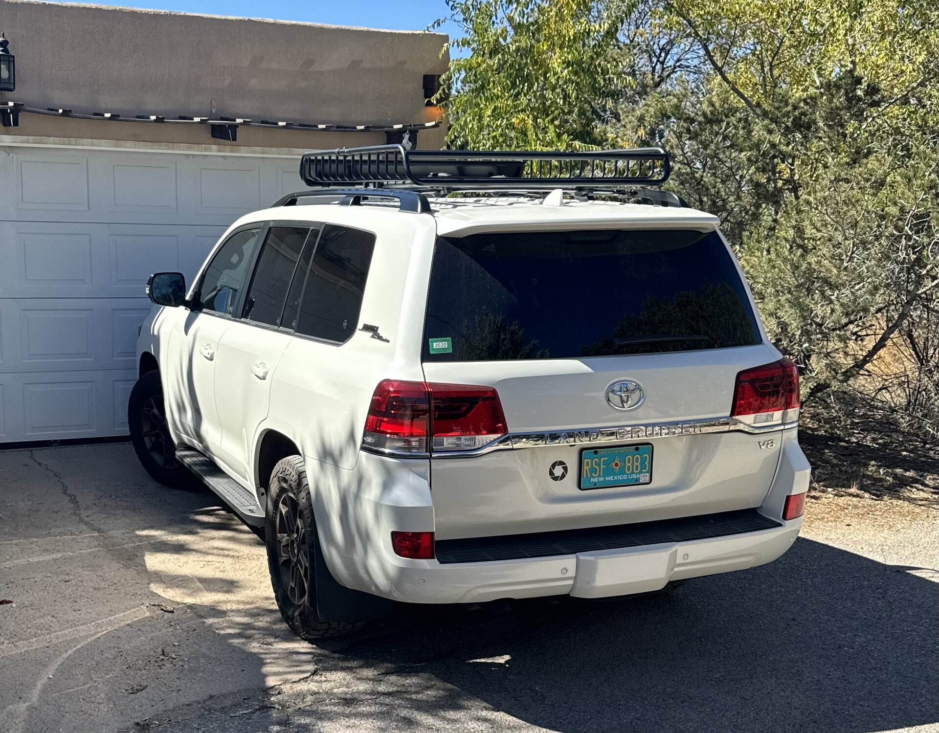

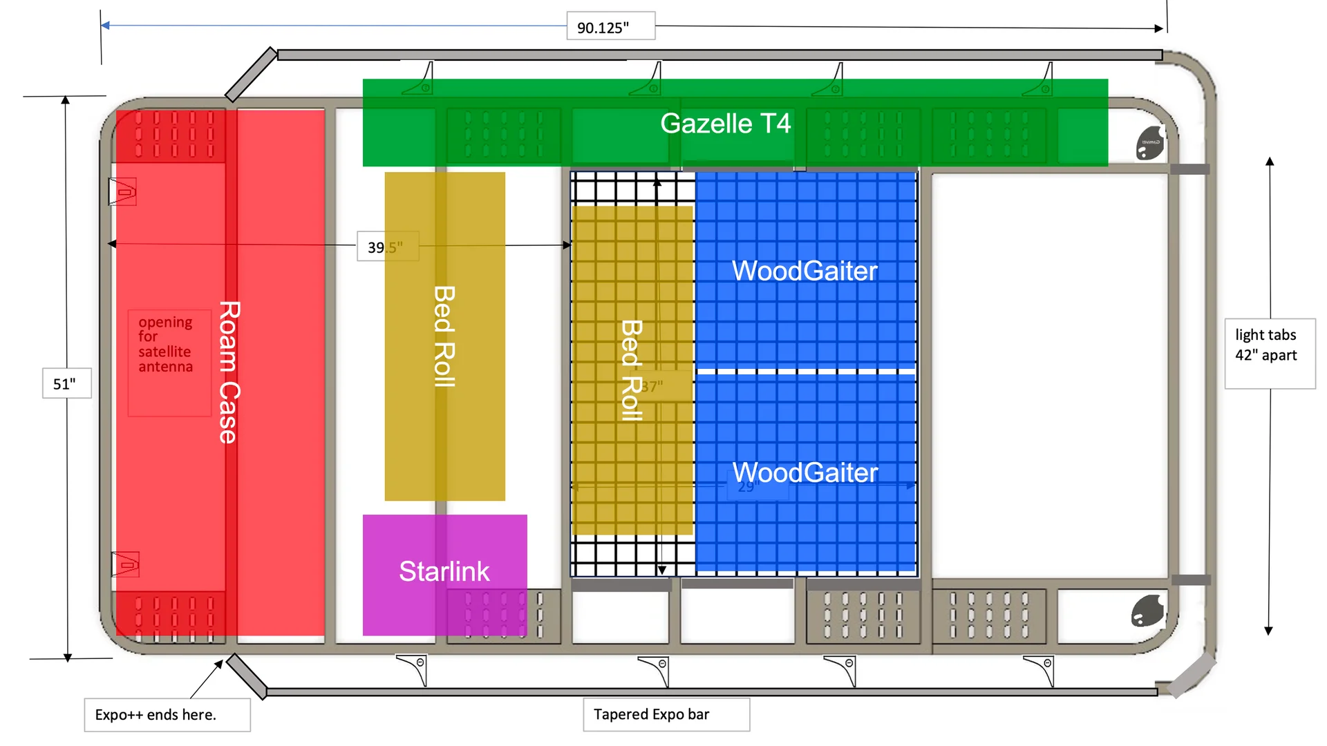

Roof plan when fully loaded

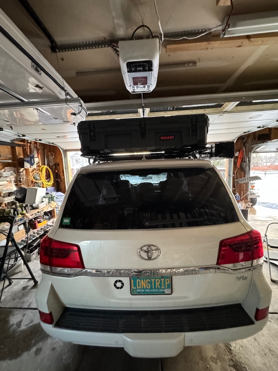

Marsha today

Can't wait to see how it all comes together. Your roof rack plan has reflections of my setup with the T4, a rooftop case, and firewood. (I use a drifta firewood bag) I just wish I had a 21 HE!

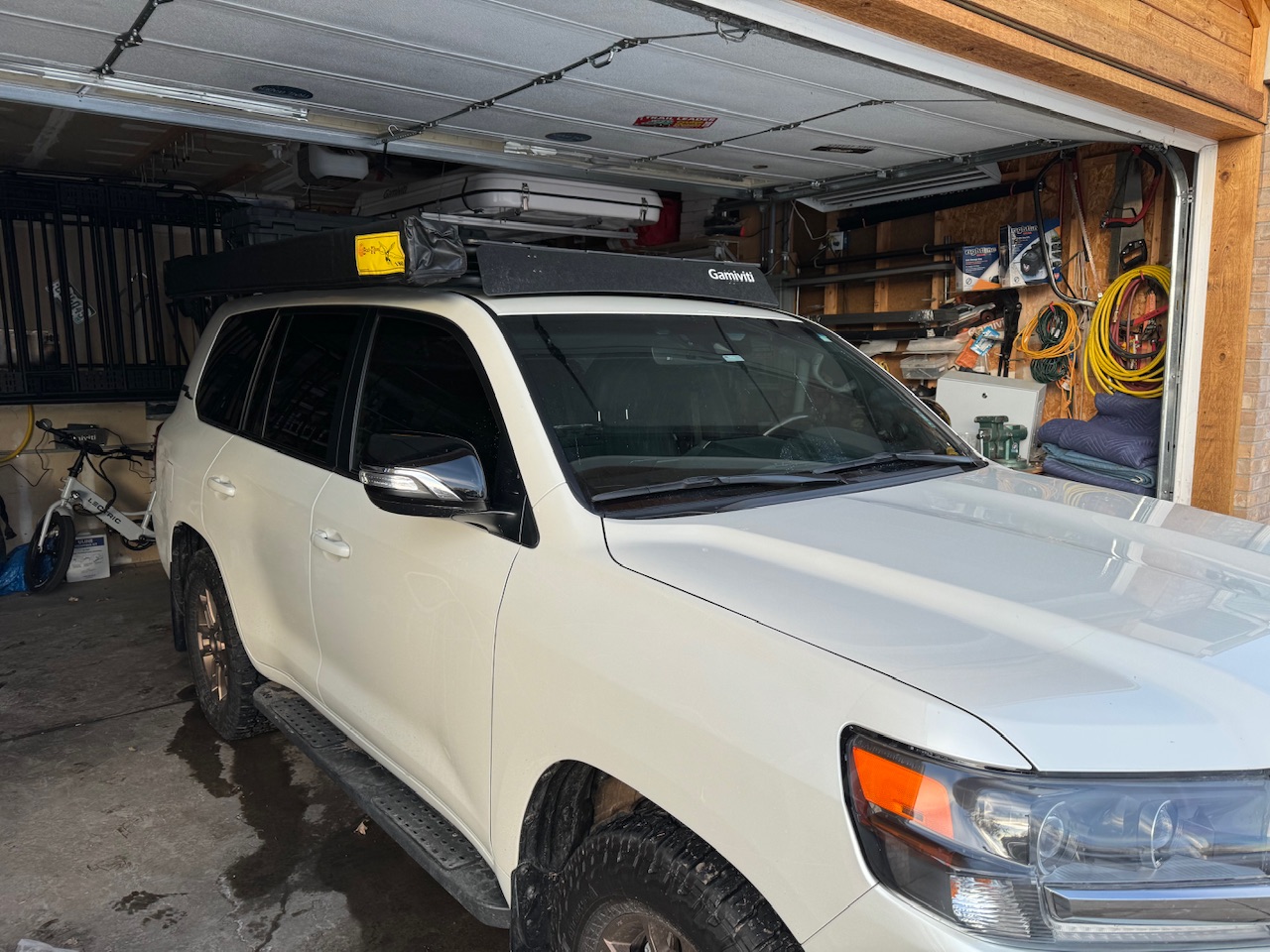

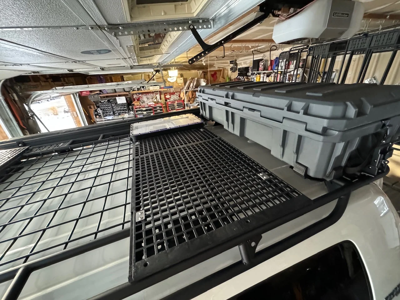

I spent the afternoon with Tim at Gamiviti world headquarters getting my rack mounted up! Dropping off at Slee tomorrow for the big projects to start.
+ Following..
Mine started in earnest this last weekend as well... and our builds are on the same path so to speak.

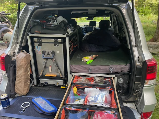

Also 2 up sleeping in the rear is fairly challenging with a fridge, Pic of my setup in the back with goose gear cabinets. I guess you could have it come out the side door but that would comprise total length..
I gave up that possibility unless I removed the rear seats completely and went custom for the rest of the storage setup. Mine is a single person sleeper.. but nothing is left on the ground at night (which was my main goal, everything that comes out of the truck at camp goes back in before bed, makes the morning so much easier).
Yeah, we won't sleep in there with the fridge. I'm running an ARB elements so it can go outside when we're sleeping inside.

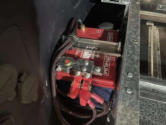

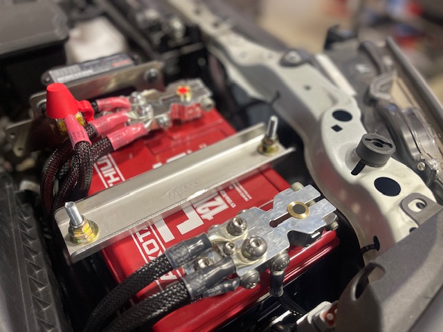

Is that the normal slee aux battery tray tucked next to your drawer setup or something a little more bespoke?
Yeah it’s tucked under one of the wings of the drawer system
Is that the Victory4x4 rear shelf? (I just installed the Kaon one is why I am asking and the brackets are different)
Electrical looks top notch...
Also are the Aux batteries run in parallel or powering 2 different "zones" - I was thinking of a way to get at least 200ah for induction cooking and going propane-less..
Yep, victory rear shelf and rear window panels

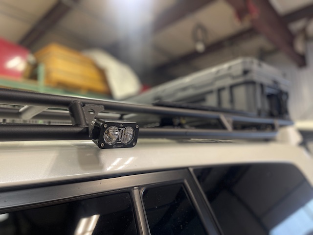

Would you mind showing how you are attaching everything, including the lights, to your rack? I know that sounds dumb, but so many racks are that aluminum extrusion stuff with the T-nuts. I like Gamiviti better and the owner seems dope. Gamiviti is the way to go and what I'm set on. I'm just not the most mechanically inclined and a little nervous I'll end up having to try and fabricate mounts and connectors and what not since it seems most racks are moving to 80/20 type stuff.
