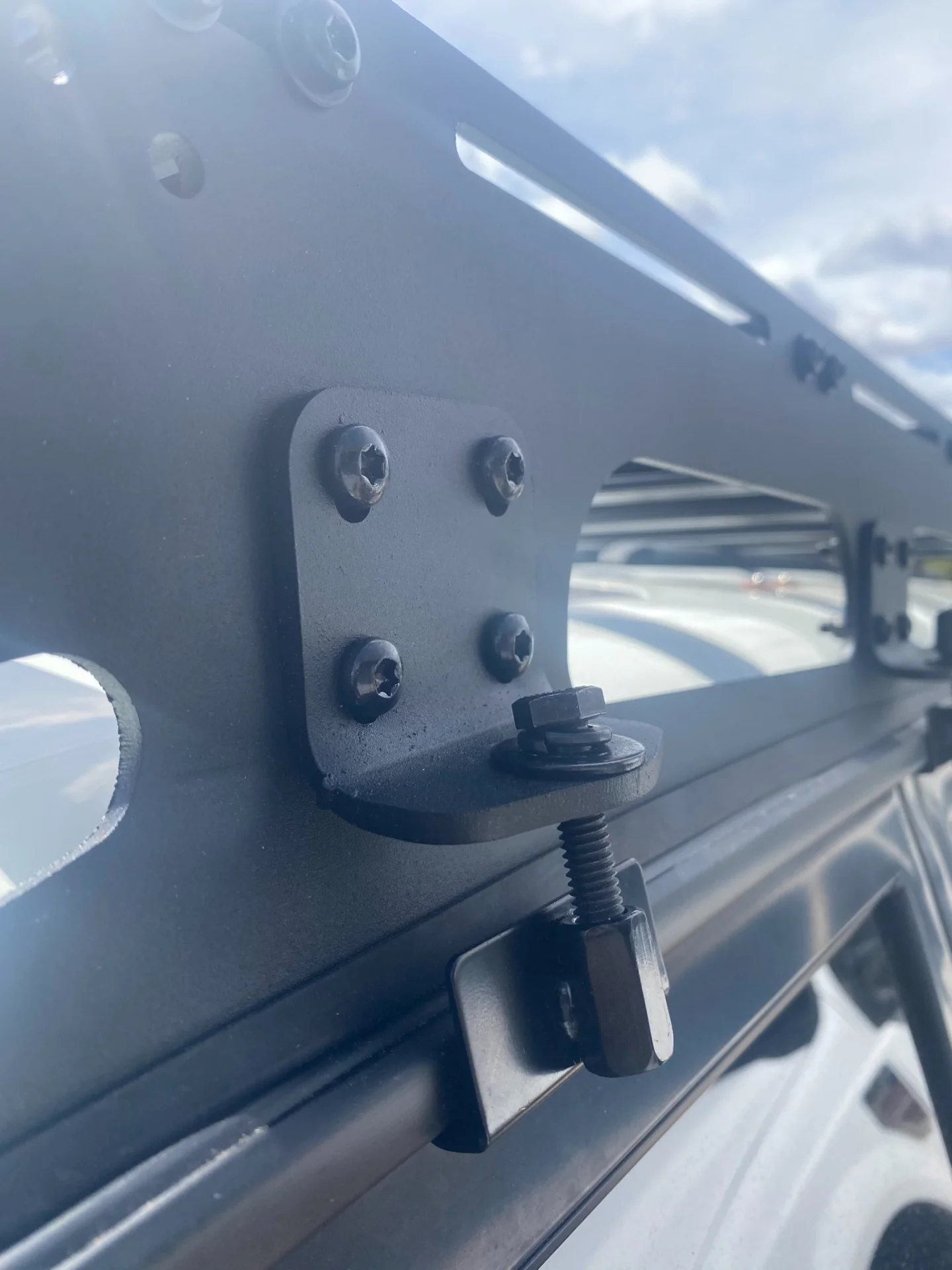

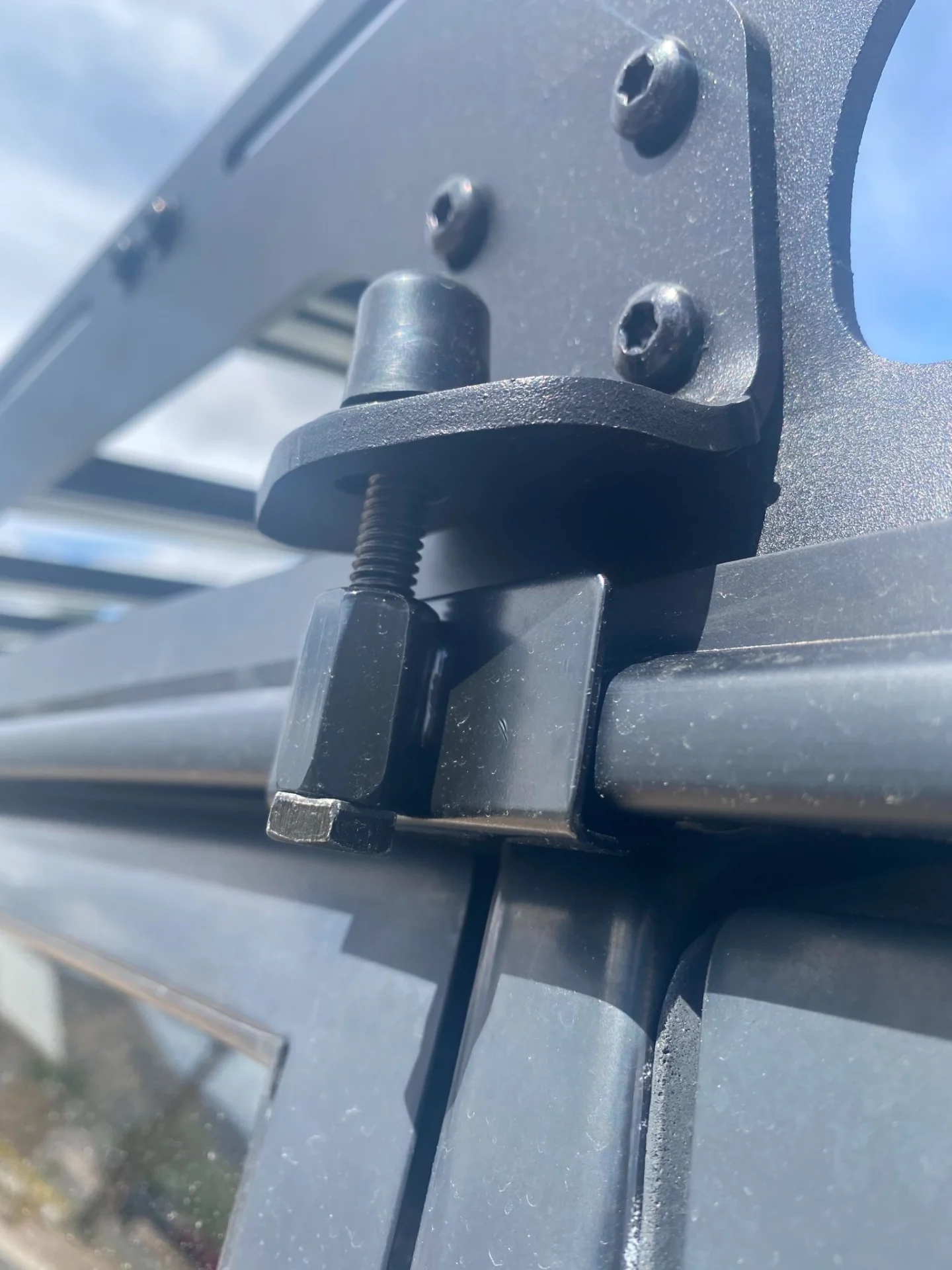

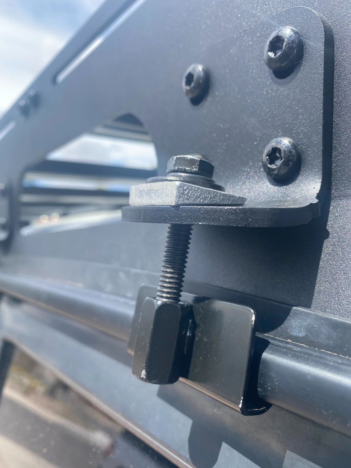

Changed up the roof rack mounting hardware for the Prinsu rack. I think this will work a ton better.
Here's the config from Prinsu (Photo doesn't show well, but the nut on top is not flush, the bottom of the bolt head at the bottom also runs into the small seal on the top of the door when it opens):
Here's the hardware flipped, bolt coming in from the top and a split lock washer instead of the serrated nut. Note the bolt head not lining up:
Here's the way I'll be mounting them. I don't think all 8 mounts need it, but the front 4 do. Will report back once I get it all finalized. Need to grind these tapered washers round and paint them black:

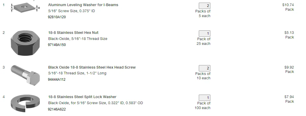

Parts I ordered for this, all from McMaster Carr (P/N to search is the 9xxxxxxx):
Some of the mount locations will need longer than the 1.5" bolts, in those I will use the hardware that came with the rack.

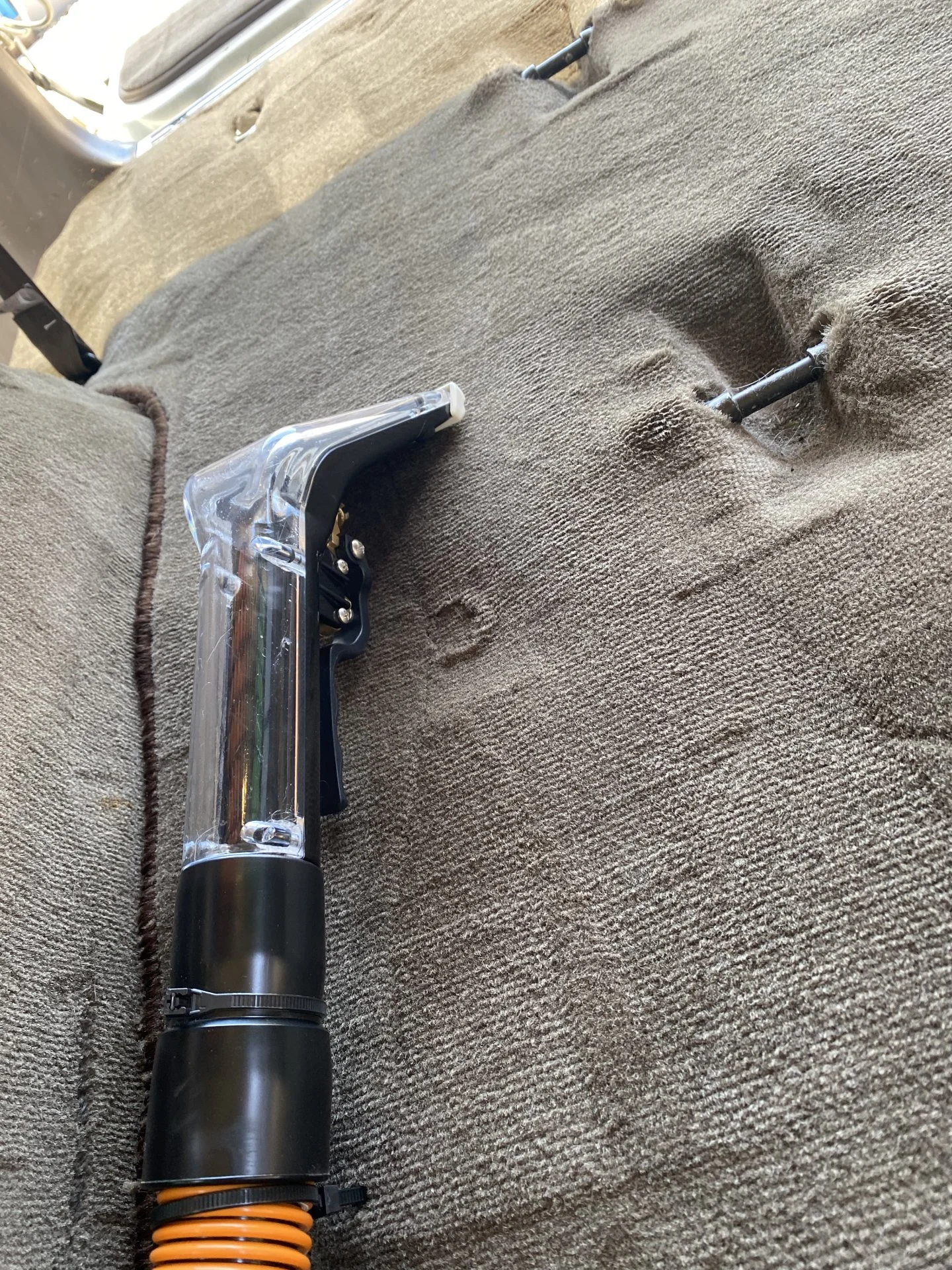

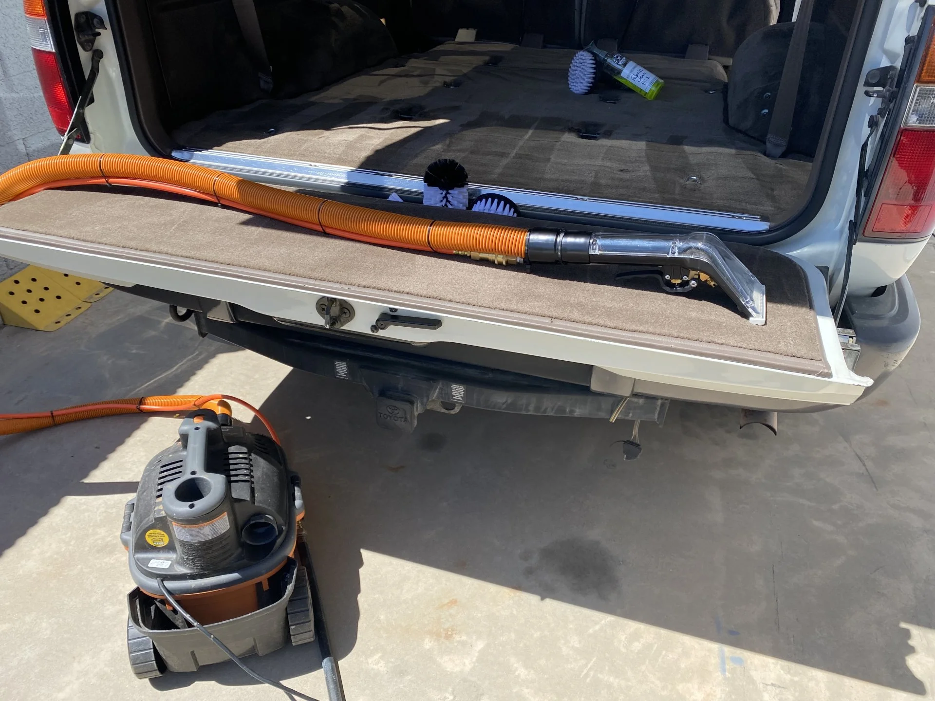

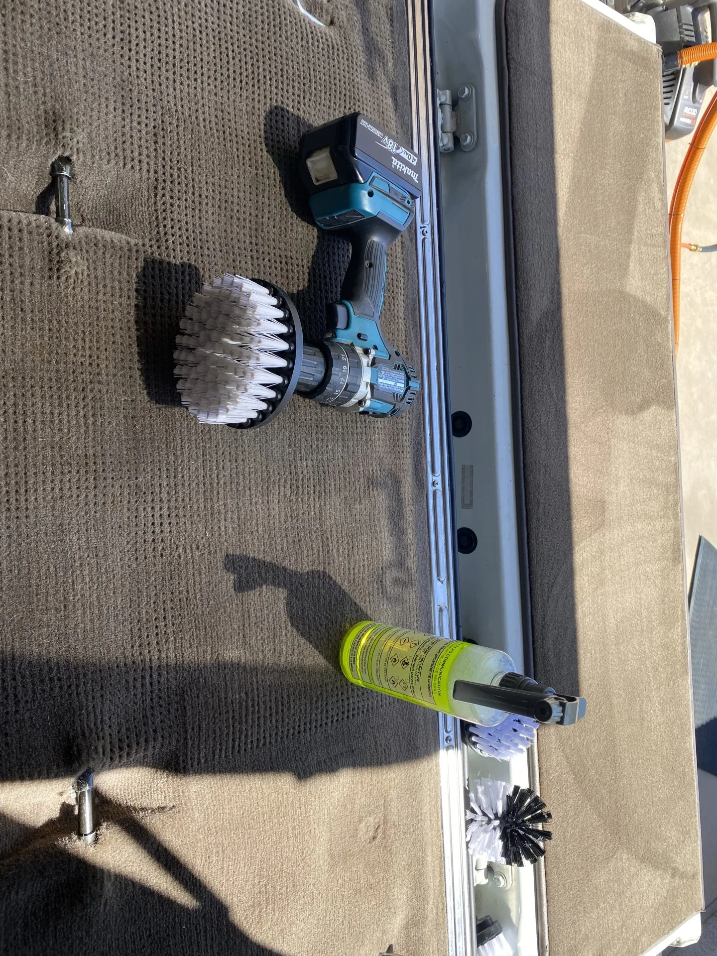

Looking great bro, you moved out with the rack and adjustments quickly! How’d your cleaning contraption work out? Looks like it pulled the soil up well from the pics.
Definitely worked well. The key was to hit it with the soap and then use the drill with the scrub attachment to get everything loose.
The clear extractor is definitely the way to go so you can see when you’ve pulled the soap out and it’s cool to see the dirt come up

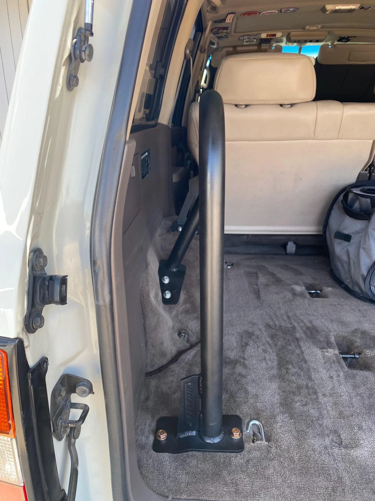

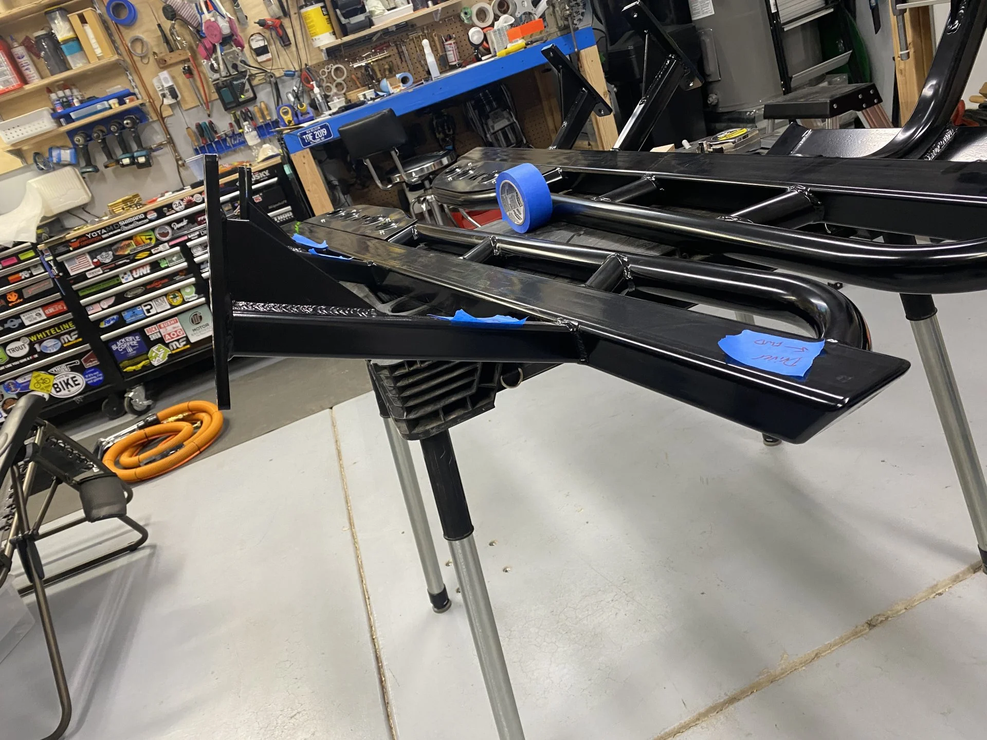

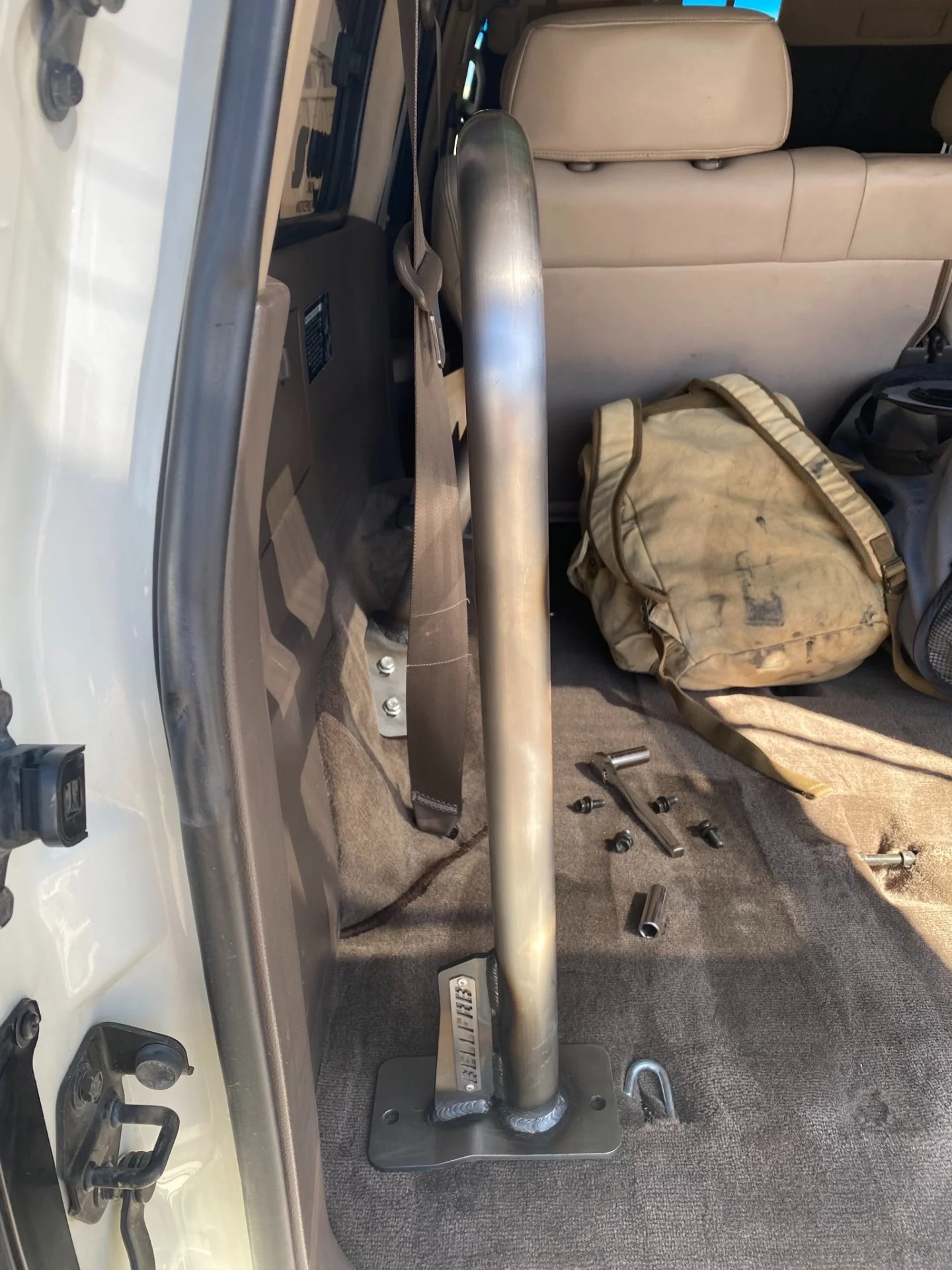

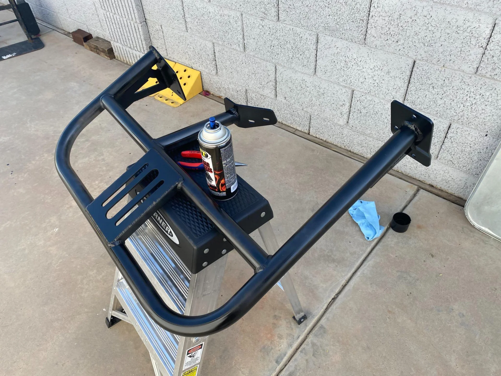

The tire mount is getting a nice coat of VHT Roll cage epoxy. should do the trick:

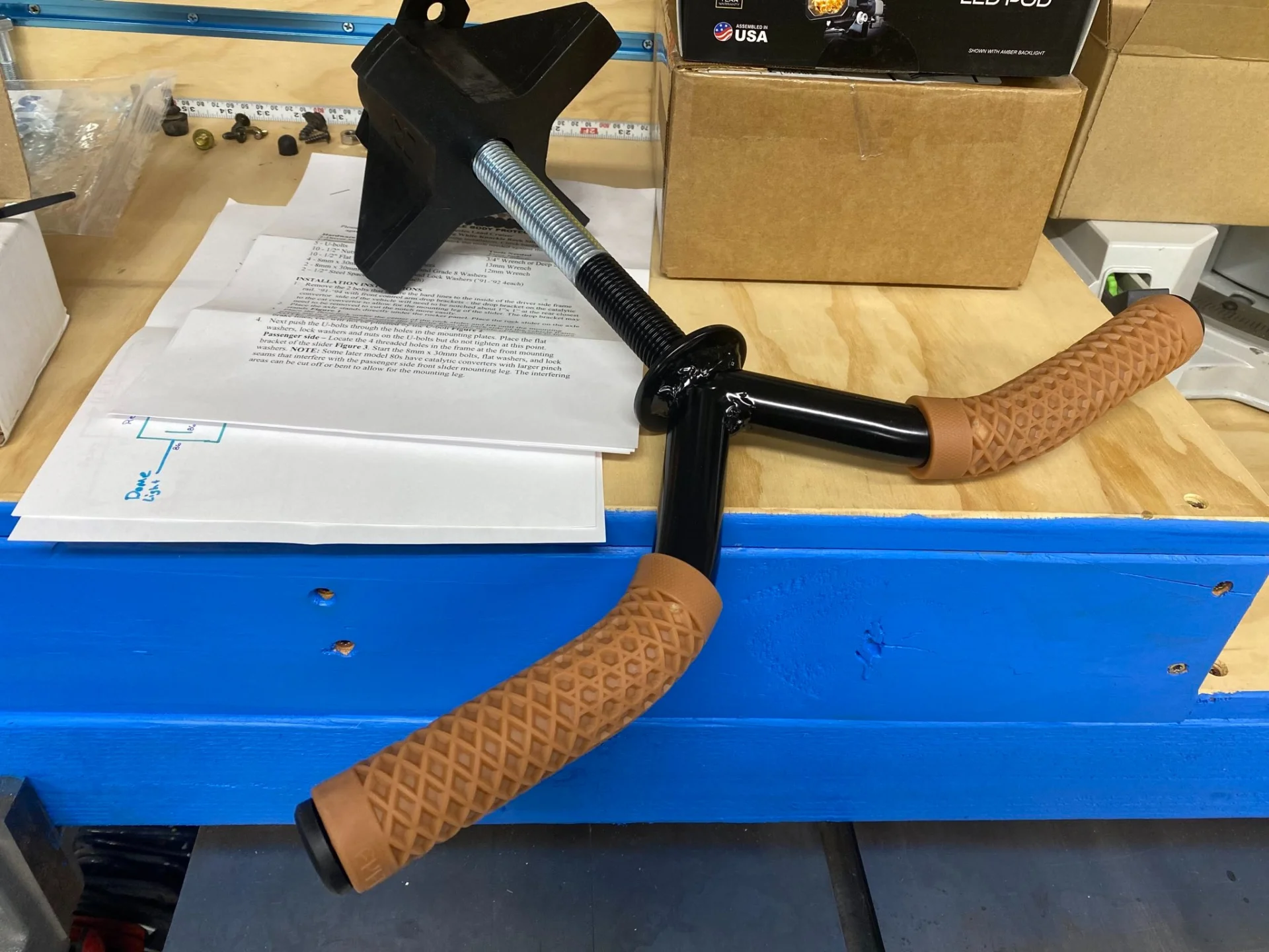

Also, slapped some bmx grips on the handle:

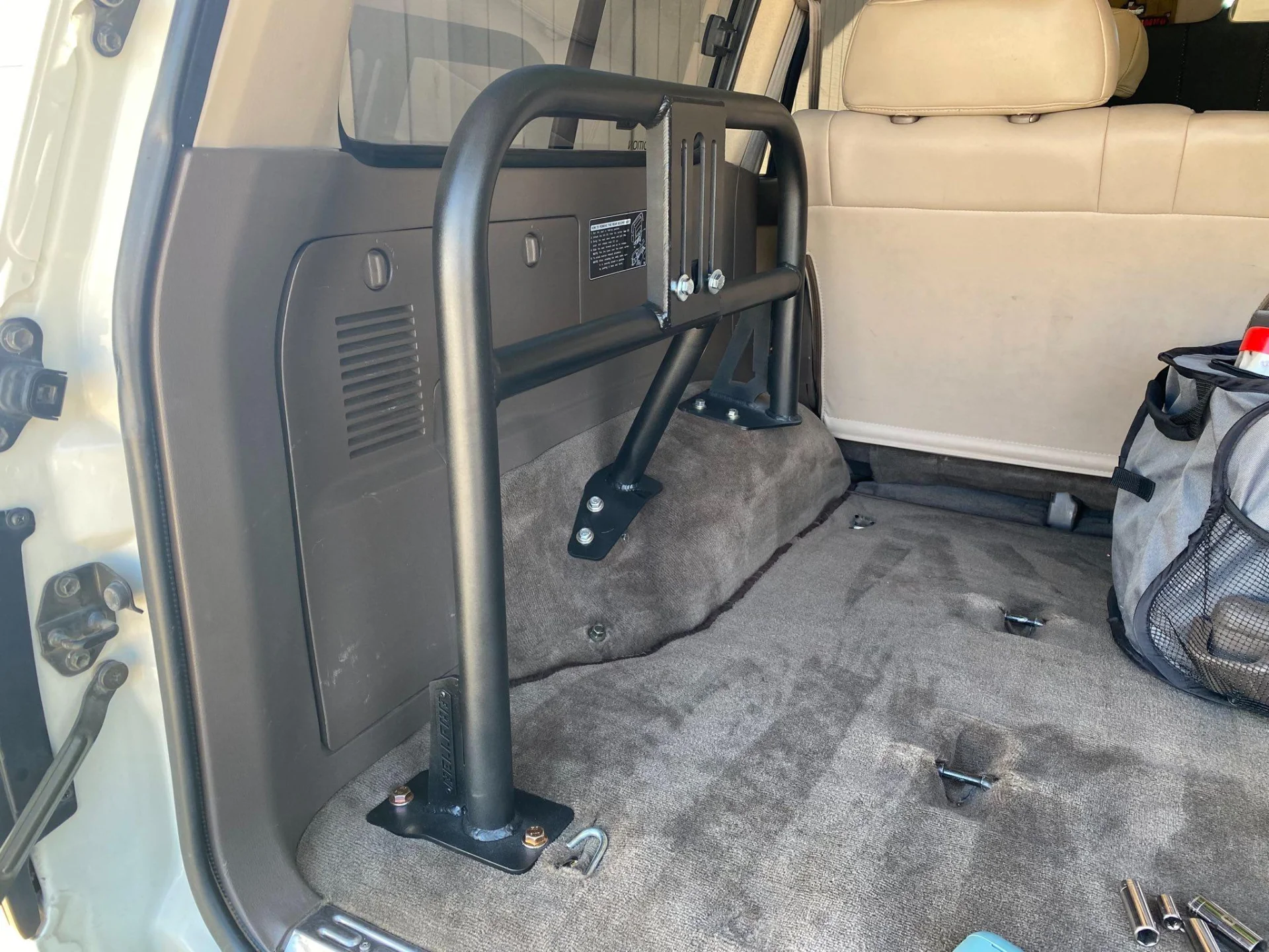

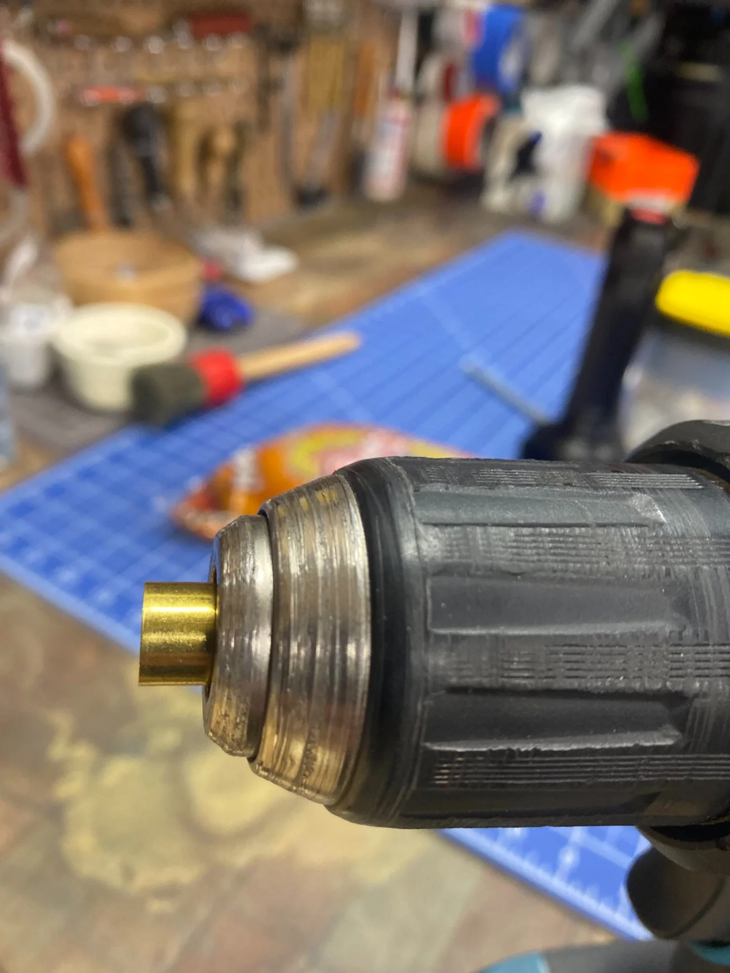

Drilled some holes for the rear mount. it takes 3. Used a sharpened 40 cal cartridge to cut the carpet and dynamic underneath before drilling:

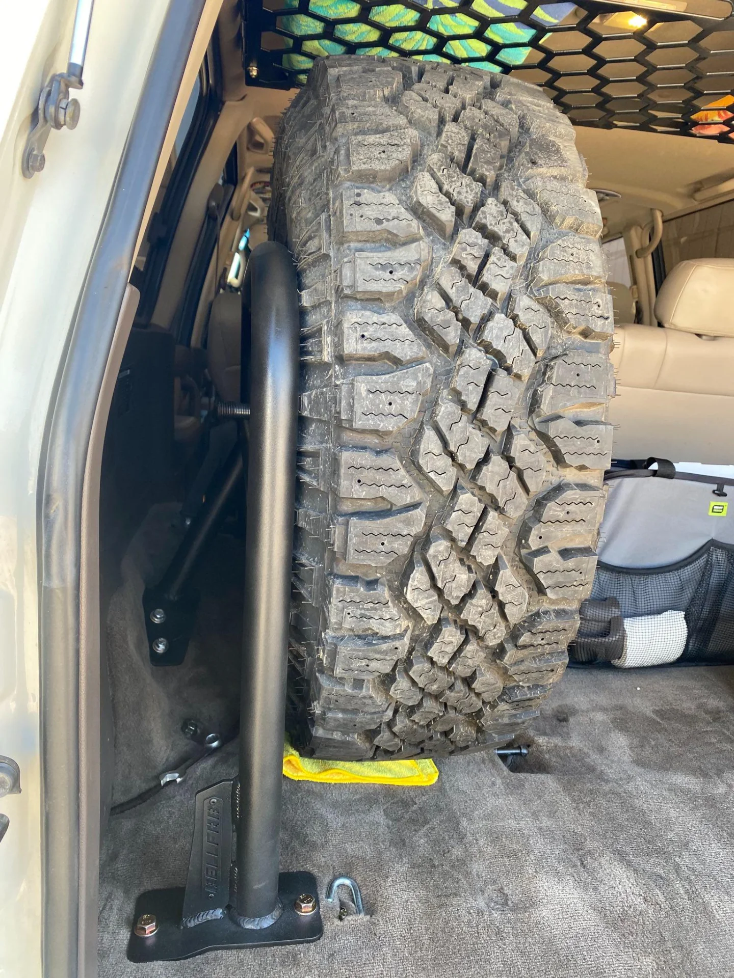

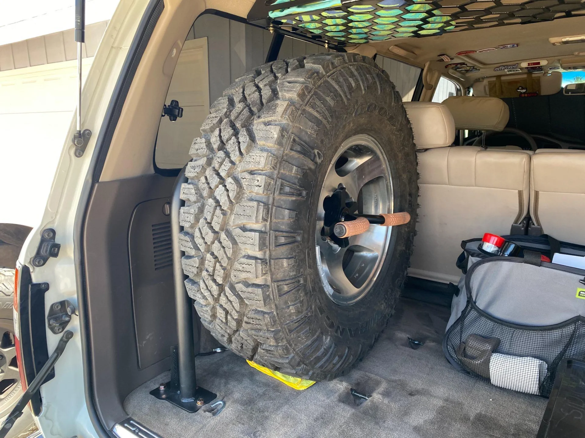

Interior spare tire mount from BellFab is installed. I gave it a rattlecan job with VHT epoxy roll cage paint and a layer or low gloss clear:
287/75r16 fits no problem. It'll clear up to a 37" (foreshadowing....)
