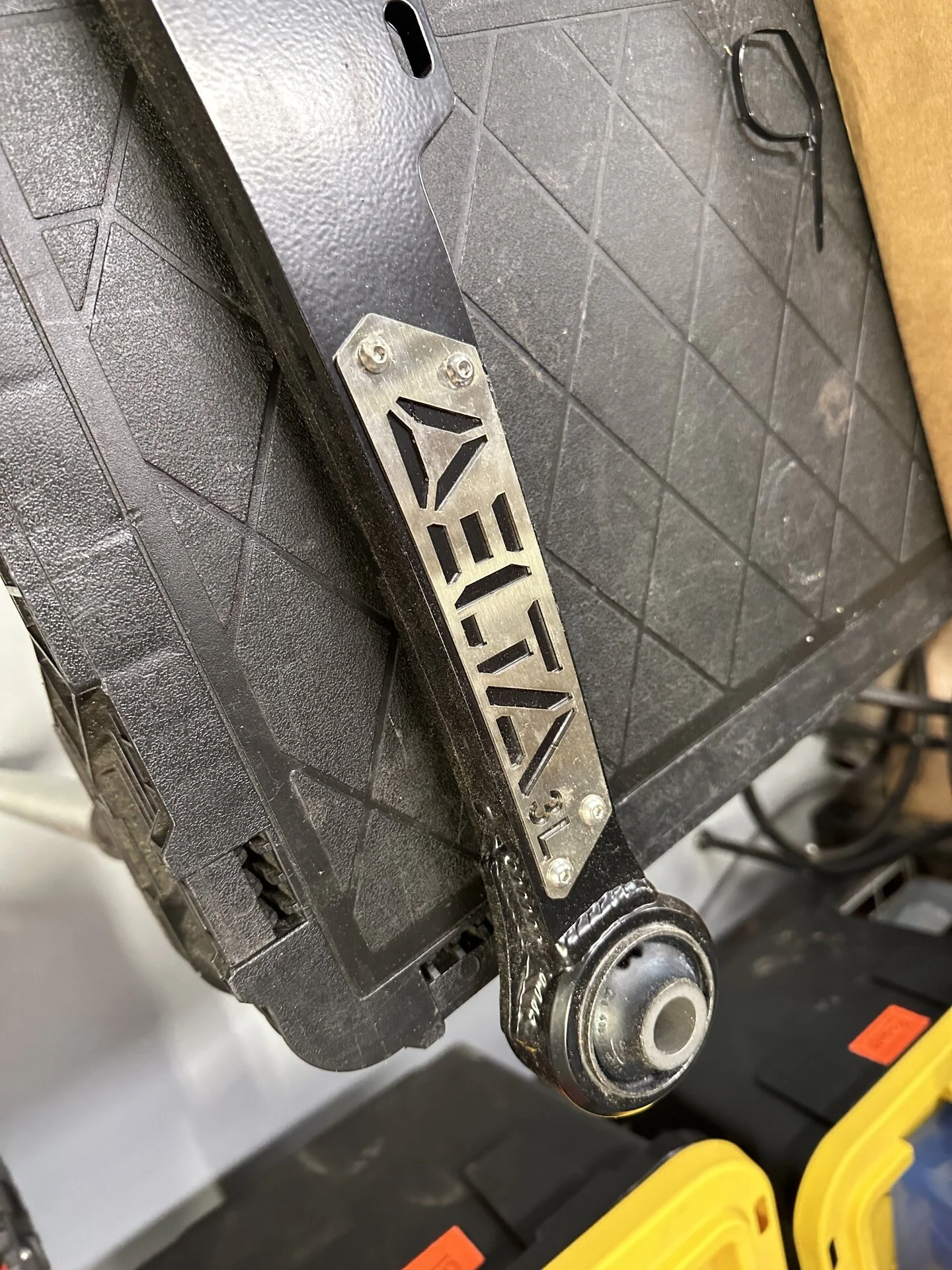

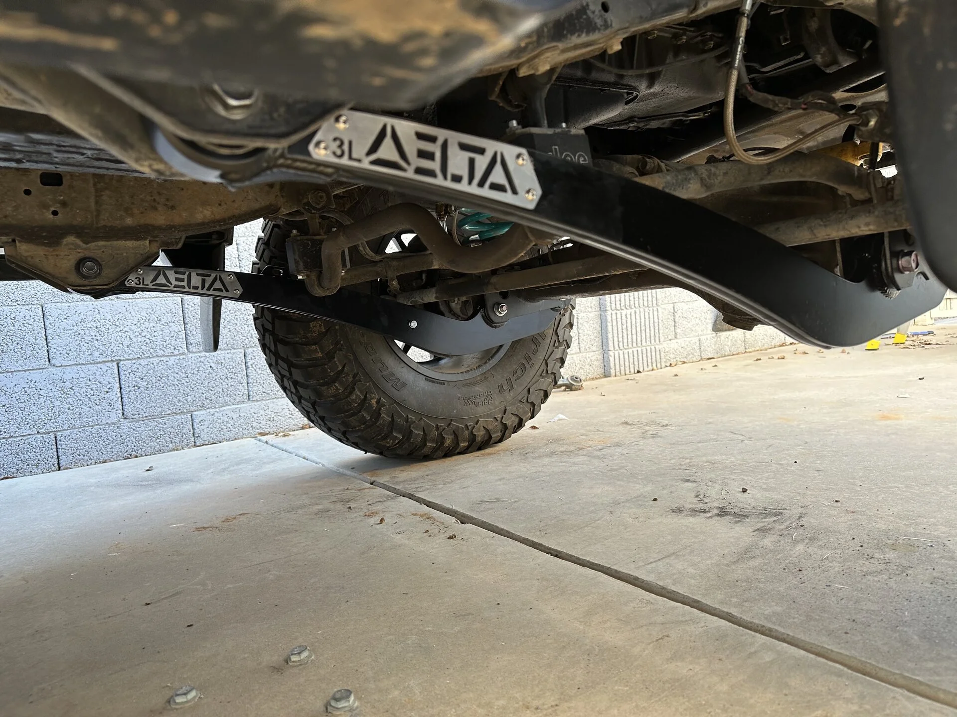

My Delta radius arms just shipped! The current list of what needs doing, in no specific order:

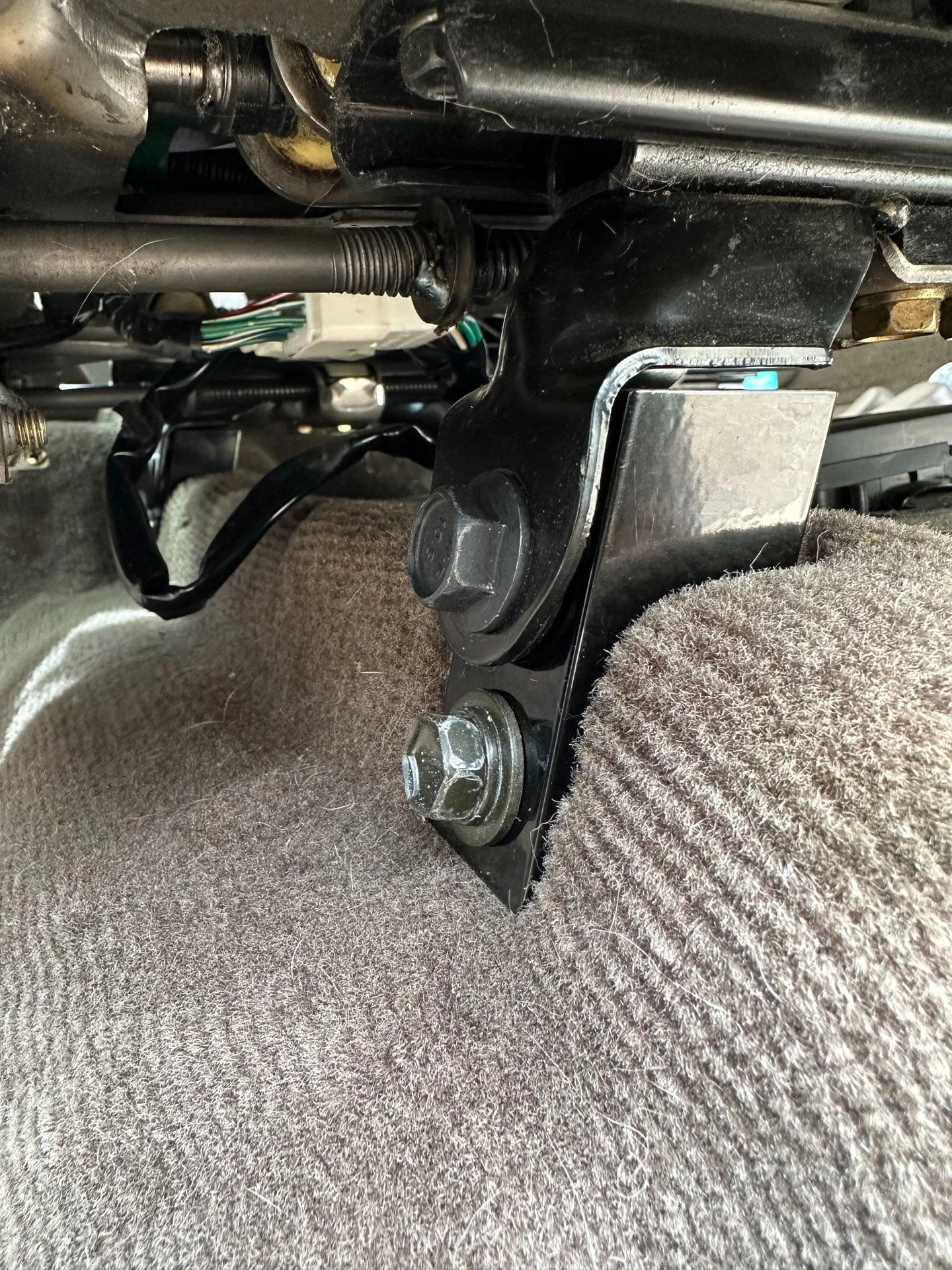

- Weld the slotted radius arm mounts from the caster plates I removed.
- I have 4mm thick x 25mm wide x ~1ft long mild steel on it's way from McMaster Carr
- Change Diff oil and extend breather lines
- Install Delta radius arms and rear panhard correction bracket

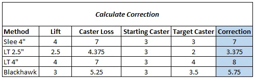

- Remeasure front caster for science (I'd like to validate some of the numbers in my table below and from post #199)

This is based on a bunch of poking around and calculating backwards using some "accepted" numbers. Plenty of assumptions included... like, the earth being an oblate spheroid, that I ate a decent breakfast this morning, and that I actually can do math. Take this with a grain of salt, it may be entirely wrong...

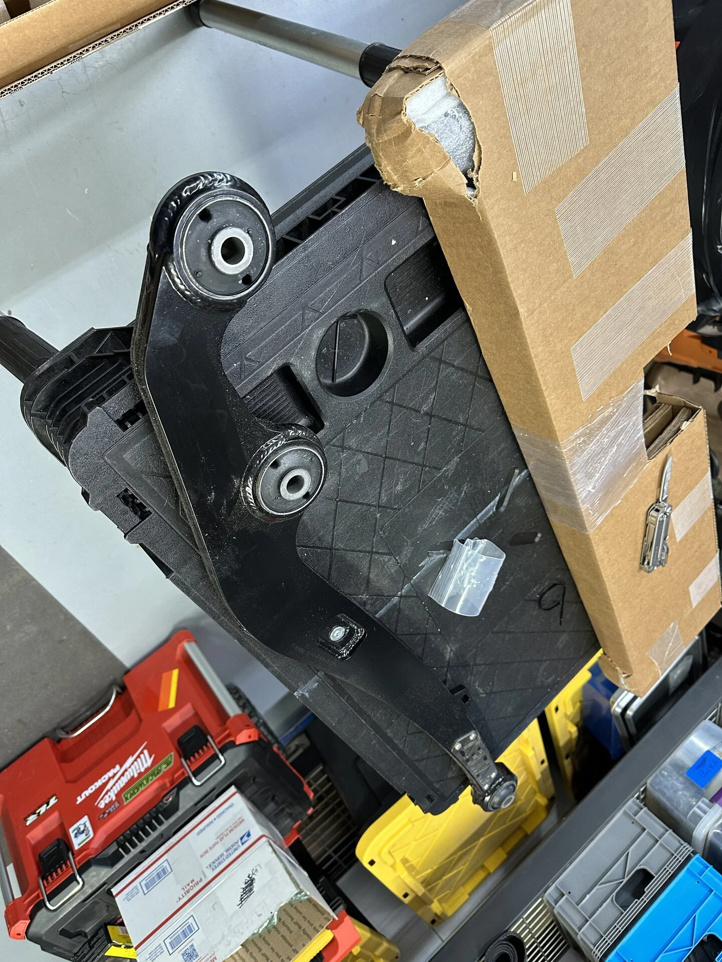

Nice!! That radius arm mount repair looks great.
Thanks! I could have done a better job on the inside... but I don't have a mini belt sander or the right die grinder attachments right now, and I was lazy. I will watch for any cracks and fix as needed :)
Just took it for a test drive, the extended arms mad a big difference, less rubbing (didn't notice any yet) when turning and compressed (on the pinchweld).
With the longer shocks I am running I definitely noticed the panhard kick my ass around a bit on big bumps... the panhard correction bracket seems to be worth it! My only complaint is that the bolt mounting to the control arm should have come with a washer under the bolt head.
