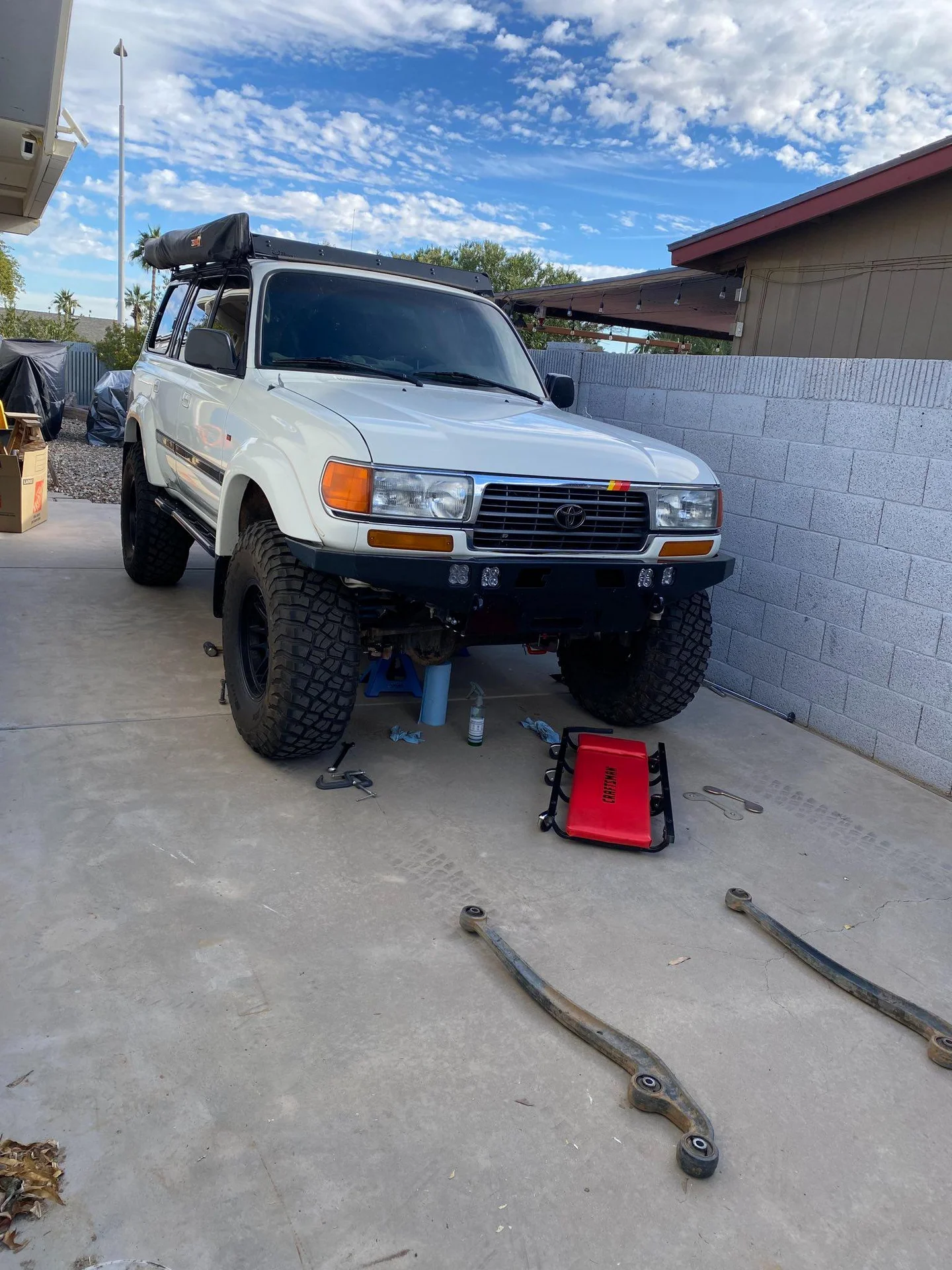

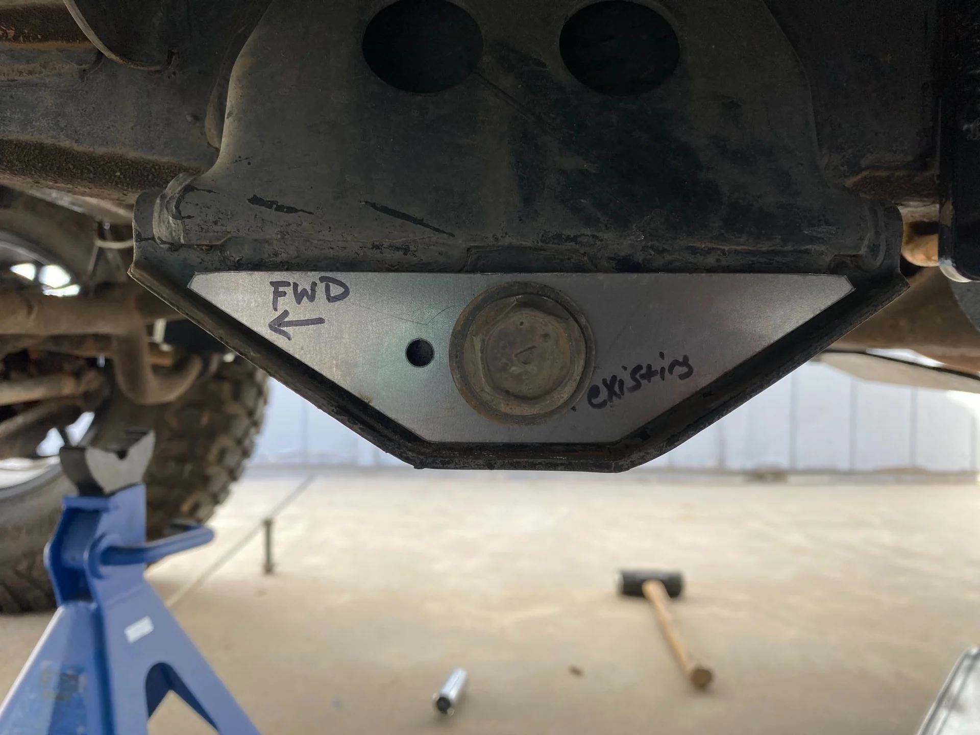

Well, it was one of those days where things don't go quite as planned... Intended to remove the 2.5" Land Tank caster plates and install the 4" plates, but it turns out it's not a simple swap without welding the slot from the 2.5" plates closed so that you can correctly drill through the new plates pilot hole and across the gap to the other plate. The edge of the old slot is right on center where the new col goes. Not a terribly difficult thing to do, but enough to get me to reconsider and go a different route....
- Those of you who know me, know I am an opinionated ass and I may be swallowing my pride and ordering some arms from those who shall not be named.
- The other option is to use the Slee 4" caster plates, that require a tad bit of trimming on the forward bottom edge of the plates and the redline cruiser axle relocation mounts I planned to use originally.
We shall see after I make some phone calls....
Mocked up:

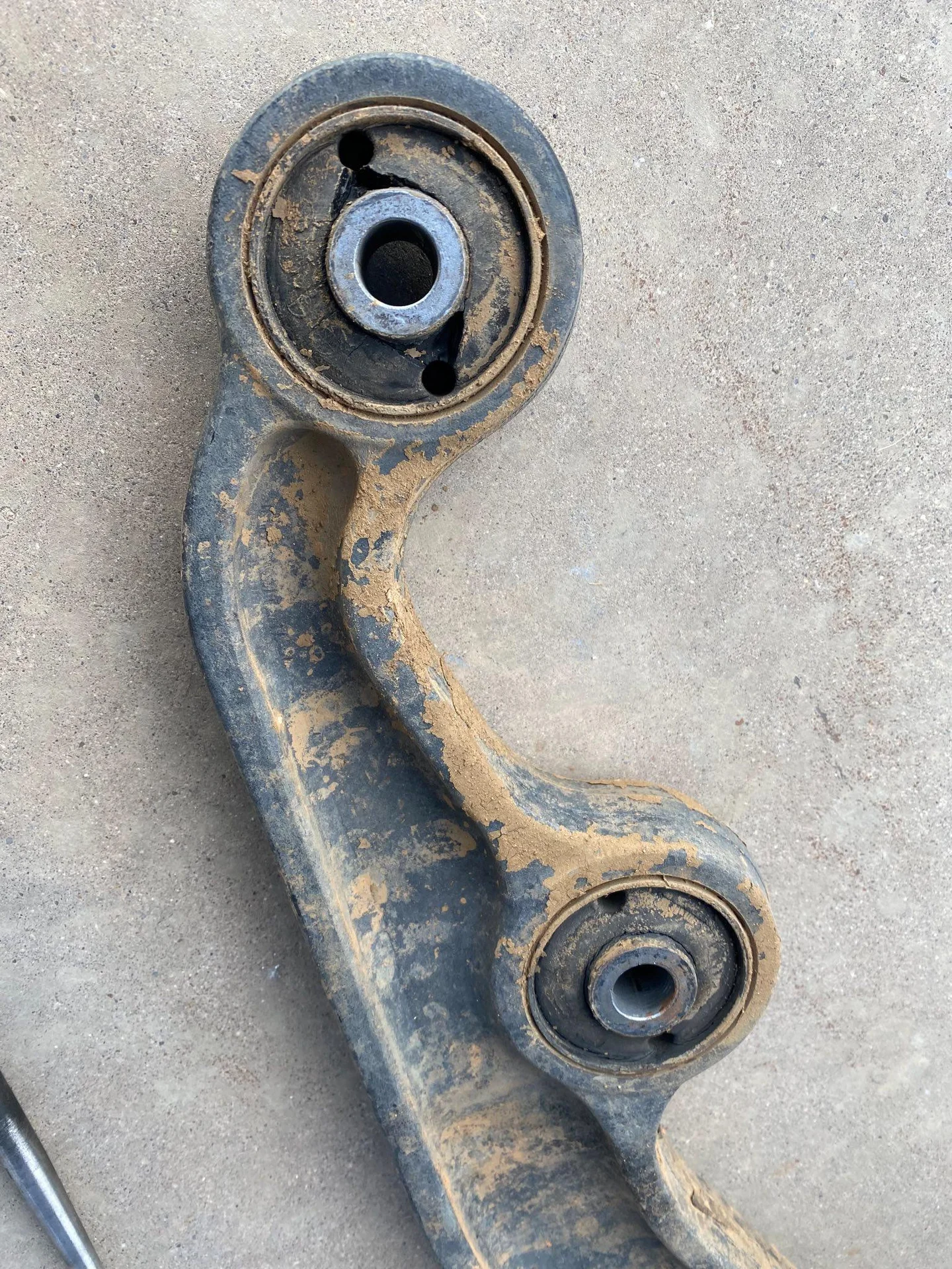

These bushings are toast:

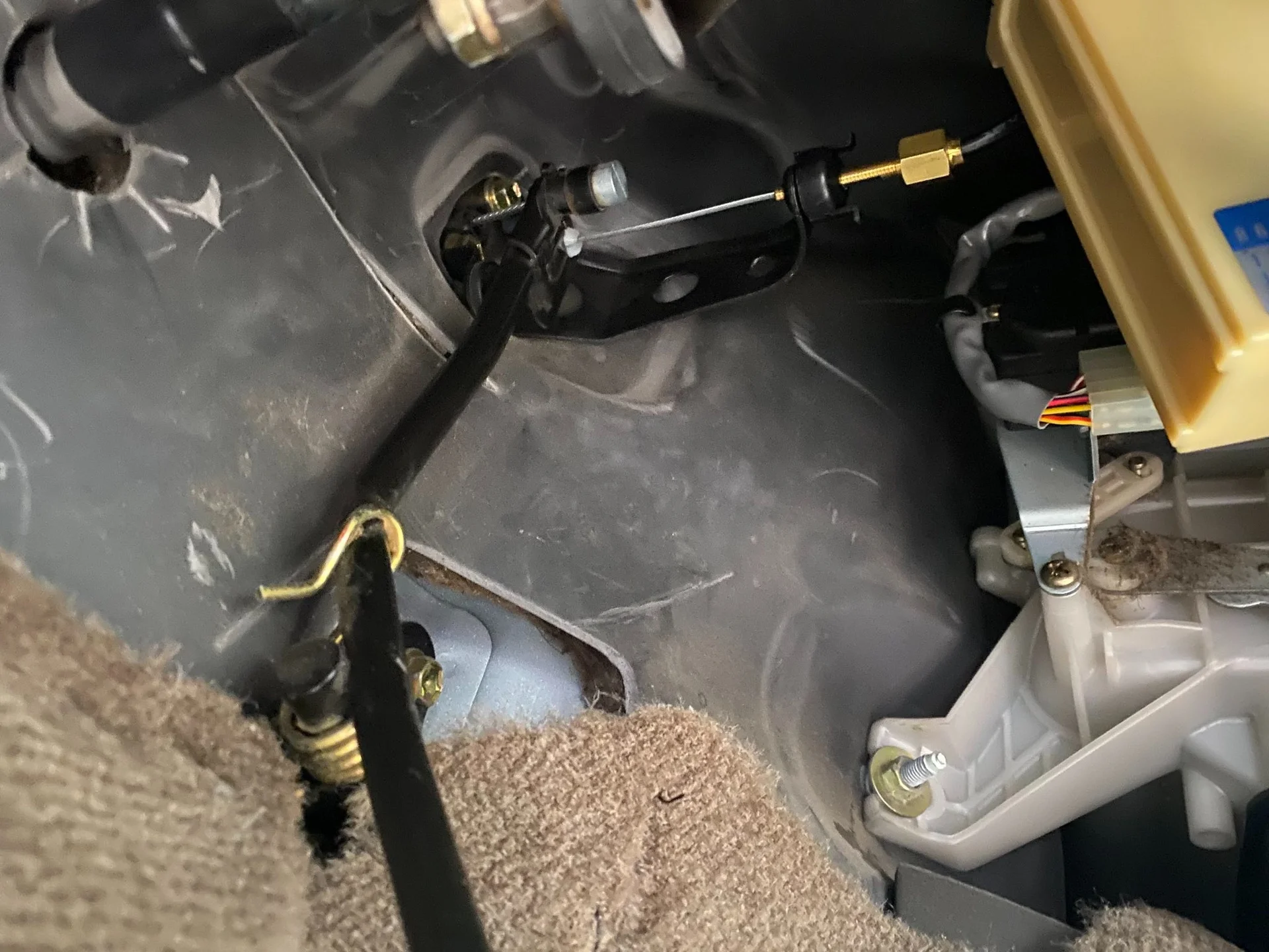

My buddy made this for me:
Mocked up:

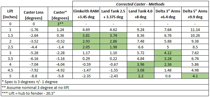

Documenting some information here, this all came from various threads, hopefully someone finds this helpful gathered in one place:
  • 80 series lift in inches = (Current hub center to fender in inches) - 20.5"
  • With each inch of lift, based on geometry, you will lose 1.76 degrees of caster ==> -1.76 degrees / inch
  • DeltaVS 5" Arms = +9.9 degrees of caster = 1.76 deg/in * 5 in + 1.1 deg
  • DeltaVS 3" Arms = +6.38 degrees of caster = 1.76 deg/in * 3 in + 1.1 deg
  • I believe delta is adding the 1.1 degree of caster to get you at the top end of the spec (4 degrees) @Delta VS can you confirm?
  • FSM Caster Spec = 3 degrees +/- 1 degree = 4 to 2 degrees... higher caster seems to 'feel' better according to folks running bigger tires
I have been racking my brain on what method to go with to correct my caster and put together this little table that may be helpful to the 80 crowd. Earlier in my thread I had mentioned incorrect caster correction numbers for the land tank plates, I removed that info and I believe the numbers in the table below are correct.
Notes:
  1. I calculated the land tank caster correction assuming 3 degree caster before a lift and 1.75 deg / inch caster loss that he has mentioned elsewhere
  2. The deltaVS numbers came from the delta drawing and discussion in their thread
  3. Eimkeiths numbers came from his website
