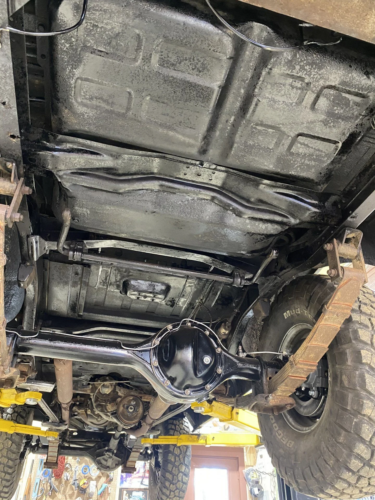

The underside has been scrubbed and gotten an initial paint. I’m going to spray some Lizard Skin and then once that cures I’ll oil it up with some Fluid Film before it leaves so we can creep that protection into all the cracks paint and Skin won’t reach.

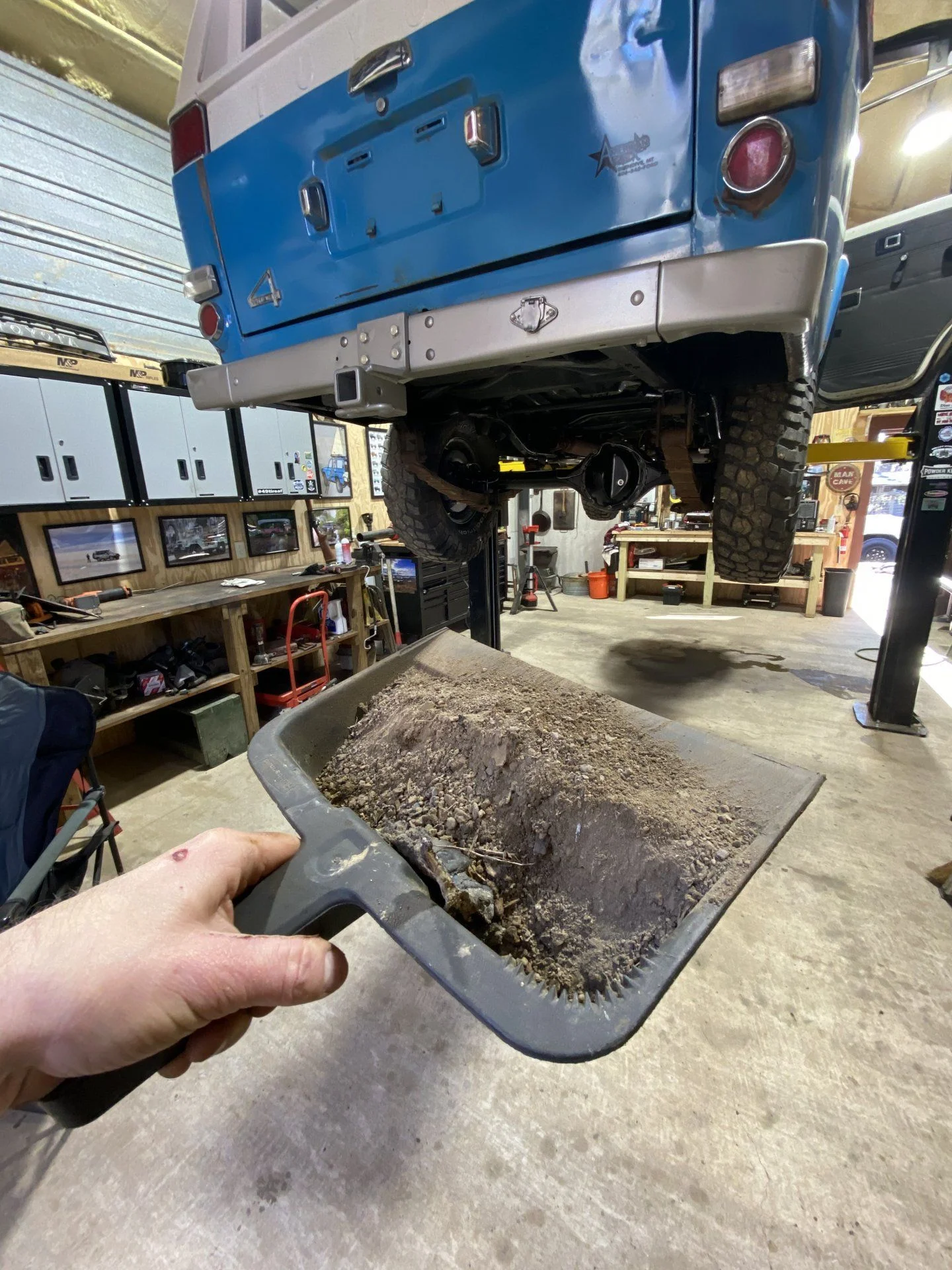

I had one body mount left to clean out. This is truly amazing that this trap is built into the truck. That’s at least 3# of MN/MT/ND

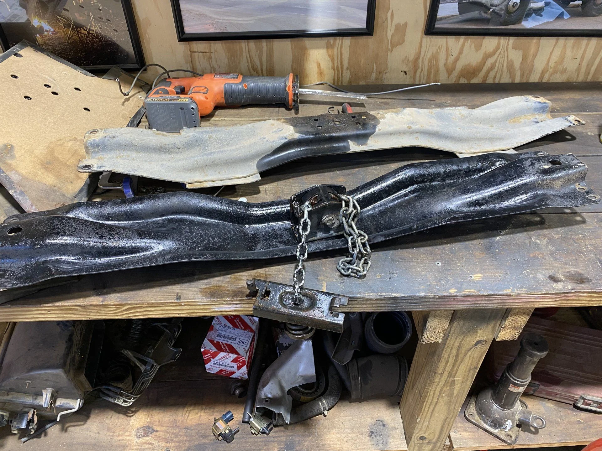

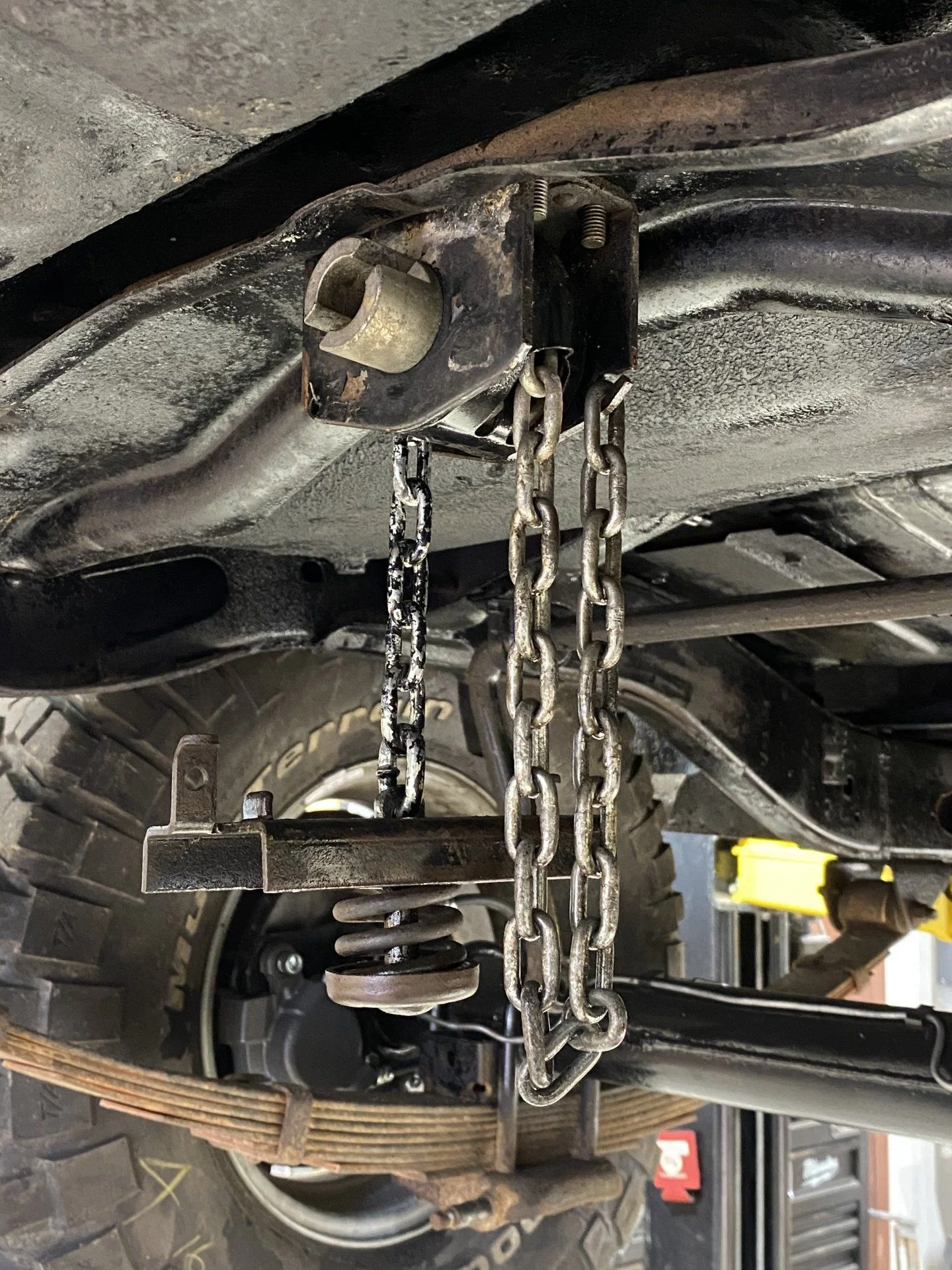

I found a functioning spare tire winch.
What was weird is that there was no room to put the bolts into the top of the crossmember to attach it. It’s like the fuel tank has swallowed up that space over the years.
Instead of having the 4 bolt heads rub on the tank I put some 1/2” spacers in to have a gap. One more item off the list.

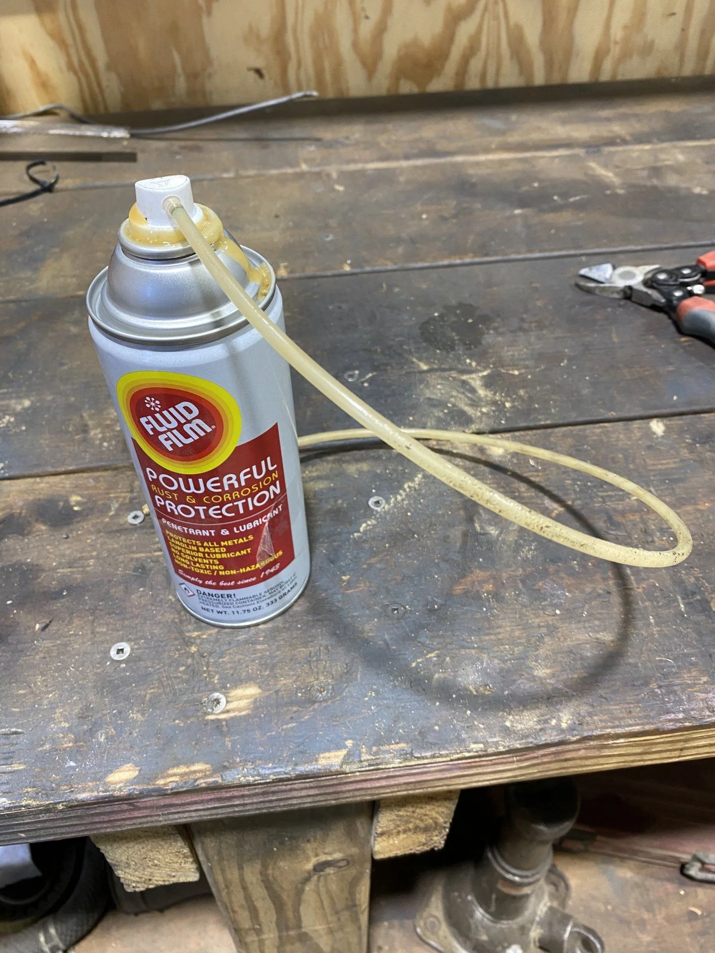

I had two rocker holes that I made patches for. Pulled all the plugs and filled the cavities with fluid film with this 360* sprayer then capped them back up.

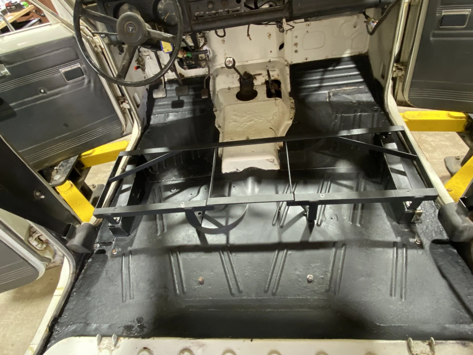

Also I made a brace for the passenger side seat tower where the thin metal had broken through.

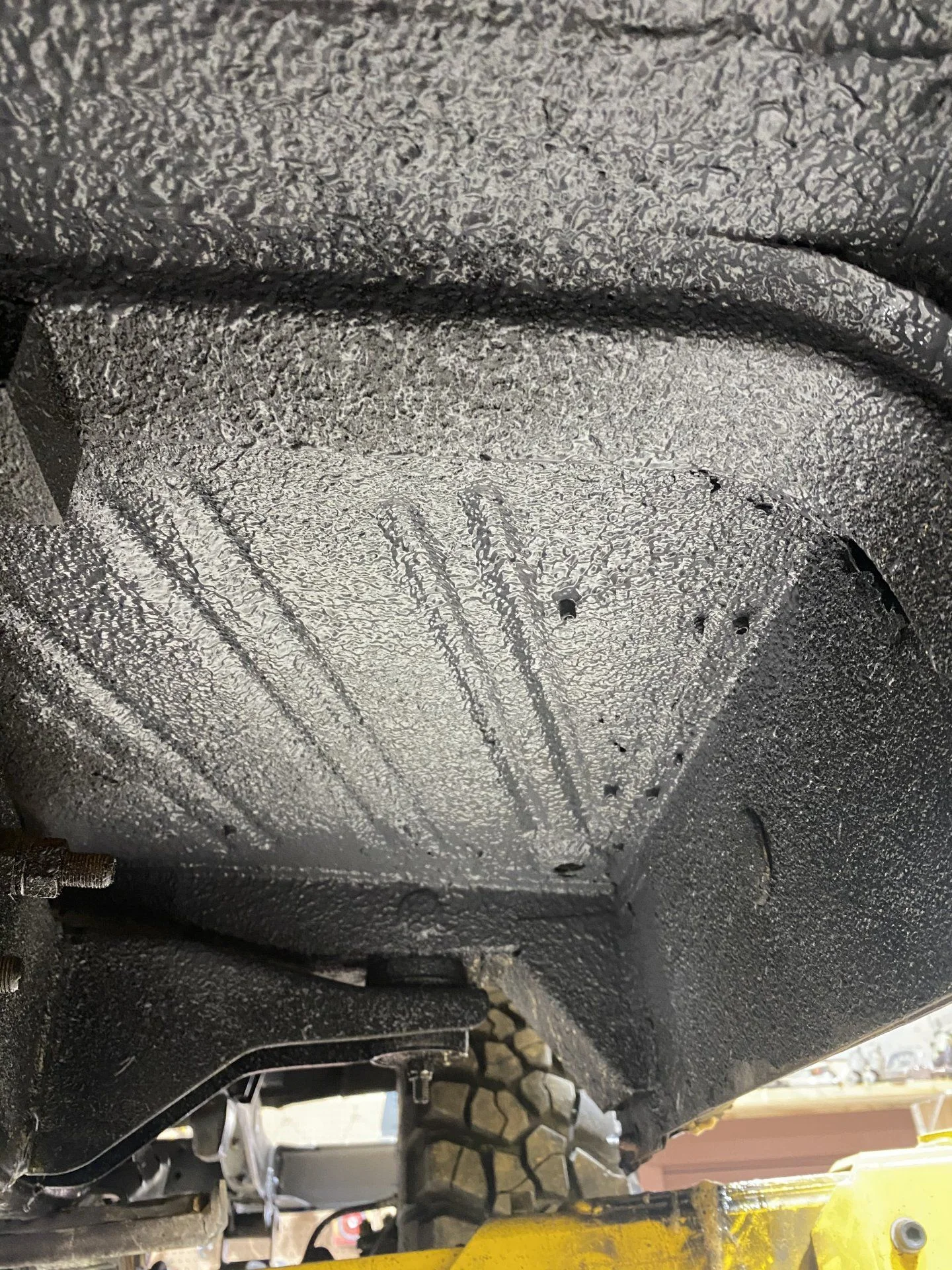

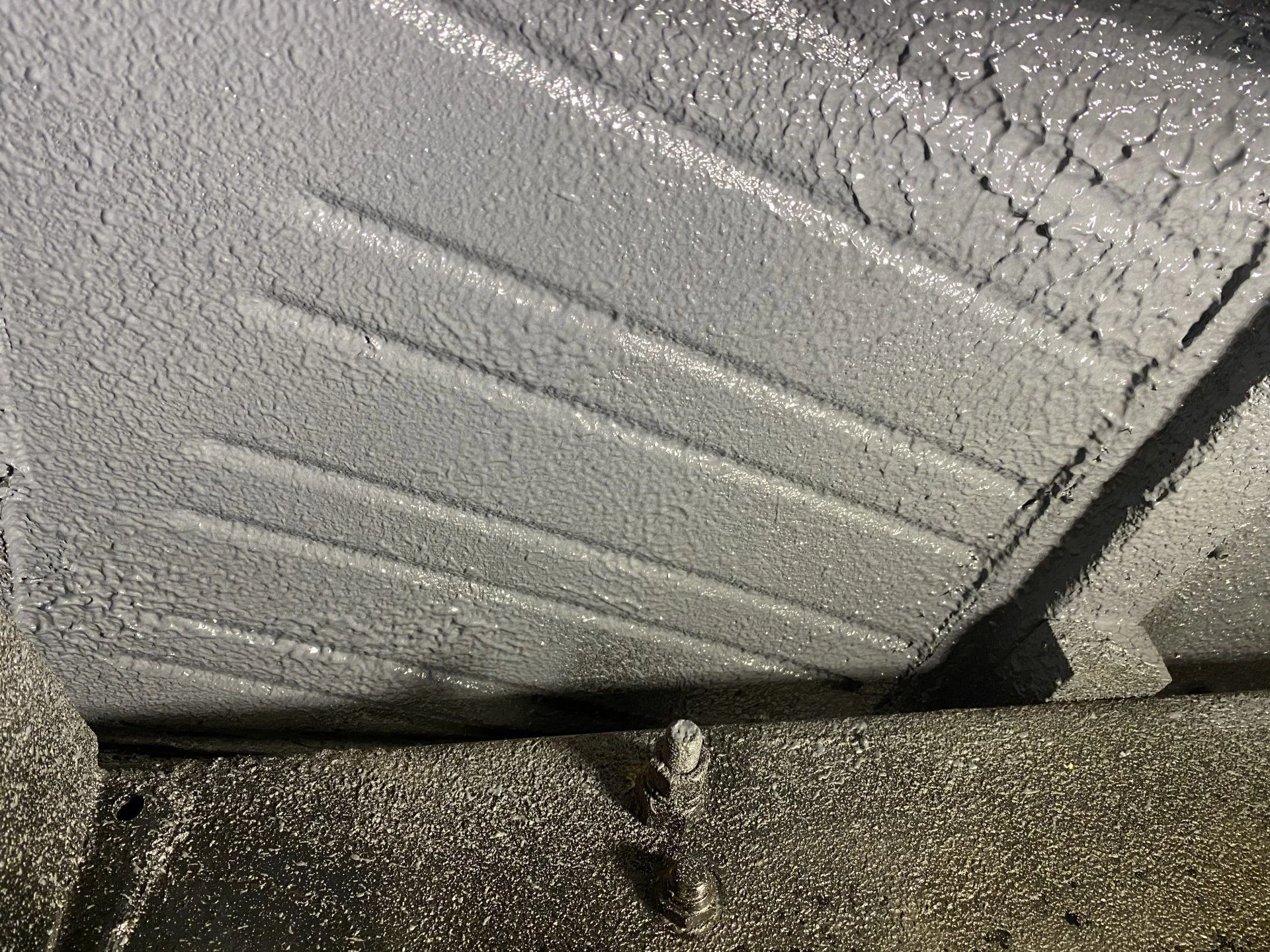

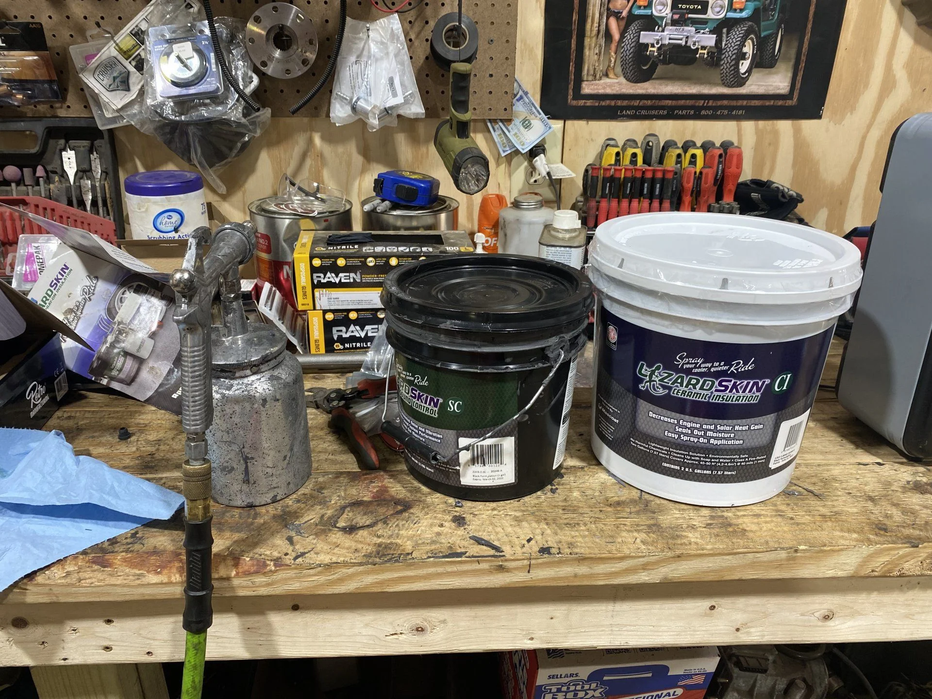

Final push to get this guy into the other shop today is getting the Lizard Skin applied to the underside
Sound dead first and then a layer of ceramic tonight once this cures.

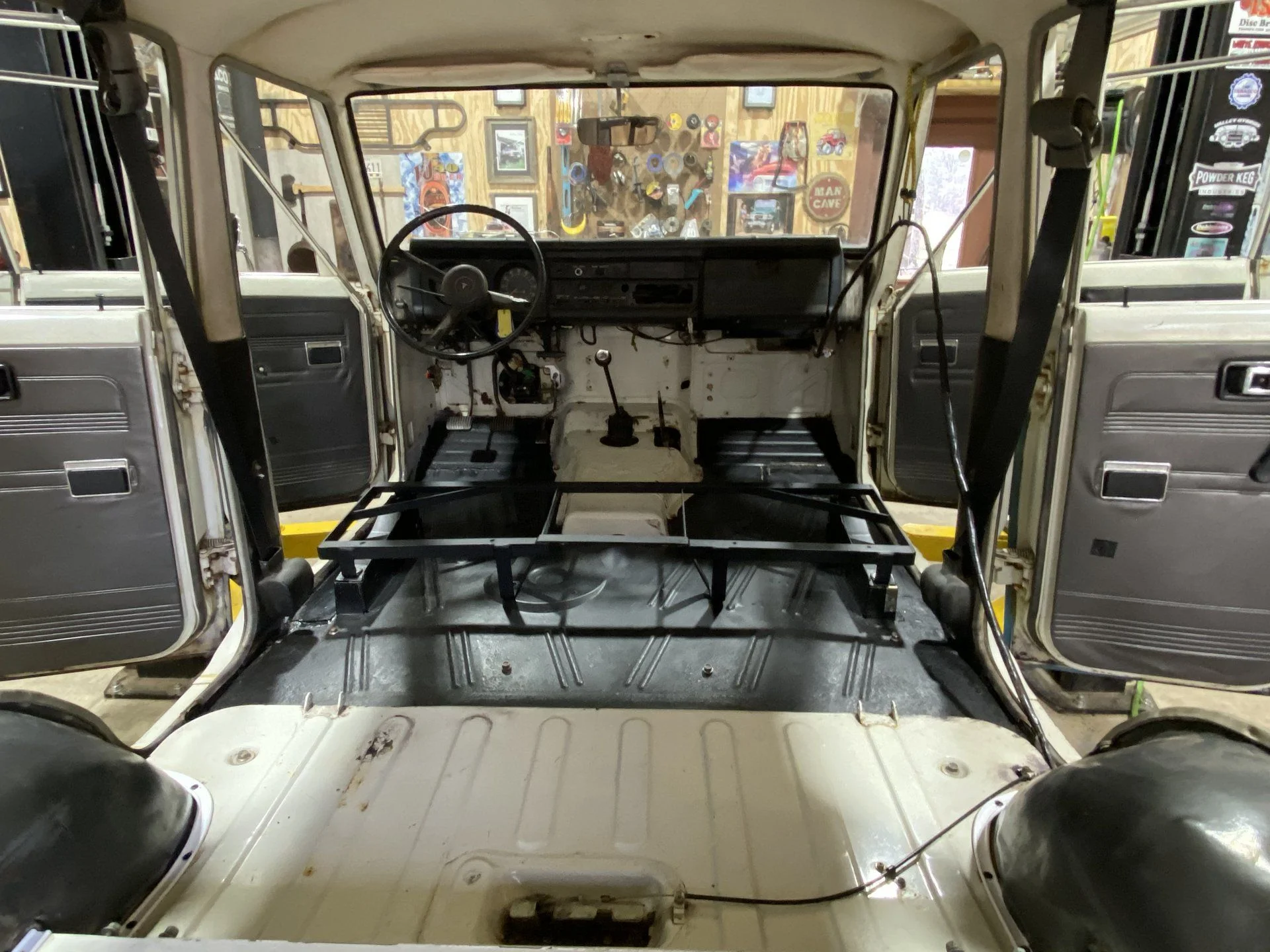

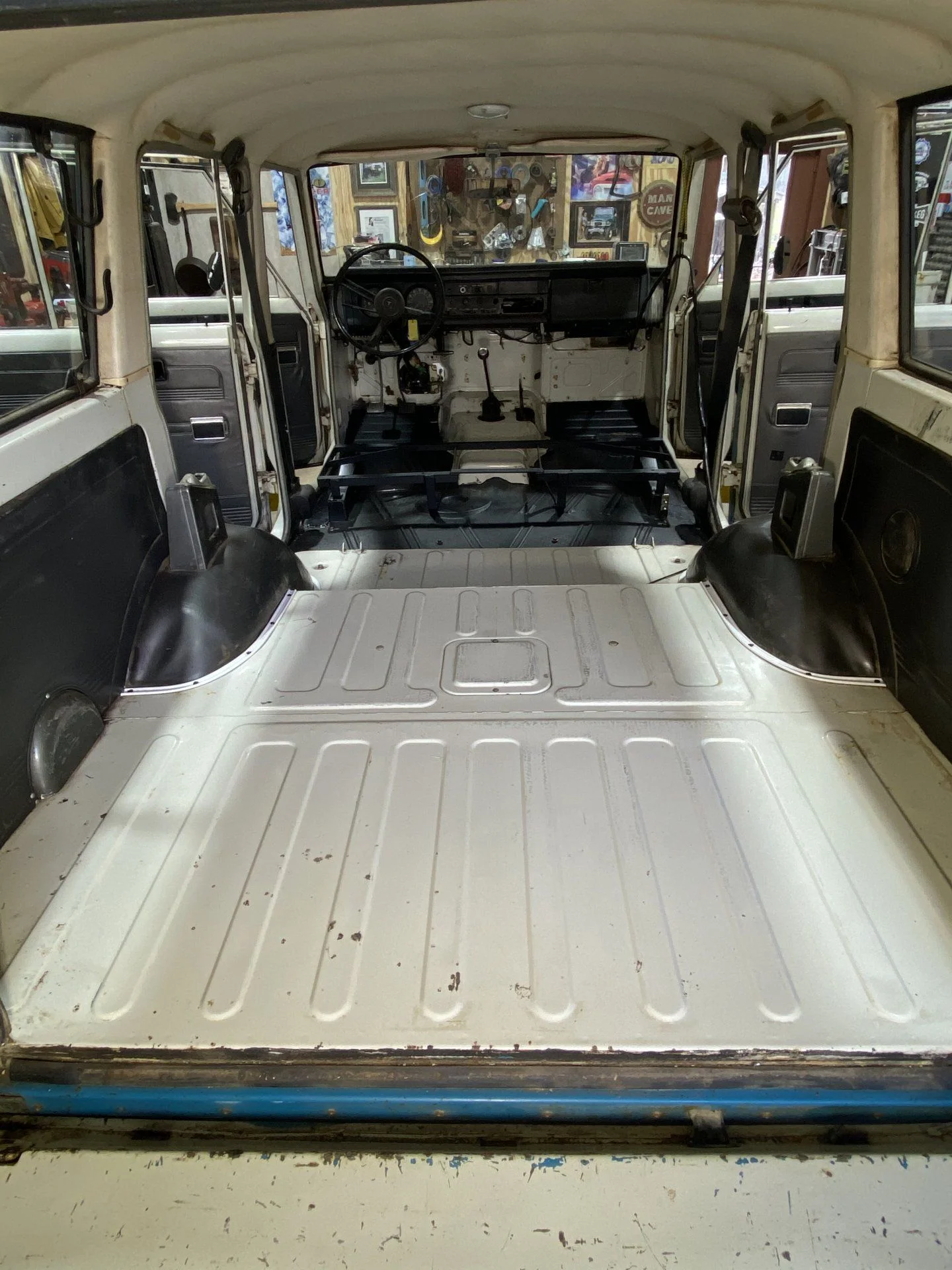

What a beautiful sight. Clean and ready for the rebuild as parts come in. The foot wells forward are getting Lizard Skin and the pretty white stays white and uncoated.
