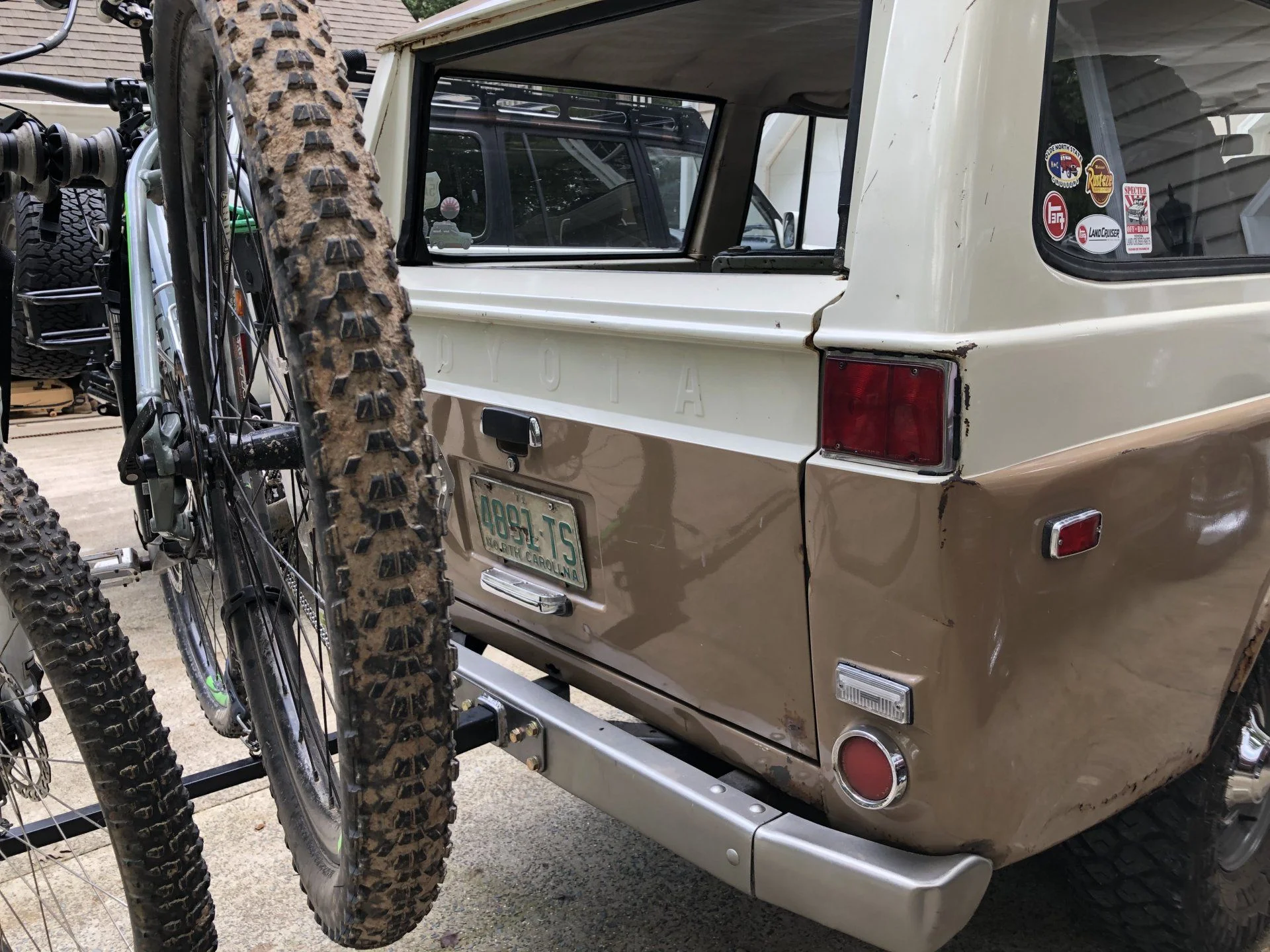

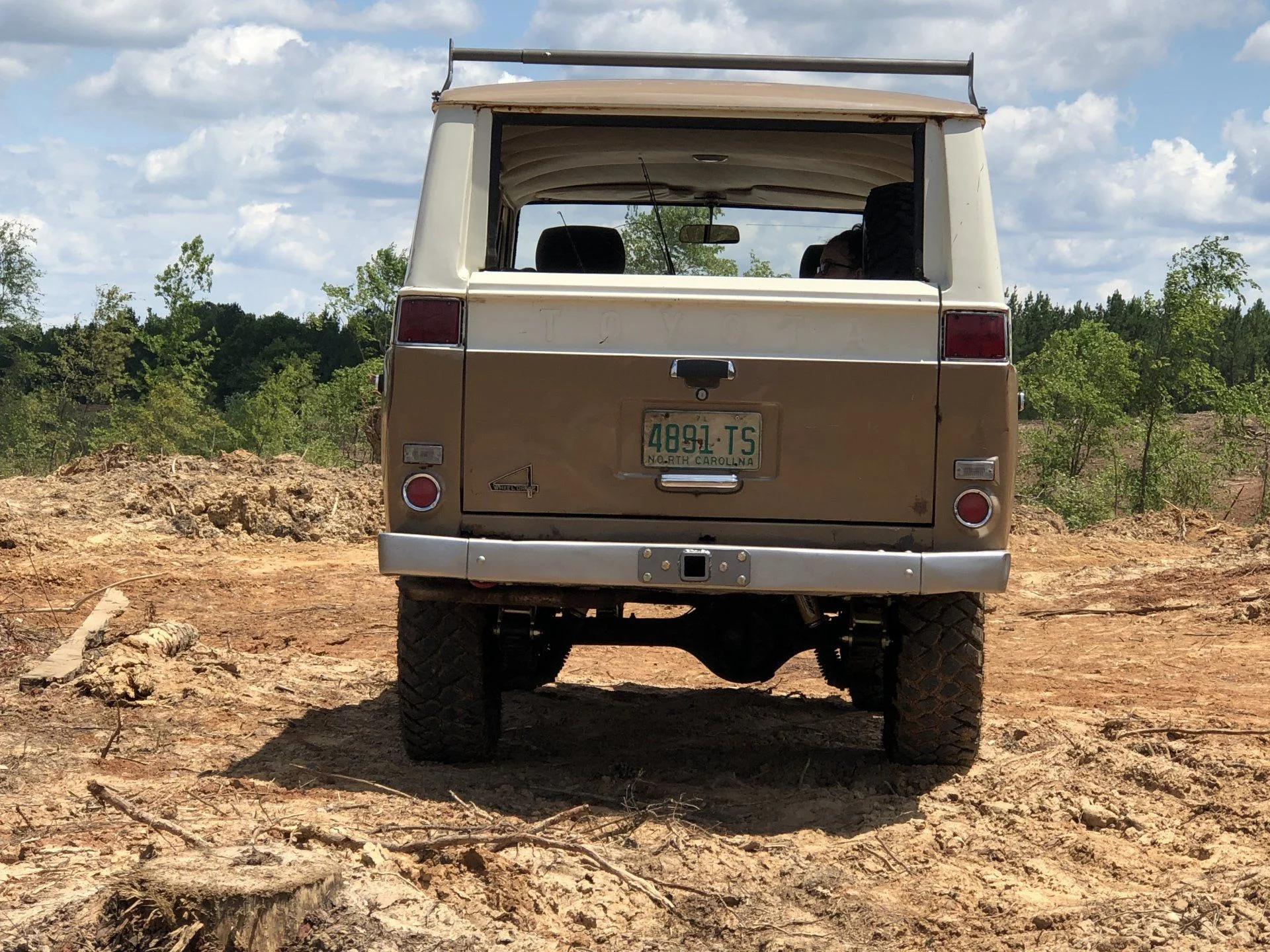

Here's what Scrap was referencing. I "frenched" the receiver into Bucky's rear bumper to make it more snag free. Mine is not a true recovery point, nor is it heavy duty. Only attached to the rear cross member and bumper. I pull a small utility trailer with it. It carries my bikes without issue.

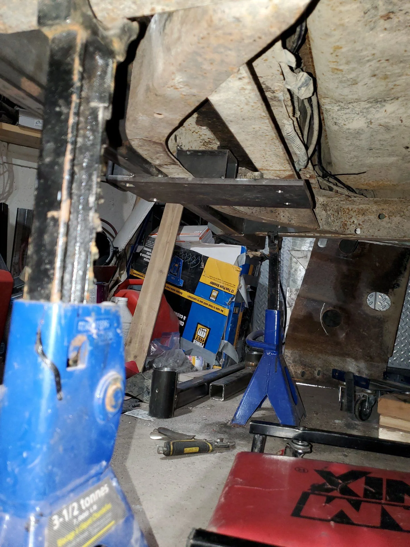

The PO on mine left a welded piece of angle iron welded across behind the brace - I am bolting my bumper to it, but something similar could be added to the 'frenched' designs above for additional strength too.. Whole design will be rethought though if I ever get around to adding a longer range tank to it.

With it up in the bumper at least you have a shot at sliding over something rather than digging in the hitch like an anchor. I would advocate adding some stiffener to the crossmember at the least if towing. If not towing, I'd remove the hitch.

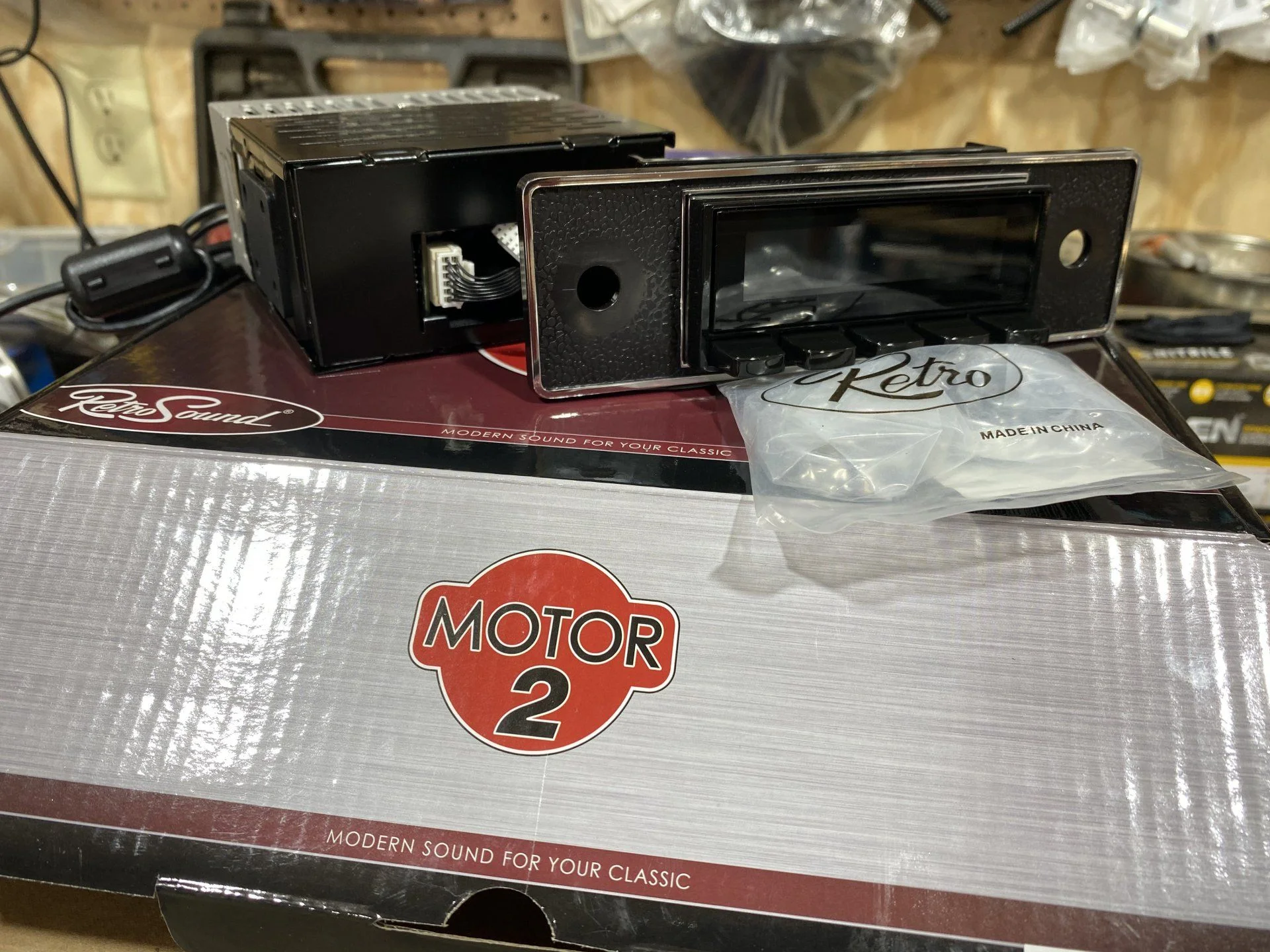

On another note, the RetroRadio is here. Theee look great in those old trucks

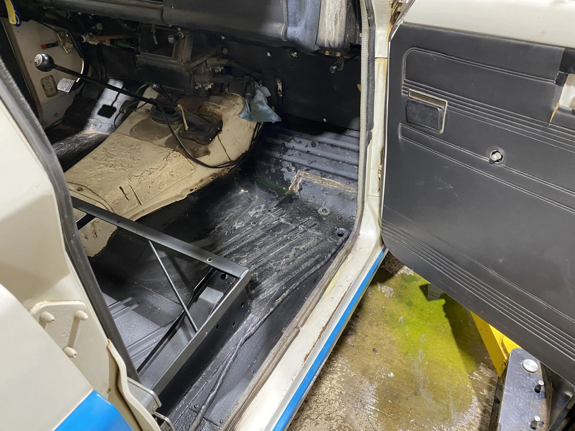

I decided I’d pull the old radio. Simple enough right? Holy hell I think they built the dash around this monster.
Then I got the heater out. The dash firewall pad is in great shape. I’ll reinstall that after Lizard Skin.
Mike is looking into AC options now.
